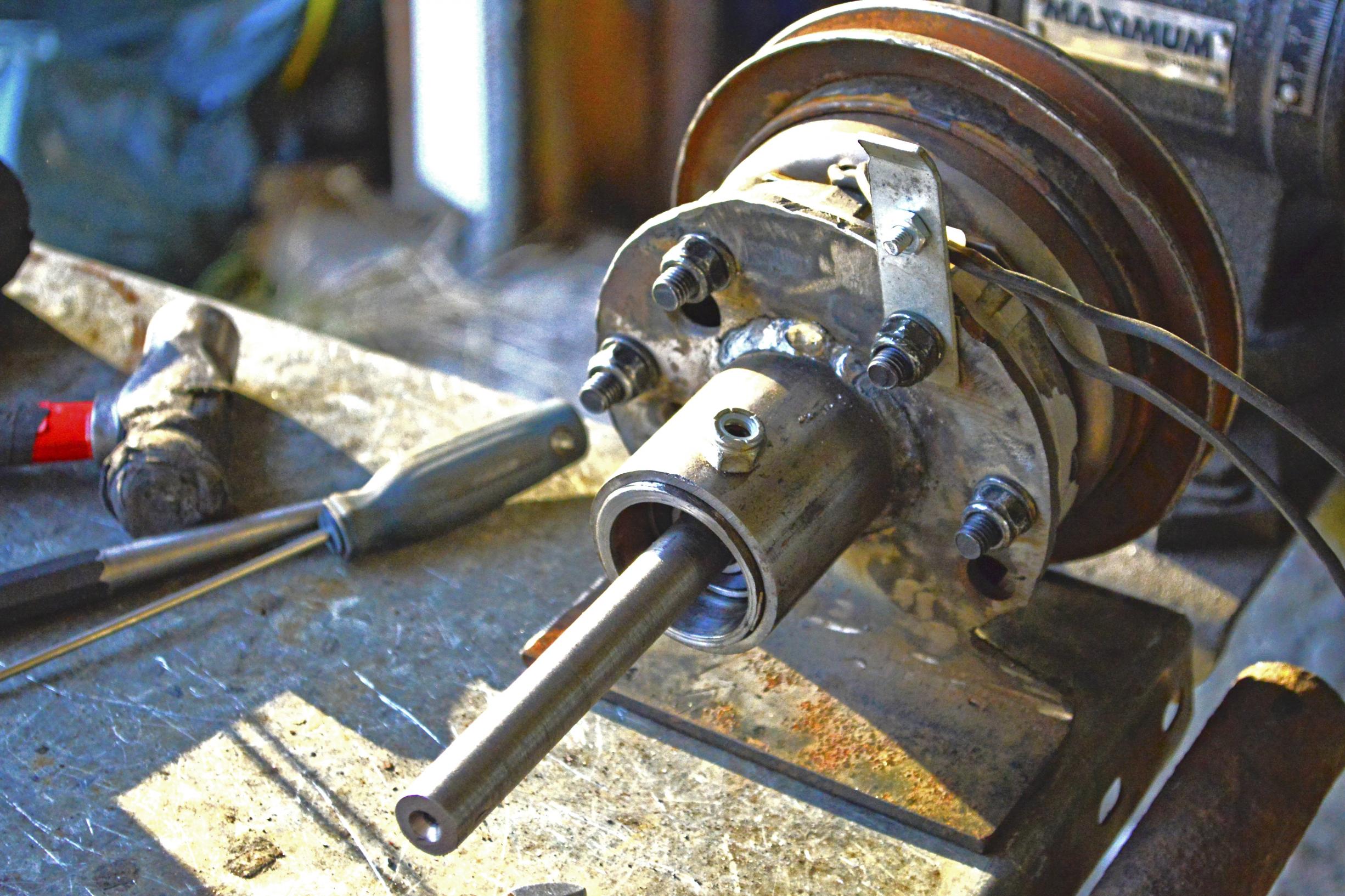

DSC5741 copy To support the shaft I machined a pipe to mount a bearing in (press-fit but I threaded set screw as well) and welded to the back of mounting plate. Tested for trueness with micrometer and ran it at 1725 rpm without any vibration. Expect the normal speed to be 60 to 120 RPM for what my use will be.
