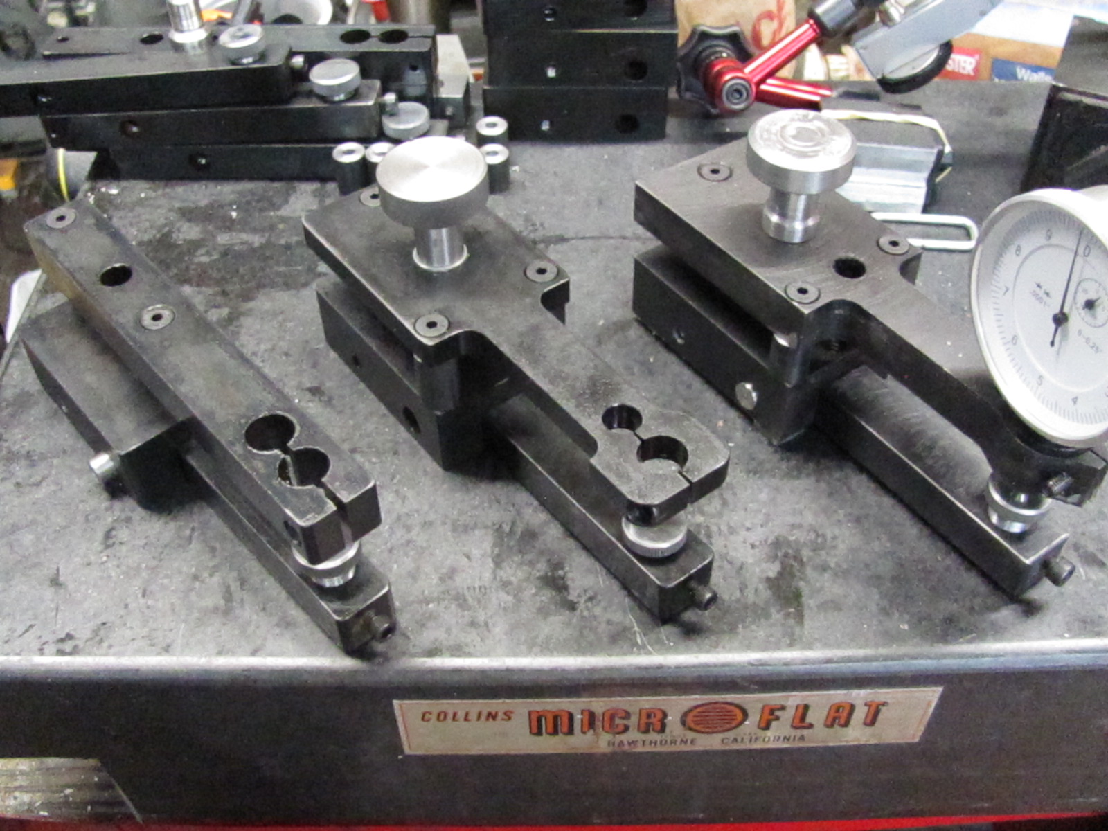

  1. thehomeengineer
    Hi
    Not seen these before how does it work?
    I can see the dial test indicator, which I guess shows any discrepancy but unsure how you would use it. Sorry if I am being a bit stupid but very interested.
    The Home Engineer
  2. Lima2088
    Works the same as a Rahn Repeat-O-Meter (ROM), detects surface plate imperfections from a given (assumed) flat zero. Owning a small 12"x18" surface plate, a 12" long ROM takes more room than it measures. This version is 6.5" OAL. Here's an NYC CNC link to their build: https://www.youtube.com/watch?v=ra727zZCMzk
    The real question is "Do you need one?" If you're buying a used or want to grade your exist surface plate, it helps. If there's interest, I'll make dimension drawings in PDF.
  3. Lima2088
  4. thehomeengineer
    Thank you for the additional information very interesting project. We have a large engraver at work and the table is all over the place (I think) so was interested to see how your project works to test our machine table.
    Thank you again for taking the time to provide the video and photos.
    The Home Engineer
  5. Lima2088
    Here's a couple more YT surface plate resurface vids from Oxtools and Robin Renzetti (sp?):
    https://www.youtube.com/watch?v=EWqThb9Z1jk
    https://www.youtube.com/watch?v=sKwZxV4bUoA
    Hmmm, lemme get cracking on the dim dwgs. Will PM when done. BTW, bought the cheapest 0.0001 DI from fleabay ($26). Tested with various measured shim stock and is +/- 0.0001 repeatable.
