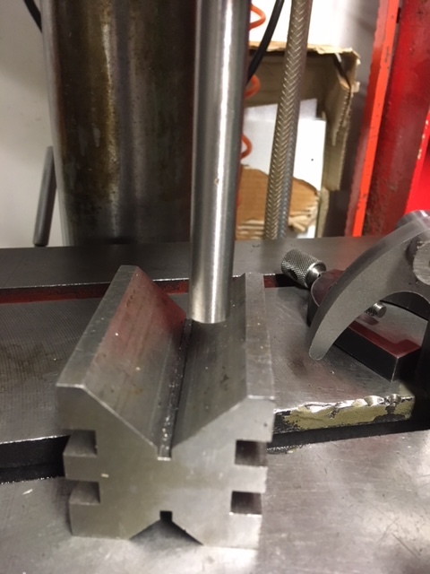

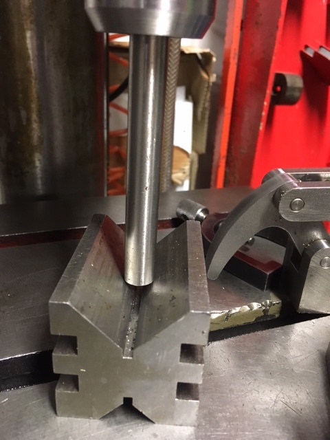

This is the method I use for setting a vee block centrally to machine spindle.
This is a quick method for setting up a vee block centrally to the machine spindle, be it a on a drill or mill.
The first picture shows a piece of material which has been machined square in the lathe and is the setting piece.
Attachment 21614

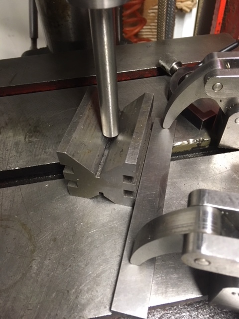

The second photo shows the setting bar being lowered in to the vee of the block using the machines quill. This centralises the vee block to the spindle.
Attachment 21615

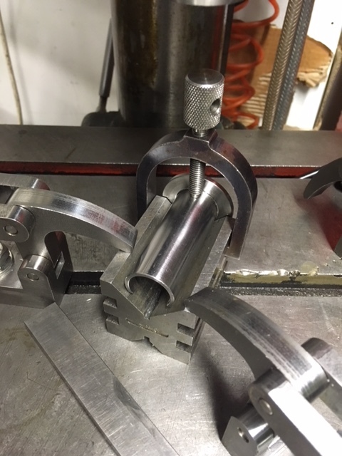

The third photo shows a parallel being clamped against the base of the vee block. This needs to be tighten and square to the block.
Attachment 21616
The forth photo shows the vee block being moved along the parallel. This enables the work piece to be position without machining into the vee block but still maintaining the central position. (In this case I didn’t need to use the parallel as it is a piece of tube and I am only drill one side of the wall.

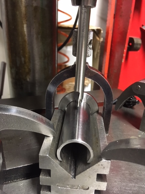

The fifth photo shows the clamping of the vee block to the table, the left clamp is operated first with the vee block still against the clamped parallel to ensure the position is maintained.
Attachment 21618

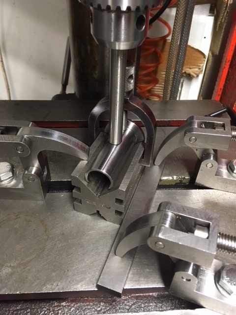

The sixth photo shows the parallel removed and the second clamp in position to ensure good clamping of the vee block.
Attachment 21619
The seventh photo shows the centre drill ready to drill the component on its centre line.
Attachment 21620

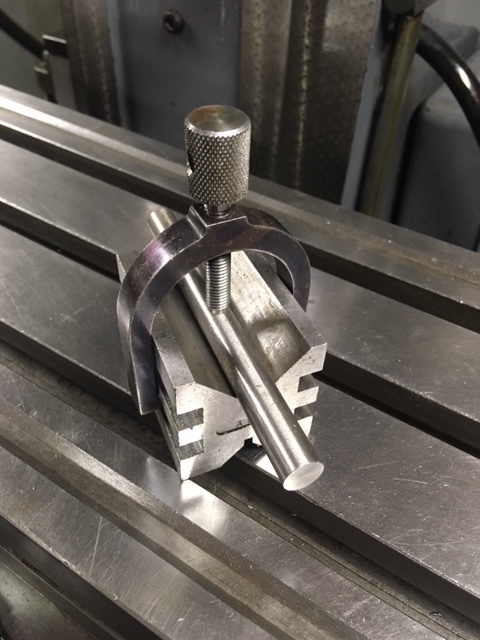

The setting bar is also used to clamp the vee block and horse shoe clamp together for storing.
Attachment 21632
This isn’t a home-made tool but I hope you have found this useful for any future projects you where you might need to drill on the centre line of a shaft.
