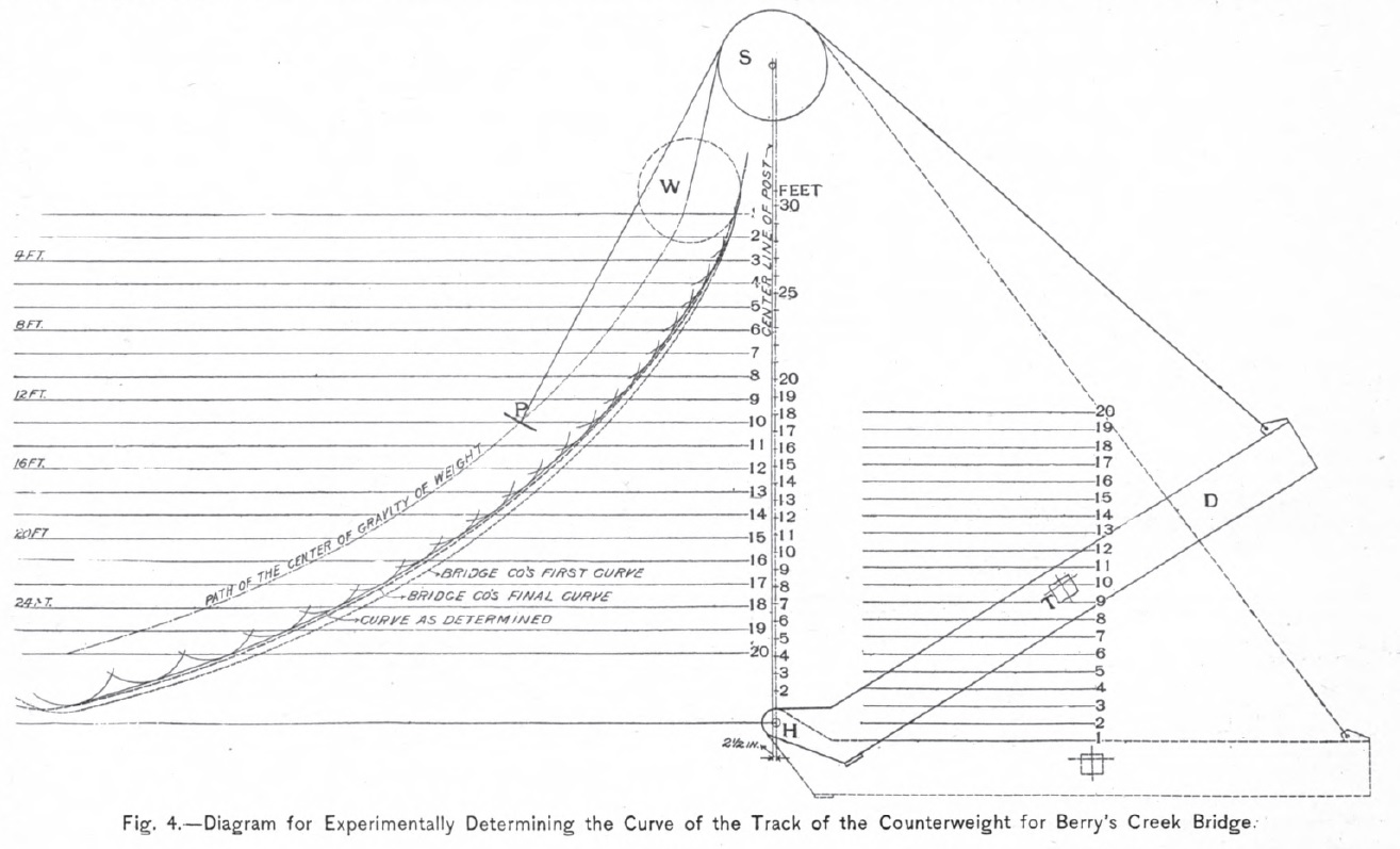

    Now that's a very rare and interesting piece - a Belidor bascule bridge, a rolling counterweight double-leaf bascule bridge,.
    Reason for construction: A perfectly counter-balanced bascule bridge, needing a minimum of work to lift.
    Guess the first US example of this type was Berry's Creek, N.J. bascule bridge...
    PDF from Railroad Gazette, Nov 27th 1896 describing the theory, design and function of this type:
    Bélidor bascule railroad bridge - Meccano Gallery

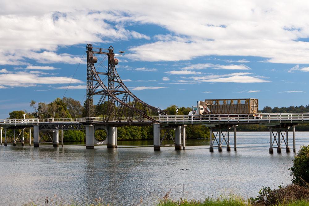

    The Aussies had the intrepid bridge designer Harvey Dare:https://portal.engineersaustralia.or...ge_Maclean.pdf
