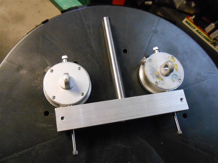

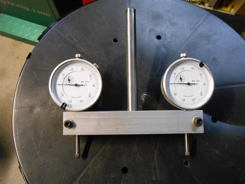

    After seeing a few video's on these, I had to make one. This is so easy to make and works so good! Setting your equipment is no longer a hated task.
    I can't take any credit for this as similar ones are sold commercially and plenty of vids on you tube but here's how mine was made.
    (1) 6 inch piece of 1x1 aluminum bar
    (1) 1/2 inch steel rod, about 6 inches long (A Chevy V8 fuel pump push rod in my case!)
    (2) Harbor Freight dial indicators
    (2) 10-24 cap screws
    As noted, I opted to use a Chevy V8 fuel pump push rod that I had lying around since it's perfectly straight and hardened it was a good choice. I drilled the hole slightly undersized and used my shop press to push the rod into the square bar. The dial indicators I simply robbed from some other tools I made so I bounce those back and forth as needed. They set in a 3/8 inch hole that is then slotted with a 10-24 cap screw that cinches down to tighten them in.

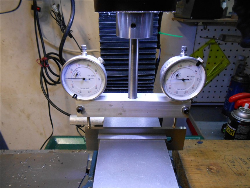

    I guess I'm lucky in that both my gauges are pointing to the same spot but it's not important anyway. Just 0 out both your dials and lower your quill down to your table or in my case, I trammed from my vise using 2 parallels. My mill was out a bit so with the mills head bolts loose (but lightly gripping yet) I just bumped it back until both gauges read the same value. (actual number doesn't matter, just so they both read the same)
    It's quite fool proof and makes quick work of tramming your mill or even drill press tables.

    Quote Originally Posted by pigpen60 View Post
    How do you zero it?
    If you only had one dial, you would zero it to your table, then rotate the entire thing 180º. You then measure the difference and adjust your tram to half the difference. Rinse and repeat.
    With this set up, you zero out one dial to your table, rotate the entire thing 180º as before. However, this time, you zero out the second dial - using only the rotation on the dial and NOT the Z adjustment on your mill - at the same spot on your table that you adjusted the first dial. You now have 2 dials zeroed out the the same spot on one side of your table, but one is resting 180º away from the other.
    If your mill is out of tram, one of the dials will be precisely on zero and the other will be off. If you adjust the tram to half the difference, as you did with only one dial, one of the dials will increase by that amount and the other will decrease by that same amount. When both dials are reading the same, you mill will be in tram (along that axis.)
    It doesn't really matter if the center shaft is precisely perpendicular to the bar of if the dials are precisely the same distance from the center spindle. It is handy if both dials have the zero at the 12 o'clock position, but not essential. As you adjust the tram, the needle are going to become either toe in or toe out (pigeon toed or duck toed) so having the dials exactly symmetrical is not necessary.
    One mistake I made was to make the bar too long thinking a longer bar would give more precise results. However, I made it too long so I could not rotate it the required 180º. Another caveat is to make the center spindle long enough that the dials don't collide into the mill.
    Hope this helps.
