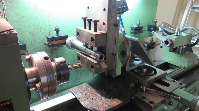

    Milling attachment for LATHE
    Used an 6" angle to mount a old lathe top slide as a "Z" axis.
    See it in action:
    Attached Thumbnails Attached Thumbnails Milling attachment for LATHE-22475699625_ae6351d8d1_z.jpg

    Thanks Cascao! We've added your Lathe Milling Attachment to our Lathe Accessories category, as well as to your builder page: Cascao's Homemade Tools. Your receipt:

    Cool
    Some photos to better show the details

    Working video

    Nice video-no inane music. Just let the machine sing. BUT-NO LONG SLEEVE SHIRTS! Don't want to see you get hurt.

    You right. Put a shirt only for filming but it was a mistake.

    Made a superb GPS mount for my motorcycle with this attachment
    With vibration dampener

    I have that milling attachment for my 1934 South Bend lathe. The only time I've used it, was to cut a square on the end of a piece of round stock, to use as a key for my 4 jaw chuck.
