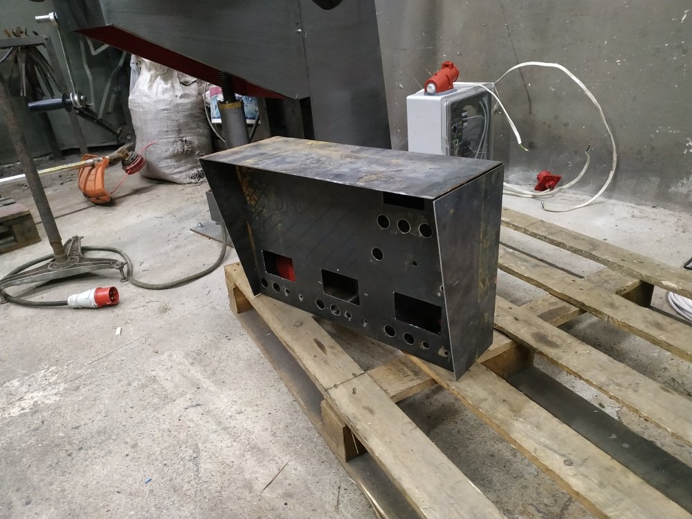

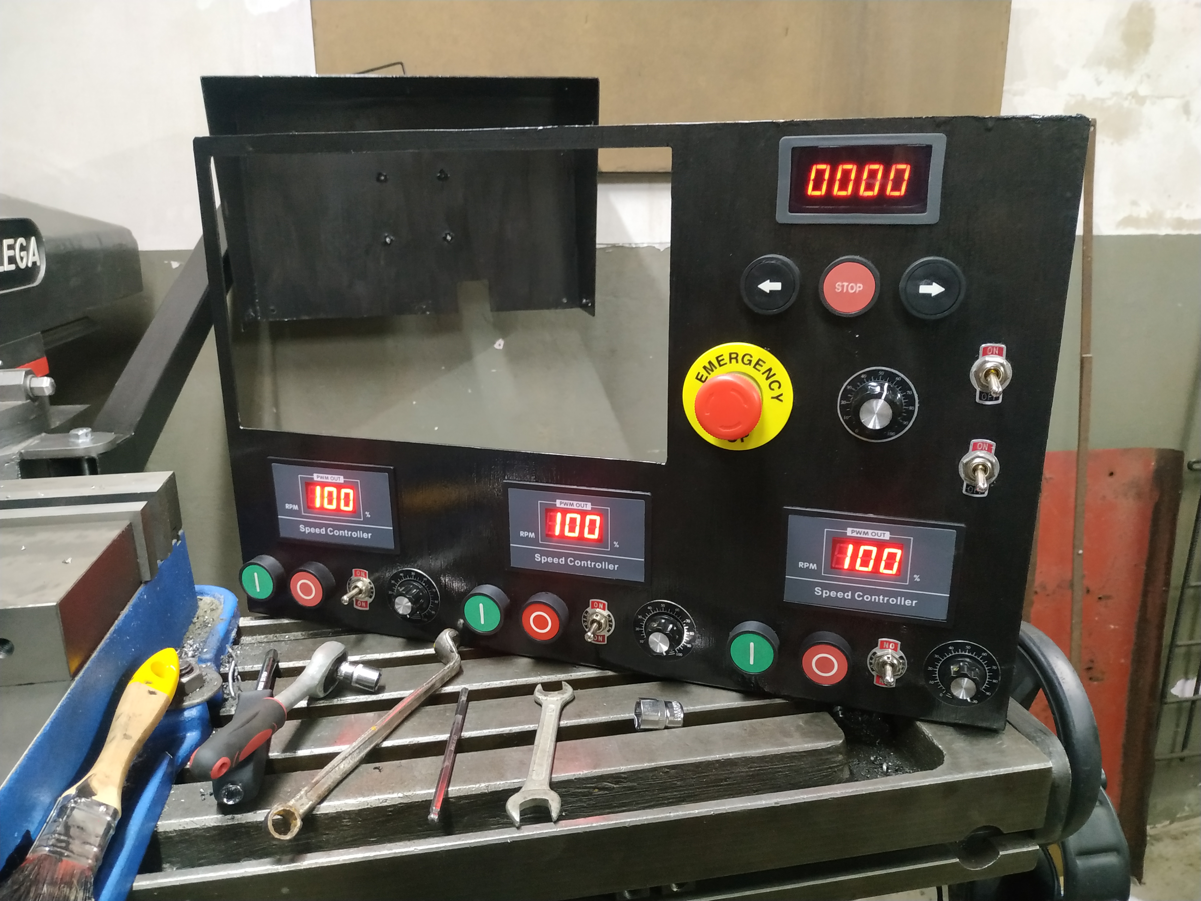

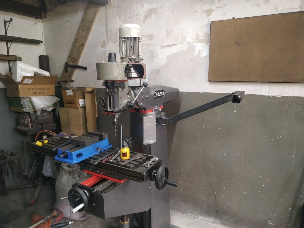

    Currently I'm working on control panel for my milling machine.
    Swivel arm is made from 50x50x2 [mm] square tube:
    Box for electronics and switches is made from 2 [mm] steel sheet (a little bit overkill but I don't like when whole thing bends while pushing the buttons):
    This big area in the left corner is left for DRO lcd screen. I won't cut it untill I buy one. Cutting too big window would be fatal failure for apperance of whole thing.

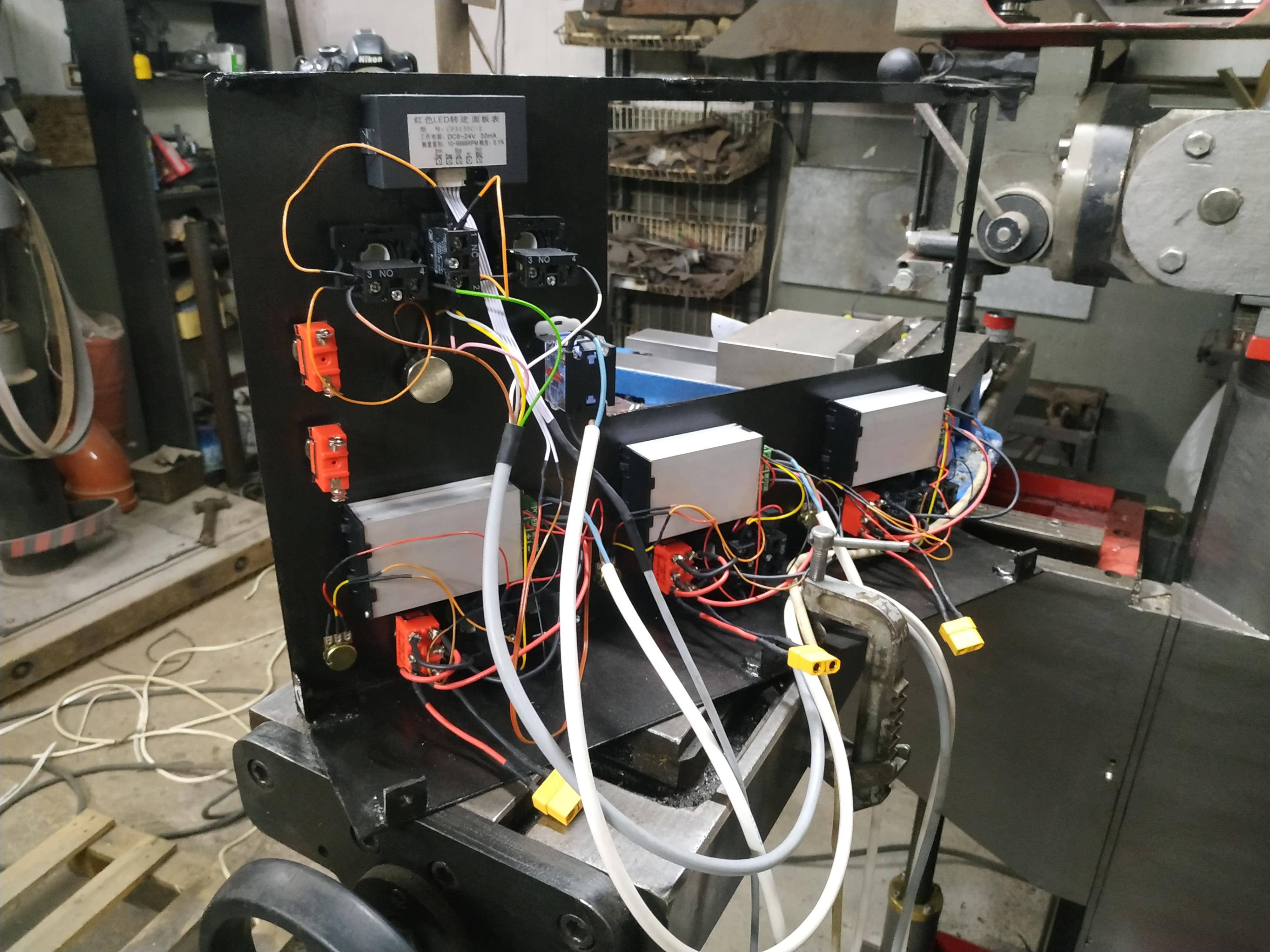

    I did some wiring in control panel. I also bought DRO but lcd screen got damaged during transport and now I'm waiting for screen replacement.

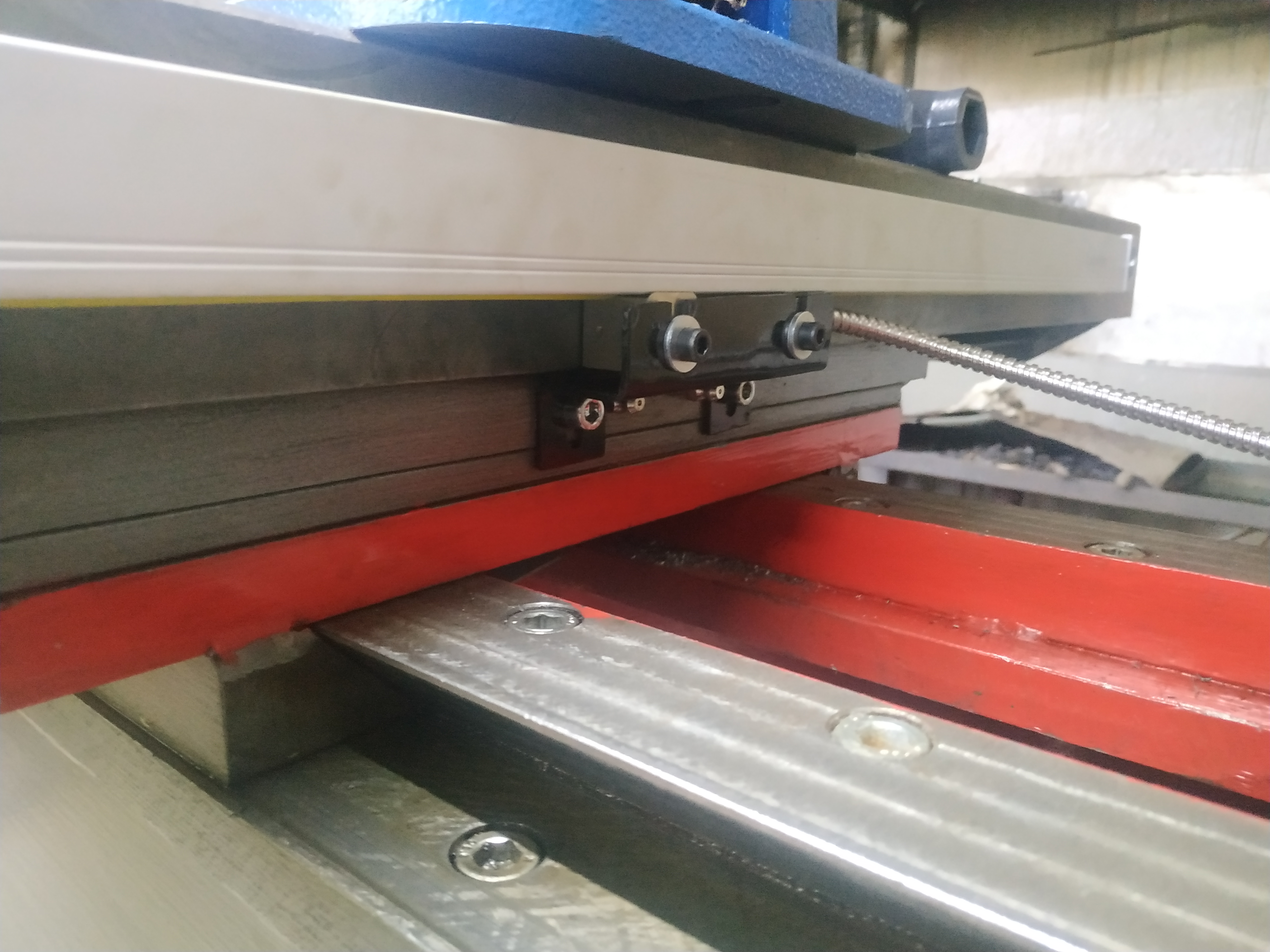

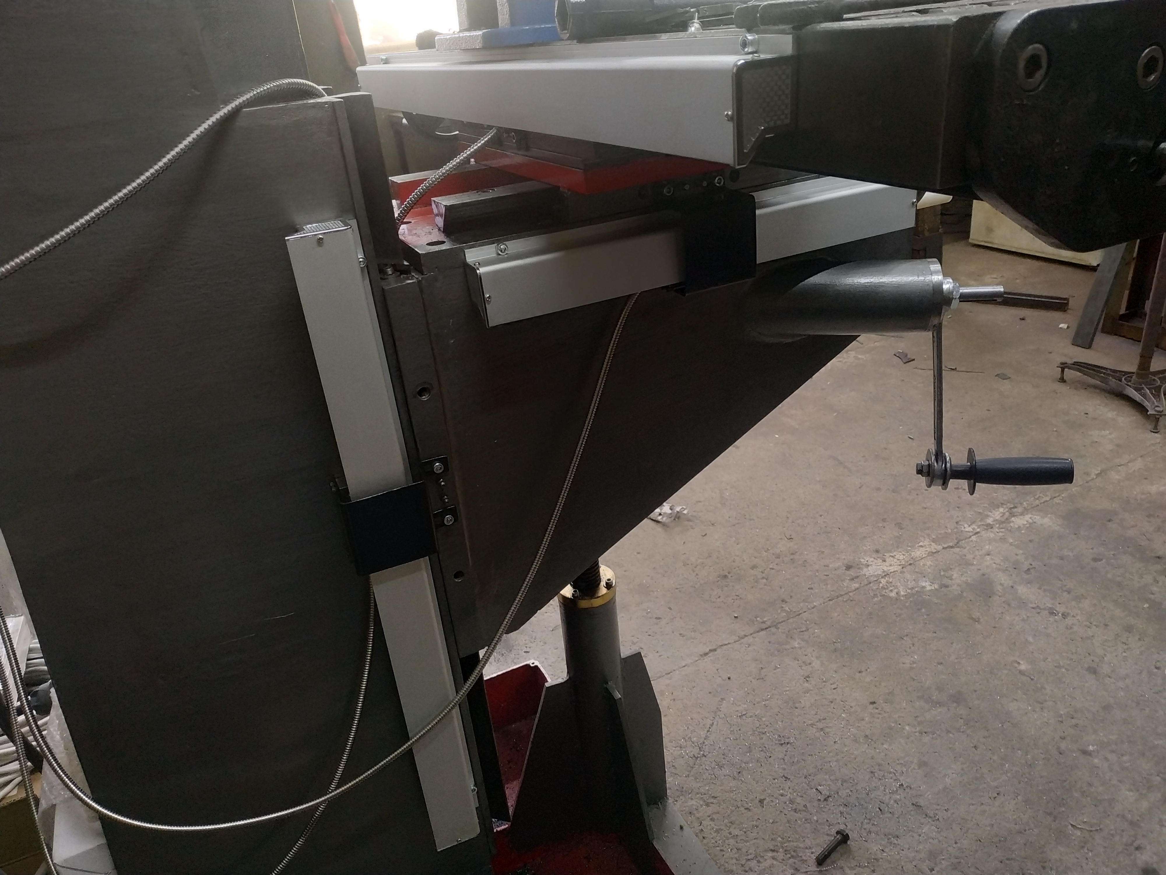

    Still waiting for new lcd screen, meanwhile I installed linear scales with covers.
    I have to find a nice solution for cable managment.

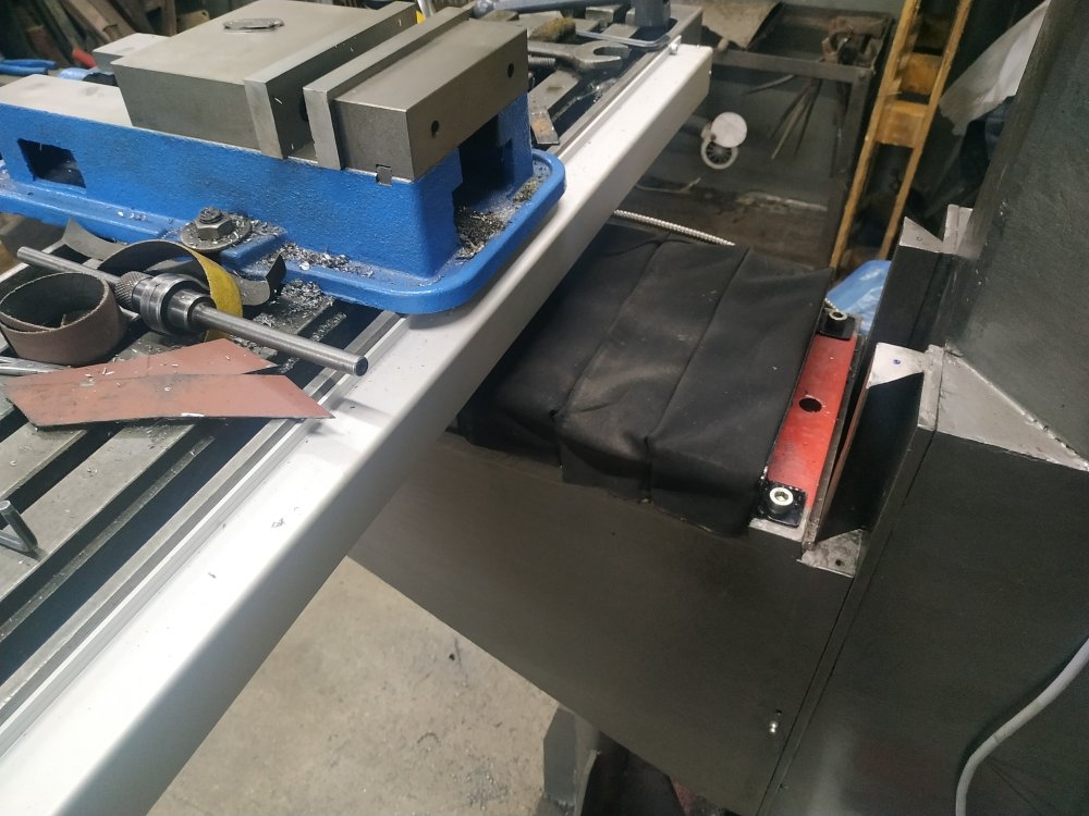

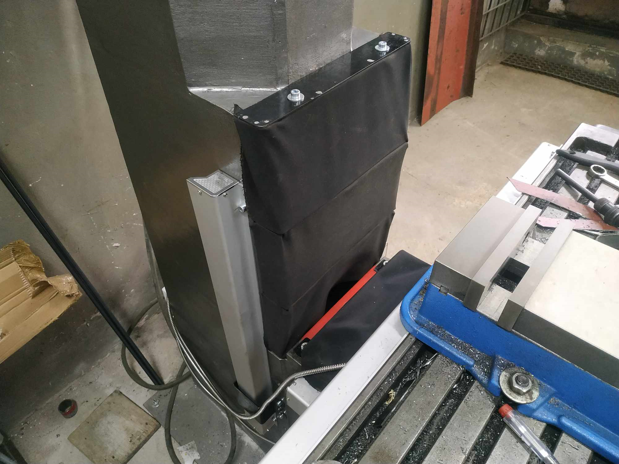

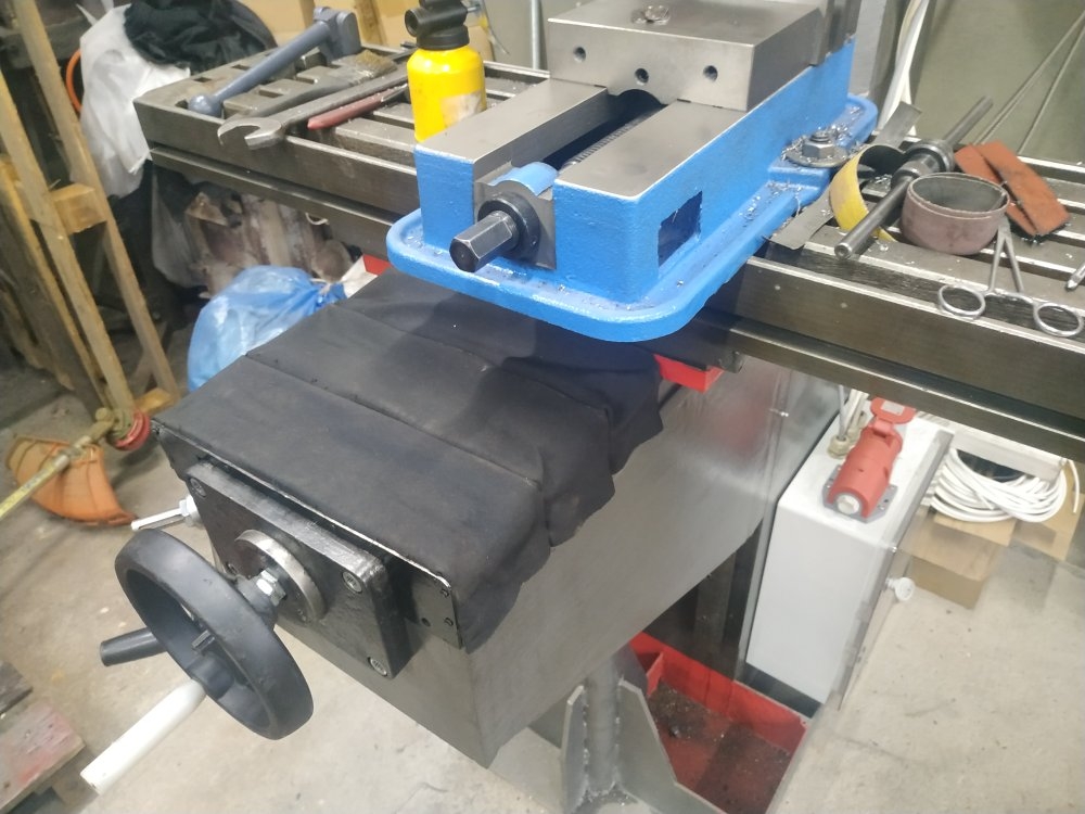

    DIY Y axis covers made out of waterproof fabric. Sections of the covers have dove tail matching plates so they fold nicely.
    I'm going to make the same covers for Z axis guides.

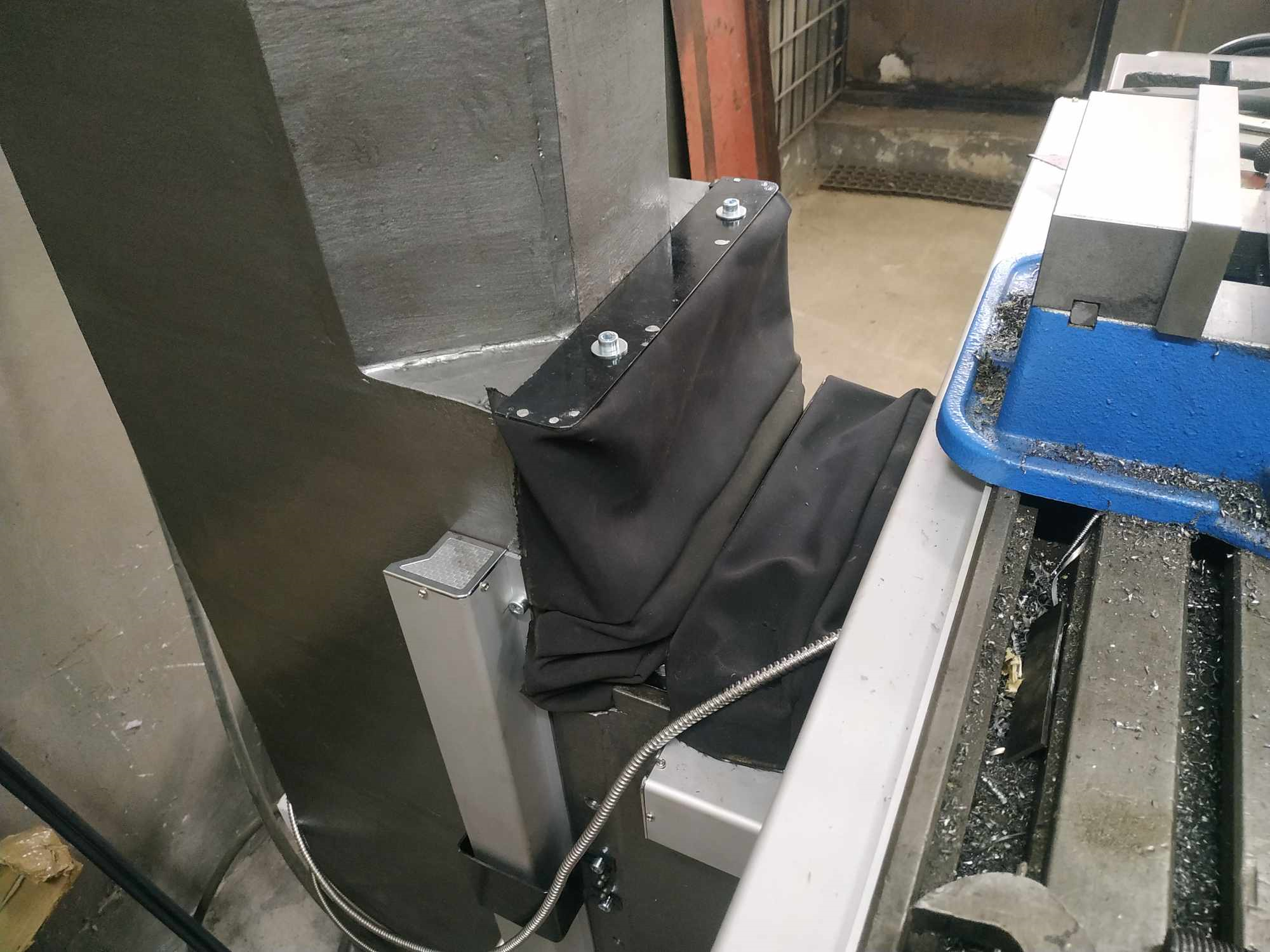

    Z axis cover is done

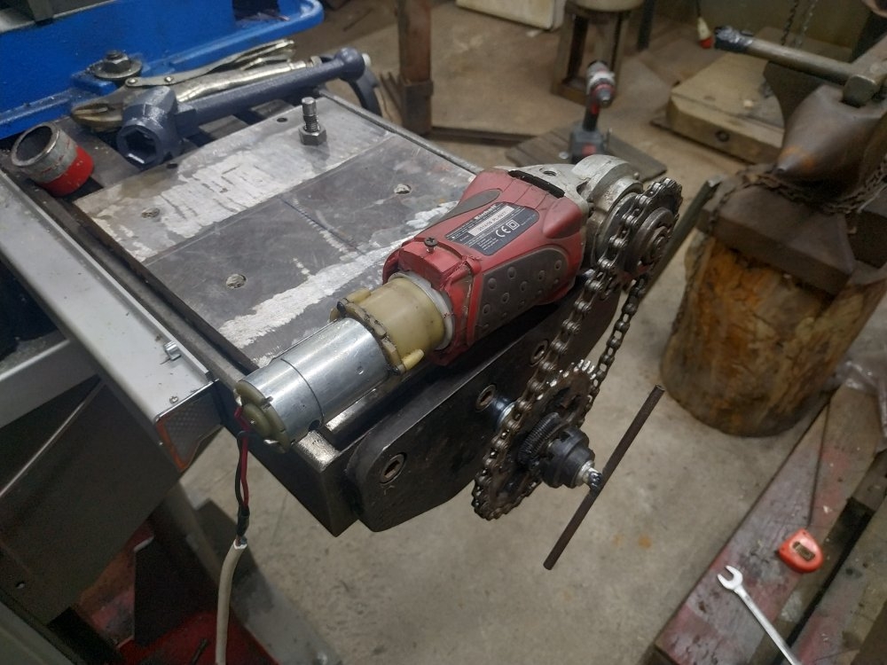

    Temporary X axis power feed from literaly trash. I used motor with planetary gearbox from very very old cordless drill leftovers (20+ years old), to change shaft direction and multiply torque I connected it to gearbox from broken 125 [mm] angle grinder gear box (extra 1:3 reduction ratio) and then I used chain and sprockets from bike I found on junkpile adding 1:2 reduction. The lowest feed rate it can go is 30 [mm/min] and the fastest is 350 [mm/min]. I was testing it a lot, this small 12v motor was barely warm. I will use it until I build proper power feed unit (hopefully before winter)
    I also added very simple clutch made from polyamide (left over from bulding a milling head), it's actuated by m6 screw.
    This improvised power feed unit is controlled by PWM controller on panel from previous video. That's why I put there XT90 connectors. I can change direction with 3 position switch, set the feed rate and use fast travel function.
    Cost? 3 hours of figuring out how to connect all those things, 1 hours of making it and 4 bolts to put everything together
