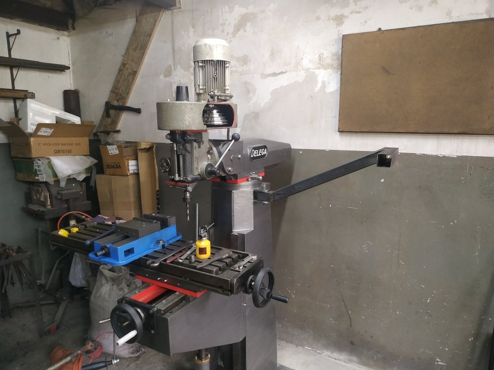

Ofcourse project continues:

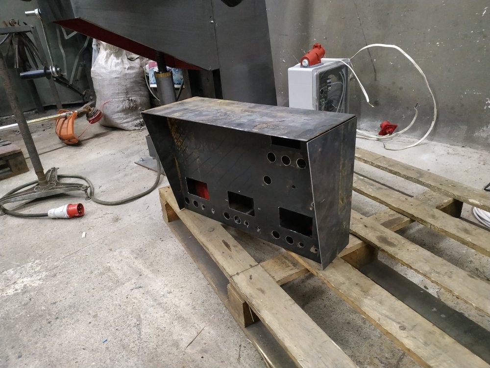

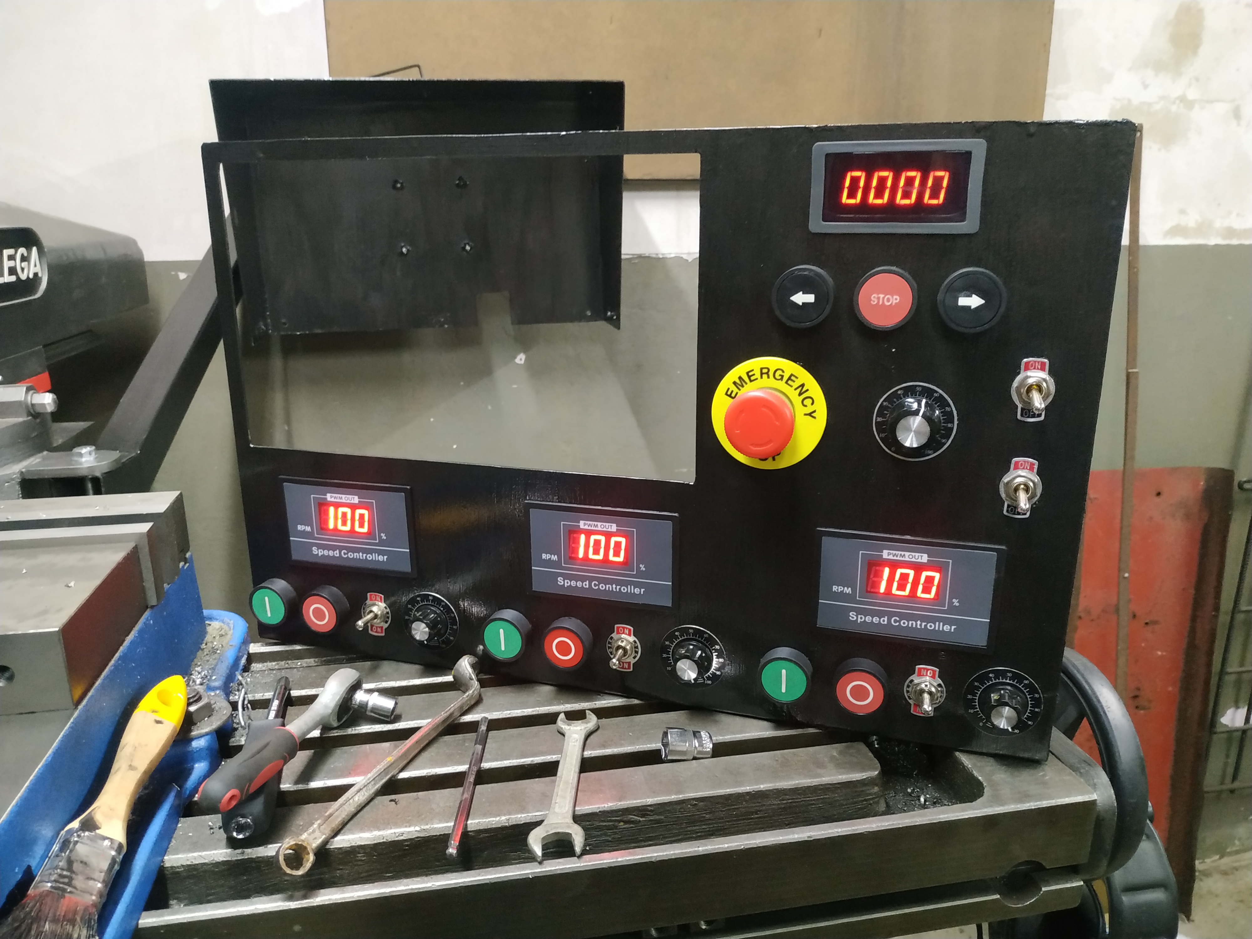

Currently I'm working on control panel for my milling machine.
Swivel arm is made from 50x50x2 [mm] square tube:
Attachment 47693
Box for electronics and switches is made from 2 [mm] steel sheet (a little bit overkill but I don't like when whole thing bends while pushing the buttons):
Attachment 47694
This big area in the left corner is left for DRO lcd screen. I won't cut it untill I buy one. Cutting too big window would be fatal failure for apperance of whole thing.

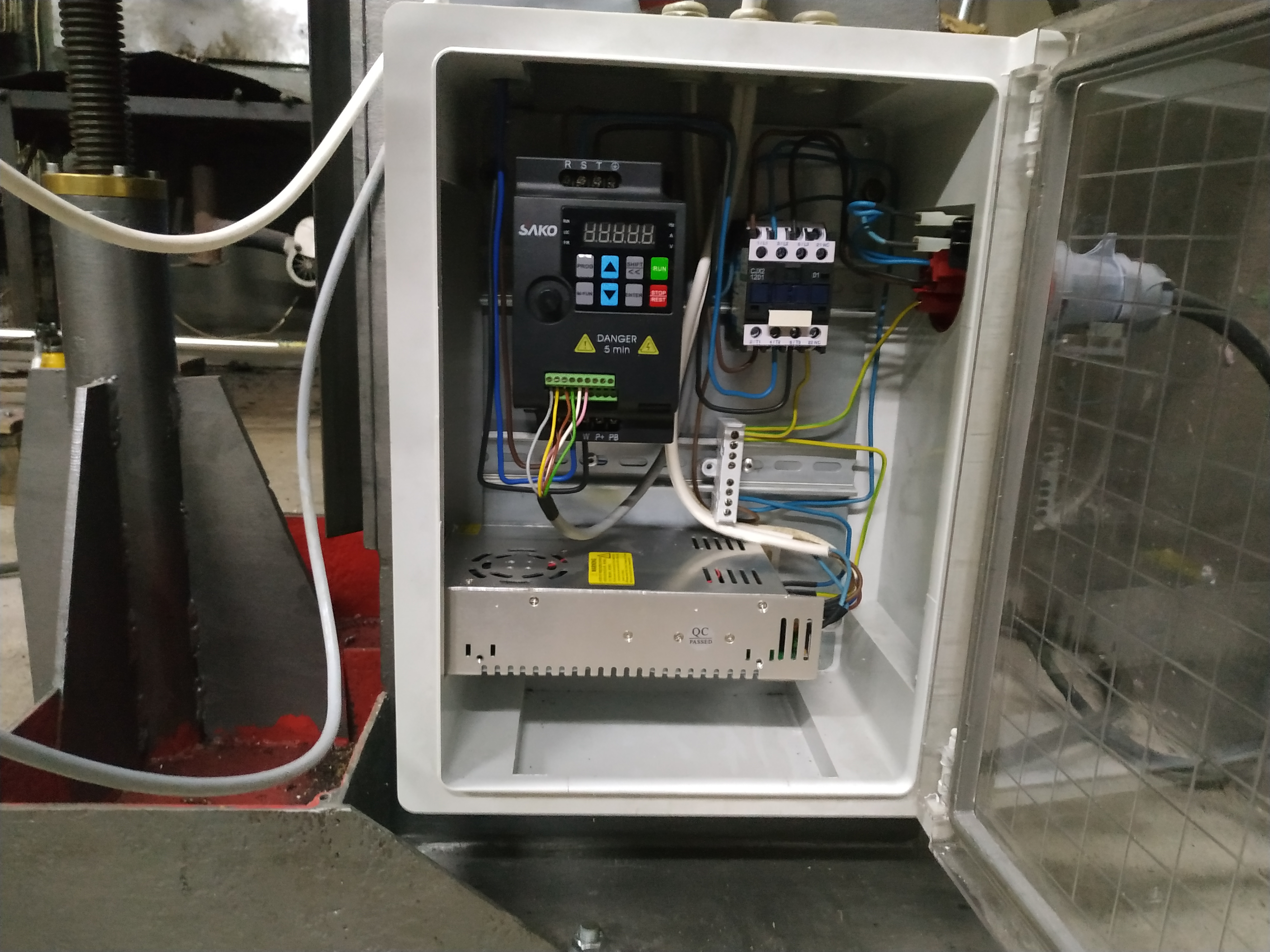

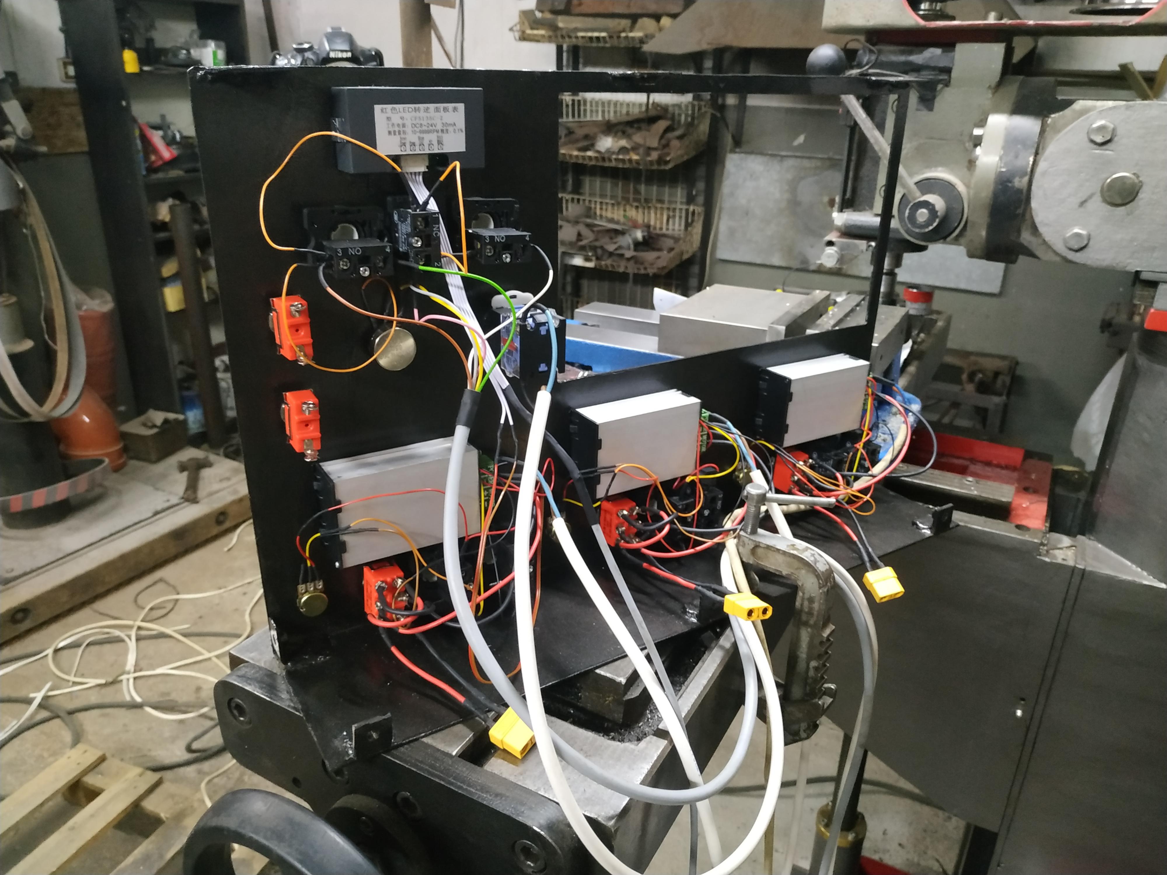

3 Attachment(s)
I did some wiring in control panel. I also bought DRO but lcd screen got damaged during transport and now I'm waiting for screen replacement.
Attachment 47810
Attachment 47812
Attachment 47811

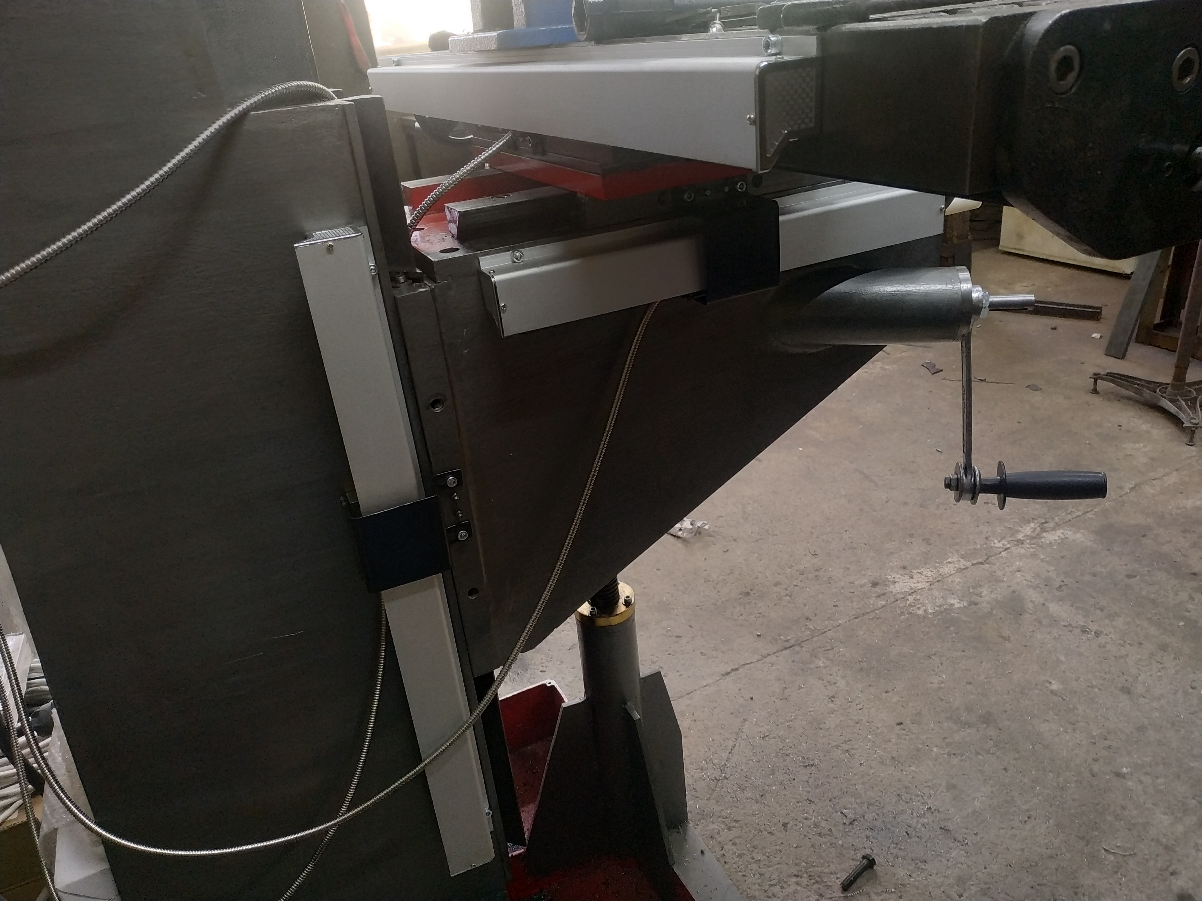

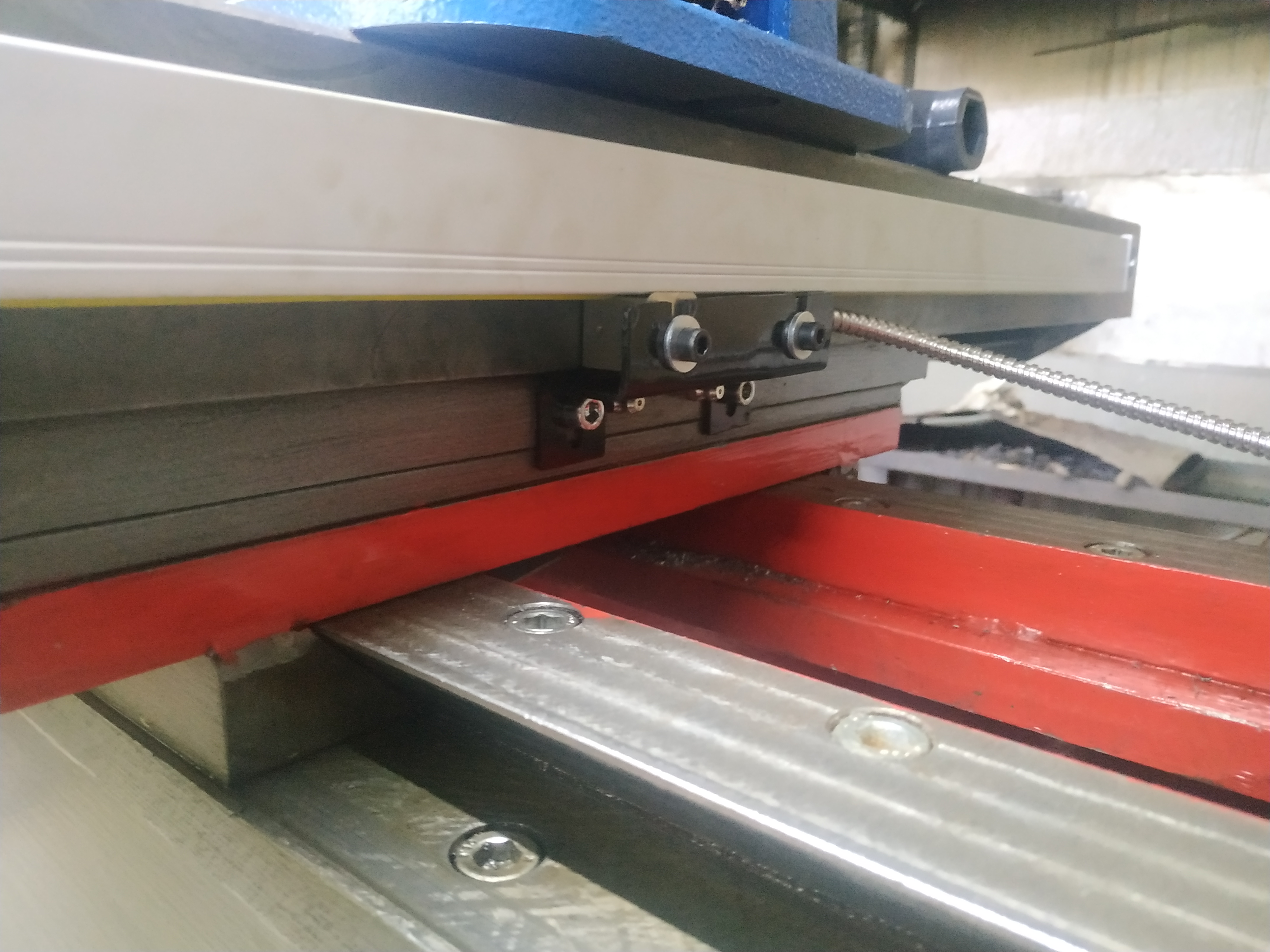

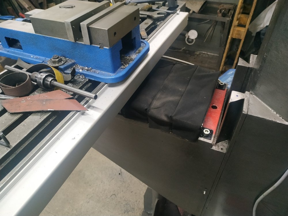

2 Attachment(s)
Still waiting for new lcd screen, meanwhile I installed linear scales with covers.
Attachment 47831
Attachment 47832
I have to find a nice solution for cable managment.
These are going to be great additions. The linear scales will allow easier milling work.

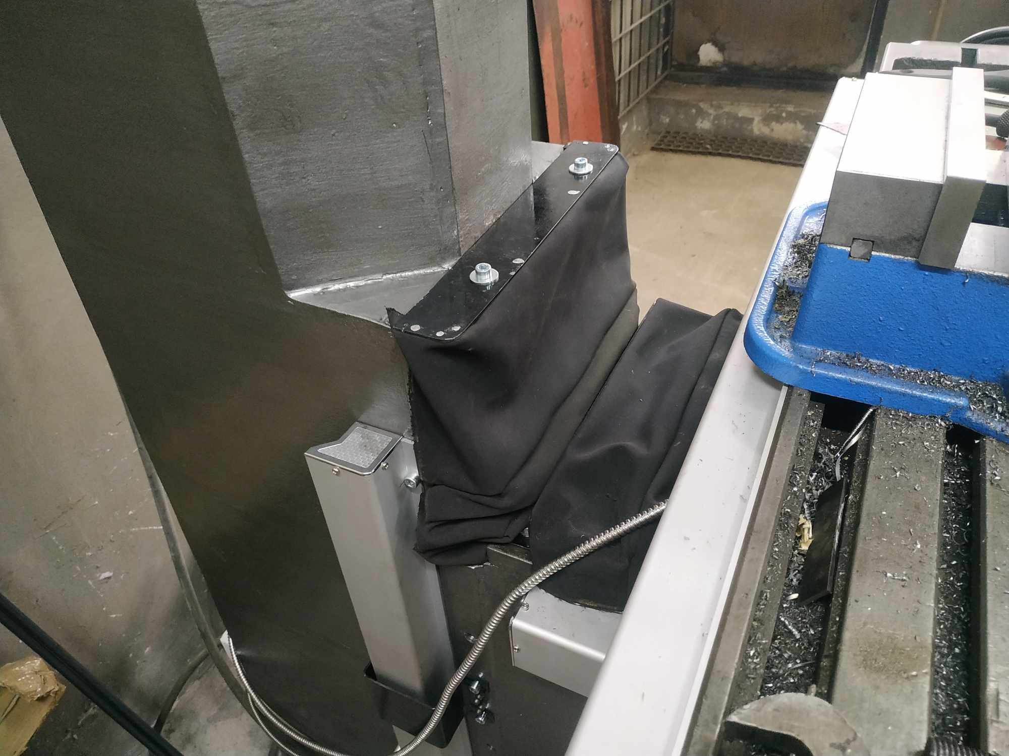

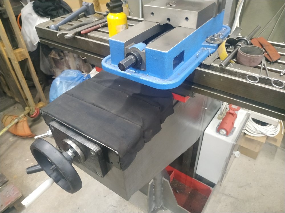

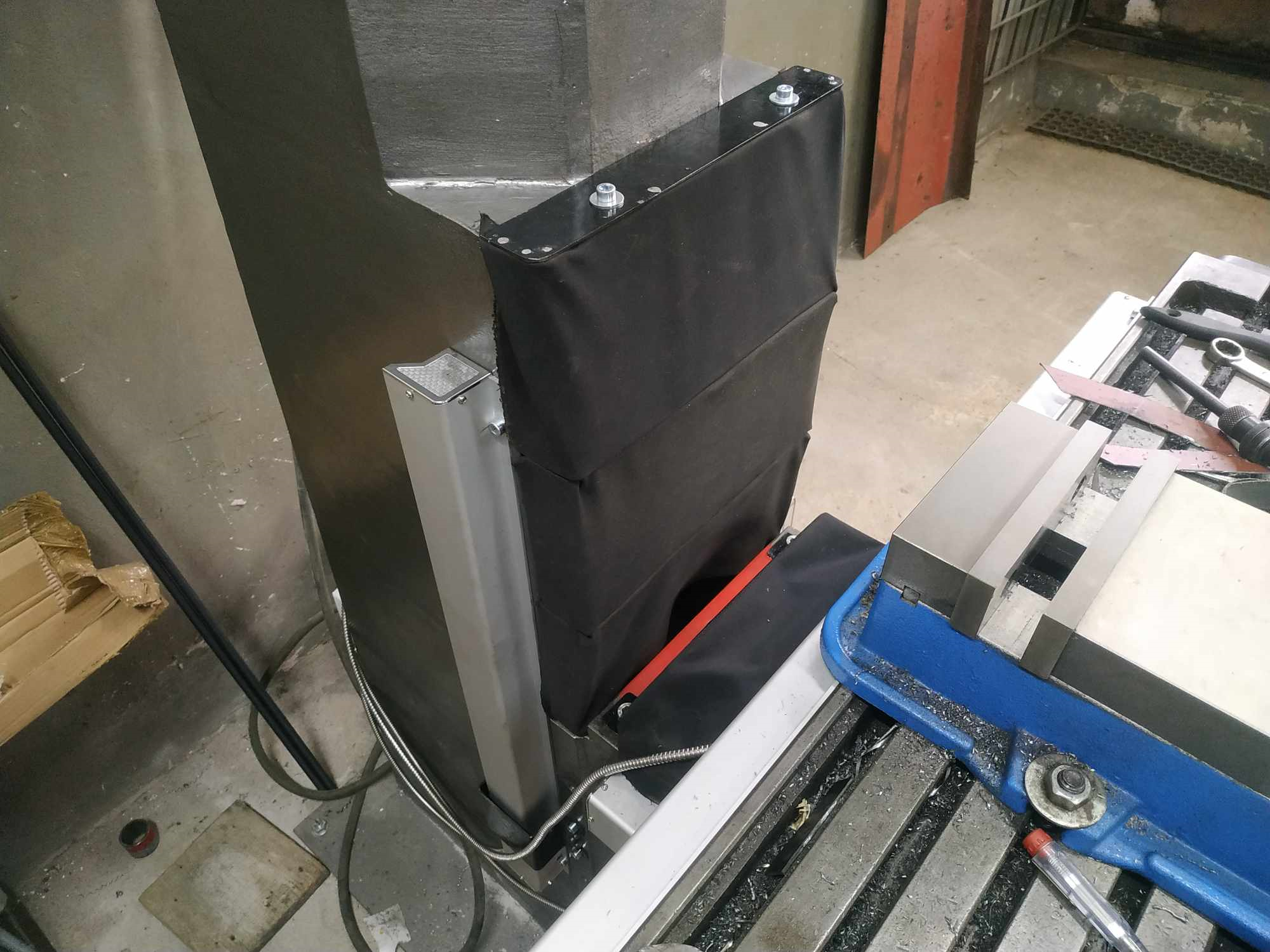

2 Attachment(s)
DIY Y axis covers made out of waterproof fabric. Sections of the covers have dove tail matching plates so they fold nicely.
Attachment 47856
Attachment 47857
I'm going to make the same covers for Z axis guides.
