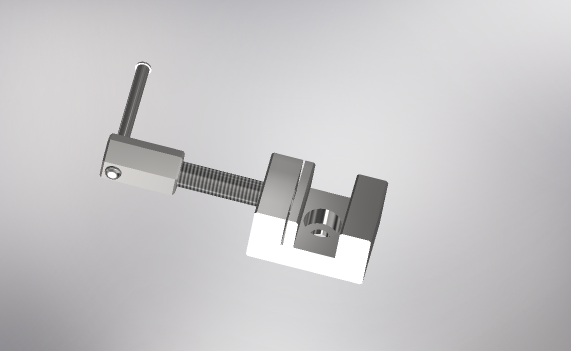

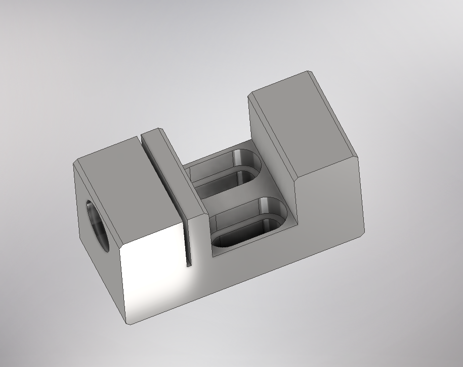

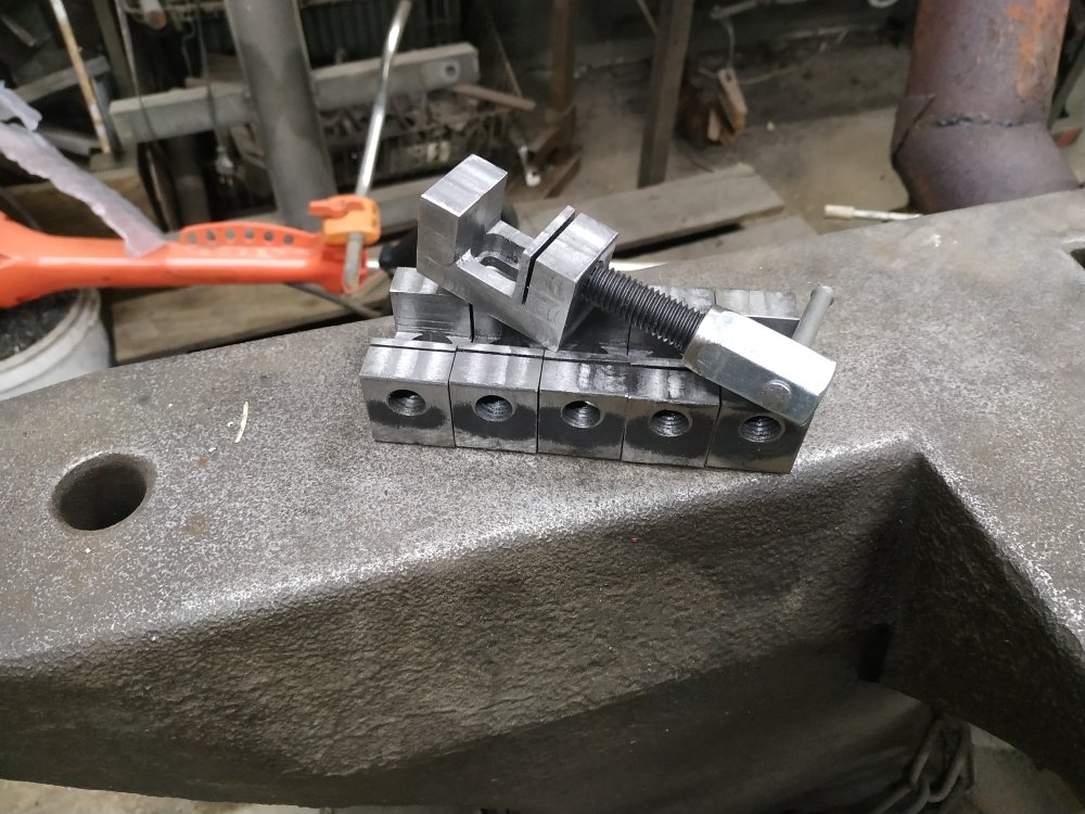

This is how I want to lock them if needed:
Attachment 48329
C block with cut in one wall. This thin piece will bend slightly under pressure of bolt and will clamp around the rail. I think this is much safer for guide surface than using only bolt directly.

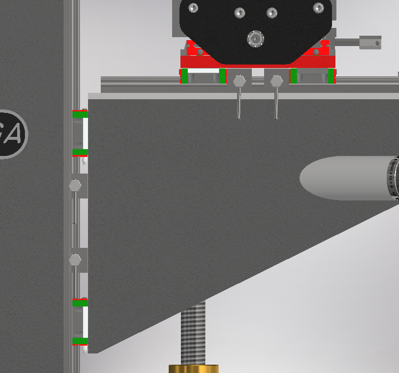

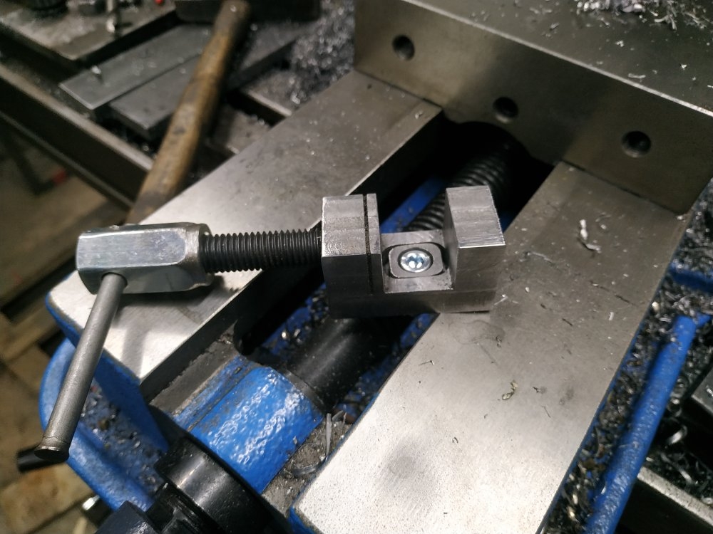

There will be two per axis:
Attachment 48330
Bolts of levers will be shortened if needed.
