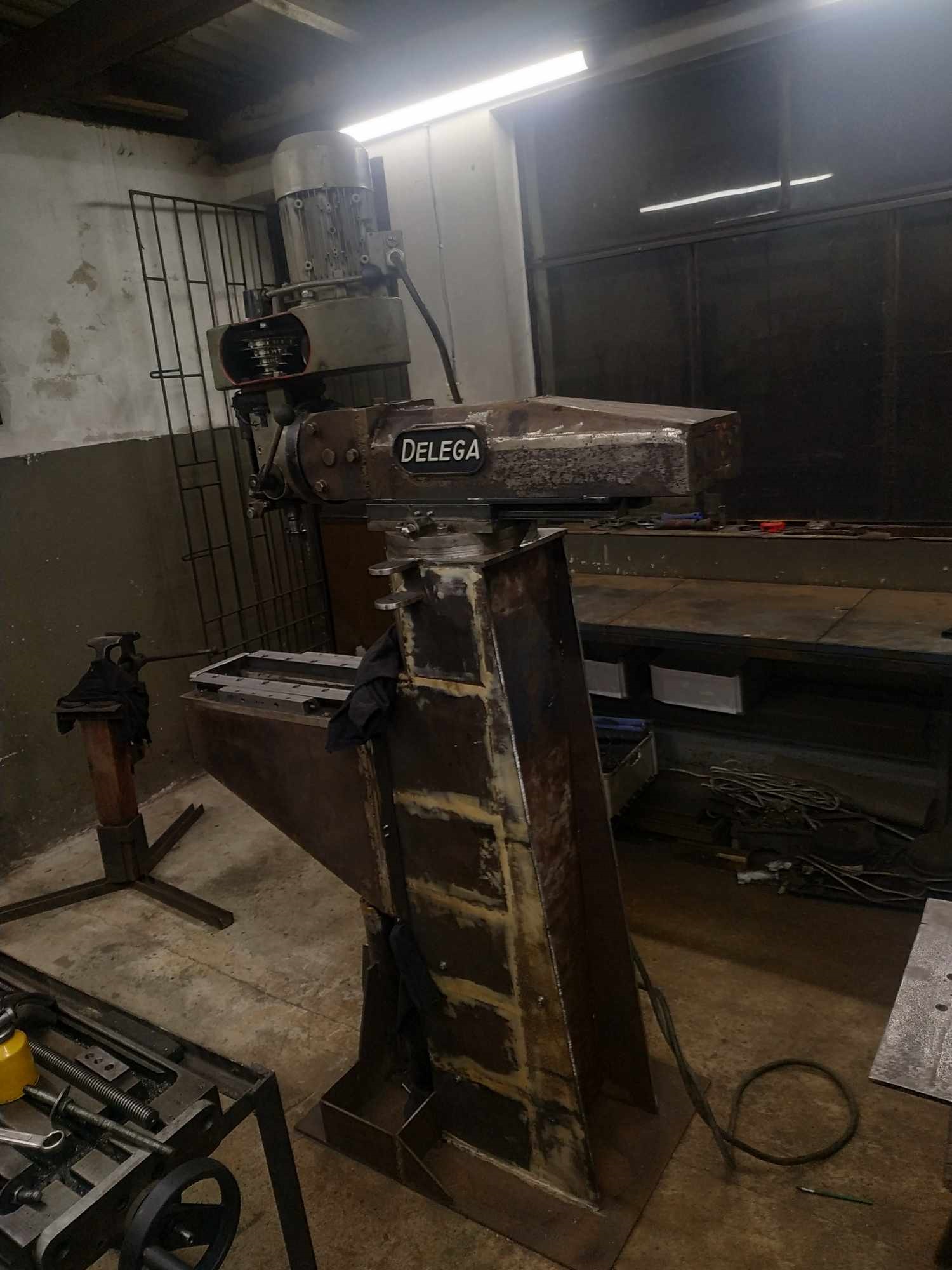

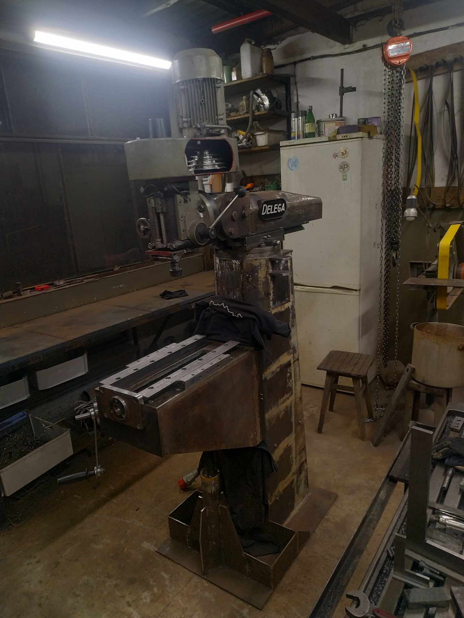

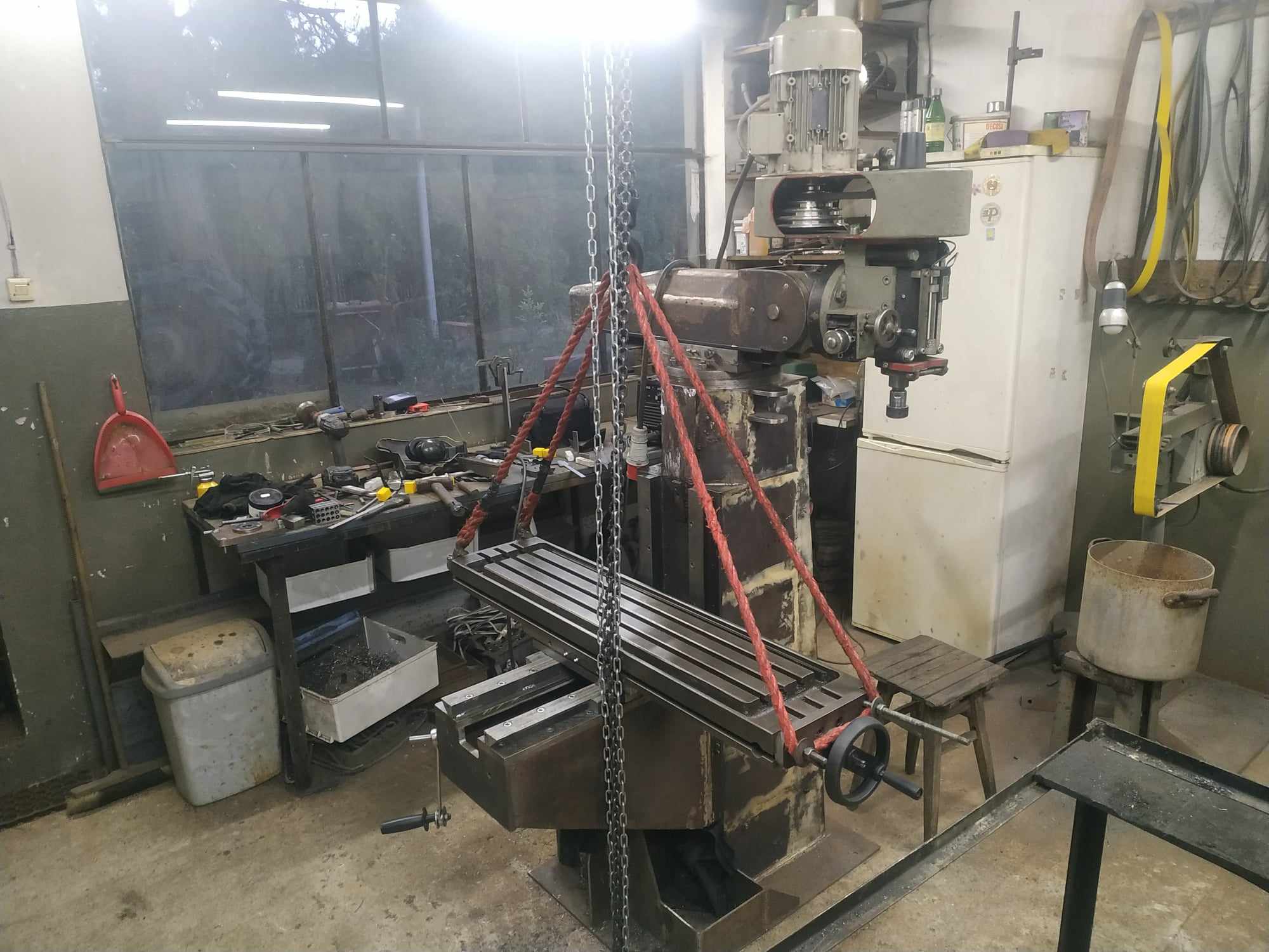

Probably the most spectacular update so far :P It starts to look like milling machine :D
Attachment 47402
Attachment 47403
Attachment 47404
Attachment 47405
Video soon!

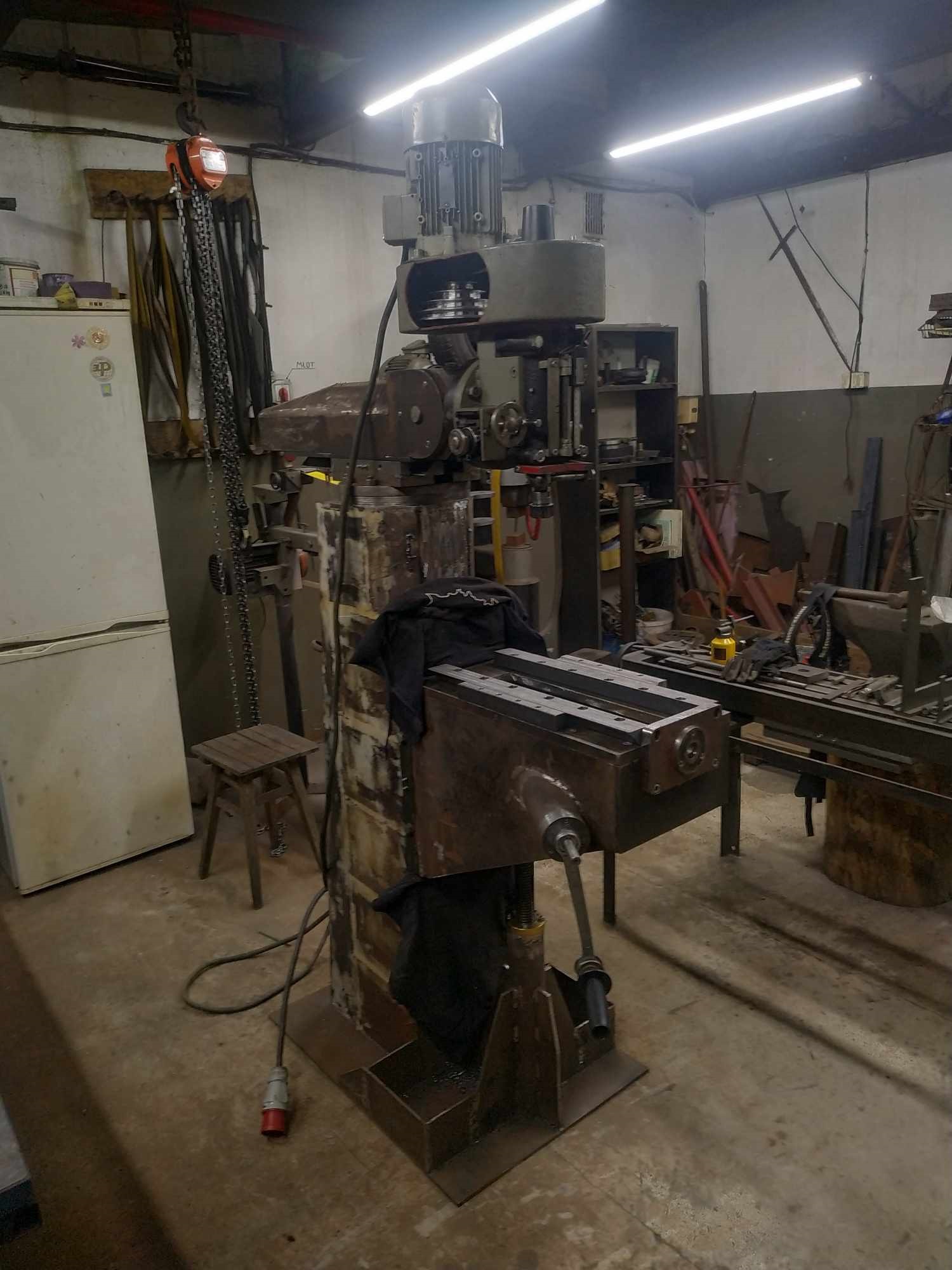

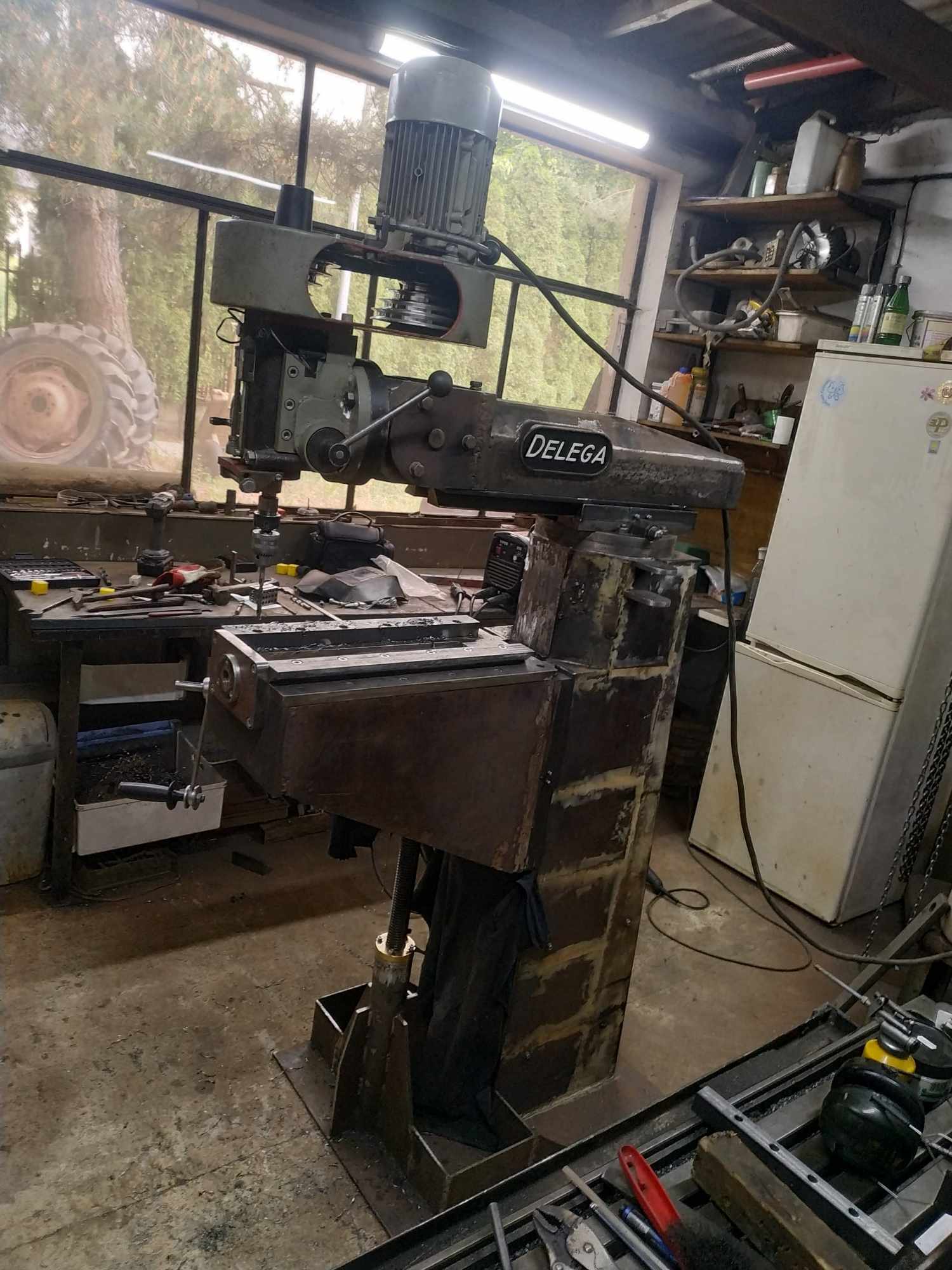

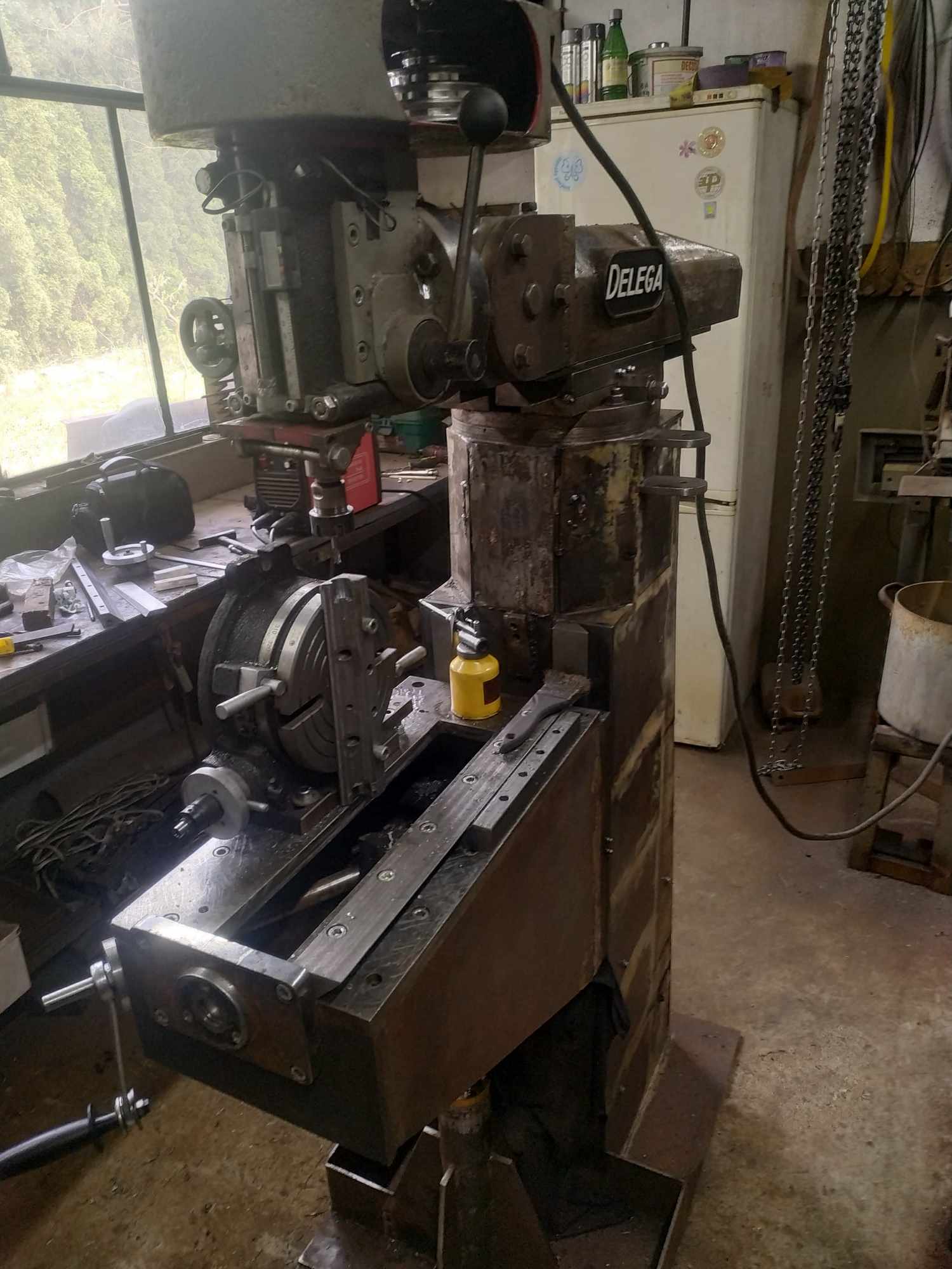

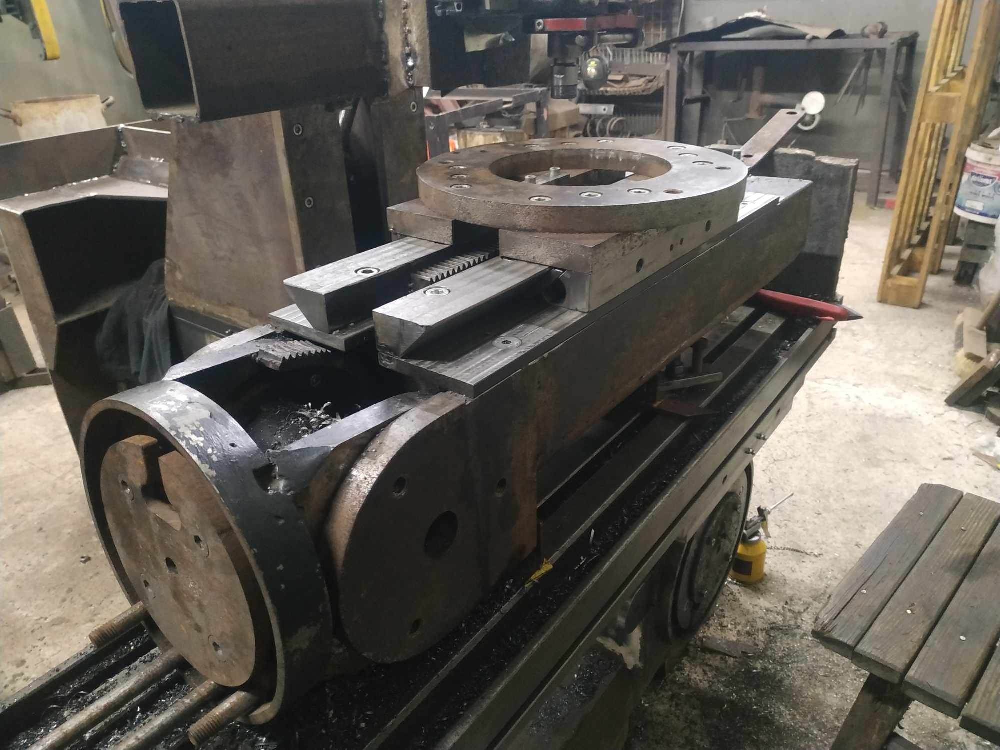

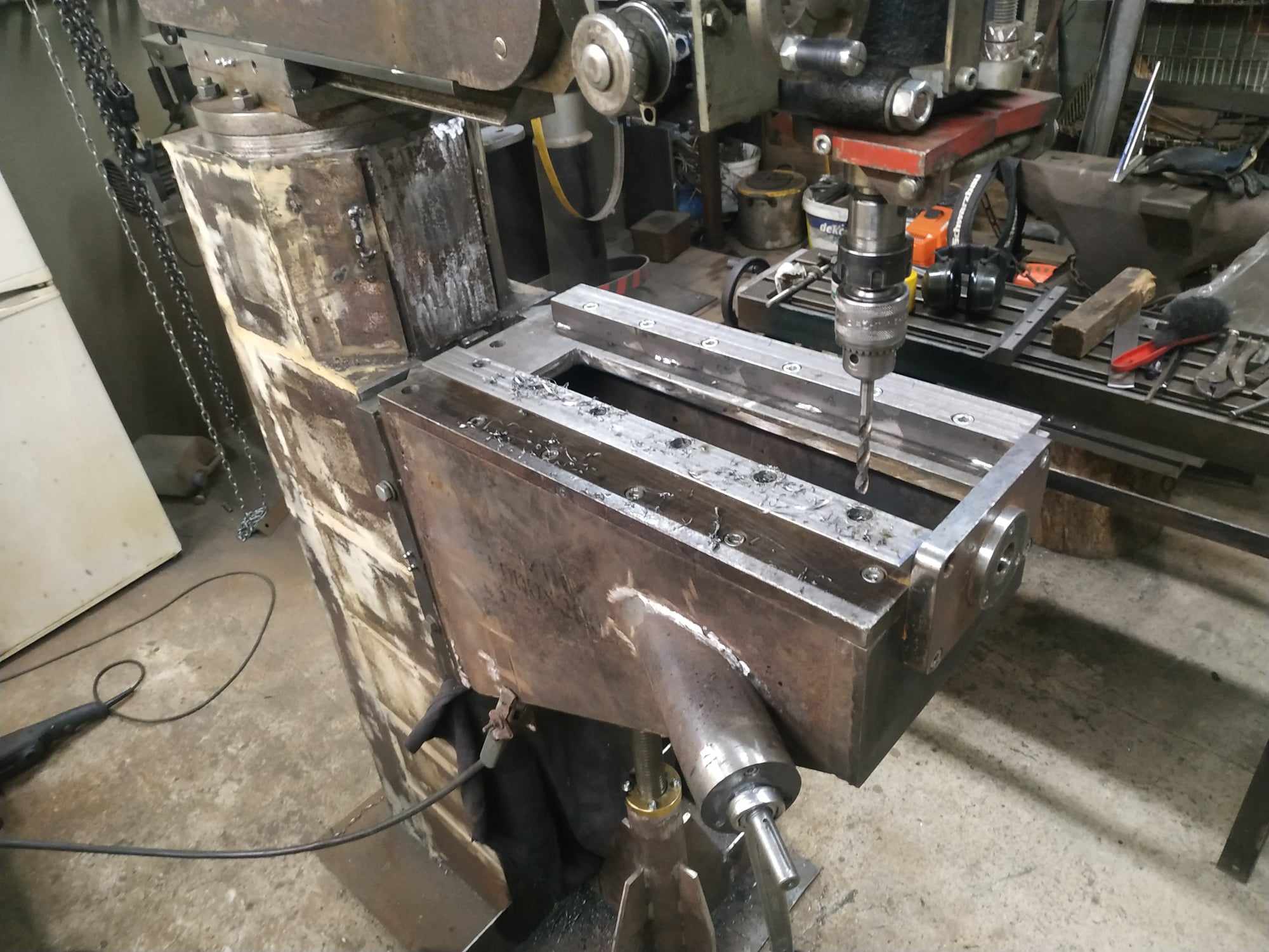

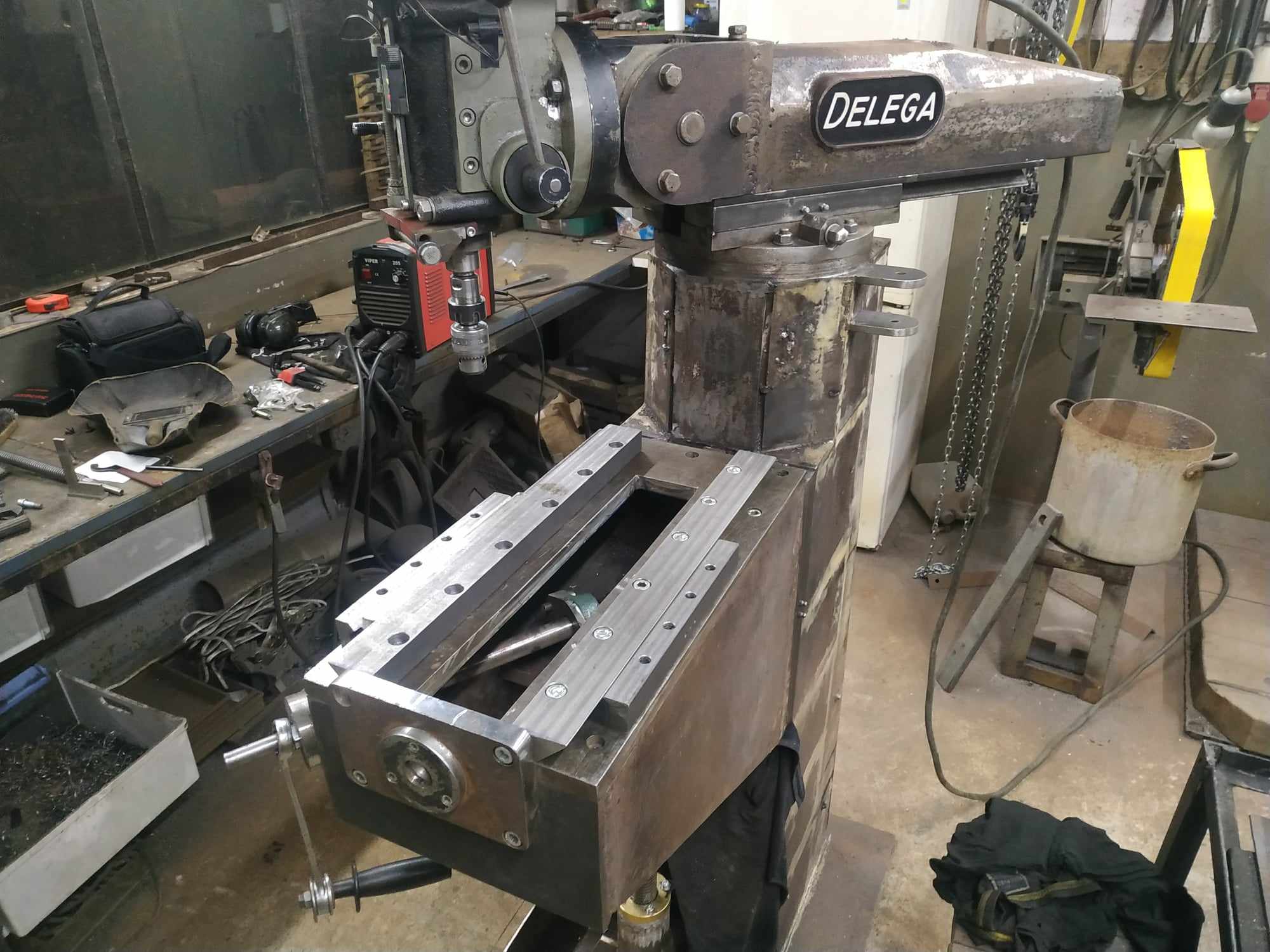

Since last video, I drilled holes for Y axis guides. Drilling with rotary turret was fun. I was like radial drilling machine. Squarness was set to Z axis flat guides using 1-2-3 blocks and machinist square - it's the best I could do.
Attachment 47514
Attachment 47515
Attachment 47516
I made flat bottom countersunks for gib setscrews by plunge milling.

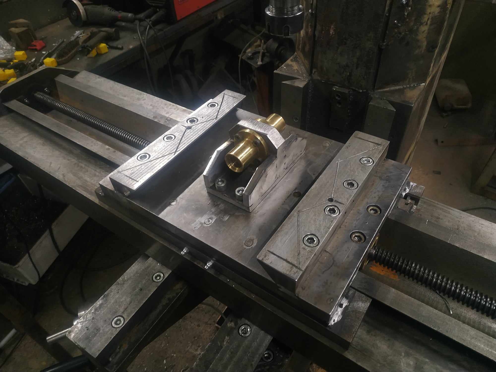

This is bracket with leadscrew nuts

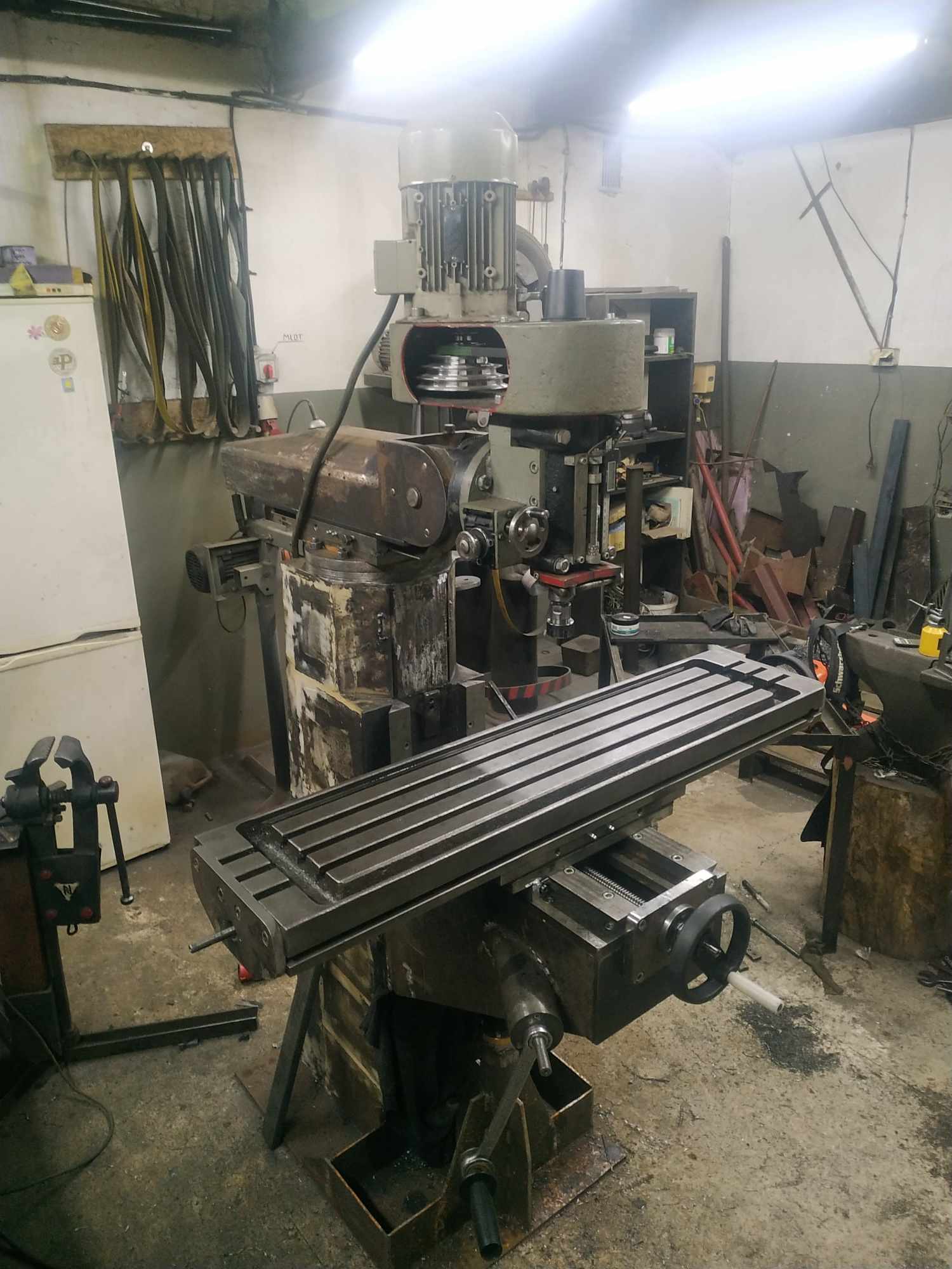

Assembled milling machine.
Attachment 47520
Attachment 47521
There is still a lot of things to do so stay tuned ;)

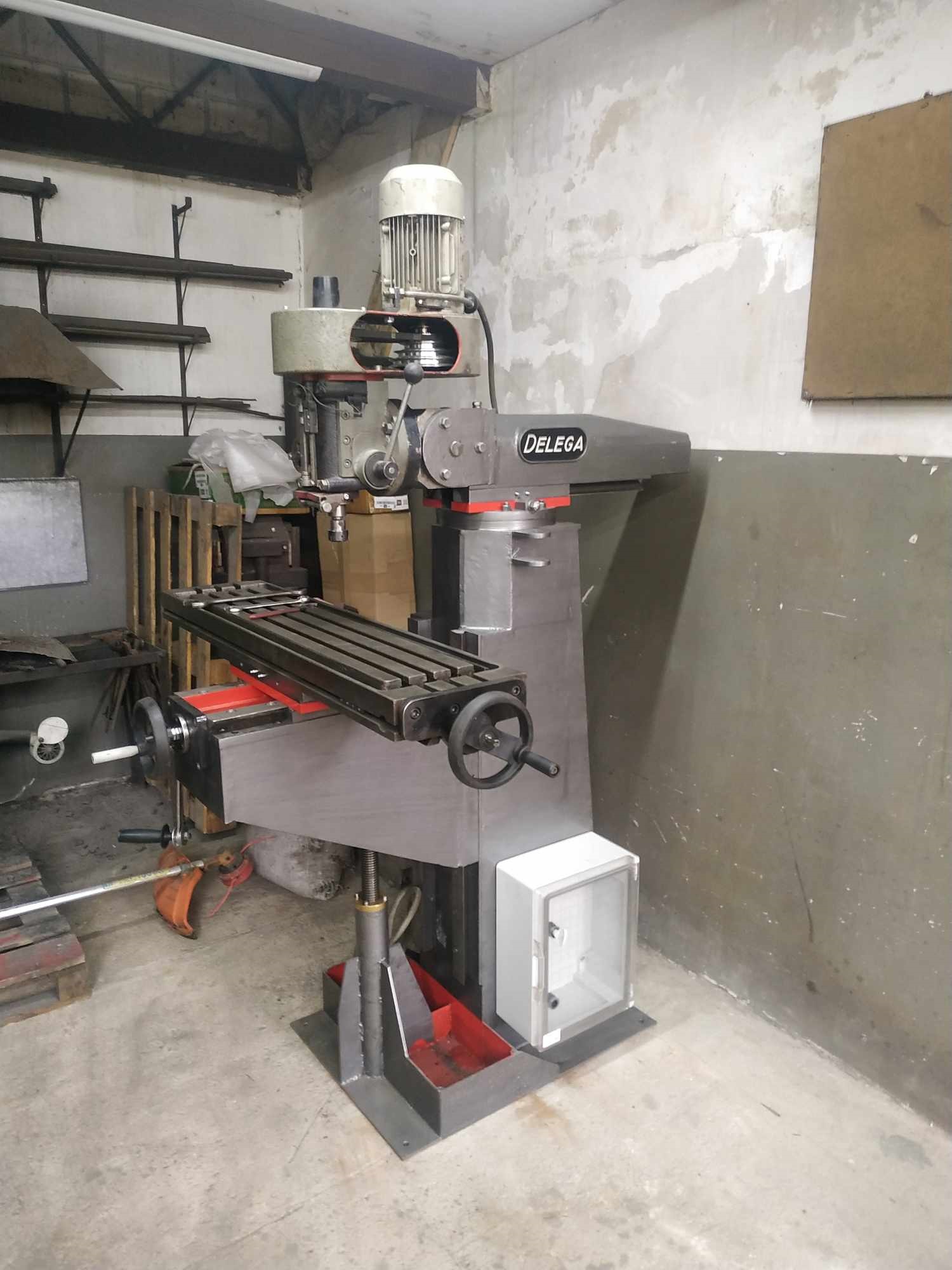

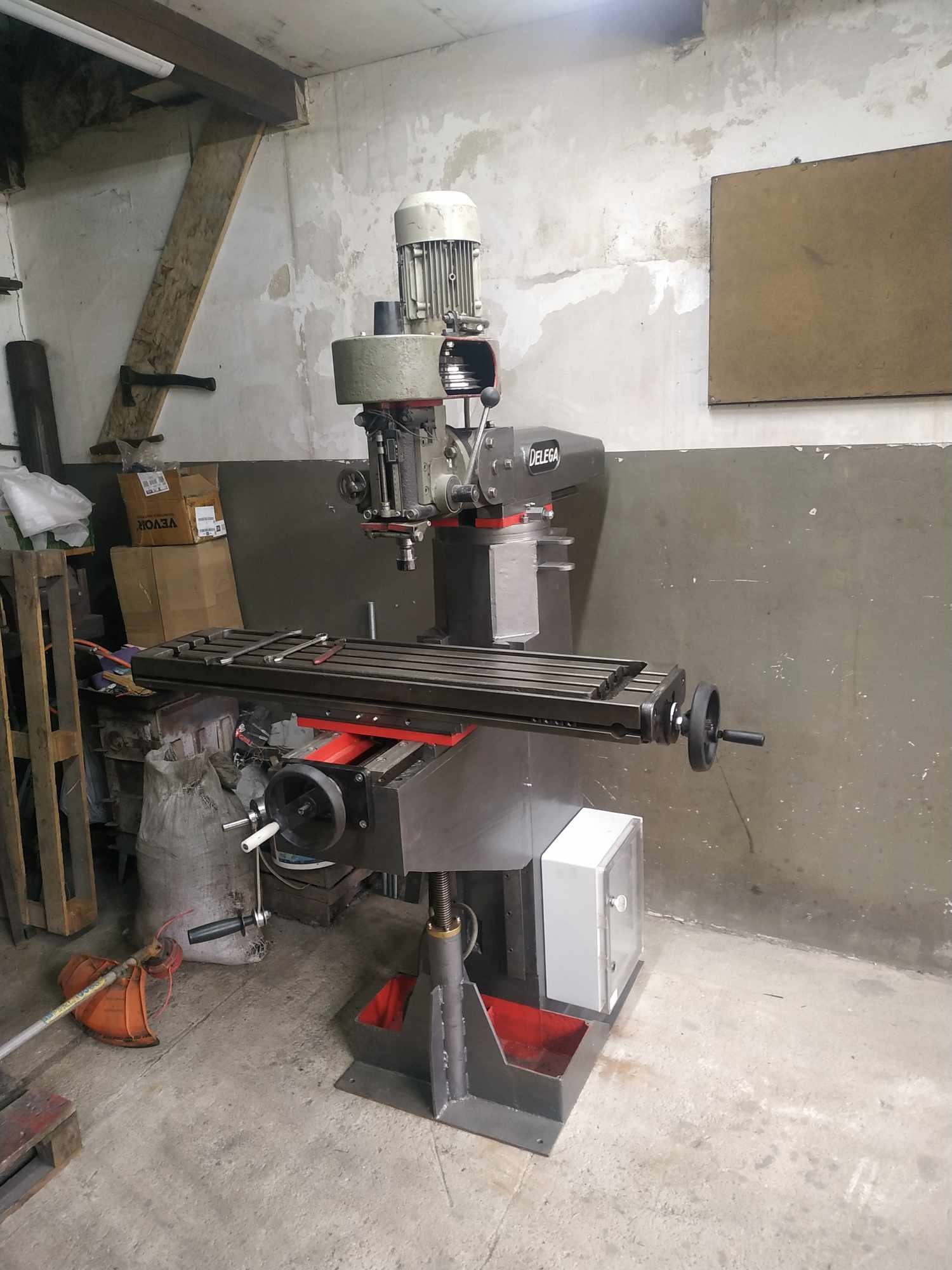

Painted. On final position.
Attachment 47618Attachment 47619
Milling head will be improved and painted later.

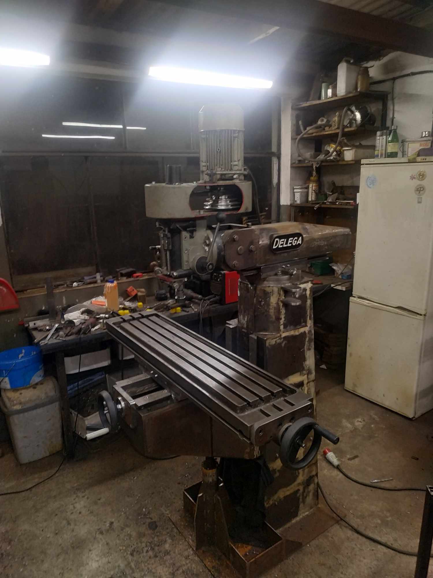

I paid about $500 for my 49x9, I couldnot of built it for 3x that. good work. if it has a harmonic you may be able to fill some portions of it to dampen it.
Whole column is filled with compacted sand. Should work fine. New video soon.
sounds good.just dont let it absorb moisture and start rust growing...
