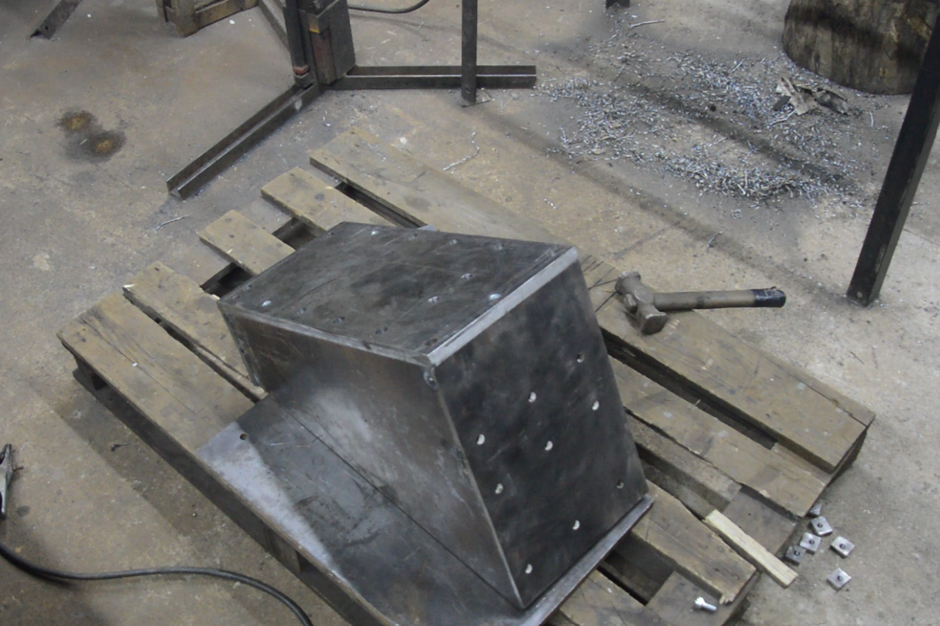

Next part, almost without welding :D
This time I did some actual milling with my milling head.

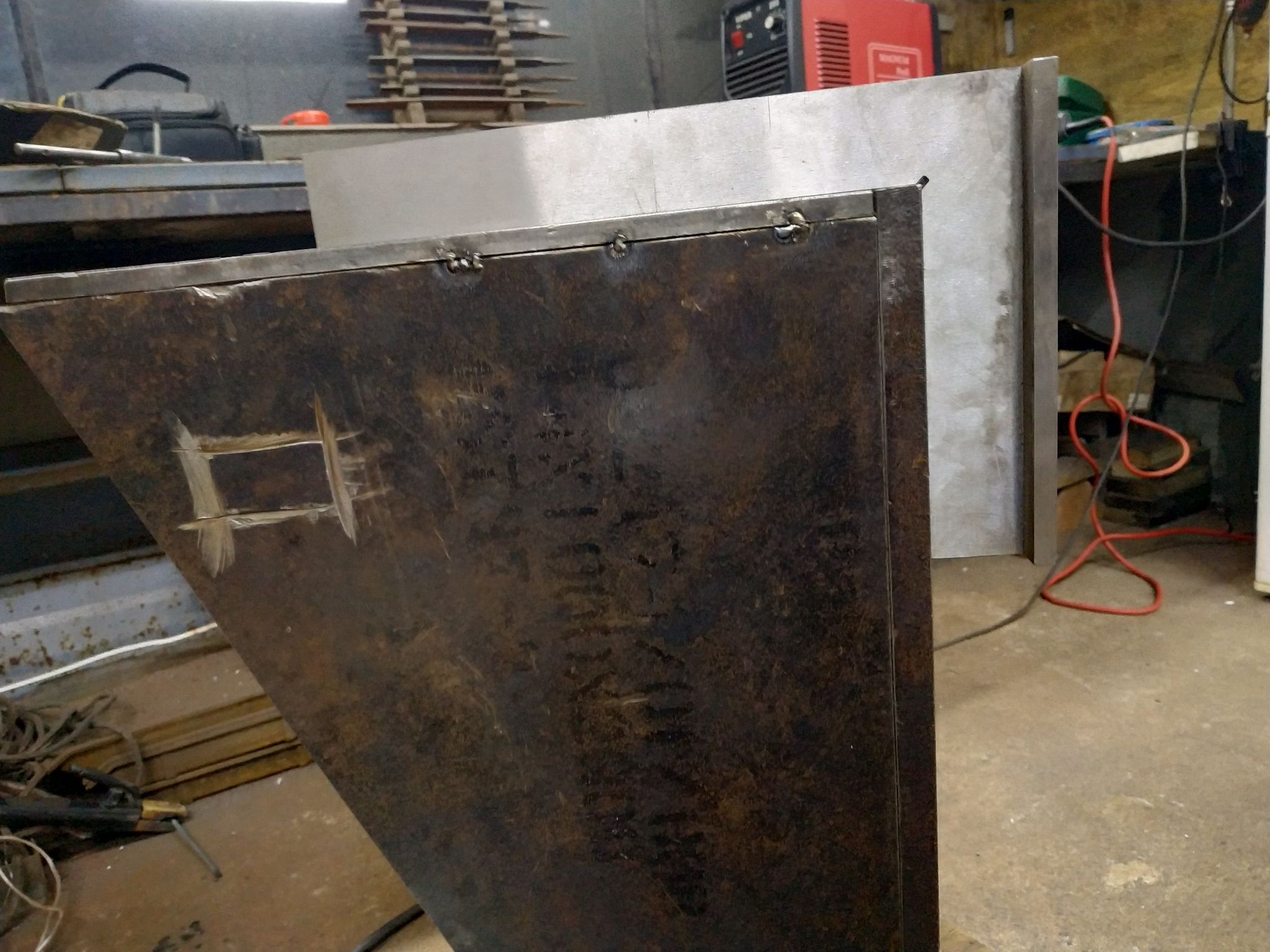

I found nice both side milled 20mm steel plate on junk yard (probably part of some woodworking machine). It was perfect part for the knee of my machine because I had very good reference surface to check squarness.
Attachment 44959Attachment 44960

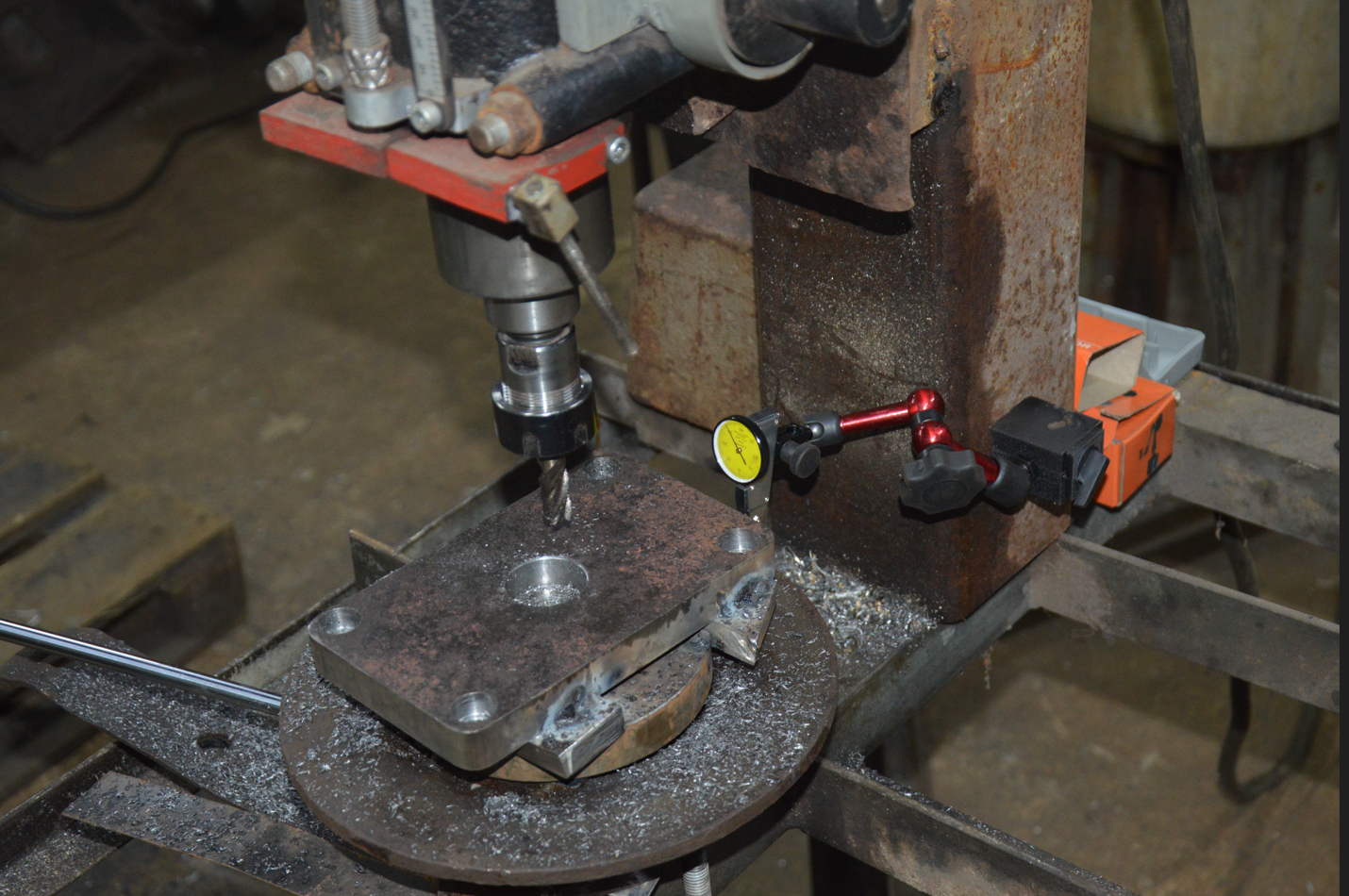

Today I made bearing block for Y axis leadscrew. This set up is not very rigid but I'm impressed with surface finish I achieved.
