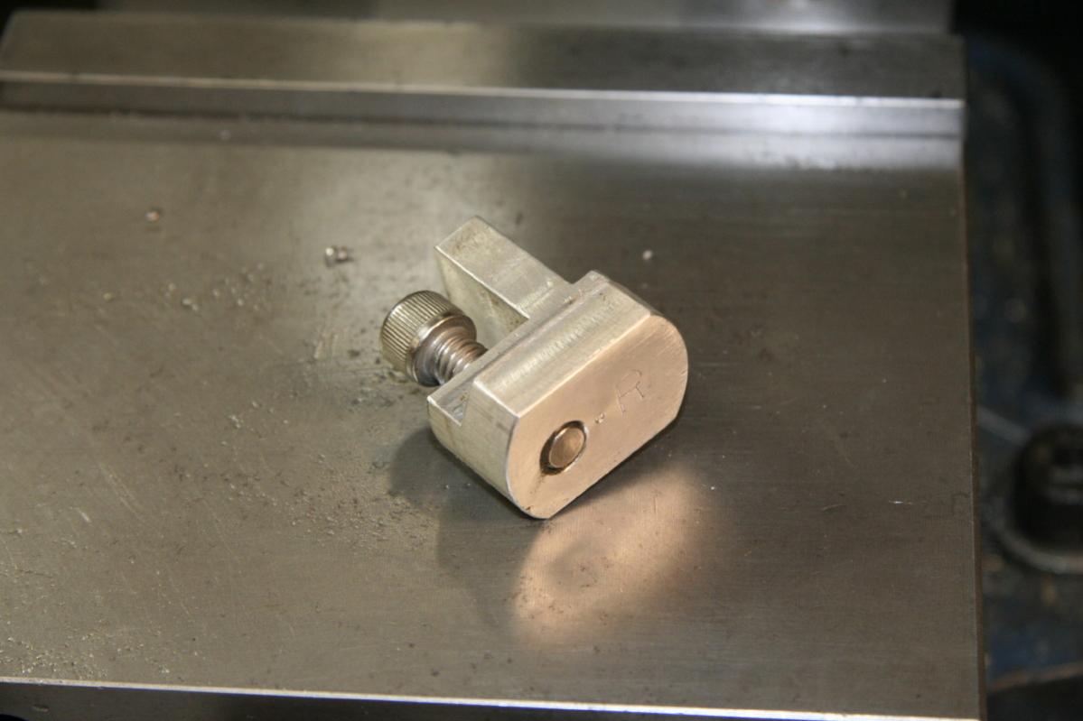

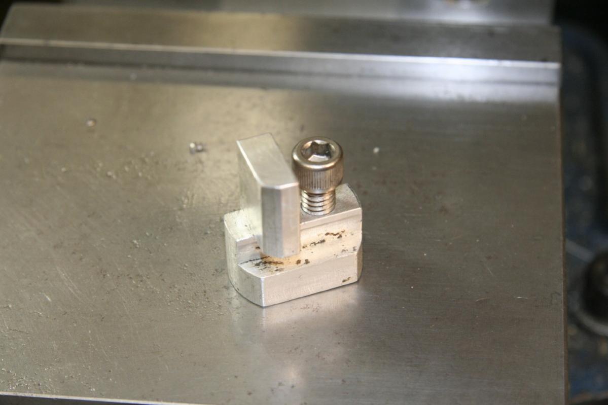

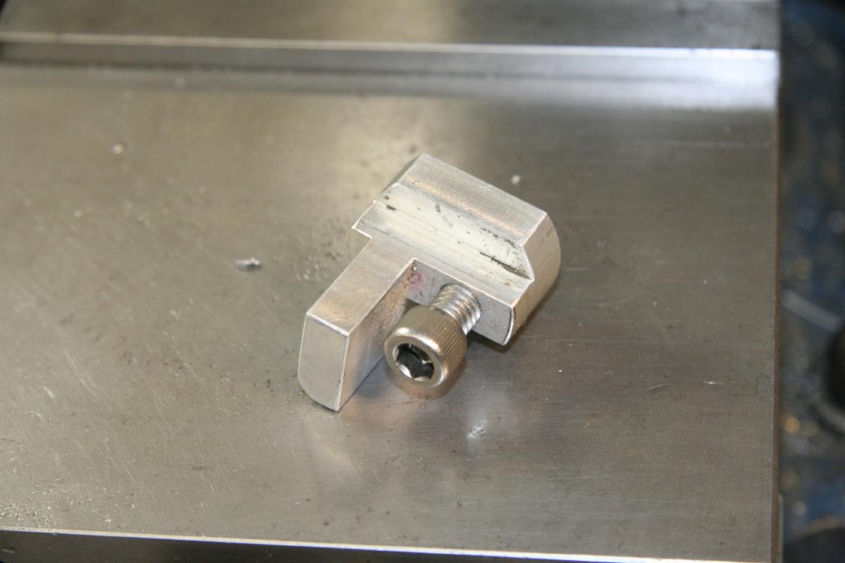

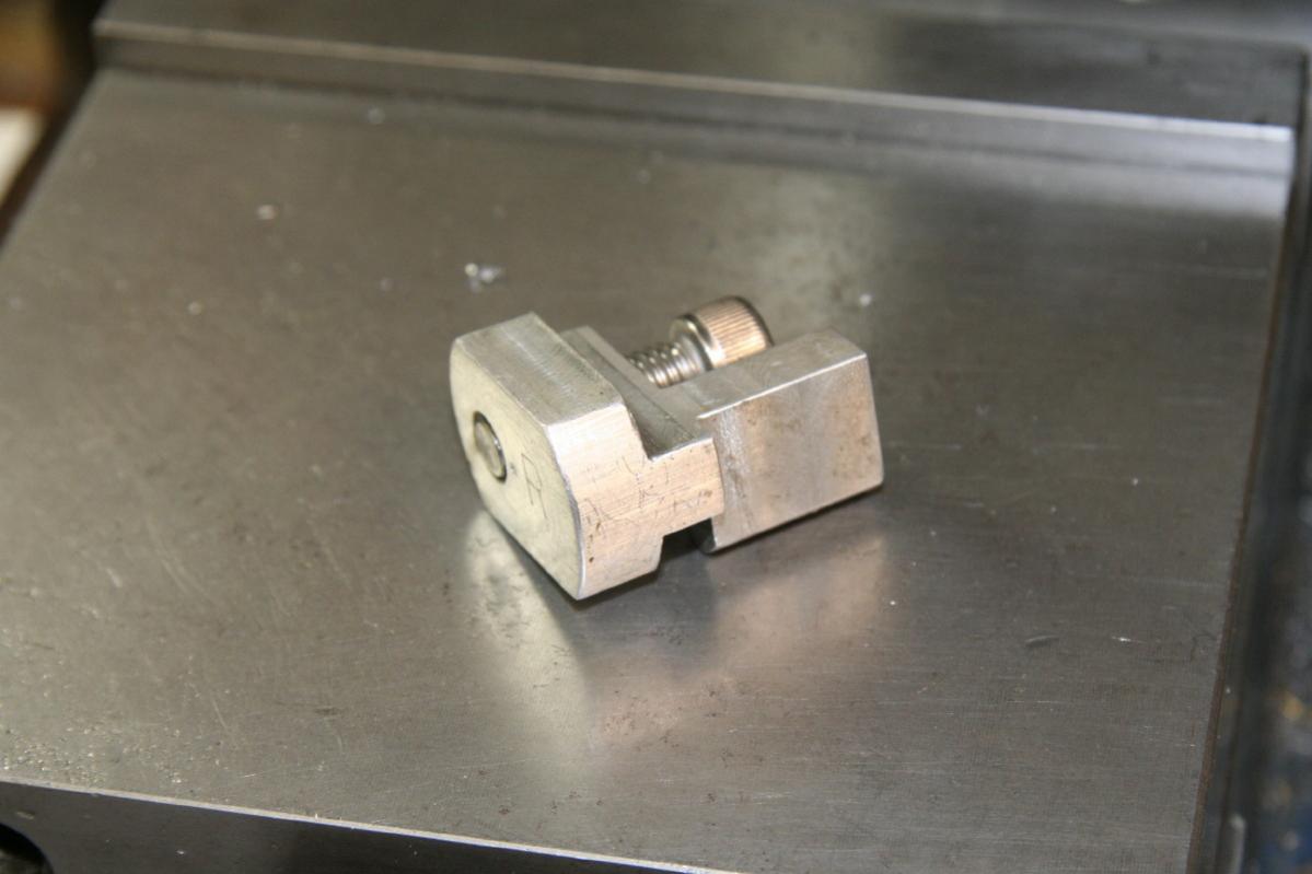

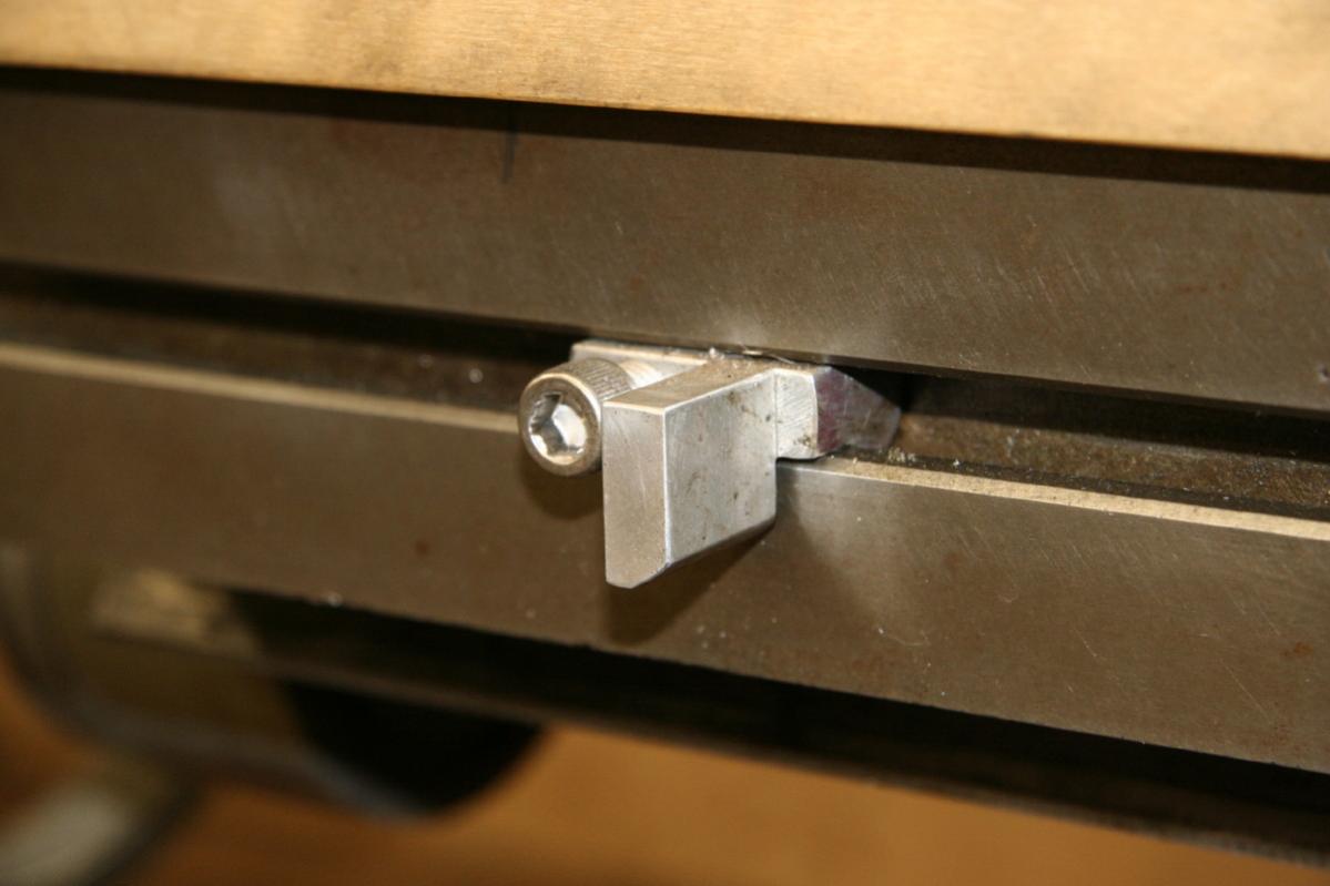

    Milling table feed stops made from 6061 Alu. 1-1/4" Dia. one piece with Stainless 5/16-18 SHCS for the lock. one for the Left and Right sides, Mirrored.
