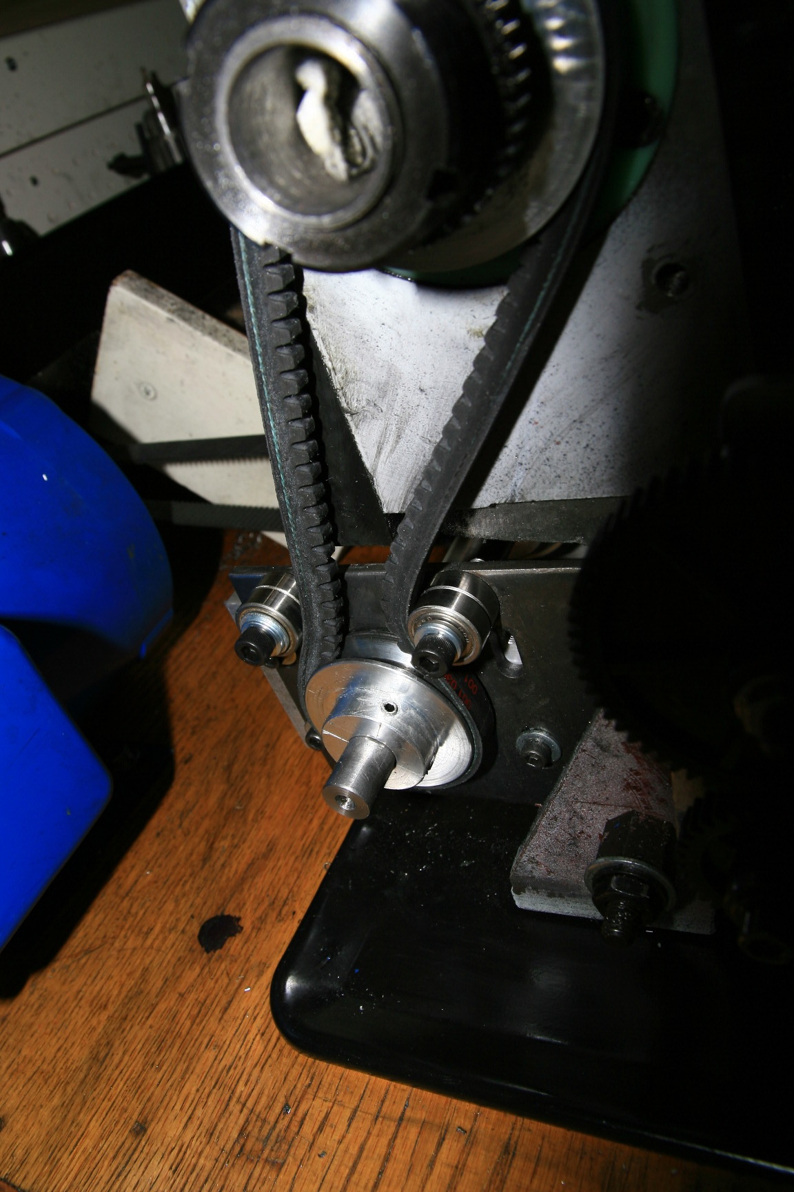

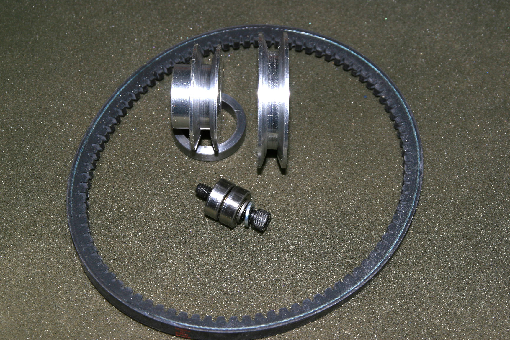

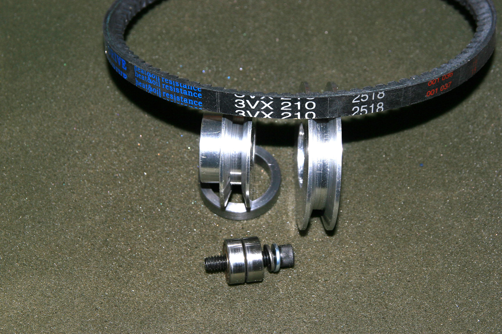

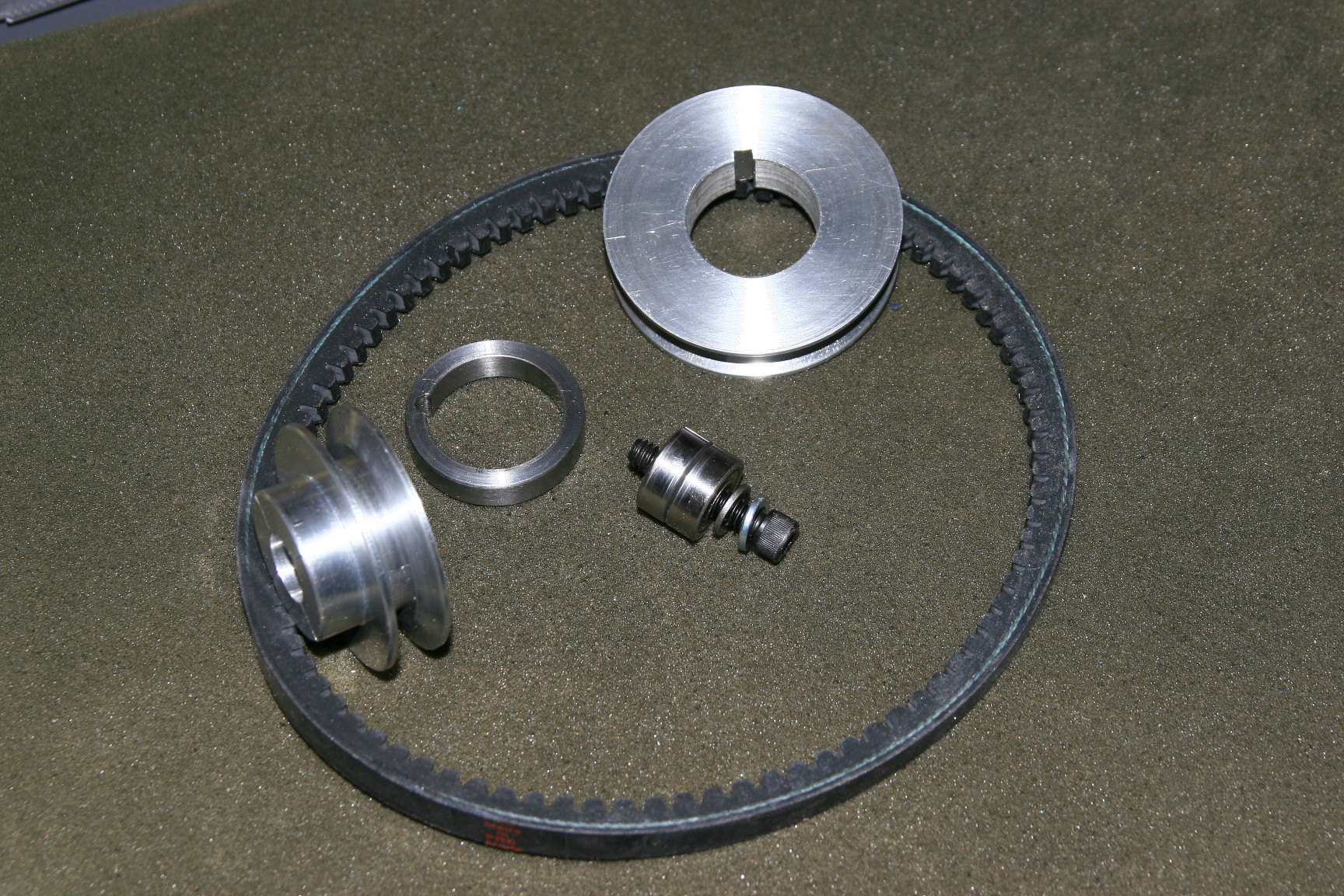

    Long over due but necessary with the new 1HP motor and VFD combo on my mini lathe.

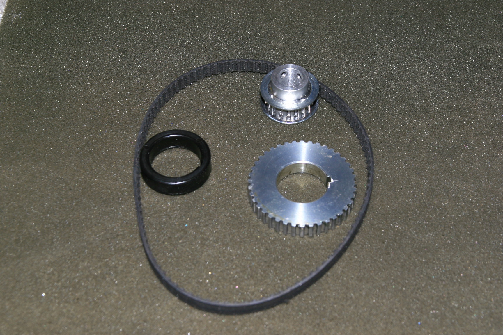

    The little 1.5mm pitch timing belt and pulleys would slip and rip out teeth on even small jobs.
    First picture shows the new belt/pulleys.

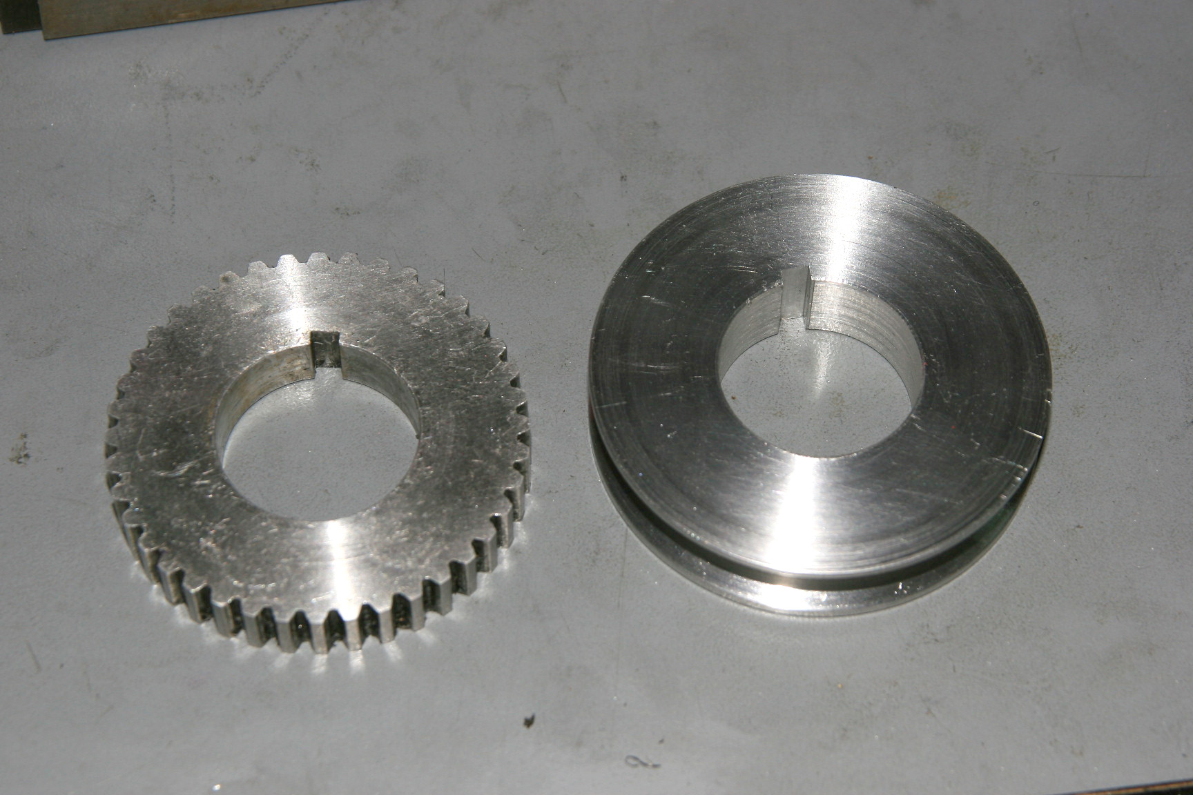

    Second picture is the original timing belt and pulleys. The original timing pulley was
    about .420 thick and I had to make the new pulleys thicker in order to fit the wider
    3vx belt and still leave a bit of material on the side of the new pulleys.
    I thought the extreme belt tension that I had put on the timing belt would help but even with
    only drawing 2.3 amps (about 500 watts) that darn belt/pulley combo would self destruct.
    The first belt I was going to use was a 3L series by 20 inches long. But then I saw the HP
    specs for the belt and that was just tool low at low rpm with the small drive pulley on the
    mini lathe.
    3VX210......Then I found the 3VX cogged belt. HP was more than enough for my use. Both the
    3vx and 3L series belts use a 40 degree pulley. The old cog belt and pulley system were put
    back in use for the last time. I made two pulleys and added an extra idler to my drive system
    so I could use the 3VX210 belts. I found a source for the belts on eBay for a good price and bought

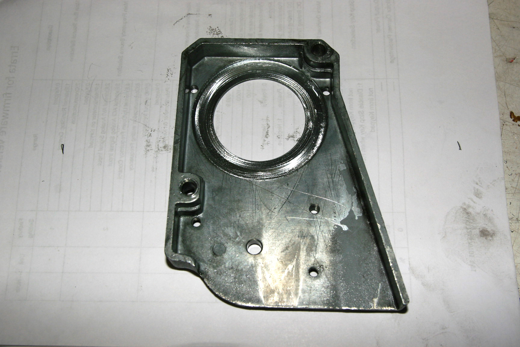

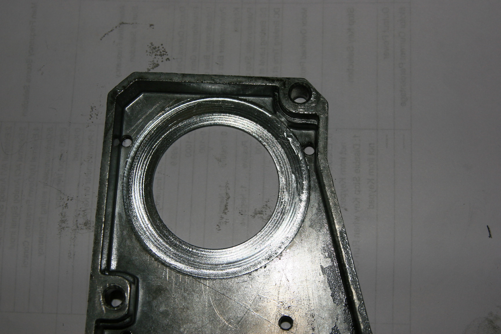

    2 of them. (I like spares). This belt is a bit on the long side for the mini lathe so I designed my pulleys

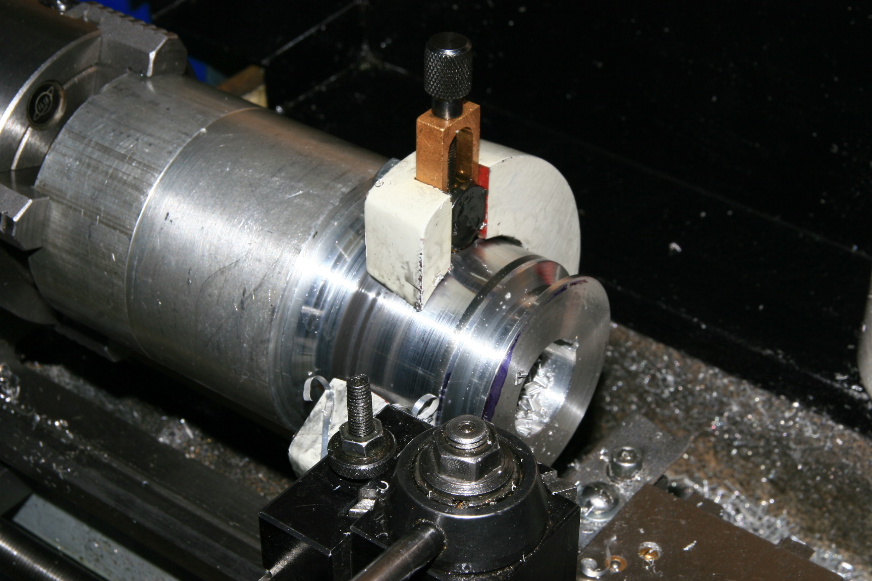

    to be quite large. As large as I could fit in the lathe without major work. The design required a recess to
    be milled in the threading gear/lead screw direction casting. No problem since I had a 6" rotary table and
    a mini mill.

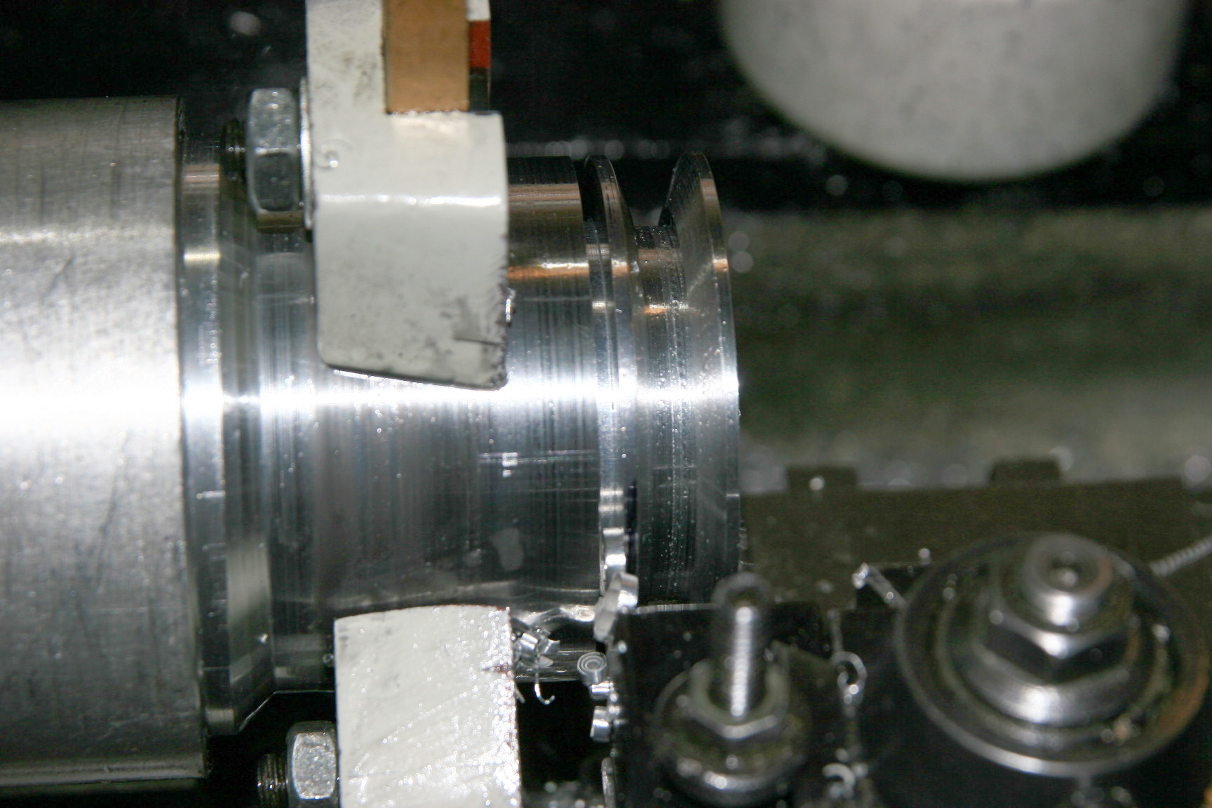

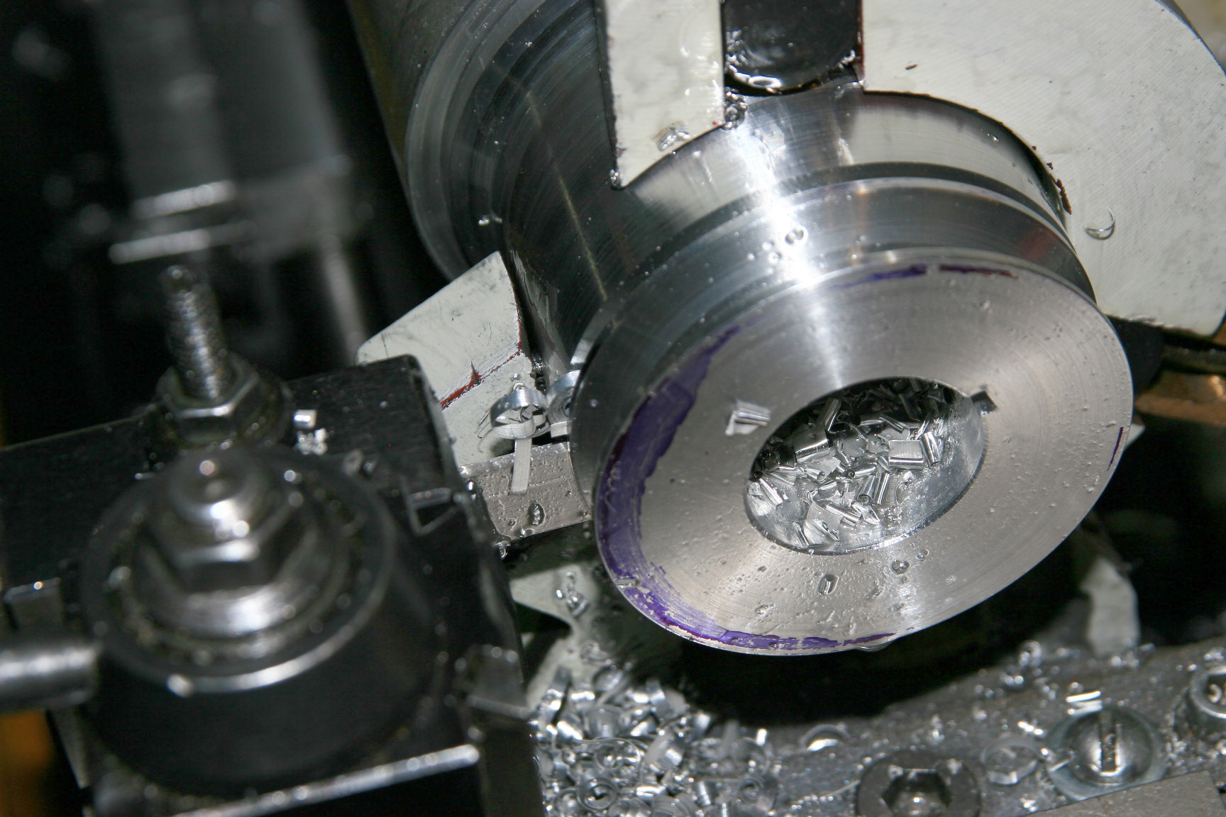

    Two pulleys were turned. Spindle pulley is .525" thick and 2.520 inches in diameter. Drive pulley is
    .520 thick and 1.980 in diameter. Both of course were cut with a 40 degree taper. (20 deg per side).

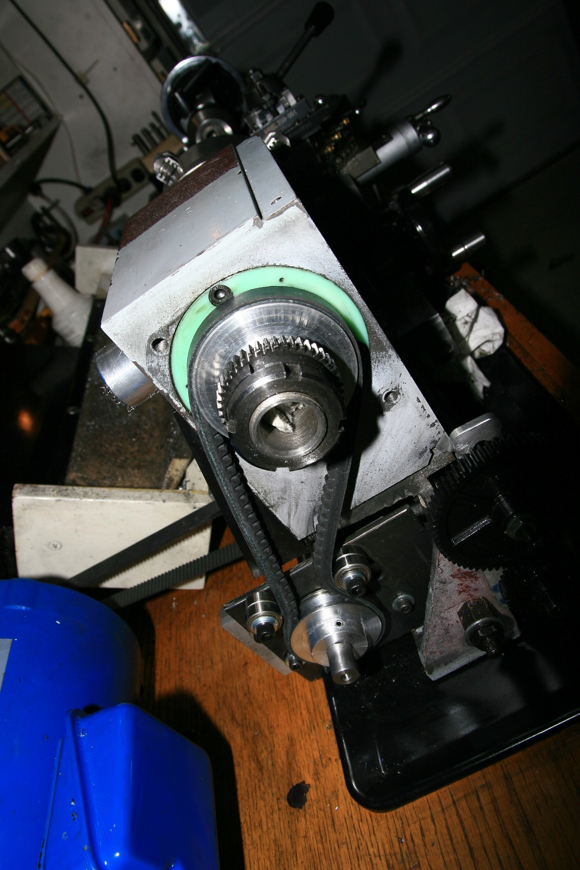

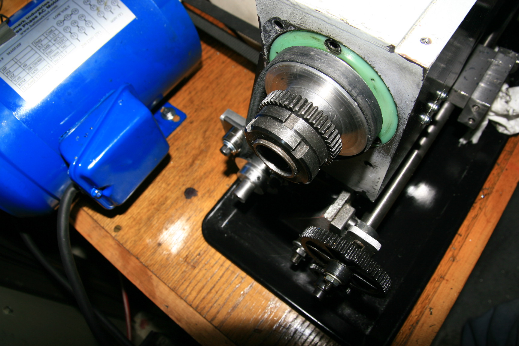

    Since the belt is so long I had to add a second idler to keep the belt from rubbing on the threading gear casting.
    There is not a lot of tension on the new 3vx210 belt but enough to keep it from slipping. Much less tension
    than I had to use with the original timing belt.
    Minimum speed on the VFD was reduced to 4HZ from 6HZ to get back my very low speed on the spindle since I
    made the drive pulley larger than the original. (Got an increase in top speed but not too much higher).
    Cruised through the crust of some hot rolled steel like butter with a carbide bit.
    Made a few more cuts with the carbide bit and put the new motor/vfd to it's first test over 4 amps.
    Yep you guessed it. The new belt performed without any screech,squeal,or slip.
    Almost a full KW and it just keeps on turning...Very happy with the new belt/pulley combo.
    I ran another test as slow speed and I was able to stop the chuck without any slippage.
    The motor current went up and the VFD tripped out. Perfect....
