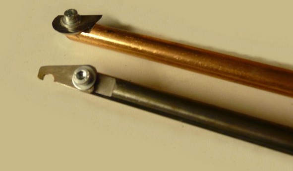

    Here are some woodturning scaping tools.
    You don't see the handle, but obviously, there is one for each
    The blades are HSS made out of pieces of jointer blades.
    I cut them with the dremel with a high speed cutting disc, that goes pretty well.
    I have plenty of different shapes, the one at the top is for scaping the bottom of bowls (you need to hold the handle very strongly, they are prone to engage with the wood)
    The one at the bottom is specially shaped for making captured rings or finger rings.
    It's not clearly seen here, but as I don't know how to drill in HSS (or exactly I don't want to bother with that), the screw is not inserted in a hole, but in an open groove. The result is the same, and you don't even need to un screw completely to change the blade (for the lazy man).

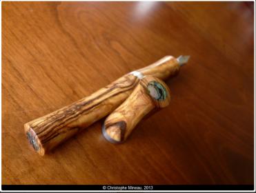

    I really enjoyed this pen ... you have much patience for these small detail
    Here at home, my word is the last ..
    Yes love! I'm going to do, you're right ... lol
    Joke is that the lathe has over twenty years and never been used and I ended up putting as ornaments. (I was lucky to find him abandoned)

    This one was made from nice curly olive wood from Jerusalem (That's true, I have a certificate )
    and I liked the similarity of the figures with the ones from the paua abalone ..
    So now, you have to practice and use your lathe !
