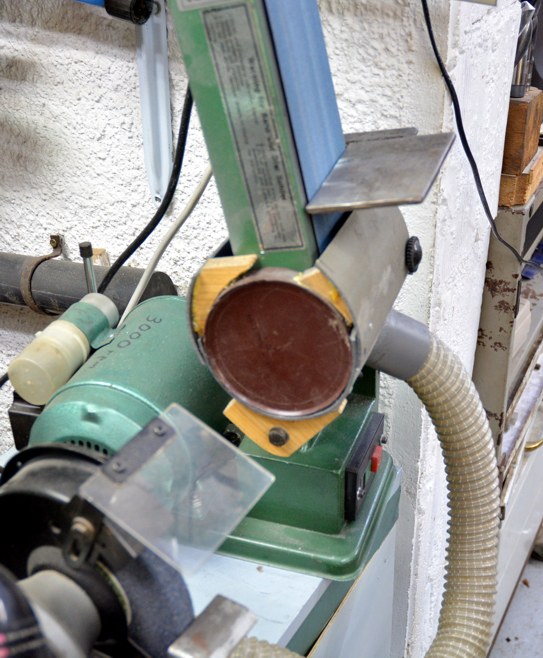

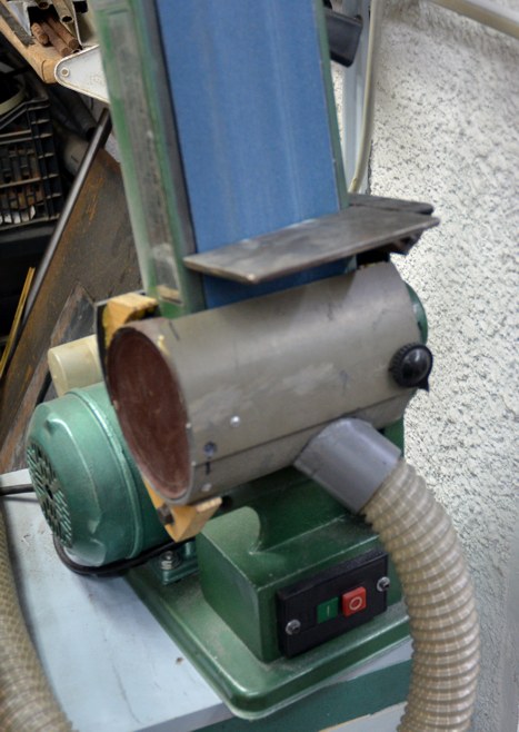

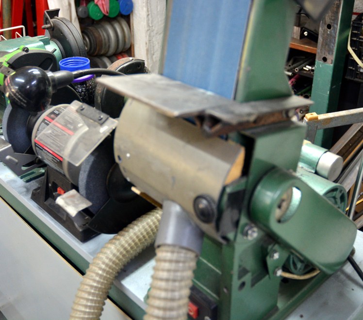

i added a dust collector as shown in these pix. As the dust is carried downward by the belt it just falls captive to the air being sucked in. There is no tendency to suck the belt onto the platten. It is made from some scrap plastic drain pipe, the lid off a coffee jar and some scraps of wood. It works really well. The black knob on the front is the only bolt holding it on, elsewhere it just rests on a shaped support.
