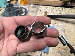

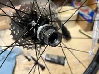

My lock ring tool wouldn't fit over the giant axles on a bike I was working on, so I bored out the center of an old one to fit. Since I had it in the lathe I also trimmed off the worn-out part of the splines.
