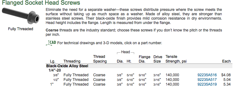

But, McMaster-Carr has something that would fit the bill right out of the box.
https://www.mcmaster.com/fillister-head-machine-screws/length~3-8-2/thread-size~1-4-20/flanged-socket-head-screws/length~1-2-1/length
The plus is that the hex remains the same as regular 1/4-20s
Ahhhhhhhhh, McMaster-Carr....epic company and website light-years ahead of ANY other distributor - warehouser - and especially everyone's favorite but despicable go-to.
At $4 to $5 EACH, plus shipping, I like that idea of squandering an allen wrench, making a lantern chuck, or using two nuts, or any of the other good solutions.
