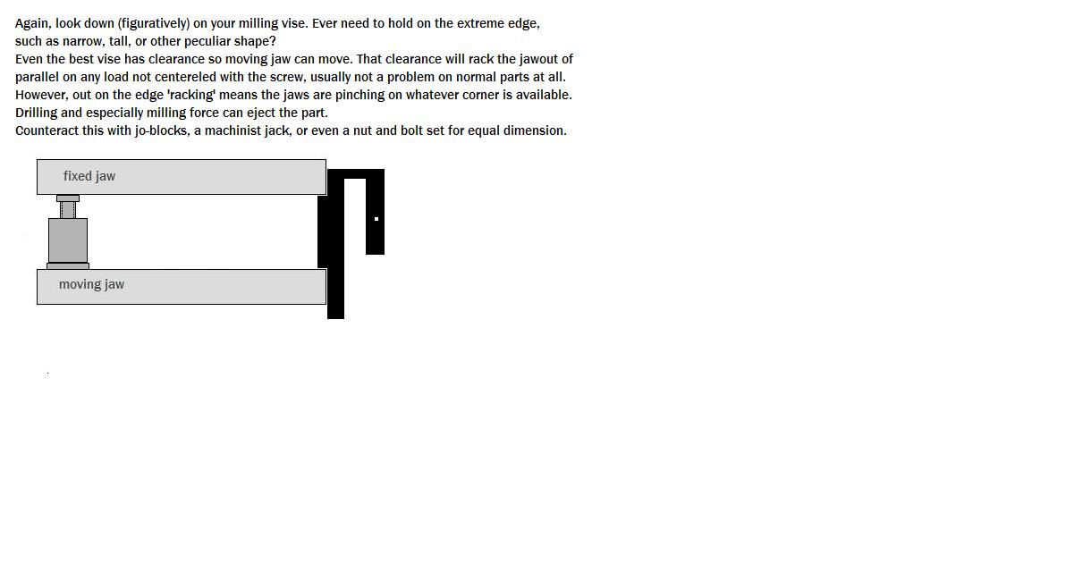

    More a vise can do
    This will help users, protects equipment, even works on a limited production basis. Everything is on the page, just click it. I'll be posting some hints; started a list when I joined, when searches for worthwhile topics had few or no post results.
    And please ask for what hasn't been hit yet. I'm certain any of us will gladly answer - it drives HMT.net forward.
