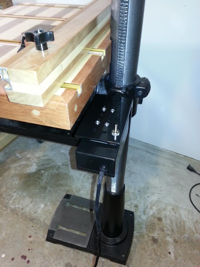

    Drill press table crank problems .... I know I'm not the only one!
    My DP table accessories are heavy.
    My custom woodworking table impedes the rotation of the crank handle.... knuckle buster!
    I routinely work large/long items, so my table lift gives me a workout.
    Given all of the advancements the DP has seen, variable speed, rapid speed change, keyless chuck, laser site, etc... The hand crank is laboriously outdated, especially on higher end machines.
    I removed my crank handle exposing the rack and pinion drive shaft and found a way to mount a motor.
    Initial specs and estimates led to a lot of trial and error, but I found a great combo of hardware that gets the job done based on a $5 DC power tool motor.
    Parts include:
    Aluminum L bracket for mount
    Small high RPM DC motor with cooling fan
    3 stage gear reduction
    Drive shaft coupler
    Mechanical and logical motor controls for speed direction
    AC to DC power converter/supply
    Inline fuse protection
    Mounting hardware
    Cable management
    Motor enclosure
    Install requires: drill, metal bits, taps, screw driver, allen wrench
    Take a look at the video .... Very straight forward operation. Easy up, easy down!
    I've also added some photos.
