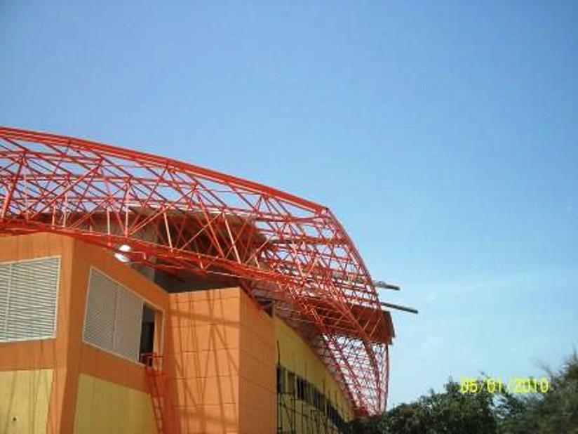

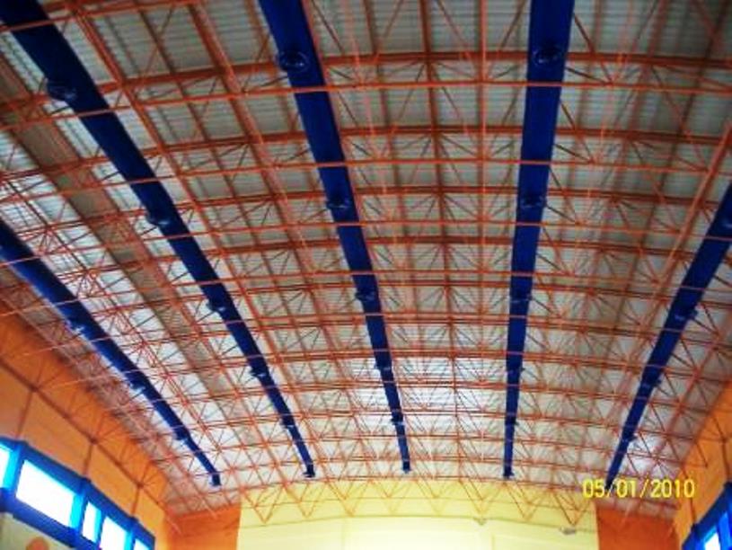

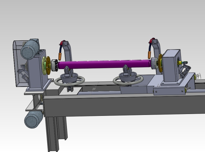

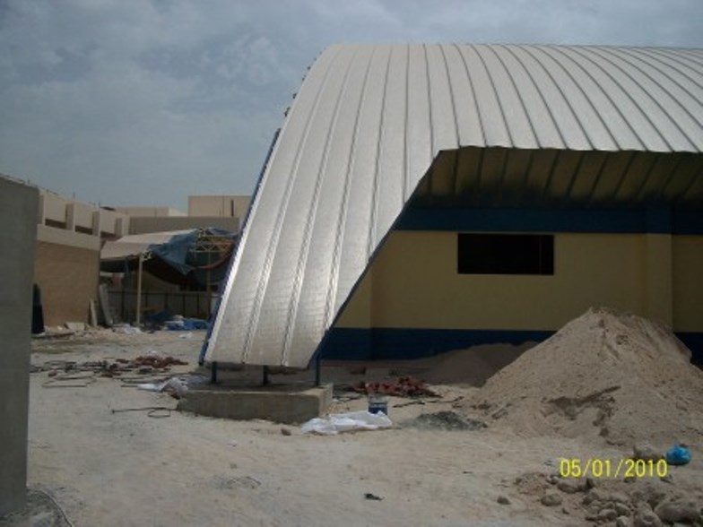

    These space frame roof structures are inherently among some of the lightest structures for a clear span roof system but the size of the building makes them nearly impossible to be hoisted in place by a single crane, sometimes even 4 cranes are not enough to do the lift. I've not seen one that required as many as 6 cranes let alone 8 of them. Coordinating 4 is as bad as it may seem, you just have to have operators who can follow instructions and only 1 person giving the orders.
    By far the best way to assemble a space frame system is on the ground unless it has multiple levels then yuoo just need ot have good removable supports as you assemble it. Designing them to have a natural arch increases the stability though.

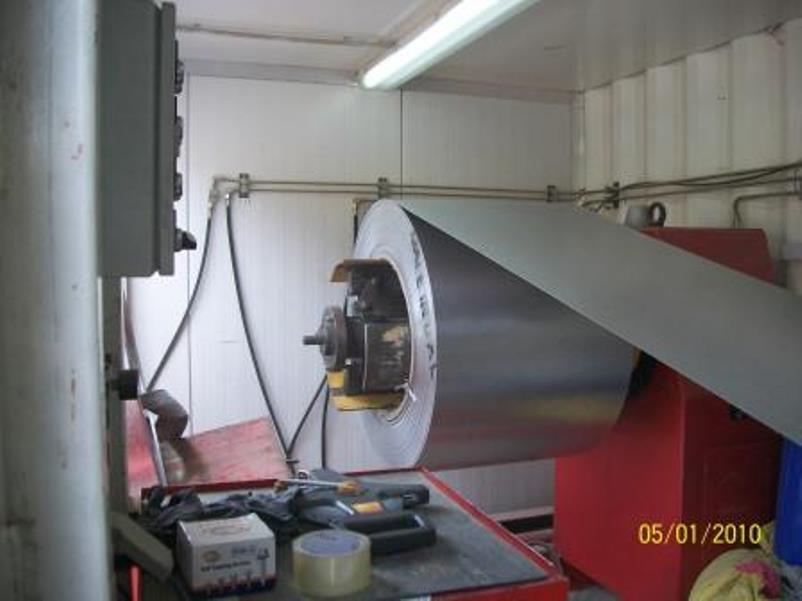

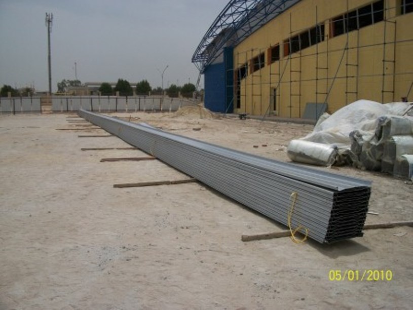

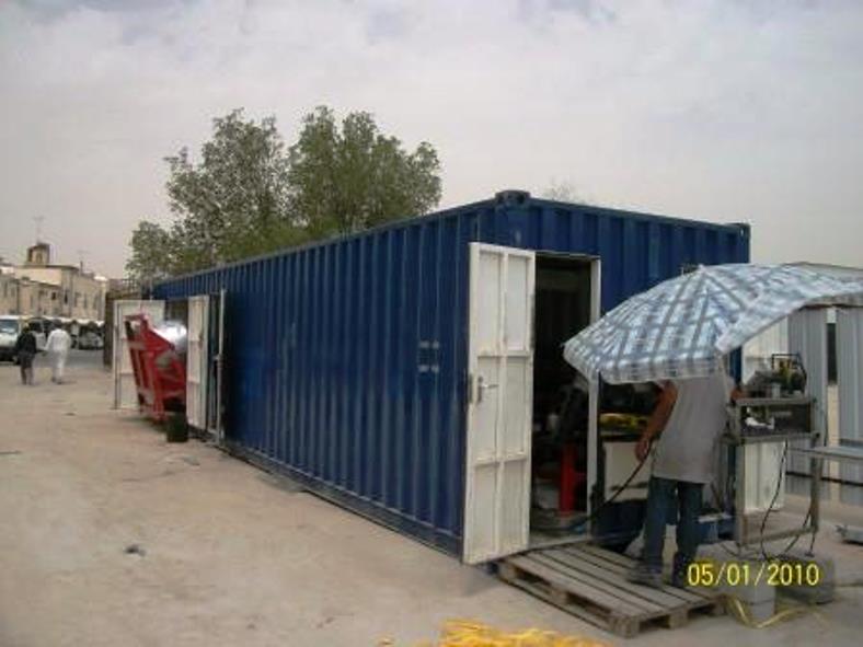

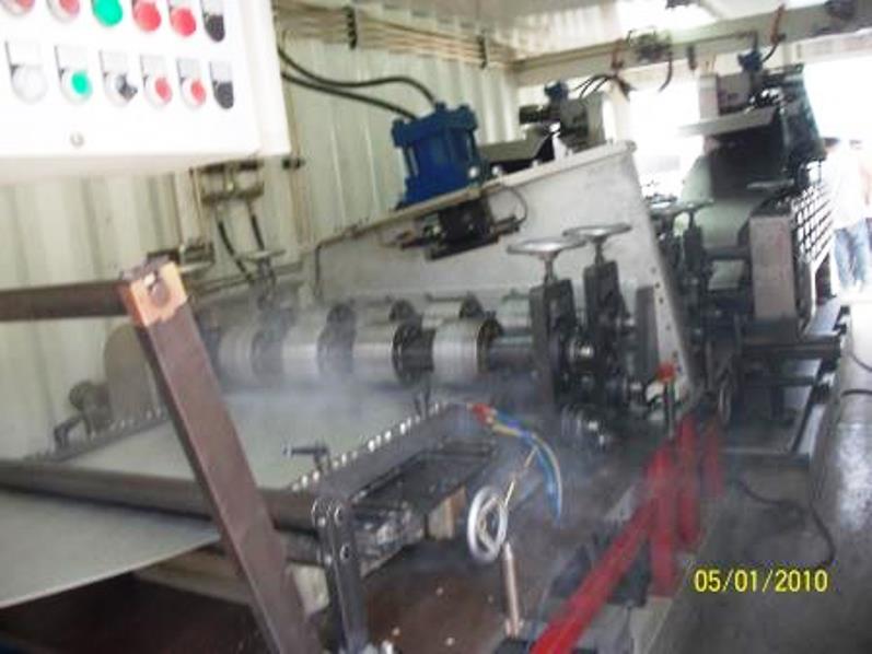

    Then we covered with standing seam roofing we formed on site

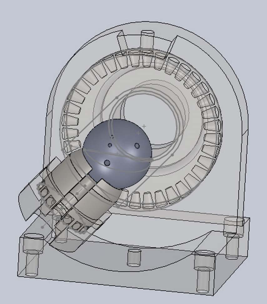

    And a drawing of the jig for drilling and threading the ball that the space framework uses for directional connecting.
    The welding lathe for making the tubes
