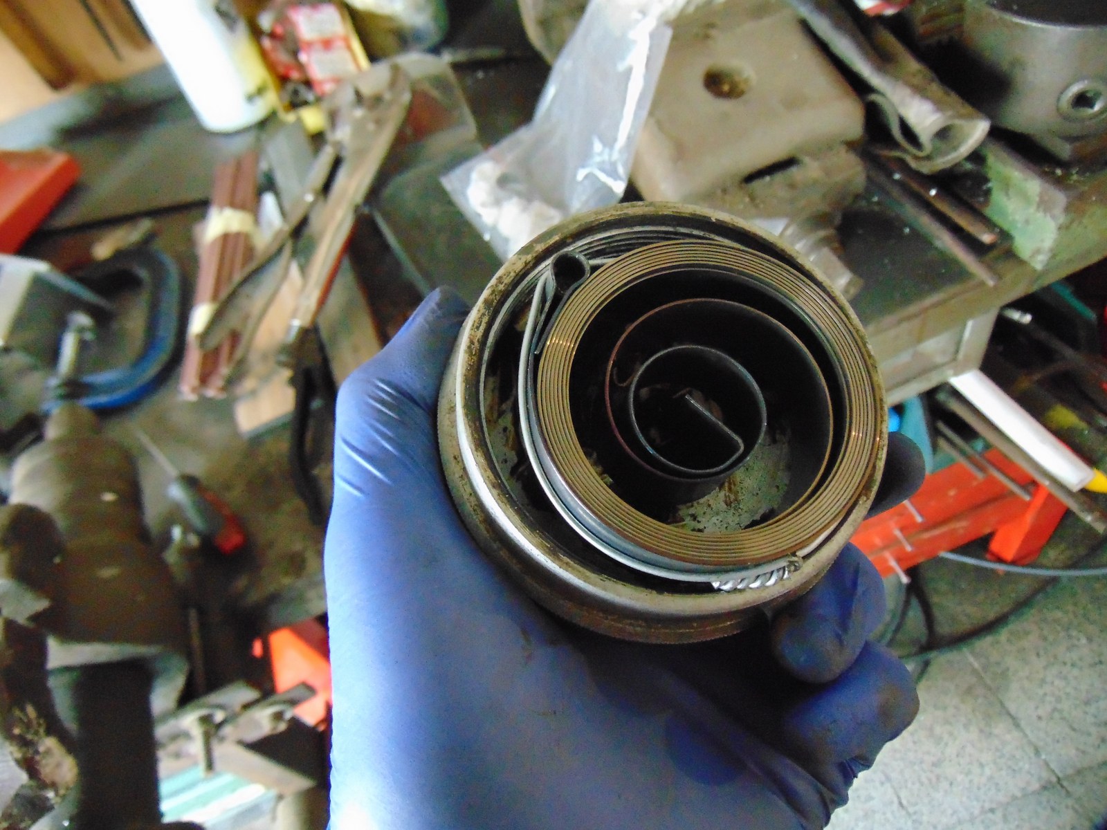

    Hi all!
    I'm searching for good advice about how to install the coil spring in my press drill.
    I bought this spring, the internal diameter is 22mm, perfect size for the shaft. The trouble is the external diameter, the round seat for pin prevents the spring from going into place.
    The spring has enough force, it's quite hard to turn by hand, it's even difficult to use the left threaded alu case.
    I'm thinking to build a sort of frame jig in order to compress the spring and then tie again with wire, but maybe there is a better way
    Any advice welcome, thank you for your suggestions

    From your picture it would appear that the spring has to many coils than is necessary and you would have to wind it up a lot to reduce the diameter enough, making it difficult to assemble. I think I would try halving the amount of coils and re forming the end loop curling outwards.

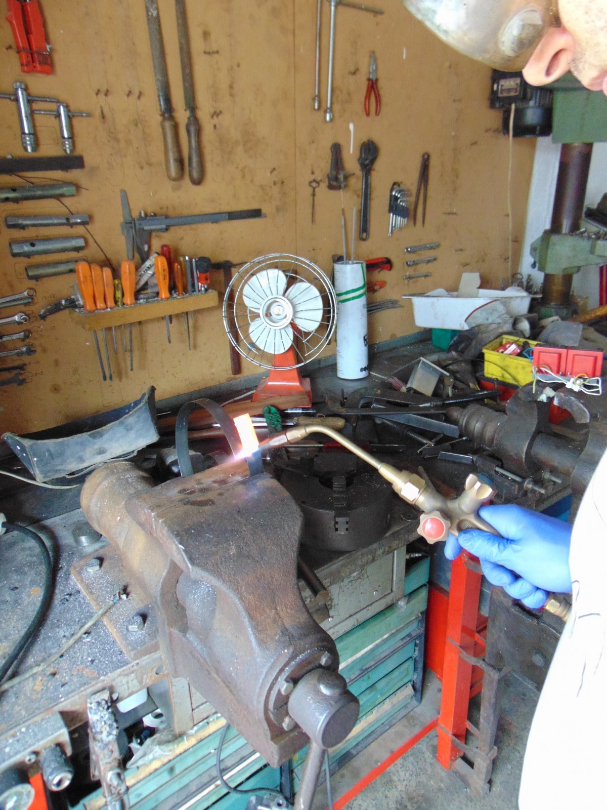

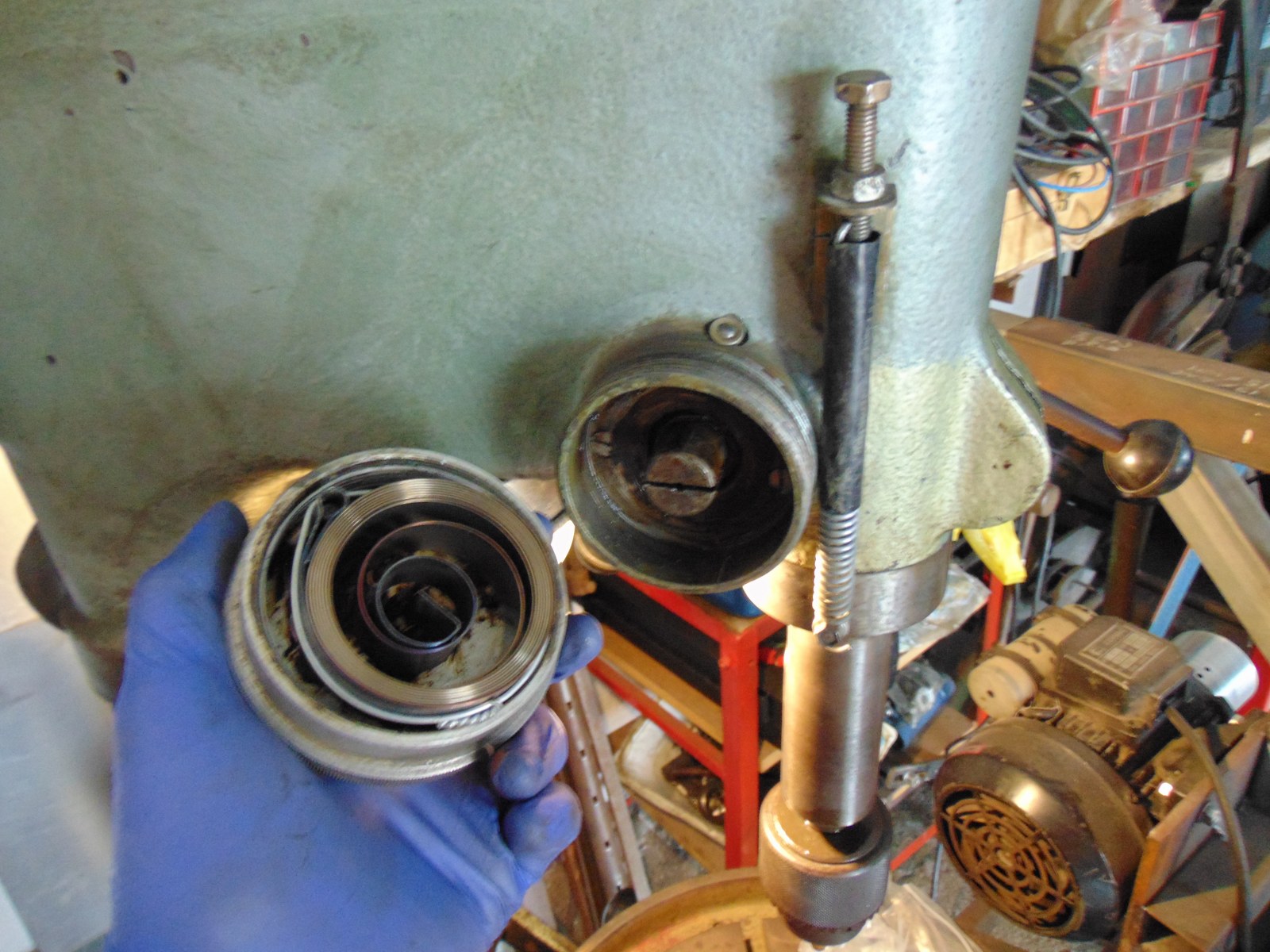

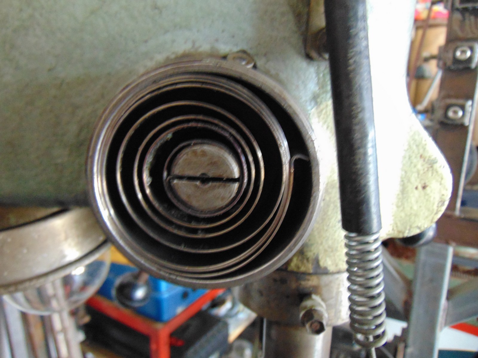

    Thank you all for the advices!
    It's nice this C shape ring,it seems better than the wire!
    I just fixed the spring! As olderan said, I had to cut the spring and re forming the stop loop with oxy torch. I cut more or less 60cm, in order to put the spring inside the bobbin. With surprise I noticed that the energy stored was high (when I cut the wire), but to be honest it was perfectly manageable with leather gloves. I added a little pre-loading of 2 turns. The spindle axis returns fluid, the descent is light. I hope this spring will last !

    I'm in full agreement with ALL of the details mentioned, especially that it looked far too long. 2 turns are a good preload setting. I frequently alter setting in accord with depth and certain operations, including occasional oiling of the spring. Really smoothes out binding on deeper work.
