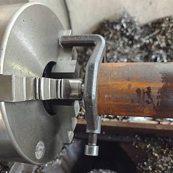

    This style of electrical grounding clamps make good lathe dogs. All you need to do is add a short driver rod to fit against the chuck jaw.
