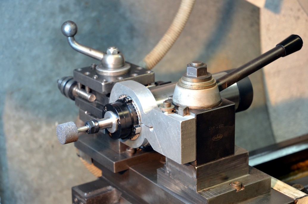

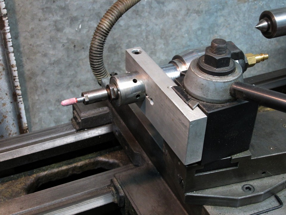

My old SB lathe has plain cast iron bearings which do not like high speeds, my usual working speed is around 600 rpm, this is a problem for small drills. The solution was to make a high speed drilling spindle to plug in the tailstock with minimal setup, in fact by rotating the stock and the drill a truer result can be had.
I had an old Archer keyless precision 0 to .25 inch chuck which I rarely use which seemed ideal, the integral hardened 1 morse taper was turned down using a CBN tool and cut off to fit two sealed bearings which I had and pulleys were made. An 18v DC motor from an old cordless drill as the power source, and a drive belt from a large O ring I found which I remove when not in use to avoid over stretching, this gives a top speed of 12000 rpm +600 if I also run the lathe.
That just left a No 2 taper housing to make from a piece of weight lifting bar I had and a mounting bracket from a piece of alloy extrusion. I can power this from my PWM 18v battery power box and And in the absence of a sensitive feed I will for now peck drill by sliding the whole tailstock by hand pressure for tiny drills. The shortened taper is because my topslide travel is 2 inches and the parallel portion enables self ejection. It can also be used as a live tailstock chuck for turning parts too small for a centre i.e. fuel needles.

The old drill motor was a bit lacking so it is now powered by the ubiquitous 775 which is ok for drills up to 5 mm.
