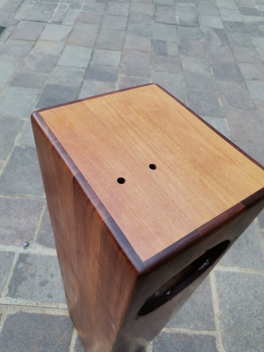

    I just finished to polish my new speakers, since I havn't found a convincing guide I decided to post my experience.

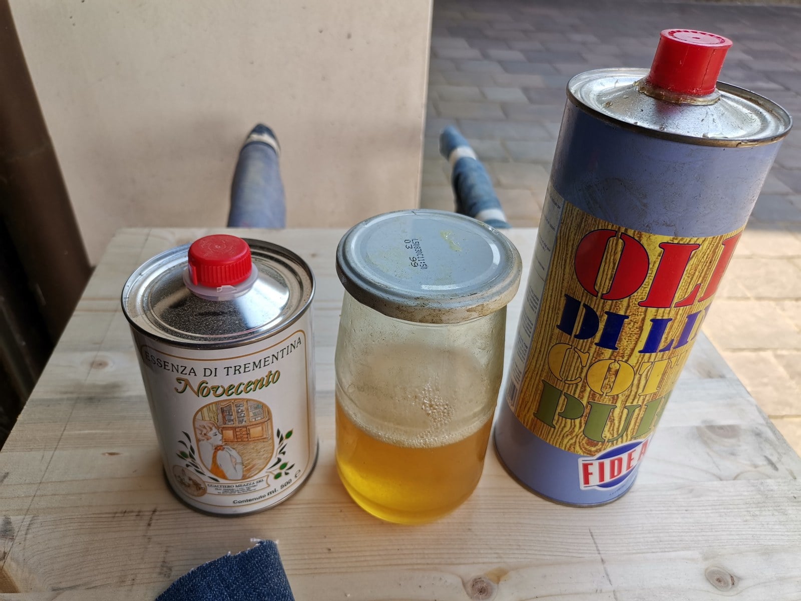

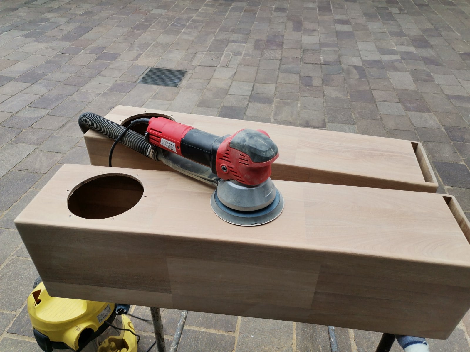

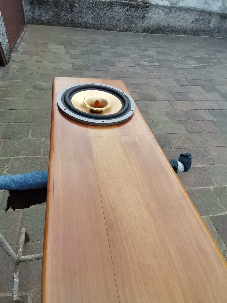

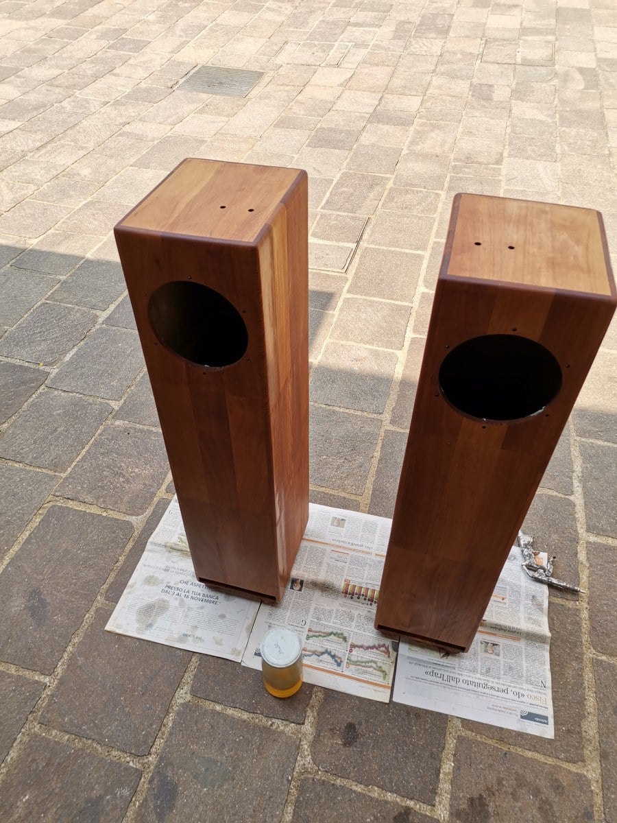

    The wood is Afromosia, from Paraguay, glued with PVA glue (Vinavil). First prepare the surface wih sand paper till 320 grit (all the steps from 80 grit), then apply a mix of 50% boiled linseed oil - turpentine. The first two hands plenty, I found pretty useful a jeans small rag, it doesn't shed hairs and helps polishing. The following coats with less oil and more rub, 30 min after each hand it's good to clean the surfaces from residue. With less oil applied the drying time is shorter. After the VII coat (half day rest) a light clean with jeans rag with turp.

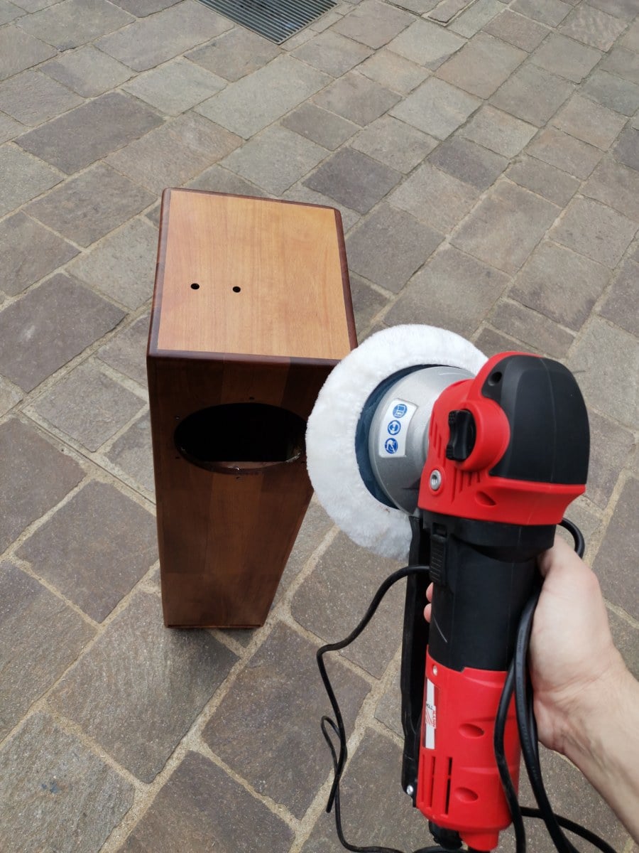

    To reach a nice high surface apply a mix of Carnauba and Beeswax by hand and remove with wool cloth. I found pretty convenient to use the polisher tool, not very traditional but effective.
    I found this method accurate and good for the result. I tried in the past another method with no satisfaction: it used pure oil in the last coats, a messy work.

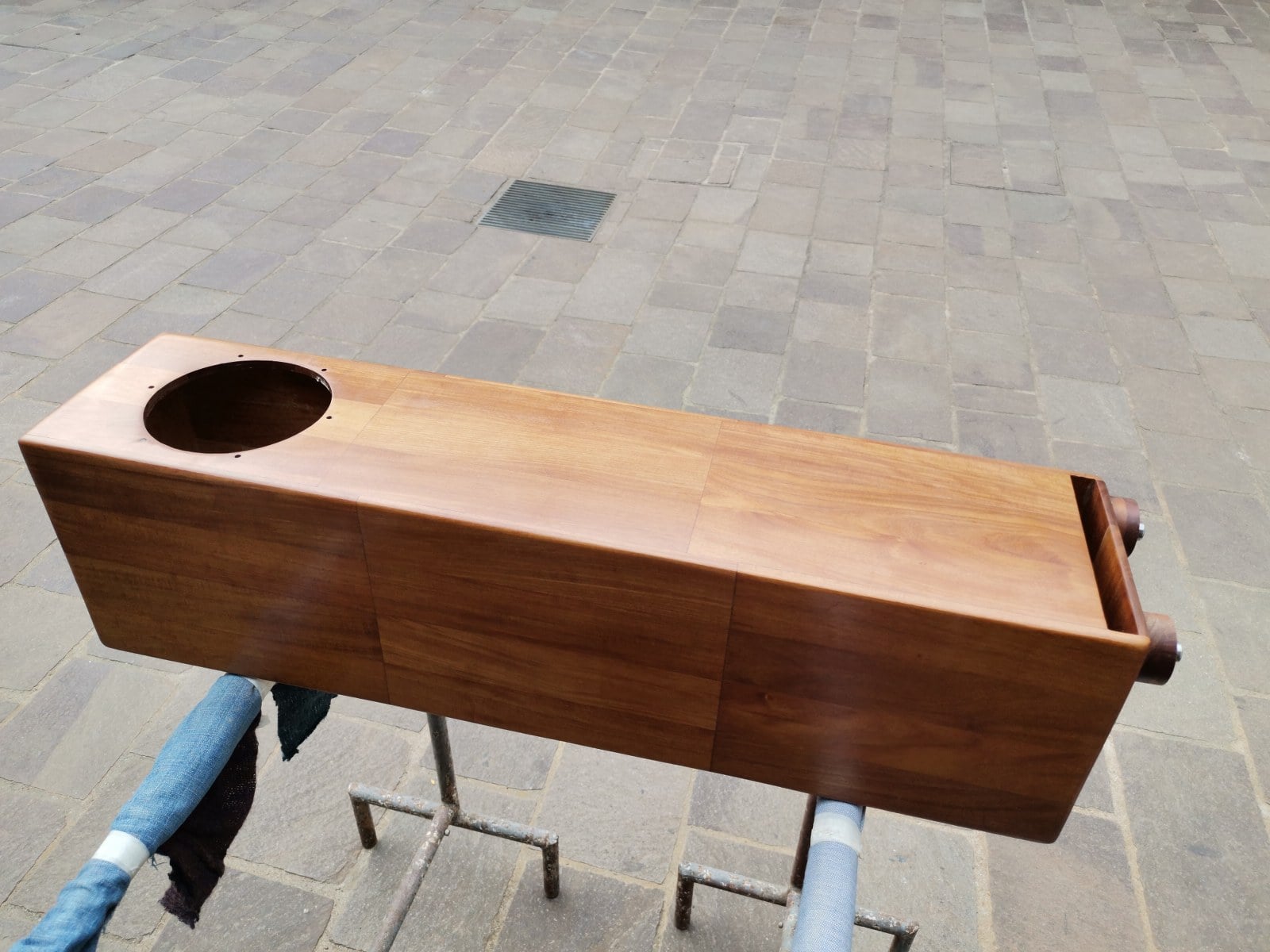

    Details of the sanding and first fresh coat.

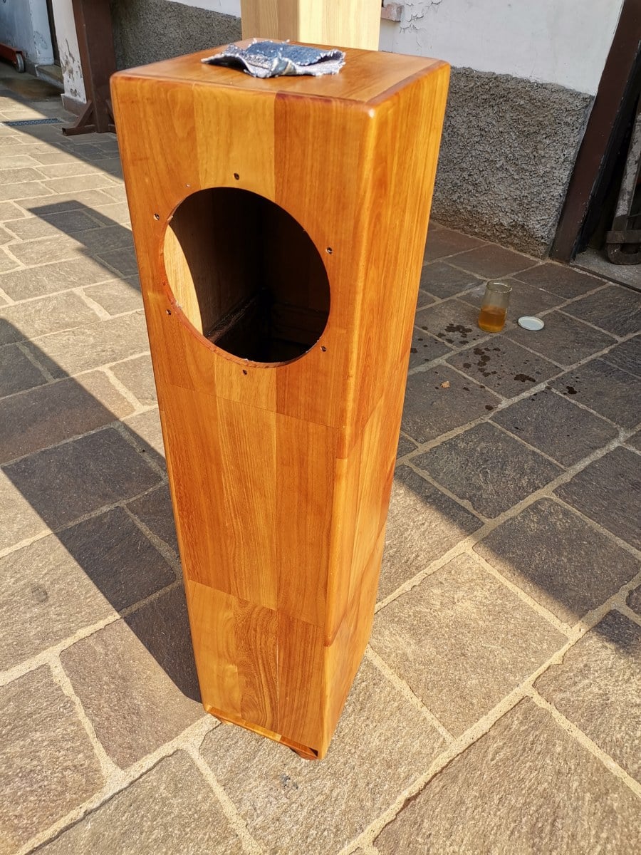

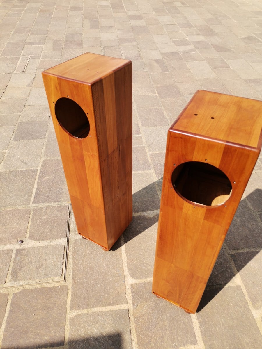

    Intermediate steps.
    Polishing wood with Boiled linseed oil-4.jpg Polishing wood with Boiled linseed oil-5.jpg Polishing wood with Boiled linseed oil-6.jpg

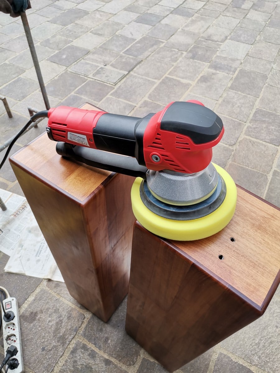

    Final polishing with power tool.
    Polishing wood with Boiled linseed oil-7.jpg Polishing wood with Boiled linseed oil-8.jpg Polishing wood with Boiled linseed oil-9.jpg

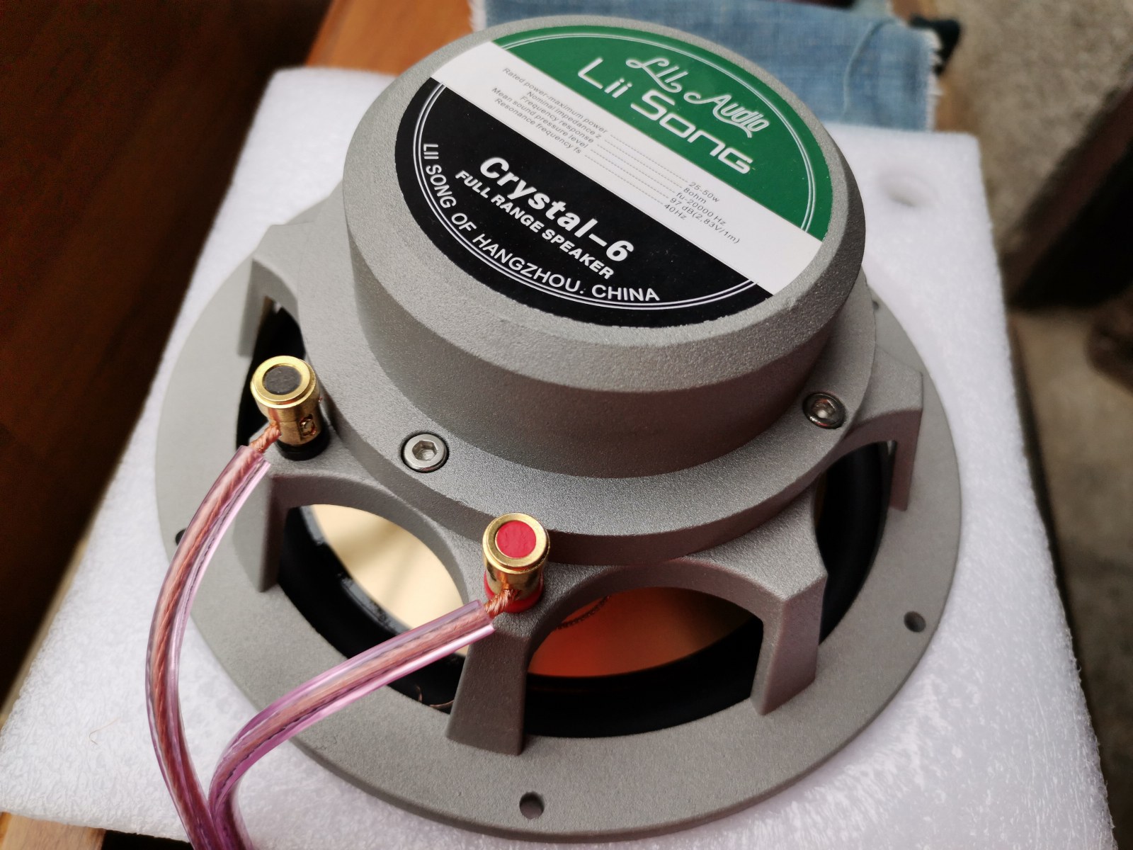

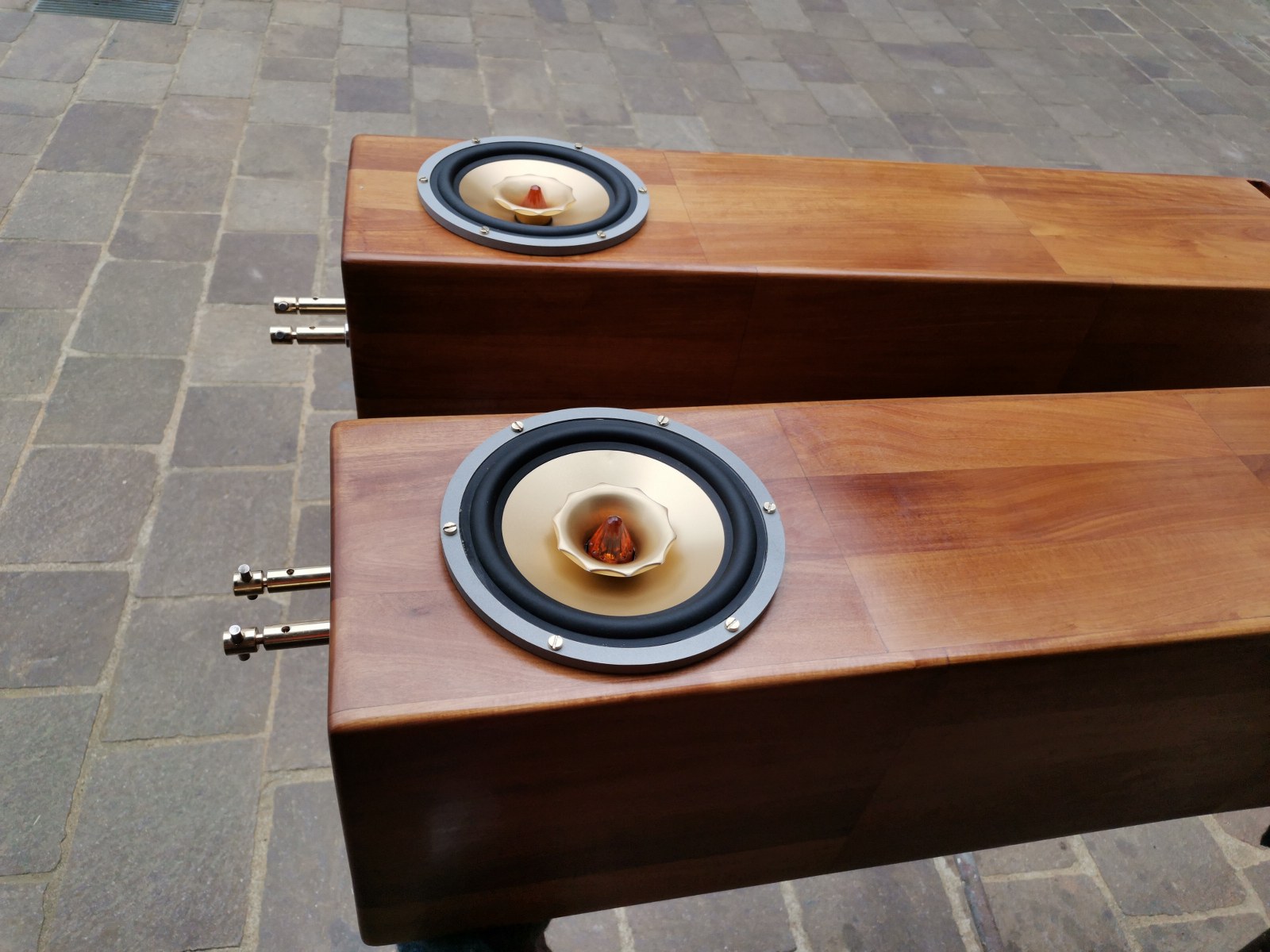

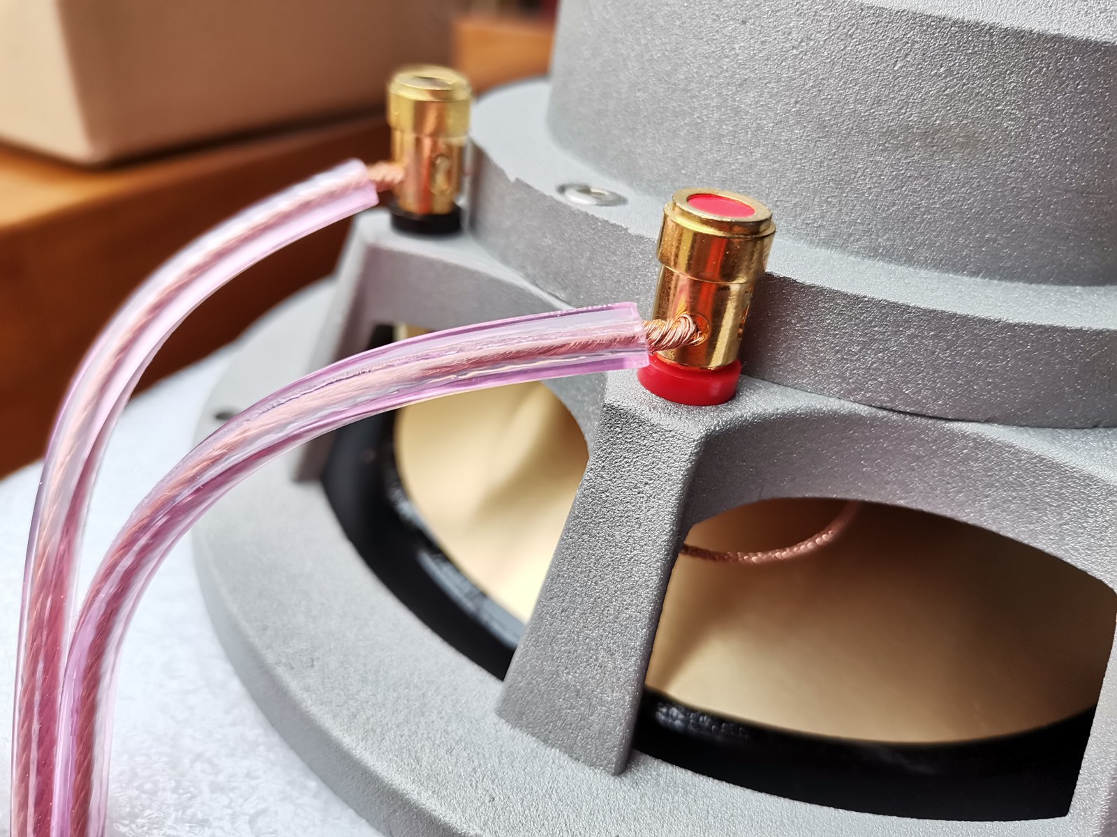

    I decided for a second coat of wax, polished the brass screws and installed cables, a quick action having prepared all the parts.
    I will play in the next days with eq-dsp to check the needs of the driver. It's early to talk about final performances, first the break-in period, than the filter and the listening.
    At first sight, it's a very interesting fullrange! The bass, out of the box, seems deep and strong like a good woofer, above all with speakers 1,5m far from walls. A bit lighter in extension than C10 but good. As usual, FRs need 50-100h to sound properly. The mid-highs is pronunced and raise as the freq increases, the idea is to build a dedicated adjustable filter. Other considerations and aspects related to listening will be evaluated later.

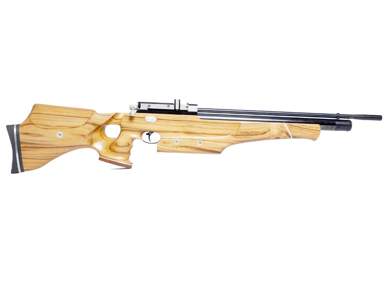

    I've always been attracted to traditional finishes, unluckily not easy to find in standard quality weapons, most use PU lacquer. I remember that years ago a friend built wonderful stocks for air-rifles, Ginb (Antonio Gentilini) with sono kembamb and teak doreng wood. He usually used Tru-oil because good looking and fast to apply but on request he made also oil and shellac finishing. I've always liked his stocks but I've never had the right air rifle.

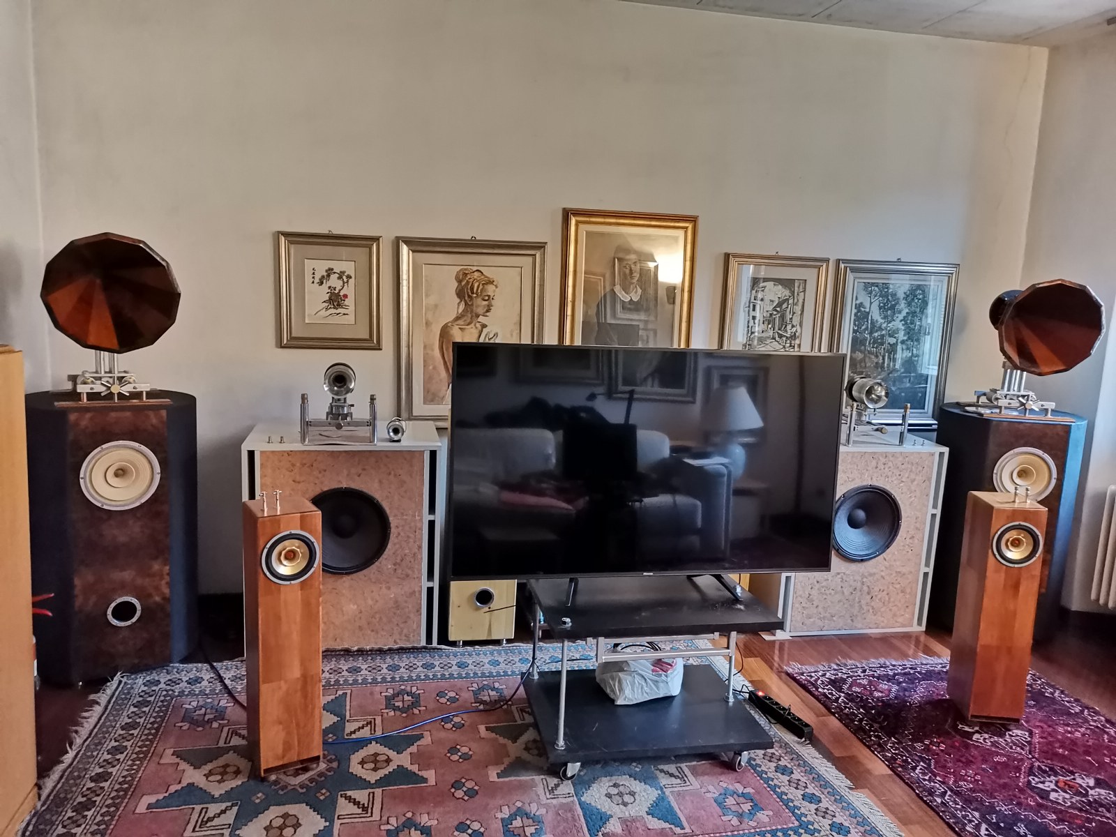

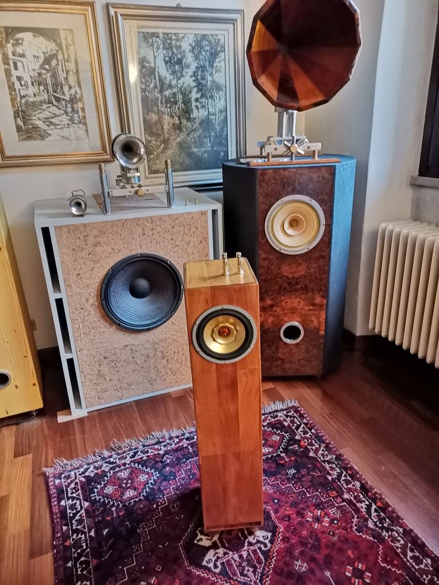

    Had to look again at your living room layout; Persian rugs, artwork, modern media. You should stage a contest, 'How Many Speaker Types In This Room?'
