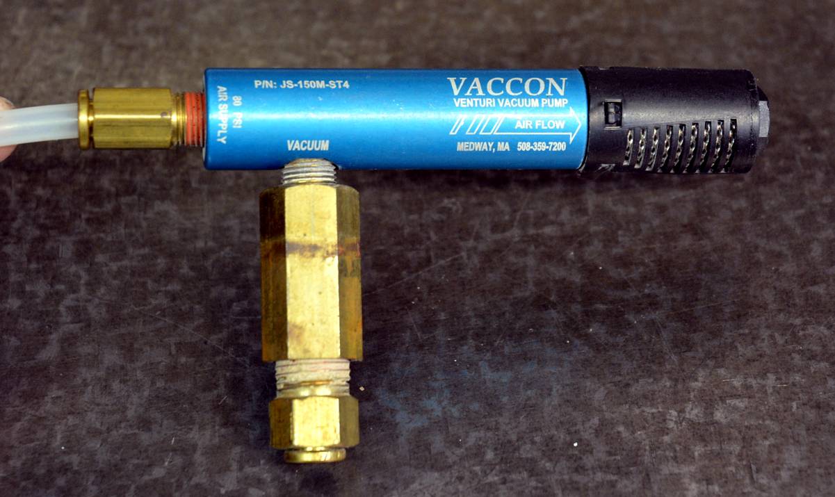

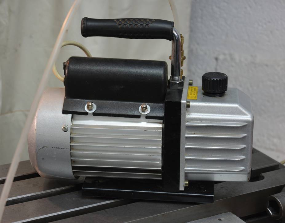

    PS. For small items you will need a good vacuum, a vacuum pump or compressed air powered venturi device are OK. A vacuum cleaner may be OK for holding down large sheets of wood based board but they only reduce pressure by around 1.5 psi so if you have a piece 2" x 2" to hold down you will only have 6 lbf holding the work piece down. It will be less than that because there is always leakage. A proper vacuum pump will suck down ~10 x the vac cleaner, so even with 50% leakage you will have 30 lbf holding it down.
    Possibility of cutting sheet metal with CNC router?-vacumn-pump-03.jpg Compressed air vacuum pump.
    Possibility of cutting sheet metal with CNC router?-vacpump.jpg Regular vacuum pump.
    I think that these pumps are used by refrigeration mechanics and they are readily available and not expensive.
