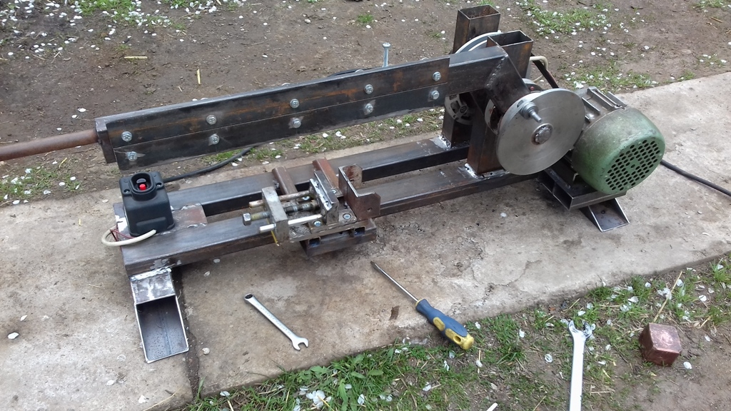

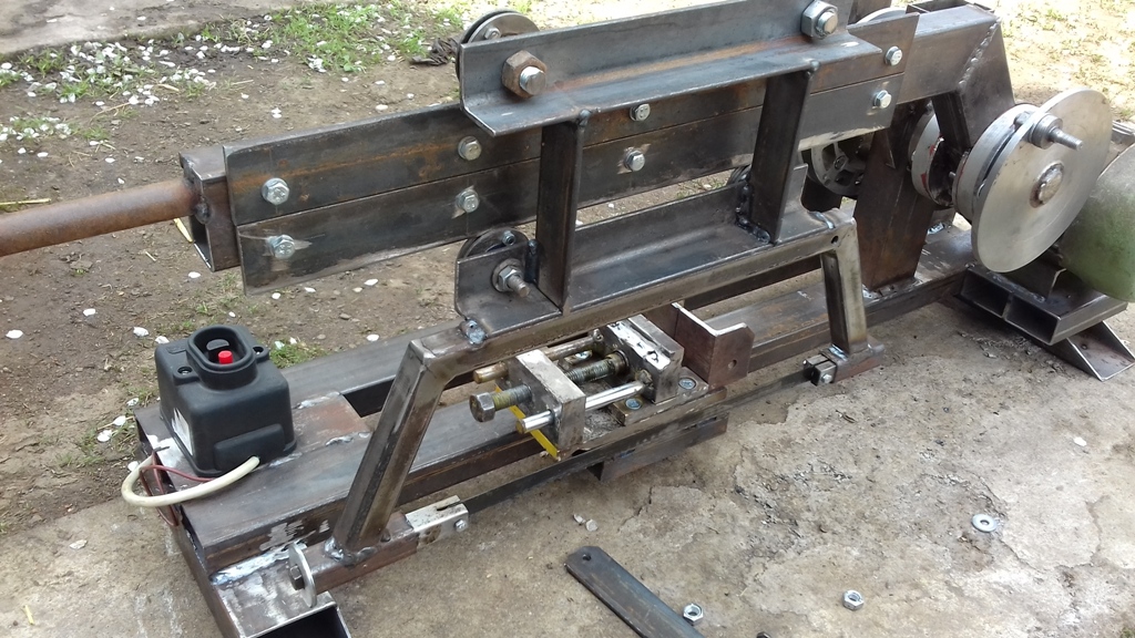

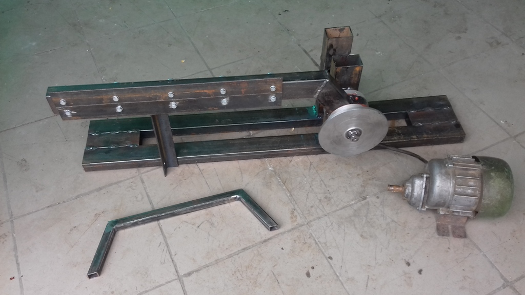

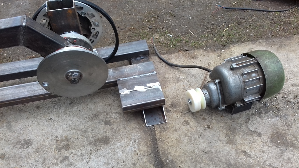

Power Hacksaw

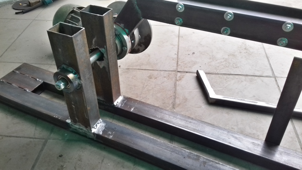

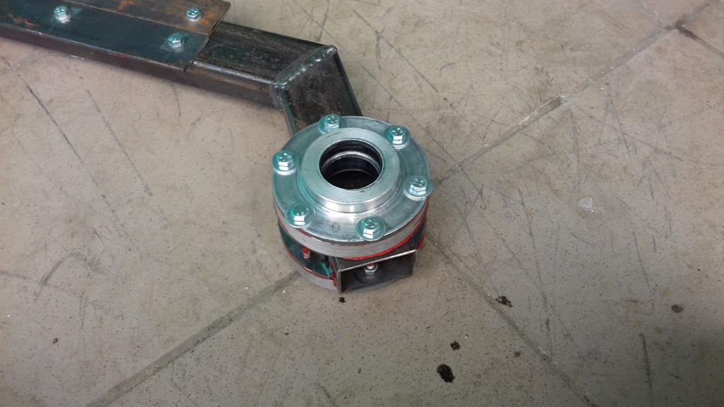

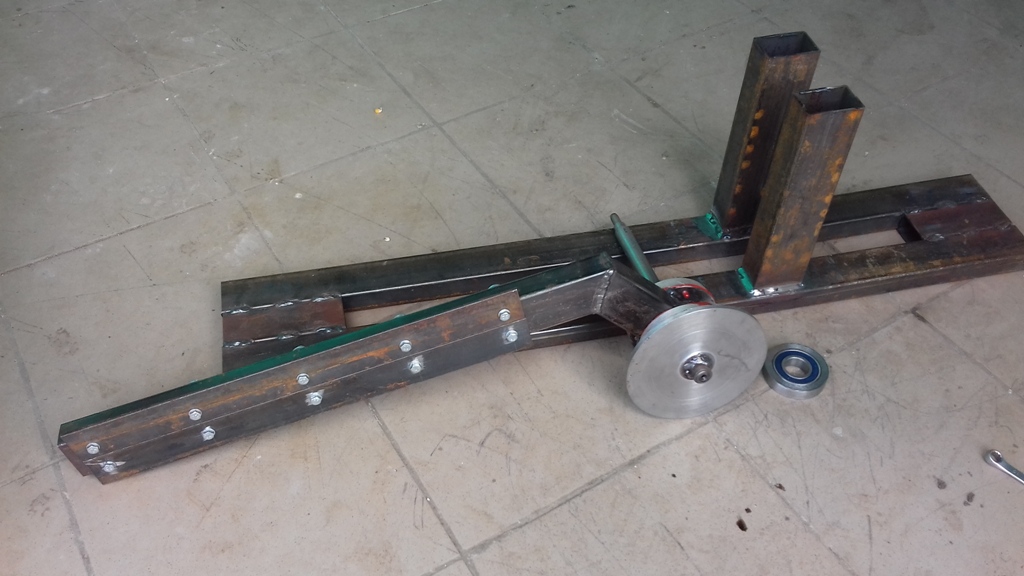

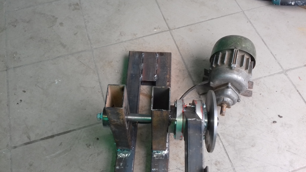

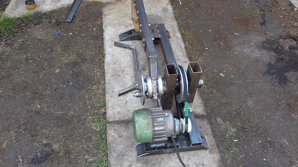

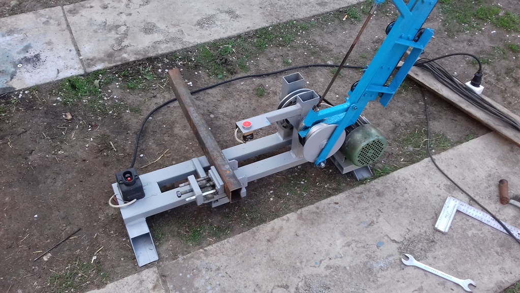

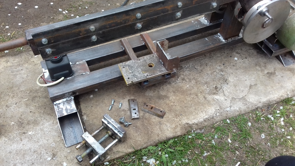

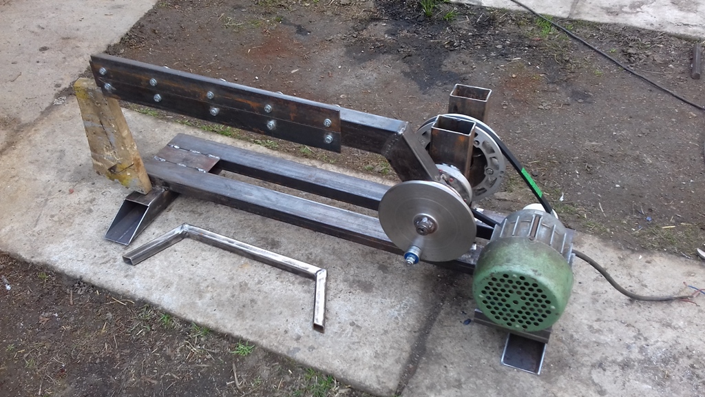

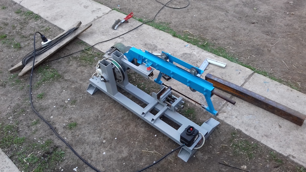

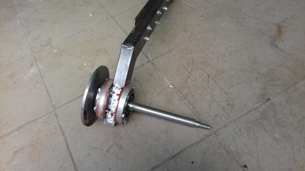

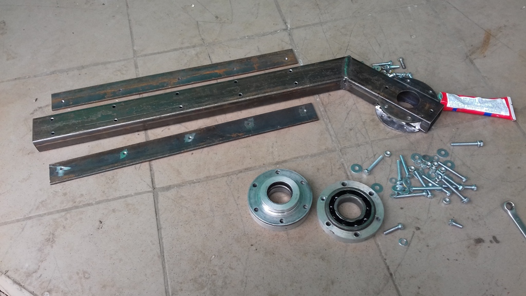

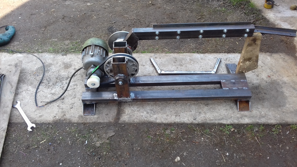

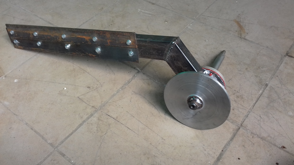

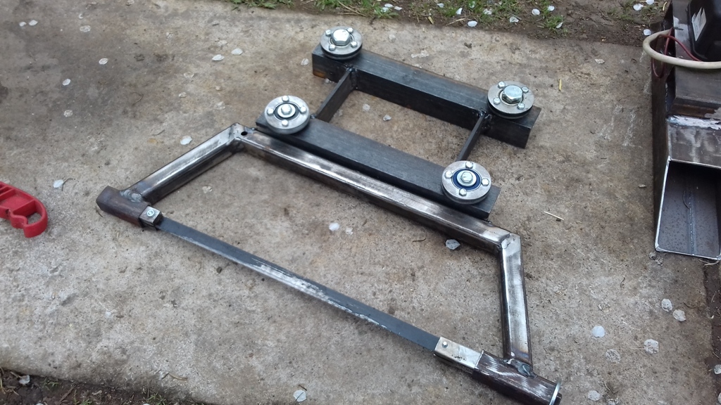

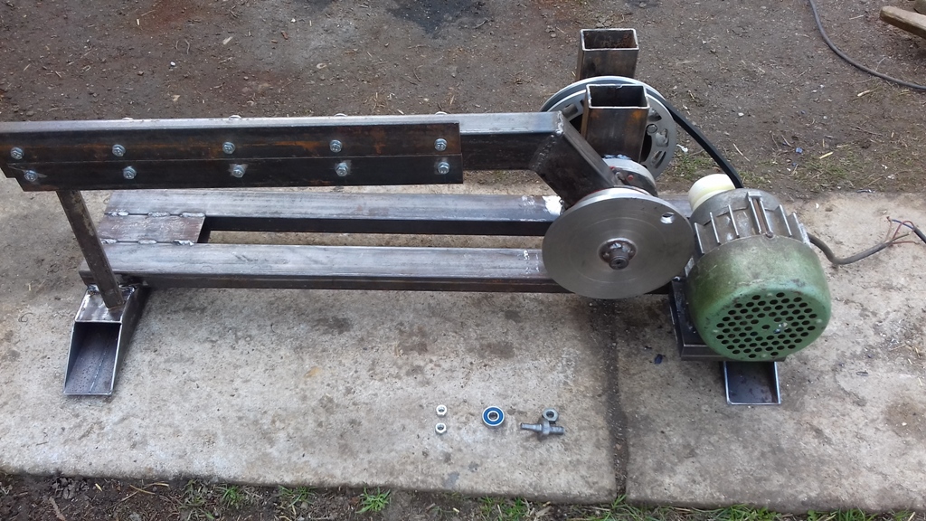

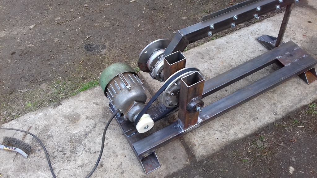

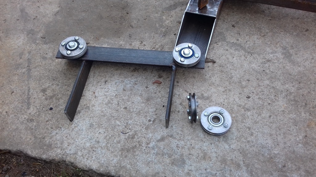

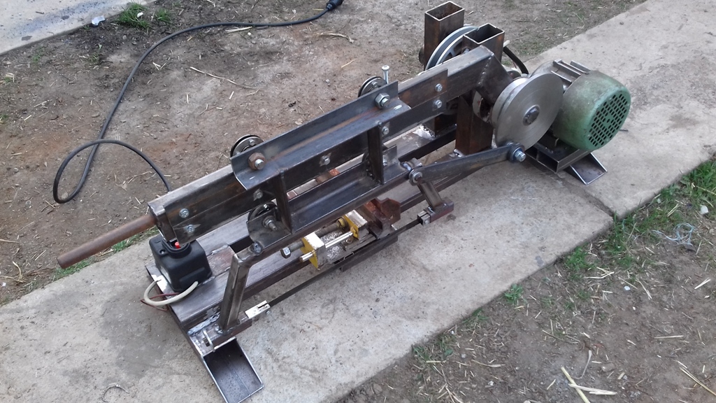

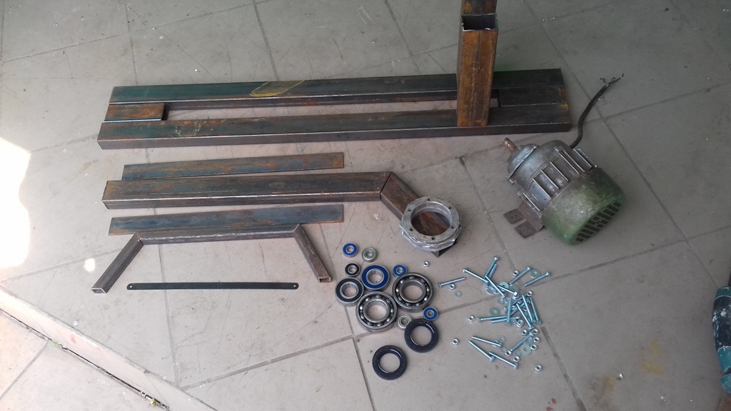

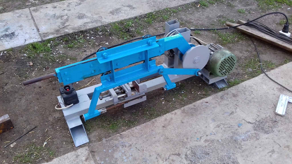

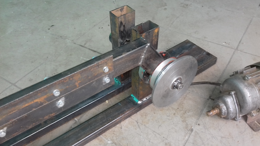

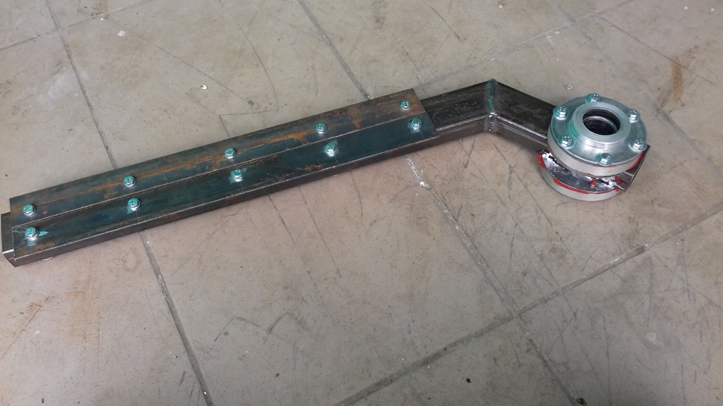

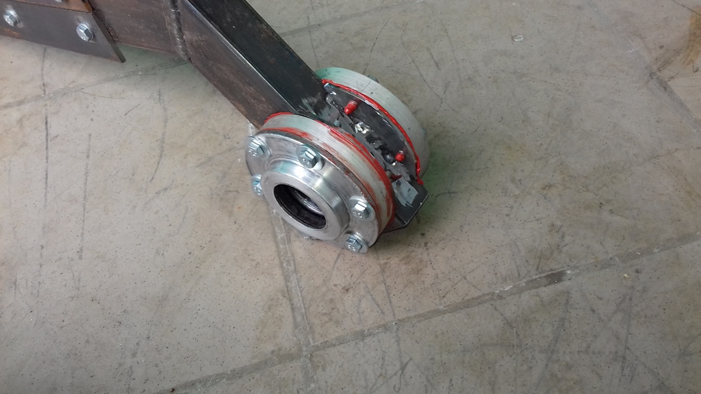

Hello. Sometimes I'm angry with the angle grinder, a lot of noise of dust and sparks. So I decided to build a Power Hacksaw. It works very quietly, and while it cutting you can do other things, hacksaw is automatically shut off.
Attachment 29566 Attachment 29567 Attachment 29568 Attachment 29569 Attachment 29570 Attachment 29571 Attachment 29572 Attachment 29573

Nice build Vyacheslav,
I made one some years ago and have used it a lot its on my builders page.
A suggestion if you dont mind is you could fit a No Volt Release switch, it is easy to forget that the machine is still live if you have if you have been doing something else while it is cutting. I retro fitted one to mine for that reason.
Regards
Olderdan
Job well done Vyacheslav, very well executed, turned out nice and works great, thanks for sharing !
Doug
