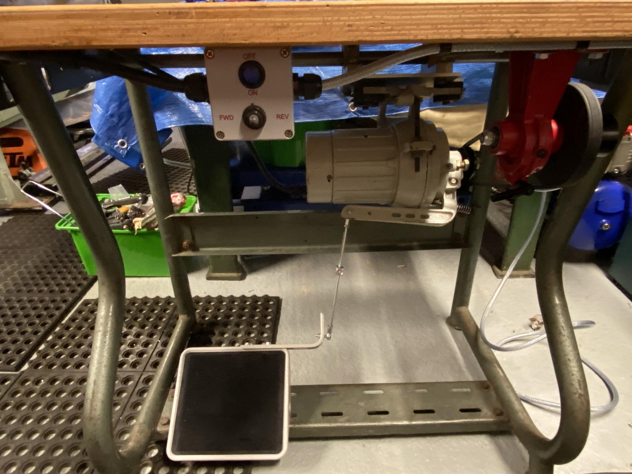

    The idea is to have a interchangeable system so I can simply bolt the tool required tool to the table slip a vee-belt on the pulley and use it under controlled speed (rpm) hands free to guide the workpiece.
    So the photos below show the table build to table top where the tools will be bolted in place. I have ordered the vee-belts so will wait to drill the top until I am happy all works and lines up as expected.

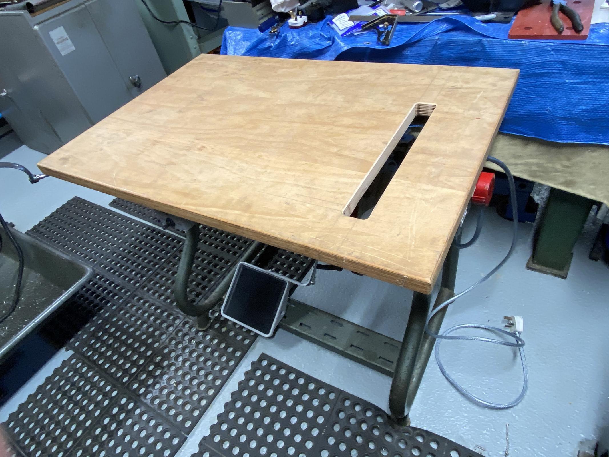

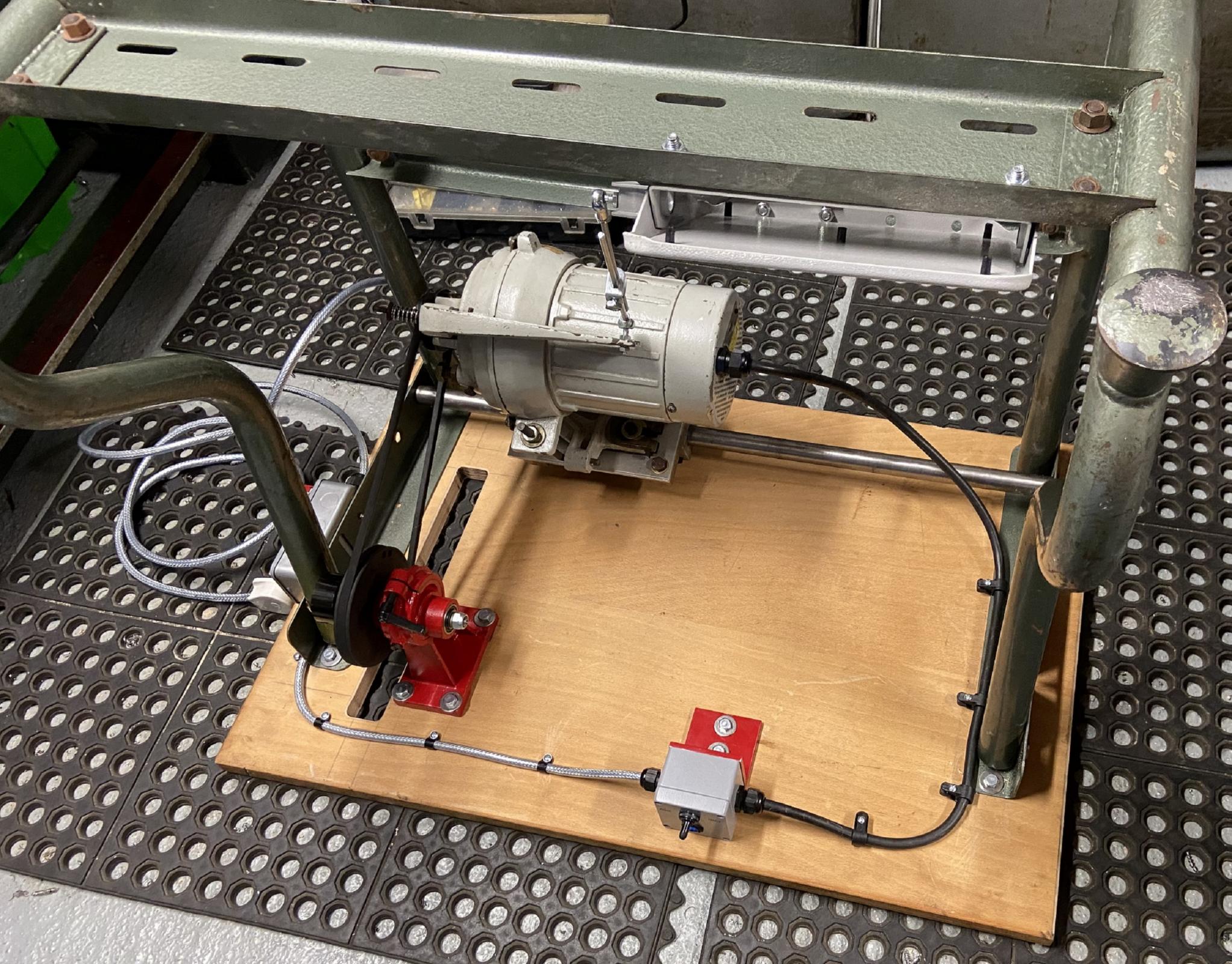

    Table ready for tooling to be bolted to work top. The slot allows the vee belt to drive the machine from the bottom drive
    Underside of the table showing motor, switch, pulley block and main metal frame.

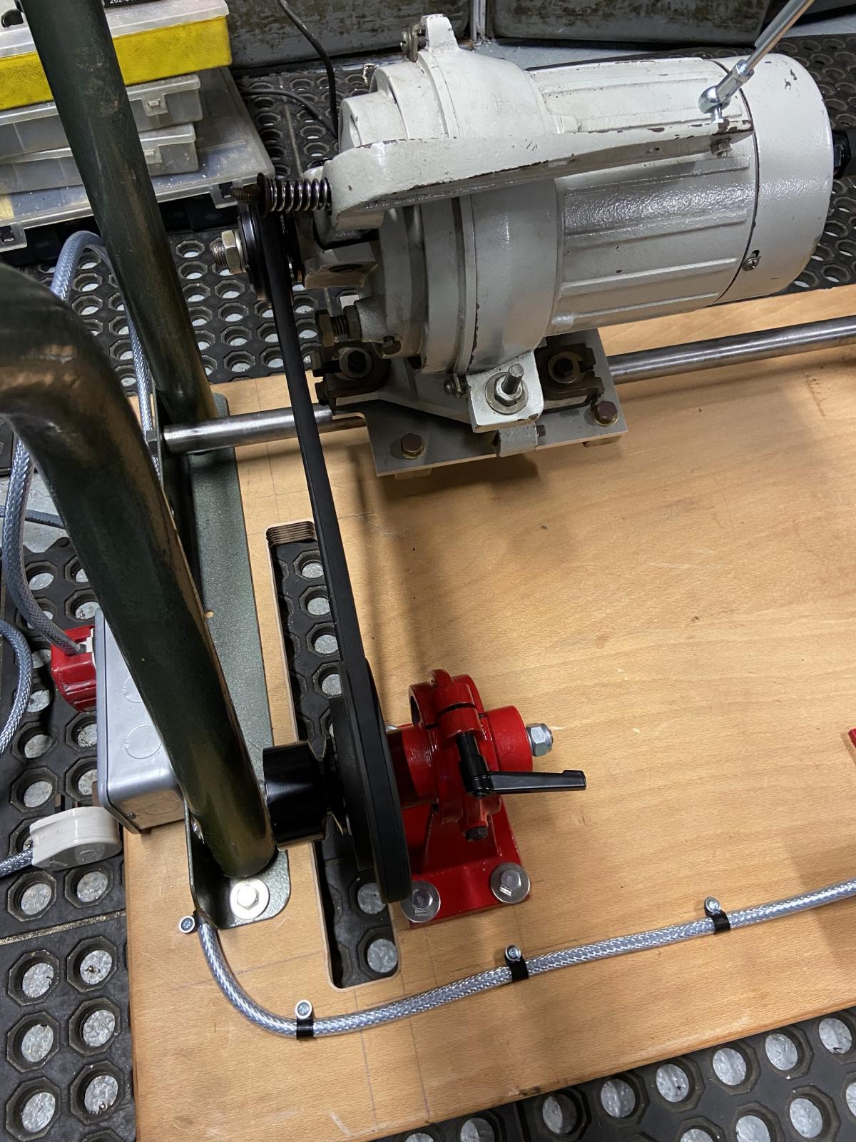

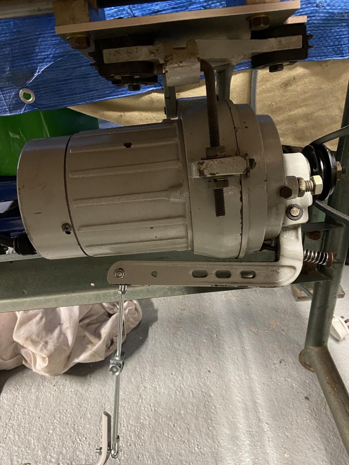

Name:	pulley drive.jpg
    Clutched motor. The belt is off set for a reason, when the clutch is operated it moves the drive pulley towards the motor so the two pulleys are in line when fully engaged.

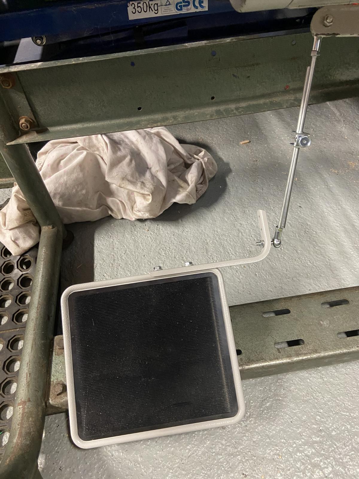

Name:	pedal and motor.jpg
    Foot pedal linkage to clutched motor. The linkage is called a Pitman Rod.
Name:	foot pedal.jpg
    Foot pedal.
Name:	clutched motor.jpg
    Industrial clutched sewing machine motor

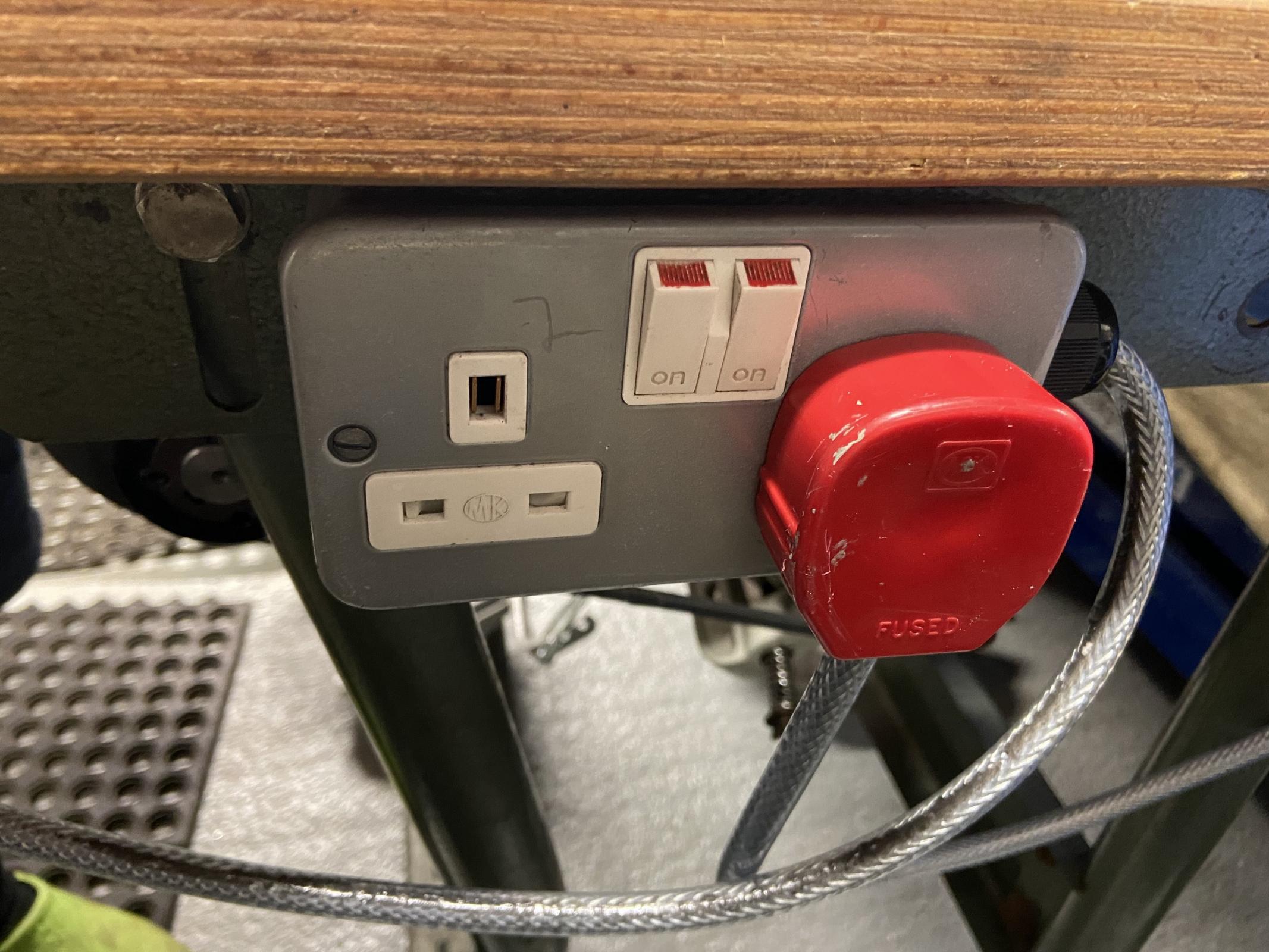

    I have added a double socket so a light can be used from the second outlet.

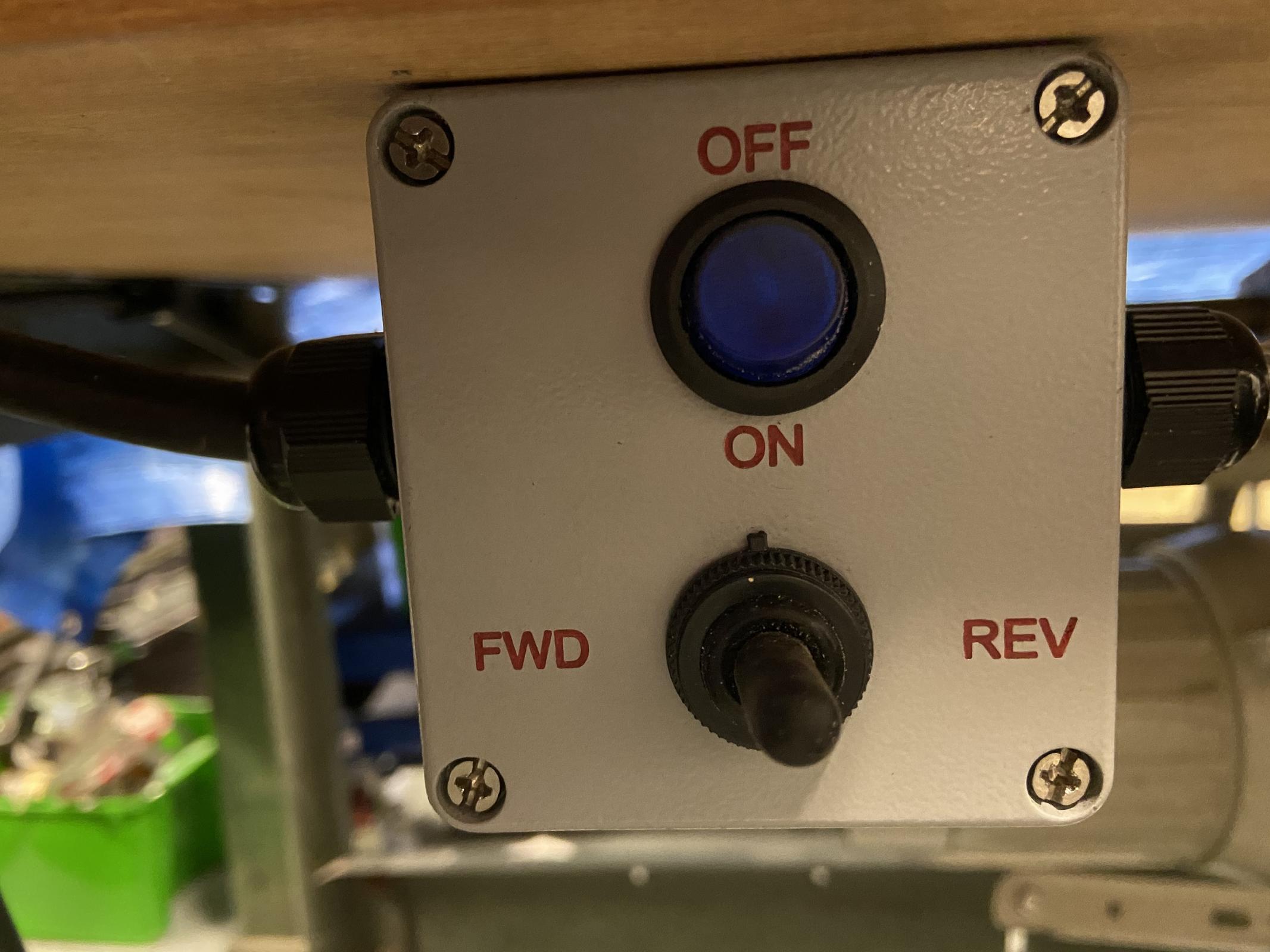

    Switch engraved rocker switch ON/OFF and toggle switch for direction

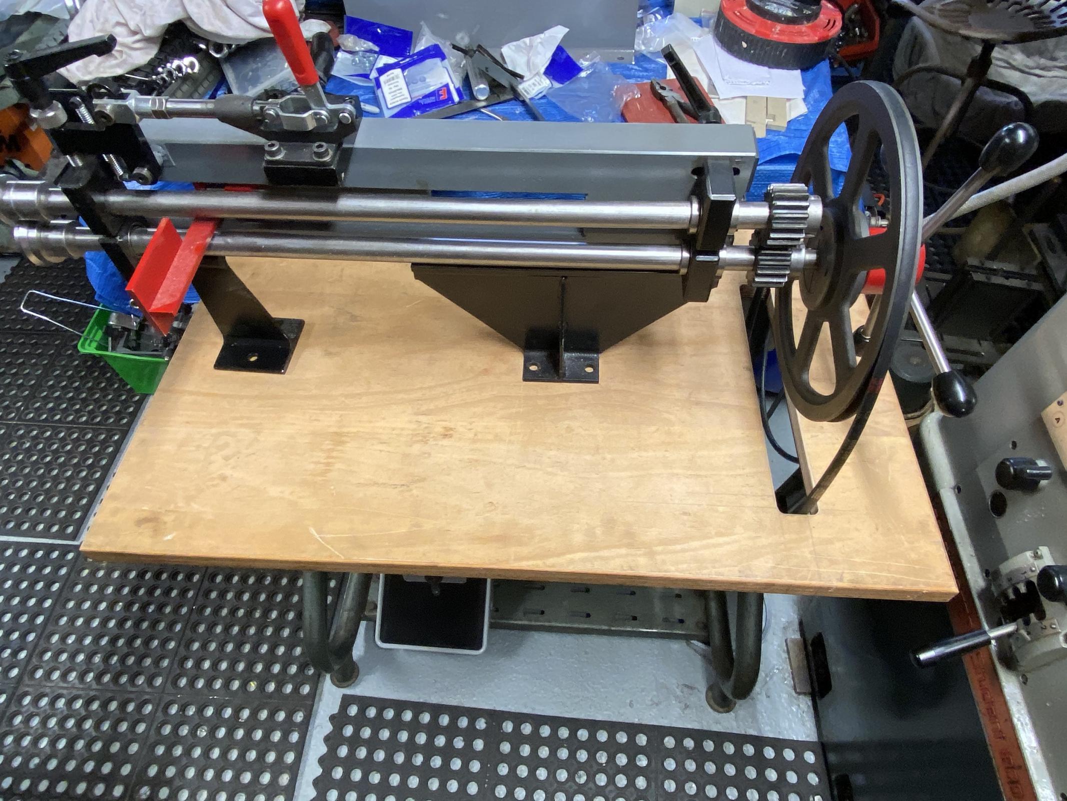

Name:	bead roller.jpg
    Bead roller just placed in position to show vee belt coming up from bottom drive. (on going) The tooling will be bolted to the table top via 8mm Prong tee-nuts.
