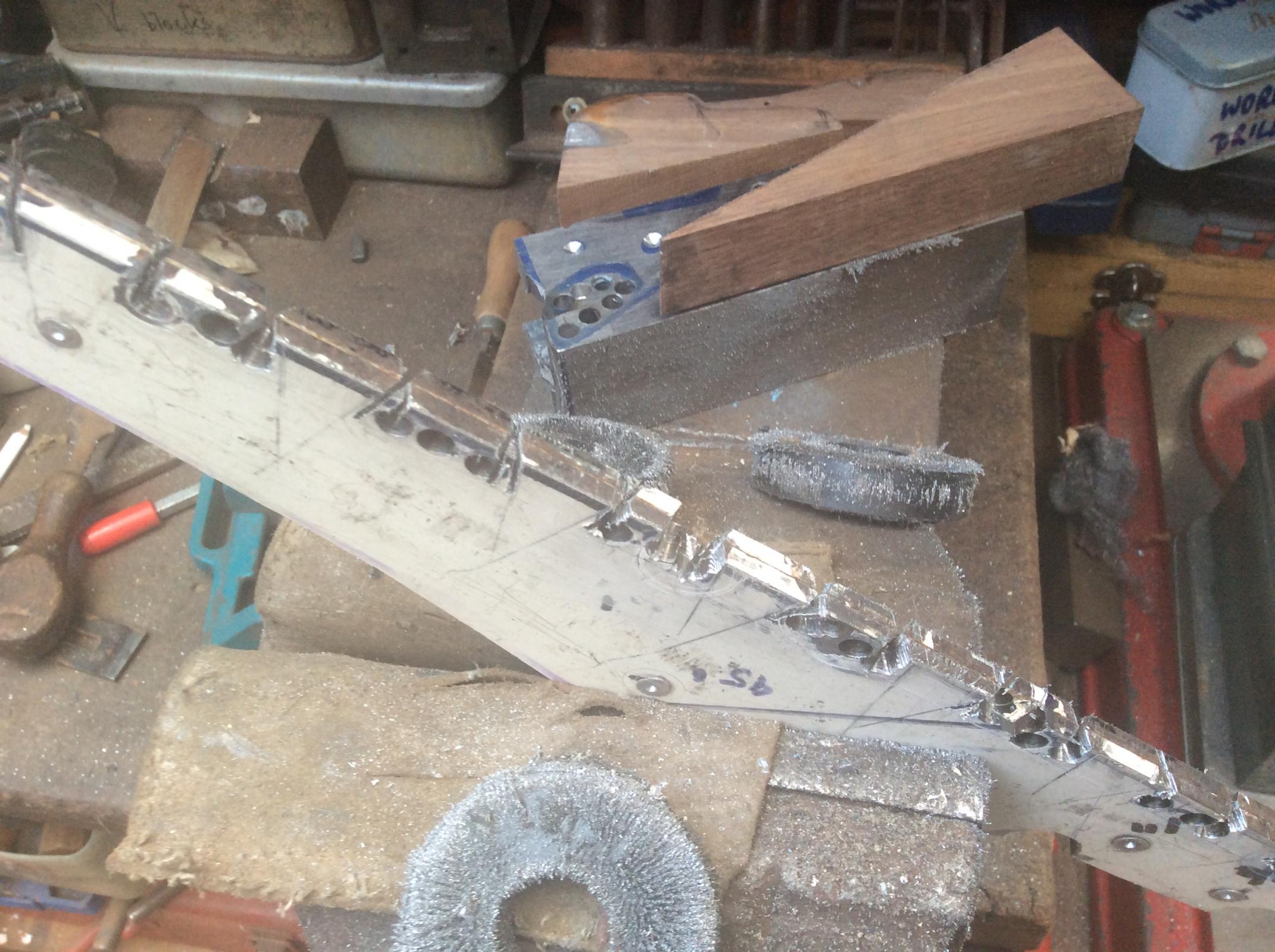

    The book in the picture is “Making & Modifying Woodworking Tools” by Jim Kingshott. He recommends practising the technique of dovetailing, before embarking upon making a plane. You can see that I have begun my practice piece, using bits of scrap. I have never cut dovetails in steel before. To fit them, you have to leave excess on the tails, and peen them to fill the gaps, not like you would fill the gaps with glue and sawdust. (Note irony)

    Trouble is, the more you hammer, the more the sides bend in. Can you make out the gap? It’s distorted by 2 degrees, and I have peened only one pin.
    Kingshott recommends packing the body with hardwood, and clamping it firmly in the vice.
    I would say that this is an abuse of a bench vice, so I clamped to an anvil, but significant movement and damage occurred to the packing, so next time I shall pack out with steel.
    Kingshott also says that you don’t want the mouth adjacent to the tail, because this cuts the sole right acrossClick image for larger version.

ID:	34823But this is view of my piece is on the page showing his mitre plane. The sole is cut right across.
    I would be glad to hear the views of people who have made these type of planes. During lockdown, I plan to make three.
