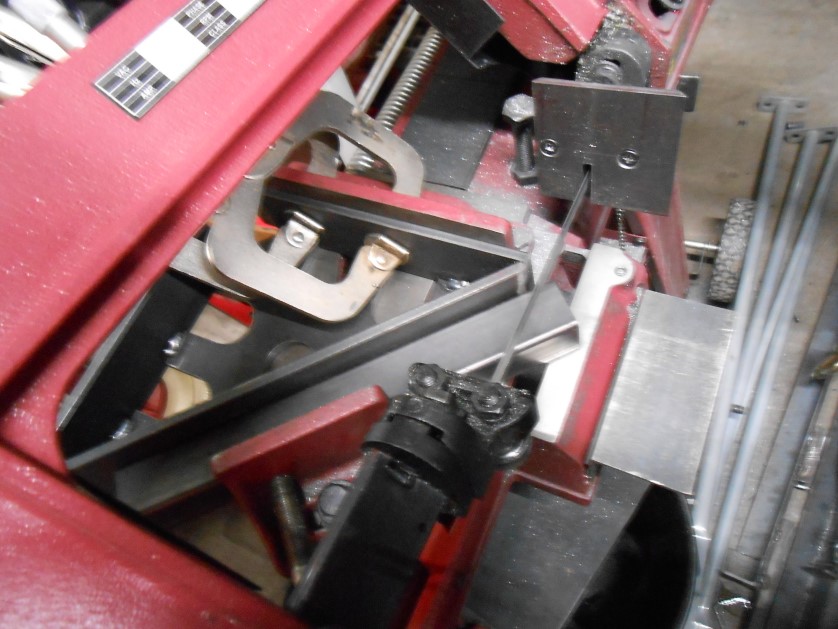

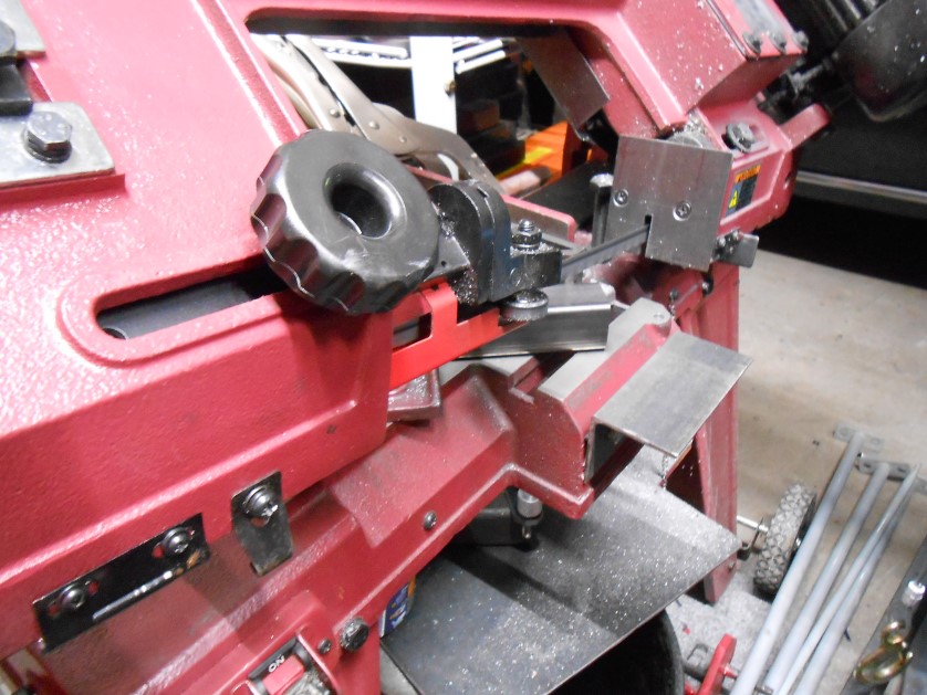

You finally got the fence on your band saw set to a perfect 90 degrees! Life is great! :clapping: But now, you need to cut some 45's. :mad:

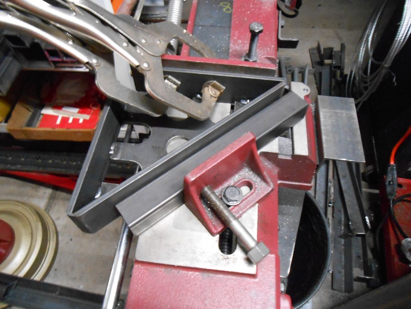

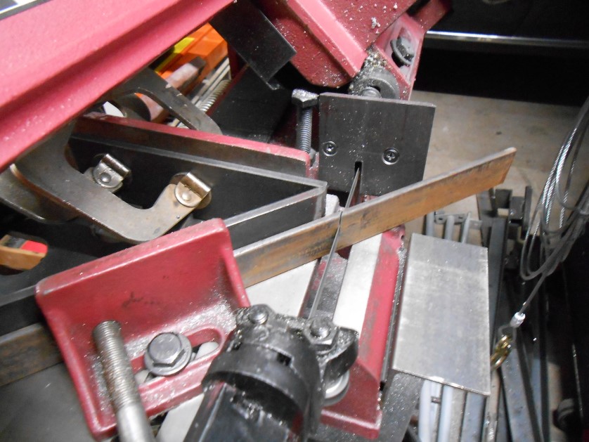

Don't change that fence position! Simply clamp in a Fireball square (or in my case, a "tribute" to it) and your set! (ok, you'll have to loosen the one bolt on the moveable part of vise to clamp your work piece in but easy enough. 17mm in my case)
A great way to give an existing tool a new purpose. And if you are feeling ambitious, you could make a few similar squares in other commonly used degree's. 22.5 might be a good one or whatever you might use a lot.
