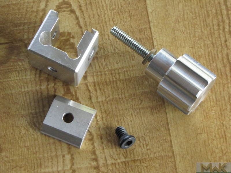

    This picture shows the component parts. Top left is the clamp assembly that attaches to the tripod; note the tiny dovetails. To its right is the screw and knob that clamps the two dovetailed arms together. At lower left is the dovetailed foot that attaches to the camera with the 1/4=20 screw at lower right.

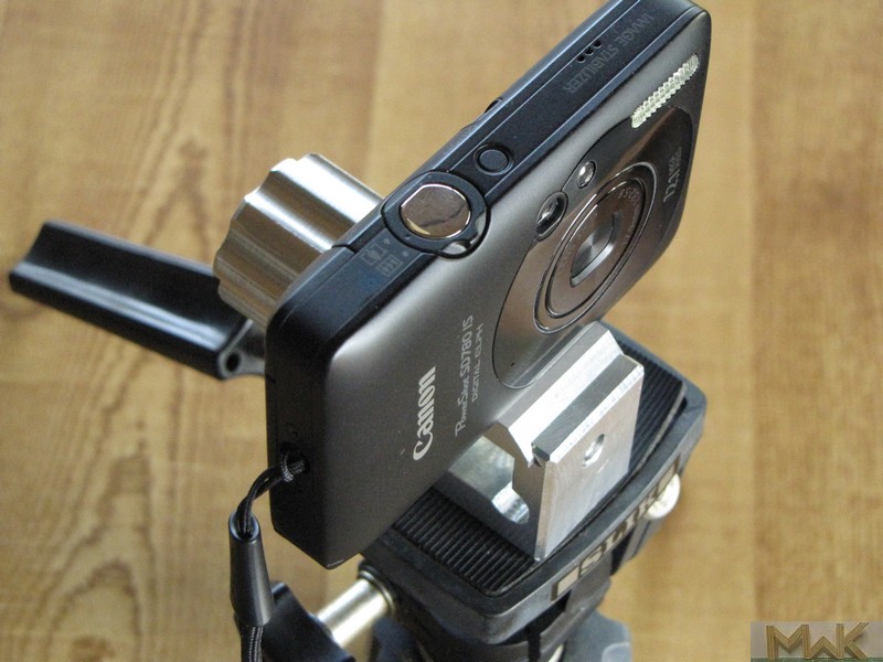

    This picture shows the quick release clamp assembled and attached to the tripod using the screw that would normally be used to attach the camera.

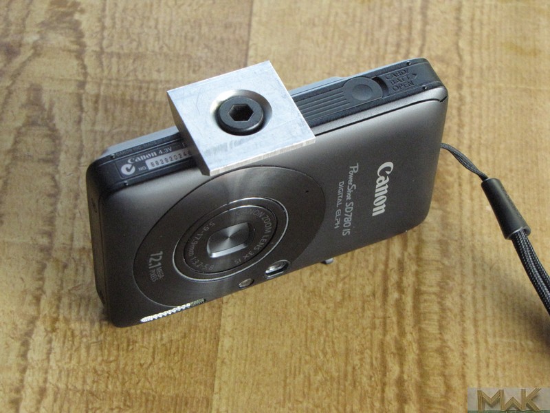

    And here is the foot attached to the camera with the 1/4-20 screw. (I used my pocket camera so that the camera wouldn't interfere with the photos. Usually I would have the foot on one of my larger cameras.)

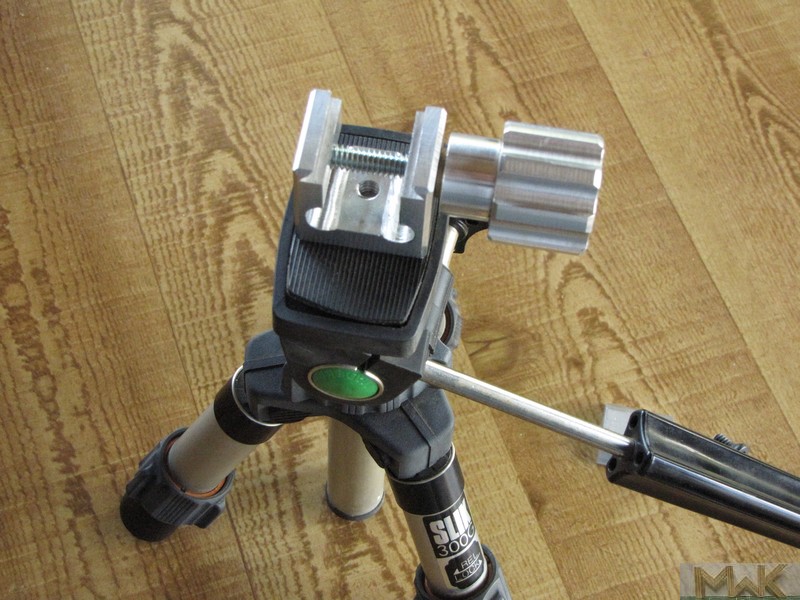

    Finally, the camera is mounted to the clamp. The foot slides into the dovetails in the clamp and a quarter turn of the locking knob locks everything tightly enough to support even a heavy camera.
    There's nothing sacred about my design. Feel free to add your own nuances. However, the foot should be smallish since you'll want it to stay on the camera more or less permanently and its design should be simple so that you can easily make one for each of your cameras. The screw that secures the foot should be countersunk/bored into the foot so it doesn't provide a pivot point when the camera is set down on a flat surface.
