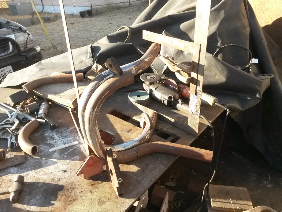

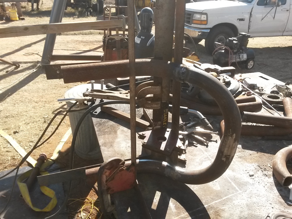

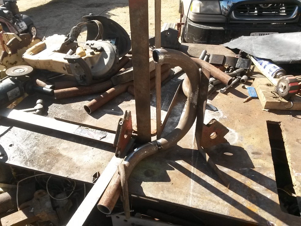

You can never have too many framing squares. I'm sure if I were to search through every tool storage area I could dig up a dozen of them.
Many times I will use magnets and framing squares as a set up jig. I don't always need to hold a part in place as much as I need to hold a location in space
Attachment 31846
Attachment 31847
Attachment 31848
