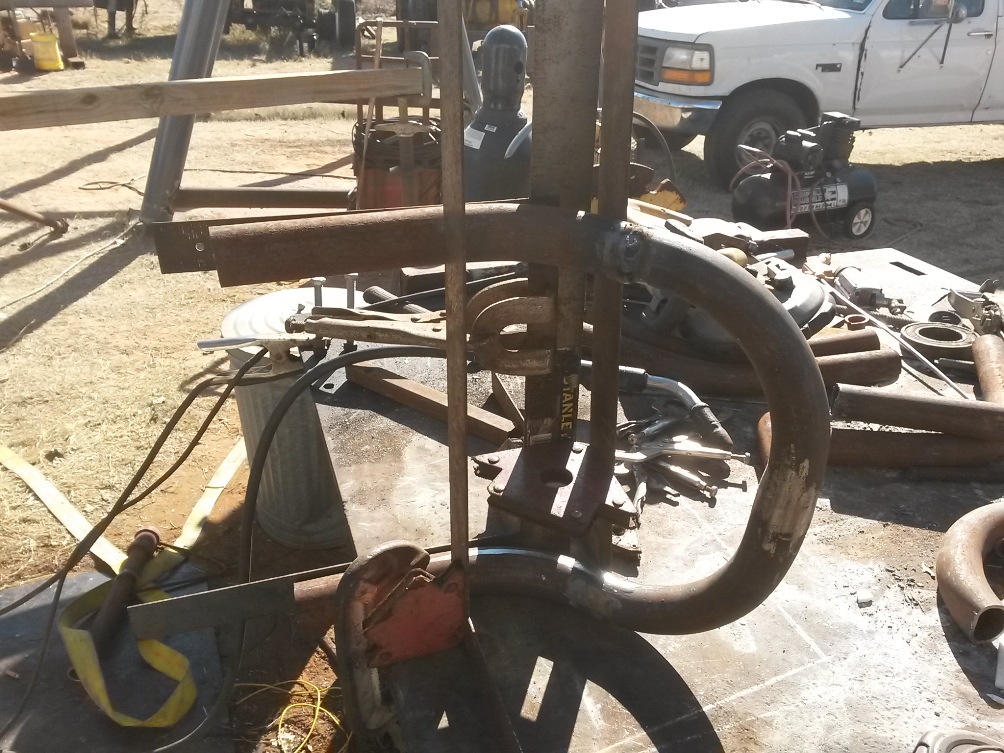

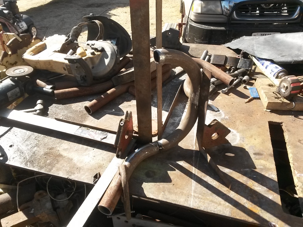

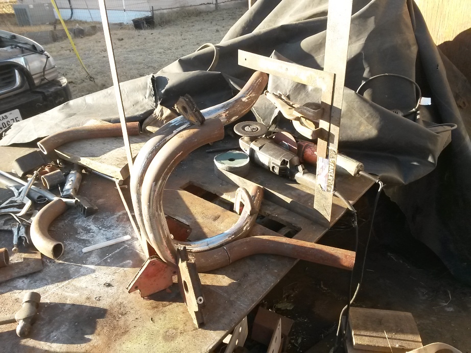

Thanks Frank S! We've added your Setup Jig to our Metalworking category,
Machining, welding, prototyping, even photography; a proper set-up is all about stability first, and repeatability is unquestionably next.
Frank S's rig is classic example.
X-Y tooling can be complicated dimensionally, but Z is where things get interesting. It is all about using the same datum for as long it is possible.
11 Nov 2019 edit.
Strikes me this morning, that datum phrase could better express the idea this way; It's all about preserving the datum for as long it is possible.
I'm finishing a long awaited run of parts for myself later today. It will exhibit that concept, including mating parts that one uses the other to index accordingly. Utilizing all three Cartesian axes.
