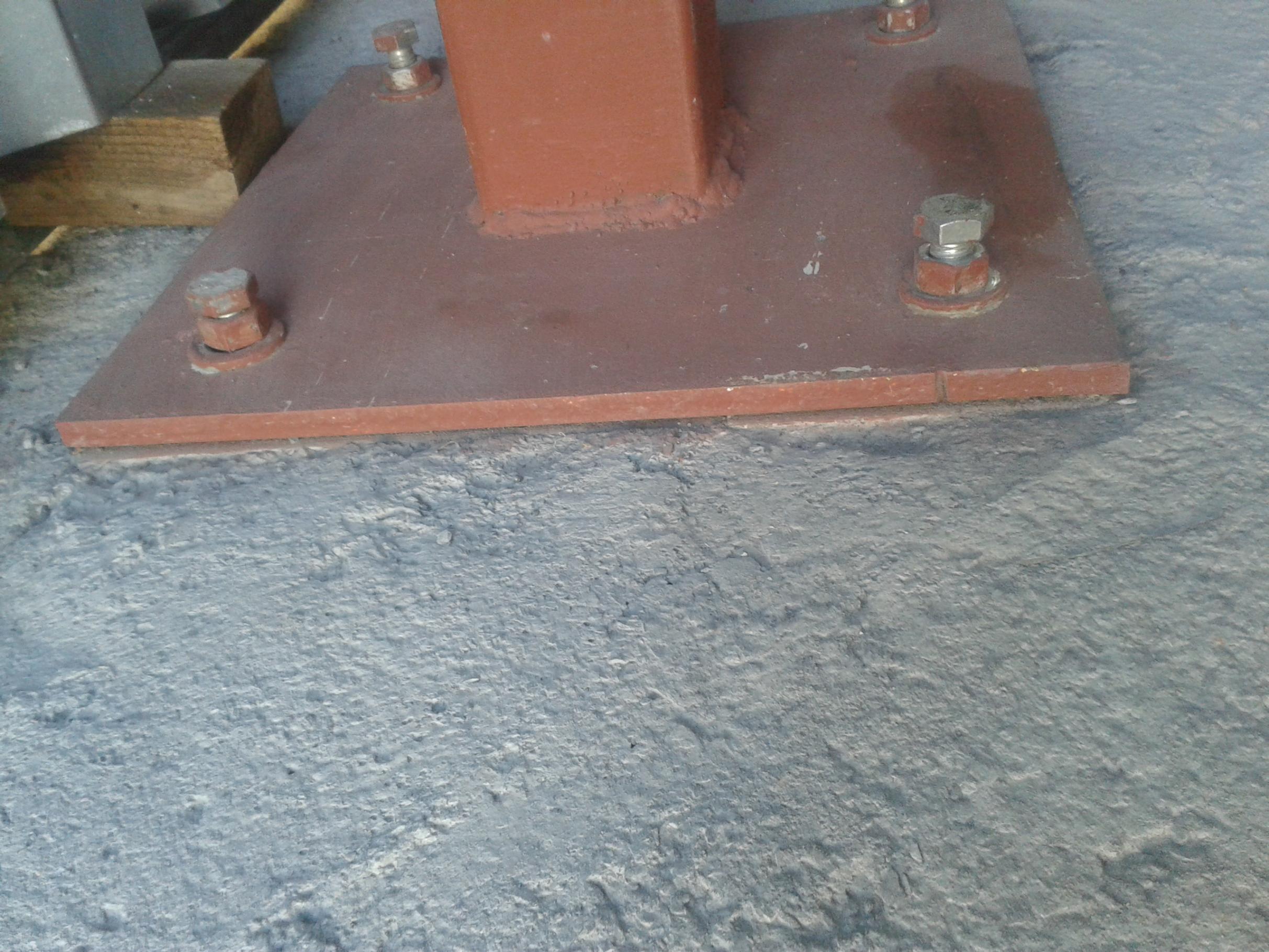

    Removable pole stands vise base
    Removable pole stands vise base made it from steel plates, round bar & tube
    Also can be mount at three pos left/right/front.
    Materials
    steel plates:.2pcs 300x300x10mm 1pcs 200x200x8mm
    round bar ø18mm : 4pcs 150mm
    bolts/nuts M12 4pcs
    tube 80x80x3 mm 800mm
