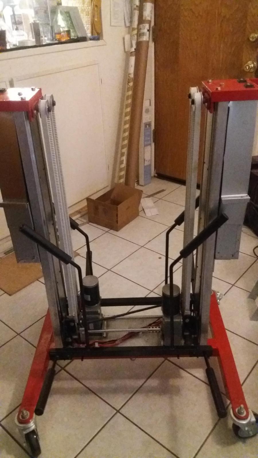

    I am the inventor of a patent pending two tire lift, this lift carries one tire in front and one in back, but the back becomes the front with the rotation of the top portion of the lift, this makes it easy to do a tire rotation on a hoist, my two tire lift can be used any time tires are removed from a vehicle, for brake jobs, front end work, and so on.

    Nice idea and probably a good market concept - good luck with your patent!
    IMHO it looks like two 200 W worm drives (of which I have quite a few, and use for workshop tables and hoists),
    working thru toothed belt drives, where the batteries and control boxes are under the side support covers?
    Back in 1977-78 I worked extra at a truck, equipment & auto tire shop/ retreading facility, where we used in-house built,
    rugged, hand-wound Truck wheel "forklifts" for the same purpose, albeit not with your 2-tire, revolving capacity.
    Just stickwelded hot rolled RHS and U-beams, some sealed ball bearings for the moving platform,
    cast pulleys, 8" 500lbs SWL castors and a locking hand winch.
    All covered in the company's hideous, undescribable blue-green bile enamel.
    These were self-explanatory, easy to use, lo-maintenance, easily hosed off friday afternoon and dirt cheap.
    The following is not intended as criticism, though I realize it could be perceived so:
    Two (totally uncalled for) cents regarding your device:
    -What'll happen when dust, grit, grime, salt and sleek from the wheels & shop enters the mechanism:
    especially between the bottom drive pulleys and belts,
    and what do the slide's bearings consisting of? Sheets/ rollers of acetal?
    Feel free to give further info on materials, battery/ motor capacity, max SWL etc.
    Cheers
    Johan, (who isn't "into rubber" any longer.)
    Can we see it working?

    Thanks steven Sauer! We've added your Revolving Two-Tire Lift to our Wheel and Tire category,
    as well as to your builder page: steven Sauer's Homemade Tools. Your receipt:
