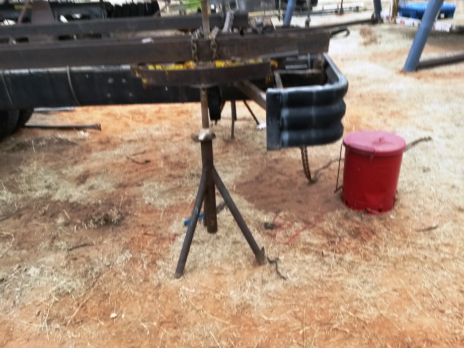

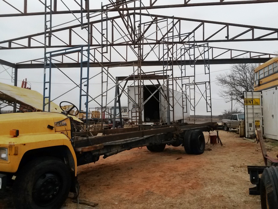

Now have all of the scaffolding mounted on the bus chassis all of the bracing in place and secured the scaffold is chained down in multiple places holding not only the scaffold in place but the postal carts and the beams as well. The only way anything could fall of would be for the bus to roll over and that is not likely to happen since I am using jack stands under the ends of the postal carts to serve as outriggers further stabilizing the structure.
What I should do now is to add planking on top of the scaffold maybe I can get that done tomorrow
Attachment 32205
Attachment 32206
