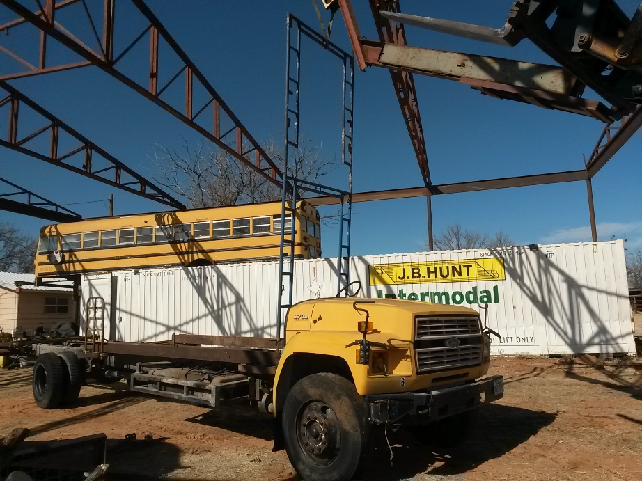

    I started constructing a rolling scaffold set up to aid in the construction of my shop and hopefully once I get a full length platform constructed it will save me a lot of climbing up and down
    First off I needed to take down some of the scaffolding from the South side of the building to use in this um thing.

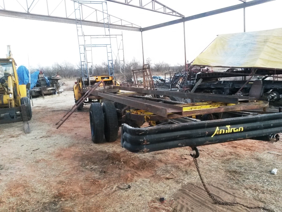

    the Feet of my scaffolding fit nicely into the H beams

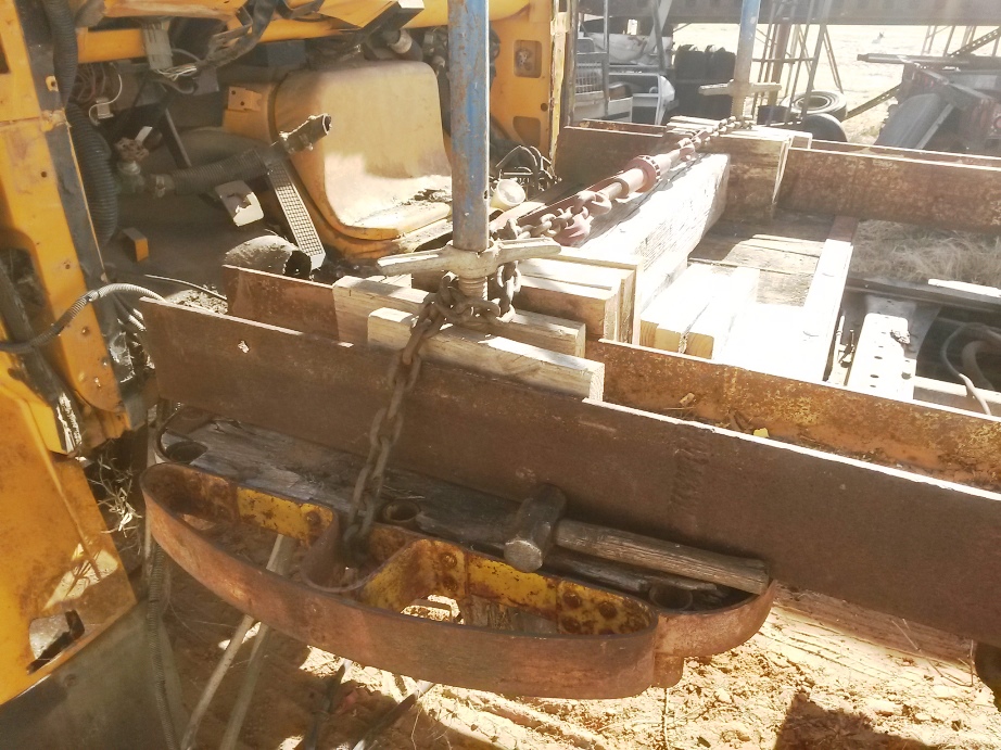

    I used 3 postal service warehouse carts as the crossmembers for the base of the scaffolding
    then chained everything down to the bus frame

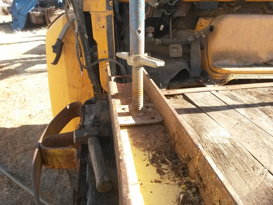

    once all of the scaffolding is erected and tied together with a platform on top it will be easy to move around and a lot safer than just having a single rolling section to stand on, not to mention I will be able to reach 3 trusses at the same time without having to move this will help in installing the purlins and the insulation panels then I can turn the bus to run along the truss line for beginning the first couiple of sheets of roofing after the first couple then most all work will be done from above anyway.
