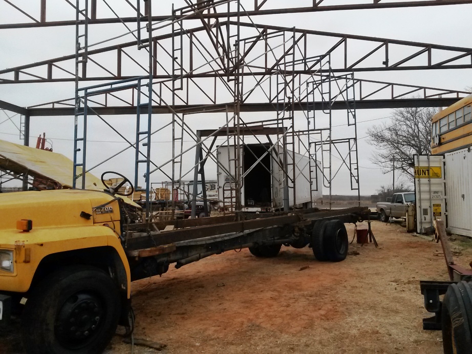

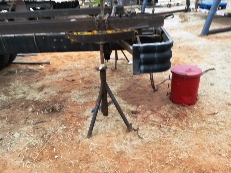

    Now have all of the scaffolding mounted on the bus chassis all of the bracing in place and secured the scaffold is chained down in multiple places holding not only the scaffold in place but the postal carts and the beams as well. The only way anything could fall of would be for the bus to roll over and that is not likely to happen since I am using jack stands under the ends of the postal carts to serve as outriggers further stabilizing the structure.
    What I should do now is to add planking on top of the scaffold maybe I can get that done tomorrow

    I do have one thing I'm going to do before the purlins. That is to "X"cable brace it and check for squareness
    Checking square on this large a structure has to have some trick you know about. Just seems real tough to measure the long distances from the peak to the opposite eve corners.
    So are the perlins installed at the same spacing as the original ones? I assume you have to reuse the same roofing holes that use the self tapping screws with the rubber seal grommet. Unless you have some method of filling the holes in used sheeting.
    It would be next to impossible to guarantee all of the holes would strike over the purlins. there are several ways to fill the old holes some better than others and some quite time consuming. One of the flex seal products would work quite well. Ceramic coat roof sealing paint works even better while being UV stable it deflects much of the radiative heat away from the metal But there is still another way that will do nearly the same job while being cheaper that is to use plain old white latex house paint that has metal adhesion properties, and mix in fine ceramic blasting media that can be bought at HF or northern tool the media helps to bridge the holes and adds some to the thermal barrier properties.
    As far as the squareness of the building goes the 4 corners were shot in to within half an inch diagonally when I set them. SO basically what I will do is to cordon off 4 15 ft by 15 ft squares at each corner add in some bracing then cable pull to square them, this will pull the building close enough, since it is in actuality really just a glorified pole barn as long as it look square from half a mile away is close enough LOL.
