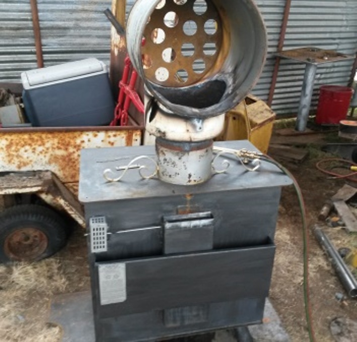

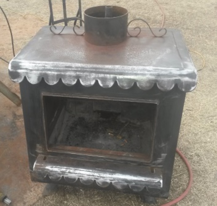

    My Earth Stone wood heater did a fair job as manufactured but I knew from past experiences that it could do much better.
    I decided since I needed to pull it out of the house and replace the chimney anyway I might as well do a couple of mods to it

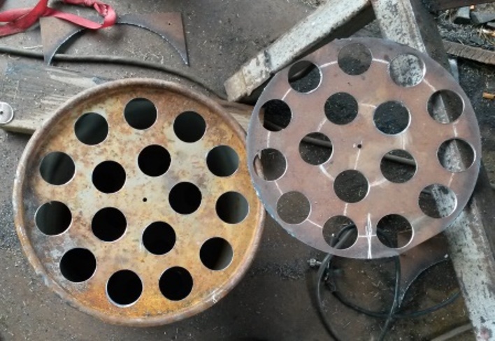

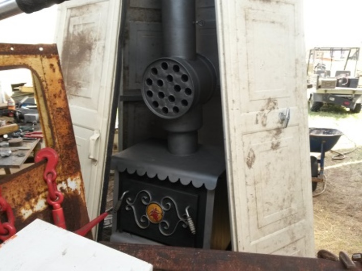

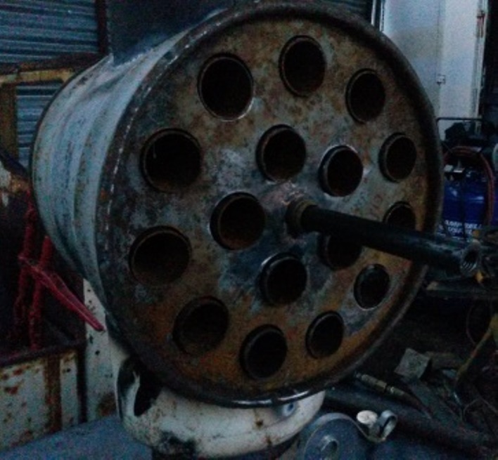

    First off I wire brushed it down and repainted it in 2 tone Charcoal gray with KBS Extreme temp paint dark on the lower then I made the recovery unit out of a 15 gallon shorty drum by hole sawing 15 holes in the top and bottom and a 3rd disk to put inside to serve as a means to drag the coke build up off the heat tubes then I welded in the 15 1.94" diameter 16 ga tubes then welded the top to the drum with the clean out plate inside and a pull rod to push or pull it back and forth. after I cut a 11" diameter hold in 1 side and an 8" hole in the opposite side I welded a section of an old water filter tank to 1 side then cut an 8" hole in that I formed a piece of 16 ga into an 8" - cylinder and welded that to the dome of the tank this formed an expansion chamber to allow the stove exhaust to spread out exposing more of the tubes to the the heat. then on the now top of the unit I welded a section of 8" chimney pipe and installed a damper which the stove never had before, which had allowed much of the thermal energy to be lost up the chimney then I painted the top of the stove and the added bits with KBS extreme temp light metallic Charcoal gray.

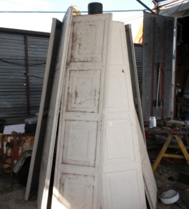

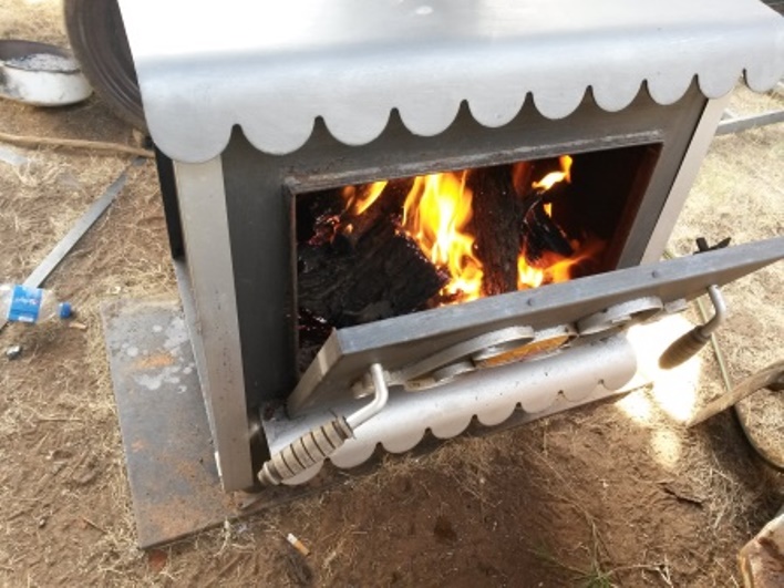

    This paint must be heat cured to 350 to 400°f for a minimum of 3 hrs before the stove could be returned to the house otherwise the fumes can be toxic to some people and they smell really bad anyway. So I built a fire in it then as the fire got hotter I stoked the stove completely full of mesquite
    Mesquite burns really hot To help trap some of the radiant heat to further assist in the curing of the paint I made a makeshift thermal enclosure by stacking steel garage door [panels all around the stove . With the intake air regulator wide open and the draw damper set at 1/2 I let it bur for several hours probably 3 to 3 1/2 then I opened the door and saw that I could stuff some more wood inside so I added another wheel barrow full and let it burn the rest of the day and into the night. This morning it had gotten down to 33 ° but when I went out and checked on the stove it was still warm

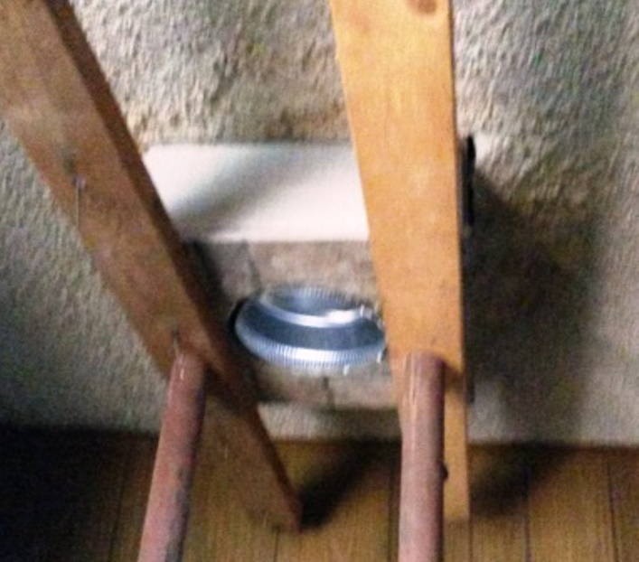

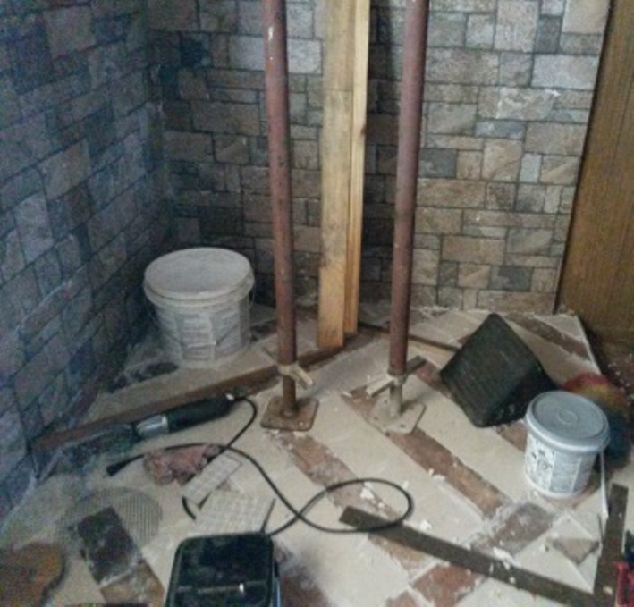

    Ceiling support jacks made out of pipe and scafold screws to hold the ceramic tile against the transition box until the cement dries.

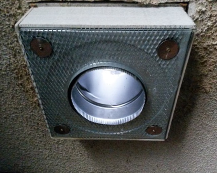

    I screwed lathing to the bottom to the transition box to give the cement something to hold on to
    The transition box is 16" sq. and I affixed 2 layers of 1/4" cement backer board on the 4 sides extending almost all the way to the roof the chimney is 8" ID 12" OD triple pipe stainless steel inner pipe

    The stove will sit on a 5 ft by 5 ft 4" thick raised concrete slab the fire protection walls are 5 ft high
    I screwed 1" firing strips to the walls then added 2 layers of 1/4" cement backer board then covered that with 3/8" thick ceramic tiles with a brick pattern there will be a heat deflecting mantle on top of the fire walls which will be clad in ceramic tiles and later have LED strip lights hidden under them for lighting effect

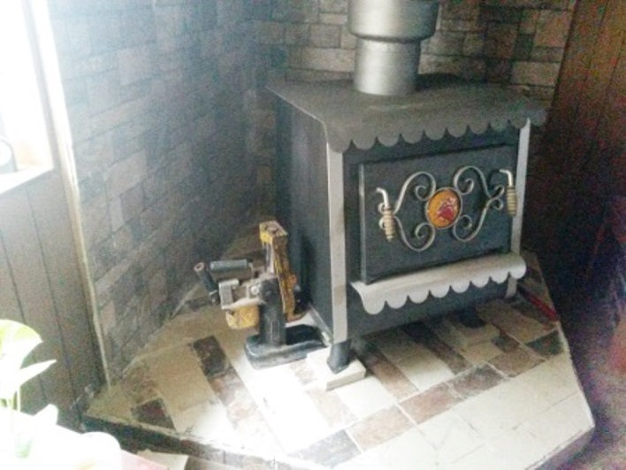

    Well today was time to re install the wood stove
    I have been wanting an excuse to use my Stanley 12 ton hydraulic toe jack for a year
    since the stove is a fixed height and the chimney is fully installed the stove had to be raised an inch to force the stove pipe into the receiving part of the transition box to make sure the pipe had a good seal I pushed it up to an inch and a half
    I think it looks good all I need to do now is to clad the mantle with ceramic tiles and find me one of those really slow turning antique fans to place in the corner behind the stove on the mantle

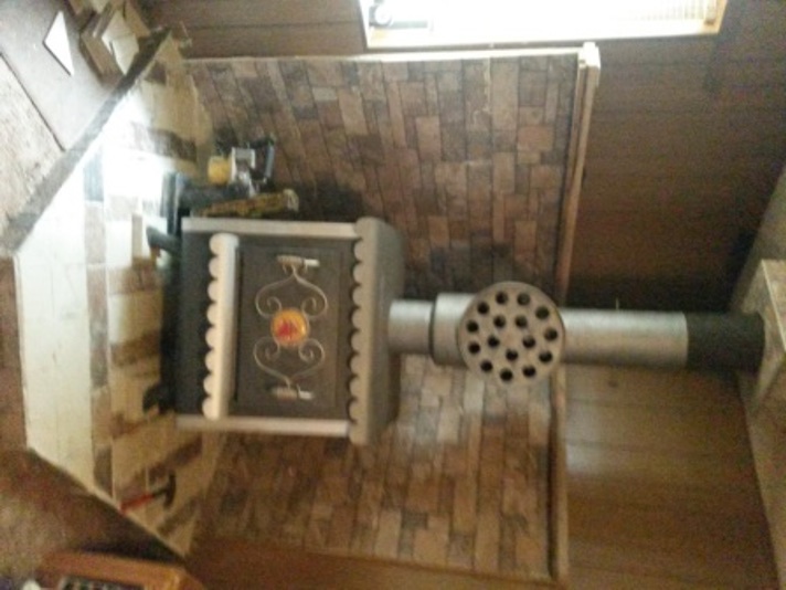

    Any way the heat recovery unit worked well except for a couple of issues which I will address when I build a stove for my workshop and install it there.
    I found that I had to maintain a very hot fire in the stove in order to prevent coking or creosote buildup. I used the cleanout disk several times but found that it was a lot of trouble eventually I had to use a slide hammer just to get it to move back and forth so I removed the unit. I wish now that I had flattened the tubes to an oval which would have meant the exhaust gases would have a higher velocity and would have remained hotter until reaching the chimney. There is a fine line between the amount of thermal recovery and maintaining a high enough exit velocity to insure proper combustion has occurred. Different wood has varying amounts of creosote in the unburned exhaust. The introduction of forced air at the fresh air intake would reduce the criticality of maintaining a hot exhaust to insure proper combustion and a complete reduction of materials to ash without creating the creosote residue in the chimney.
    After removing the unit, leaving the original straight stack to preserve heat I stacked 250 lbs. of 6 inch ceramic tiles on top of the stove, creating a thermal mass for heat storage. In doing this I found that I could build a medium to large fire of an evening with a small 8 inch fan behind the stove on the mantle and the ceiling fan on low with outside temps falling into the low 20’s or even down to single digits re stoke it once around midnight to keep the front half of the house comfortable so I blocked off the back half since we are only using the back 3 bed rooms for storage anyway I also burned through less than half the amount of wood we were previously using
    So there you have an update to the heat recovery unit at its present design there needs to be forced fresh air to create higher combustion temperatures or the tubes need to be oval possibly a combination of both
