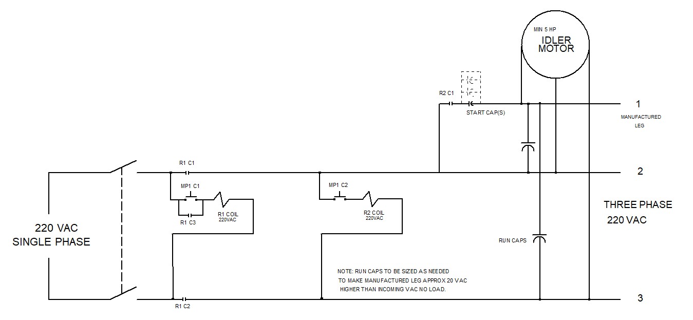

    I have been using this in my shop for over 20 years. I have built at least 20 different various sizes.

    Thanks everyone I hope it is useful. I have ran, under load, 1hp surface grinder with coolant and hydraulic pump, 1 hp milling machine, 5 hp lathe, 20ton obi press, 3ph bandsaw, all at one time with no problems. I had a 10hp idler at the time.
