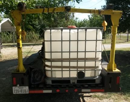

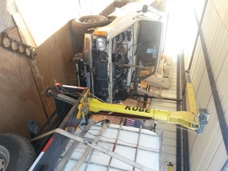

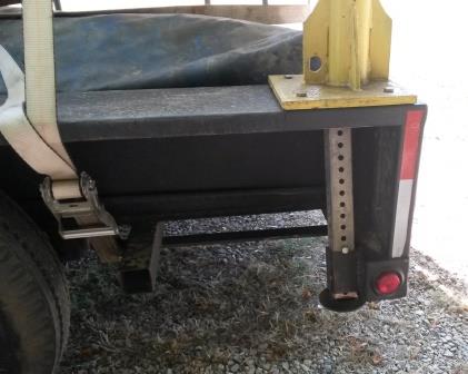

    I can now consider this trailer an actual tool actually almost a multi-tool
    with the addition of 2 small cranes it is a self loader
    It also doubles as an engine hoist on steroids
    can use 1 or both for removing or installing very handy
    the drop down legs when needed will keep things stable

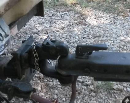

    A 2" ball hitch is fine but when it is part of a pintle hitch this is like having a belt and suspenders you just got to know your pants are not going to fall off

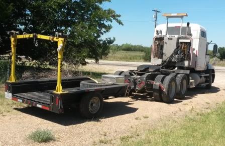

    Also perfectly happy to be towed behind a big truck

    The cranes work great I filled both of the 225 gal totes with water then hauled them 14 miles and unloaded them with the cranes with the drop legs supporting, this made what could have been a difficult task much easier.
    Actually I have been thinking about duplicating the little cranes and adding 2 more to the front of the trailer

    I made my trailer strong enough to accept these cranes with them in mind while I was building it.
    To answer your question as to why 2 of them. this gives me the option to load from either side of the trailer without having to move it also 2 cranes together can lift 3000 lbs I have used them to lift those totes full of water as well as to load lathes and mills by working them in tandem and using a 2 part line and connecting them to the center ring of a 2 or 4 hook sling it gives me a safety factor that I wouldn't have if having to do the lift with only 1 crane.
