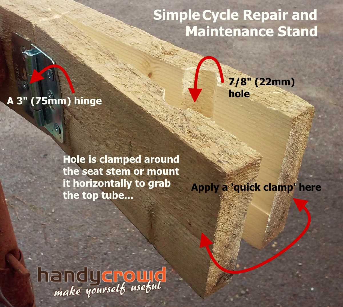

This is what I came up with using a pallet bearer (2"x4") a hinge, a 22mm drill and a quick clamp (or three!)...

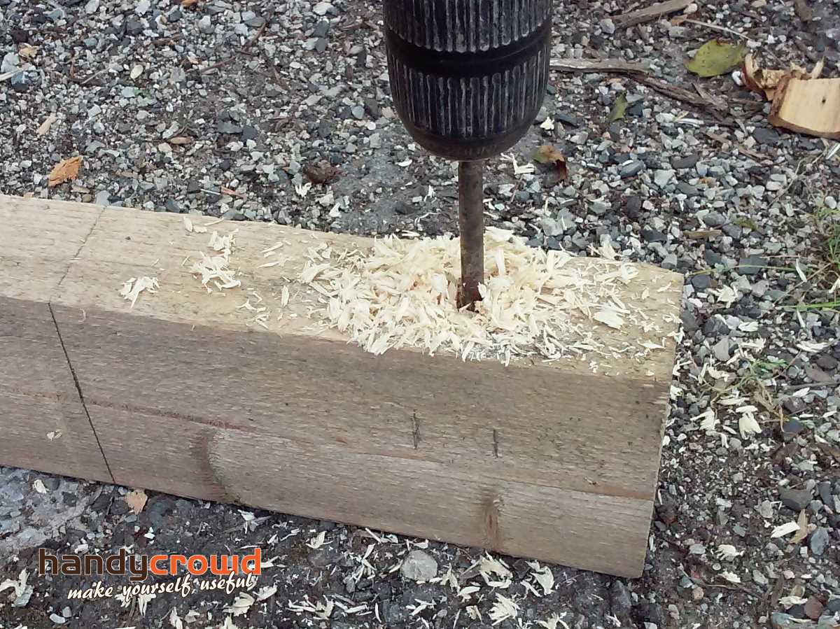

Attachment 13528 Drill a 22mm hole all the way through the long side.

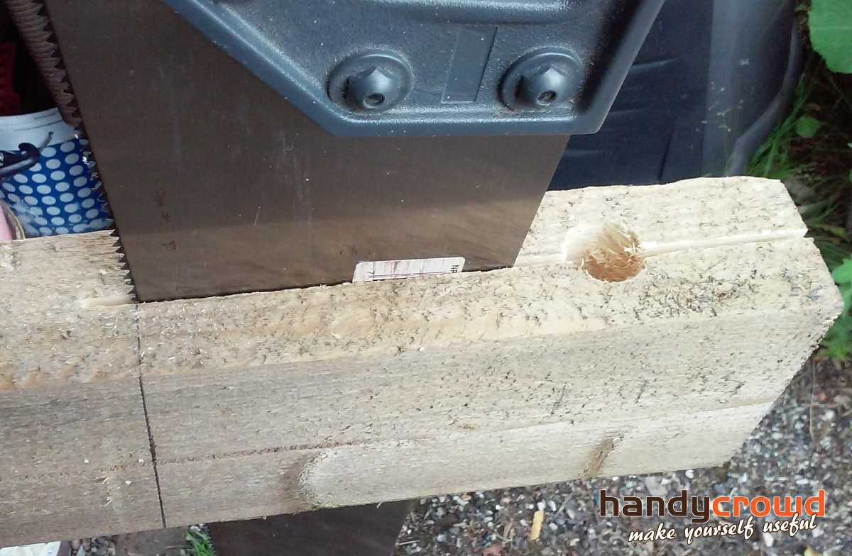

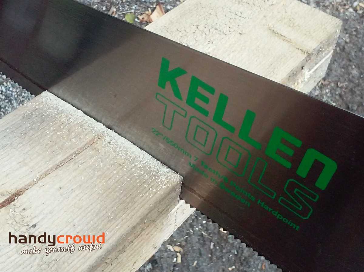

Attachment 13529 Saw down the middle about 8" or so, through the centre of your new hole.
Attachment 13527 Cross cut it off and screw a hinge over the cut, reattaching it.
Attachment 13530 The details (if you can call them that!)

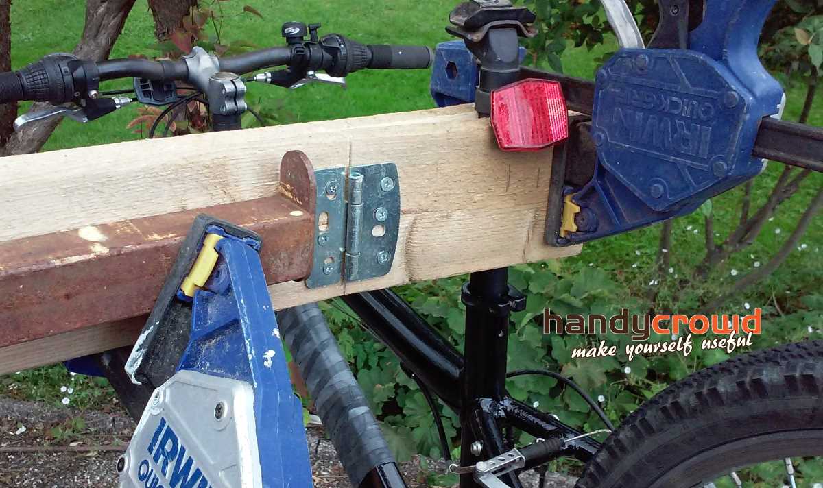

Attachment 13531 Bike stand in action on my lads 'rat bike' project....
I then clamped my new cycle stand to an old builders trestle I had, but you could just as easily use a longer length of 2"x4" and screw it to a tree or the side of the shed etc. I'm going to screw mine to the wall in the garage on a bracket/hinge so that it can be stowed out of the way for the 99% of the time I don't use it lol!
