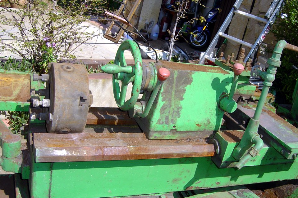

    I think that it was European. The old lathe that I had with it on was of Spanish manufacture. I have seen a reference that they were fitted up until 1975. I that the A is the common fitting for the cheaper end and D for the less cheap.

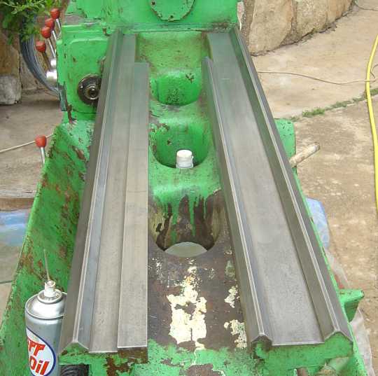

    I got that old lathe for the price of shipping. It looked to be very rusty but when I started cleaning it I realised that it was not the lathe that was rusty, it was the grinding grit that it was covered in. Apparently it had been stored where iron casting fettling was done. Within a week or so of getting it running I got a three year job offer, out of the blue, at Segway in the US. I bought my current lathe whilst in the US and so when I returned to Spain I scrapped the old lathe because the ways had a big wear dip right where it would be most used. It would have been a great lathe except for the wear, it was heavy and very rigid.

    I think that it was European.......<snipped>

    Get an eyeful of those ways, NO scrimping there!
    Later years then US heavy iron, Italy, Spain, Britain, areas around Poland, Czechoslovakia, likely Russia too, had no hesitation building heavy patterned machine castings. I'm sure the iron was of good specification like Meehanite, chilled, seasoned, induction hardened as measures of competition.
    At same time German and Swiss offerings had thinner sections but far more webbing. I'm thinking those were chasing foreign markets [shipping], the heavy stuff more domestic.
    Despite gargantuan appearance, those of Italian and central European makers operated in a very civil but positive manner. Had examined British, French and Spanish too, apparently not so many sold, never had one in front of me on a shop floor, save one HES lathe. That had wonderful collection of features, for certain.
