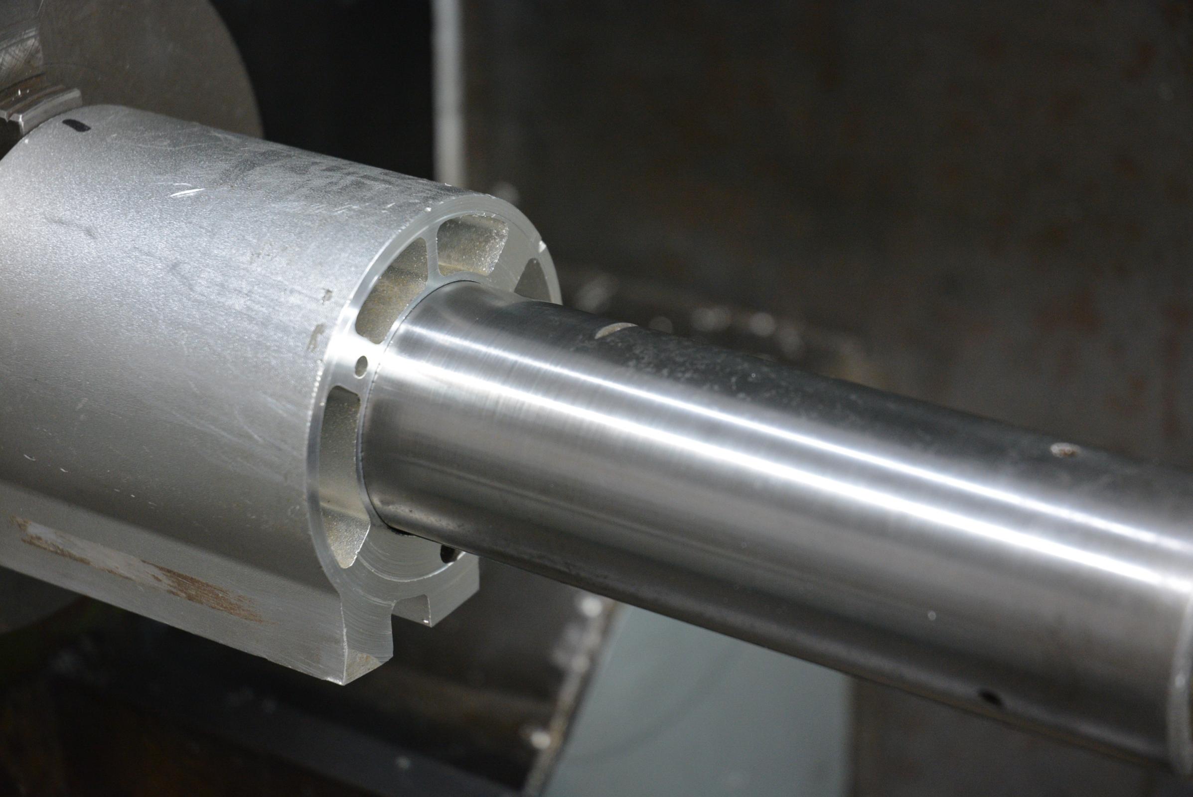

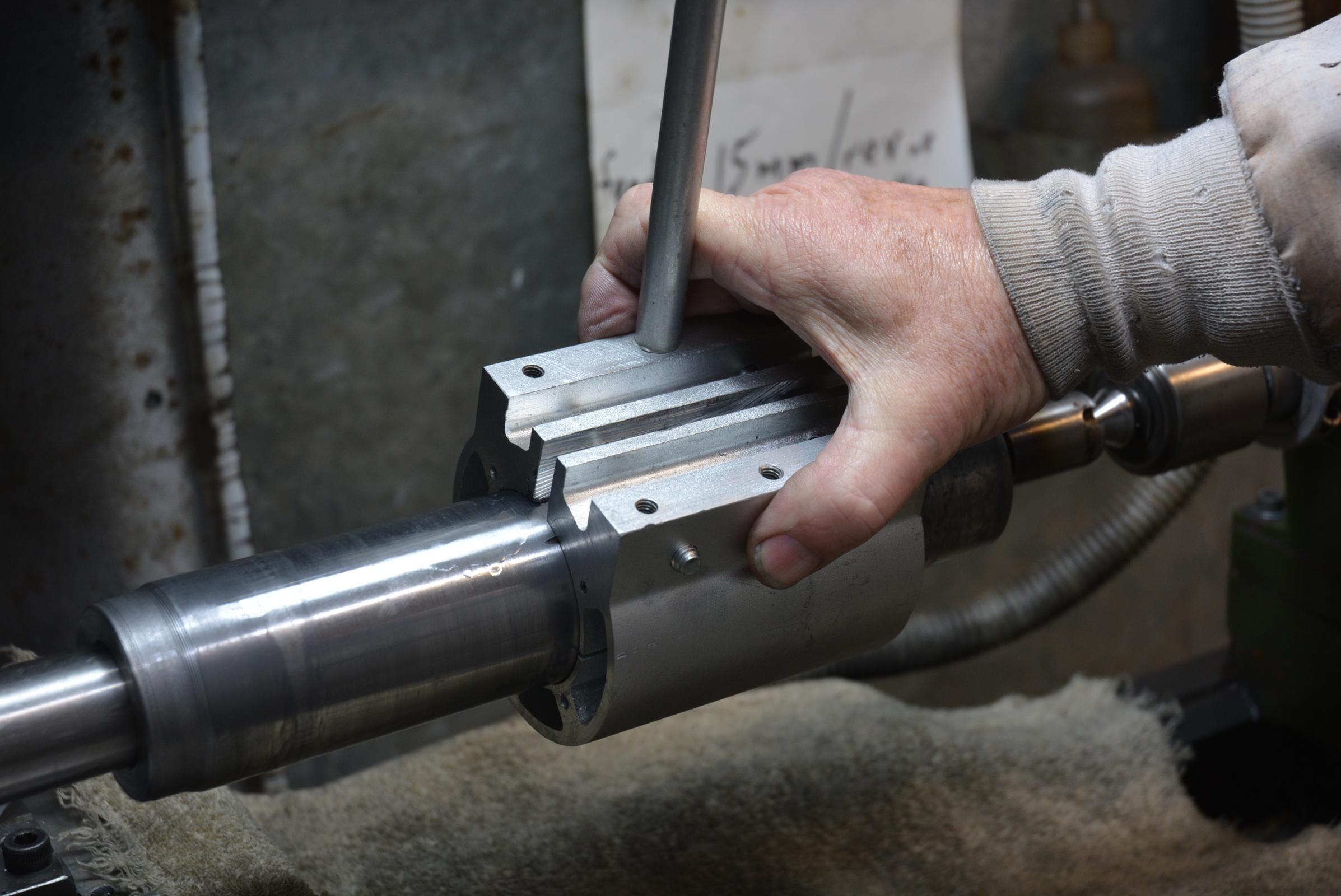

    I had a spindle from the tail stock of a large lathe which I used as the basis for an accurate cylindrical square. Although the spindle was hardened it had some wear due to years of use on the lathe. This video shows how I lapped it true and checked it for squareness.
    here is a link to my Youtube playlist of more workshop videos.
    https://www.youtube.com/playlist?lis...O1hdmUIYO28Def

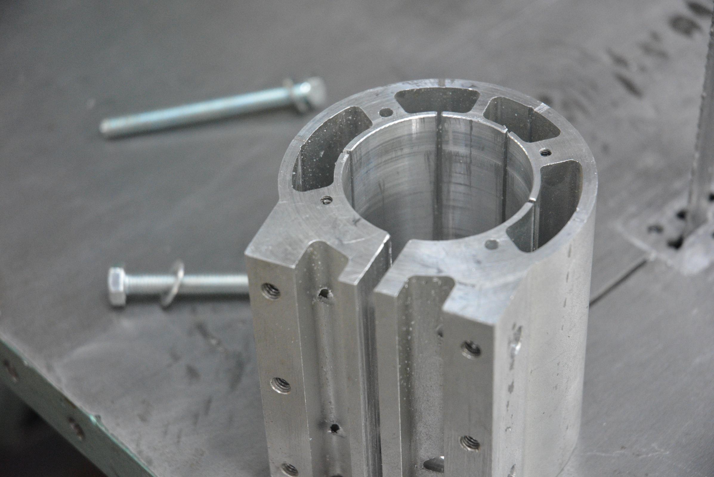

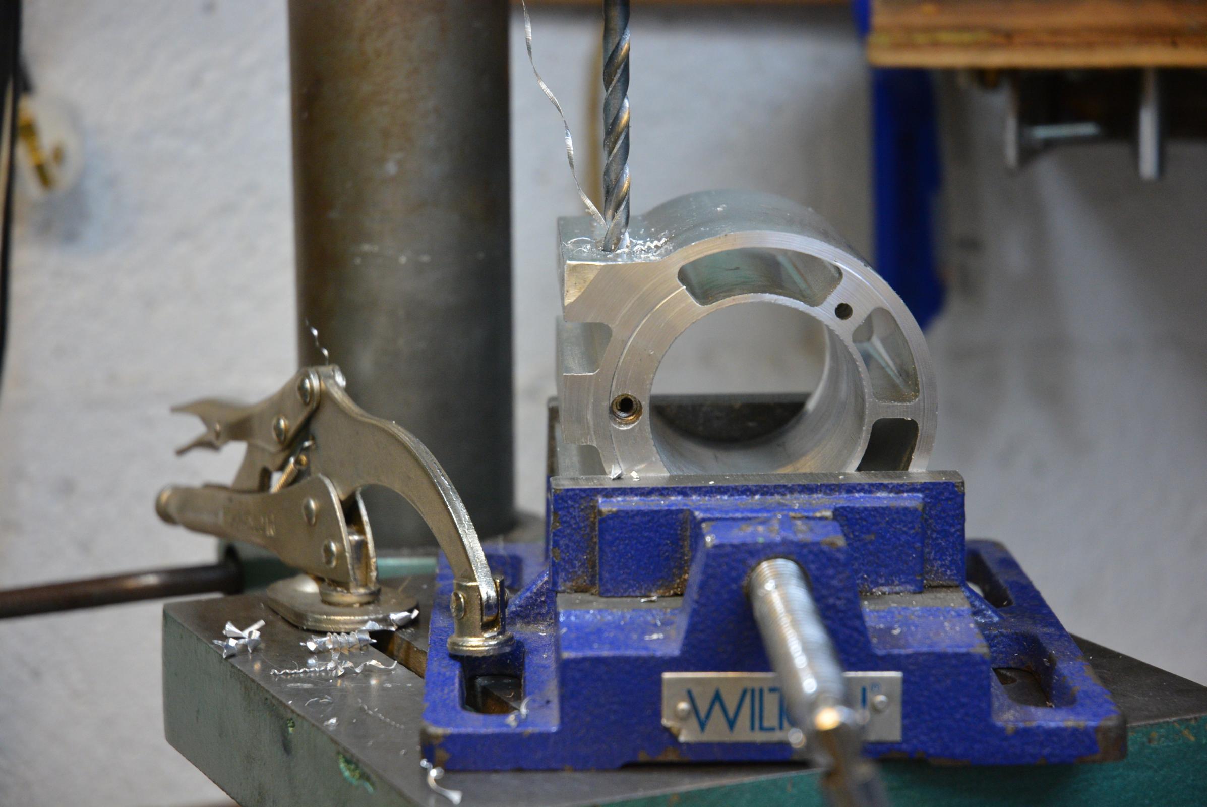

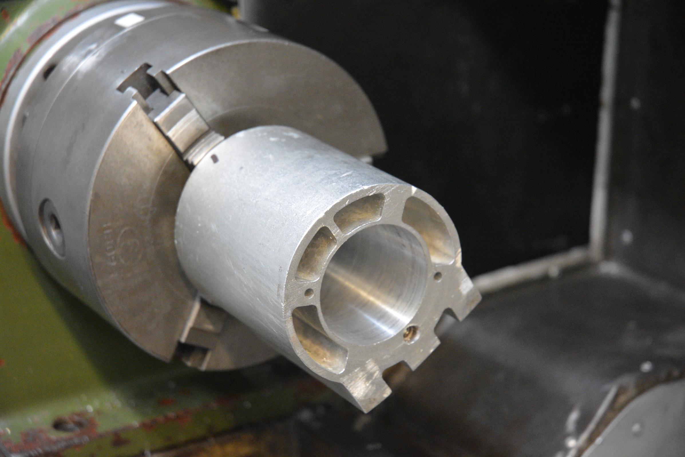

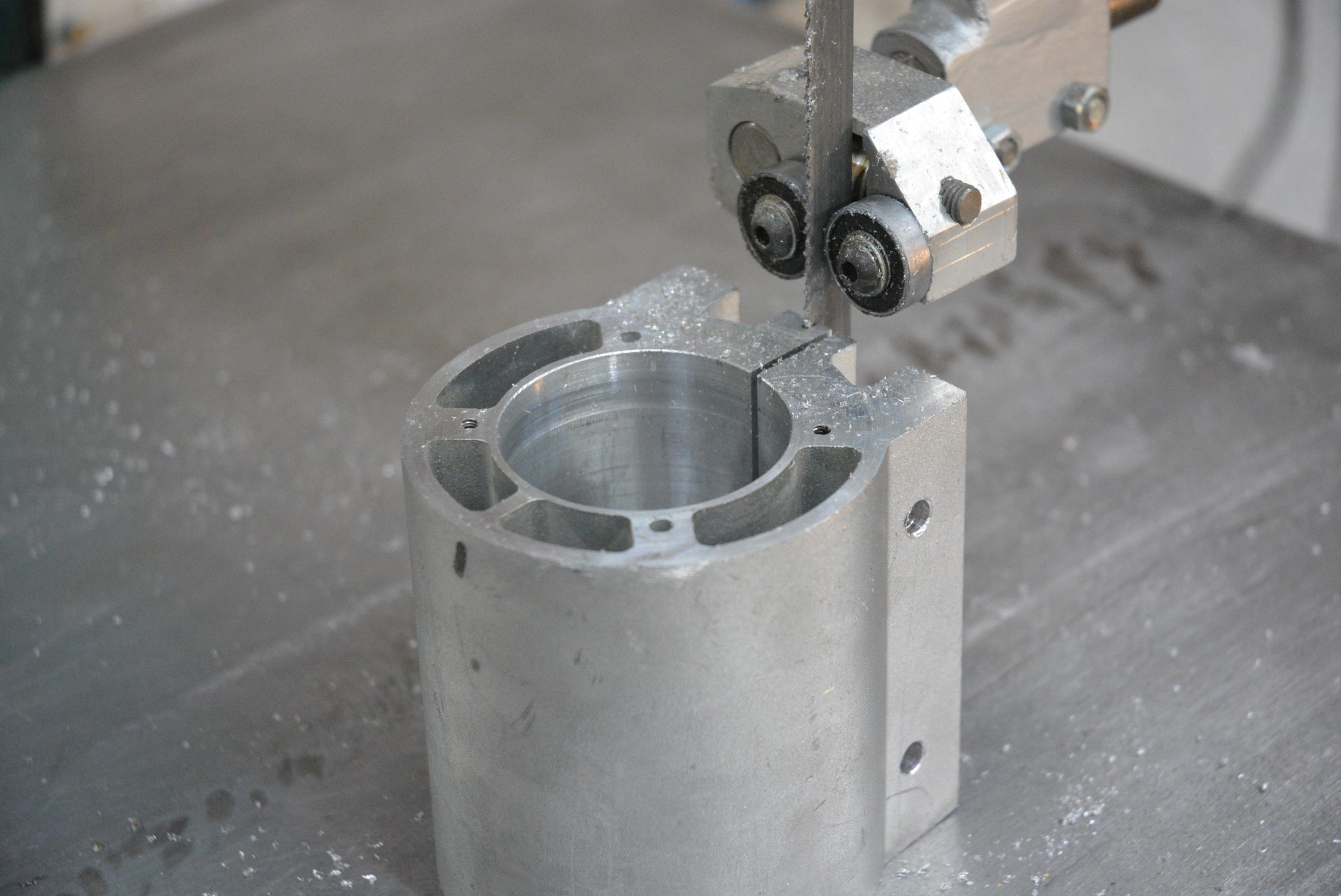

    I had an old aluminium bearing housing in the scrap box which had a bore of 50 mm and the tailstock cylinder was 54 mm so I made a lap by boring out the housing and then splitting it with a bandsaw. I added a couple of clamping screws for adjustment during lapping.
    Cylindrical square from a lathe tailstock.-dsc_2038.jpg Cylindrical square from a lathe tailstock.-dsc_2040.jpg Cylindrical square from a lathe tailstock.-dsc_2041.jpg Click for full size.
    Cylindrical square from a lathe tailstock.-dsc_2045.jpg Cylindrical square from a lathe tailstock.-dsc_2048.jpg Cylindrical square from a lathe tailstock.-dsc_2050.jpg

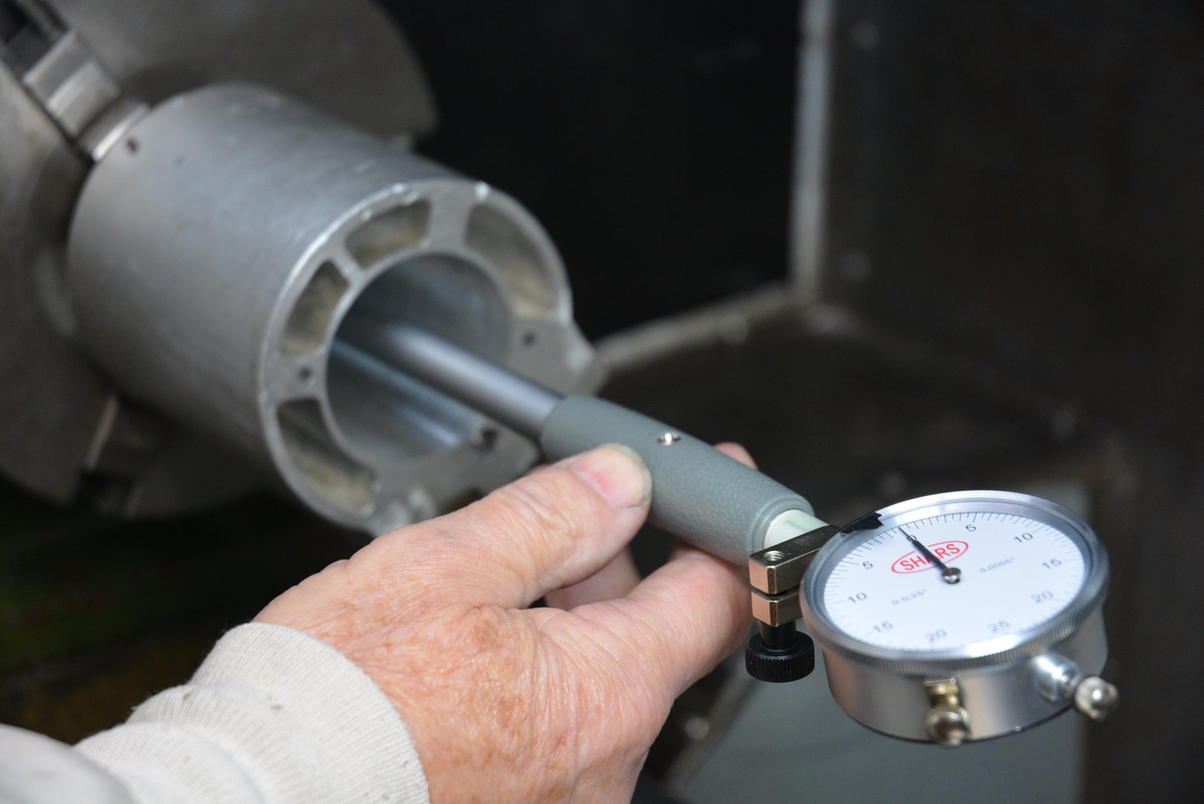

    I had machined the bore for a nice slip fit on the cylinder, but for the initial lapping I spread the diameter a little so that I could charge it with the lapping grit and some thin oil. I worked the lapping over the areas which were the largest. The cylinder varied in diameter by only 2 tenths of a thou. prior to lapping. Pretty good but I like perfection where possible.
    Cylindrical square from a lathe tailstock.-dsc_2058.jpg Lapping.

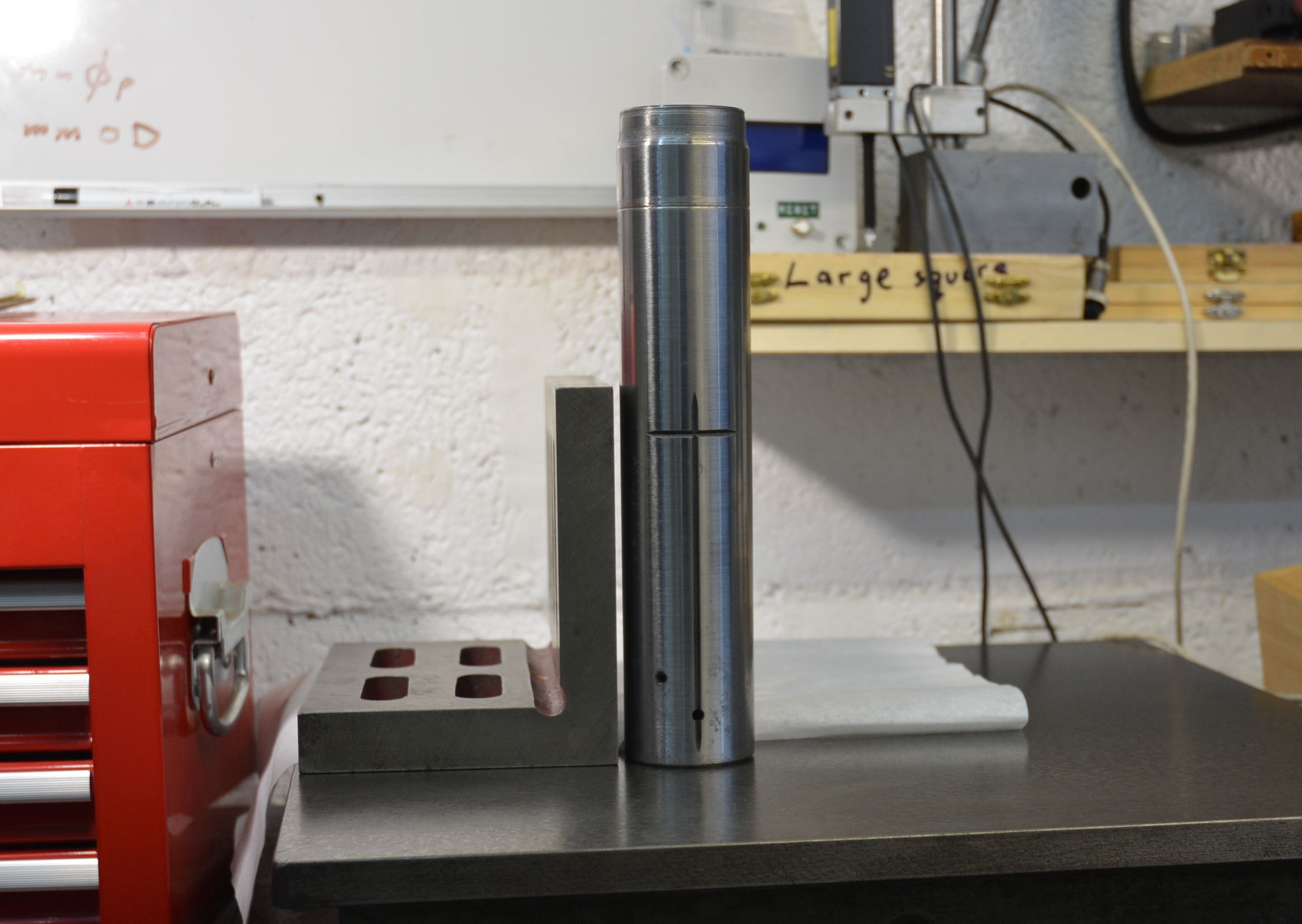

    After lapping I could detect no difference in diameter over its working length. So that left the squareness to the base to be checked.
    I suggest watching the video for more details. Please like and share it and subscribe to my video channel if you have not already done so.

    Finally I cut a short length off the top to eliminate an undersize area.

    Q: I wonder about your sequence of lapping and the grits chosen - any info to share on that, please?
    I do not know the grit size. I have some 1200 grit diamond but that was a bit fine for removing much metal, great for a mirror finish but my concern in this case was not a shiny finish. I had several lots of valve grinding paste and one tube emphasised that the grit was all one size (it did not say what that was), so I used that one. Not a scientific choice but a practical one.[/QUOTE]

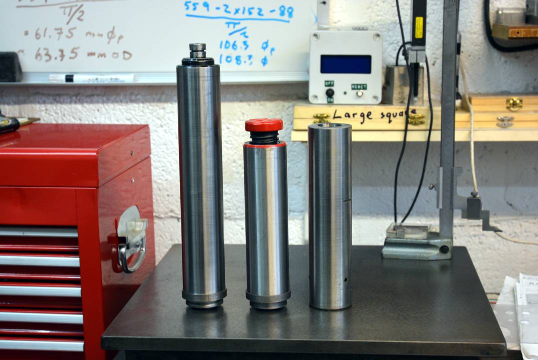

    Your comment reminded me that I happened to have a couple of 20 ton bottle jacks open. i measured them to check what the were like.
    Cylindrical square from a lathe tailstock.-dsc_2084.jpg Click image for full size.
    The item on the right is my new cylindrical square, the other two are from the bottle jacks. The longer one measured up with the ends of equal diameter but around midway was 0.001" large. The shorter one had a gradual taper of 0.003" over its length. Careful setup in a lathe or grinder would allow bringing them up good enough to lap to an accurate shape. Not the ideal donors but they are readily available. The shorter jack was obviously built to lower quality standards, with rougher machining and twisted gaskets etc.
