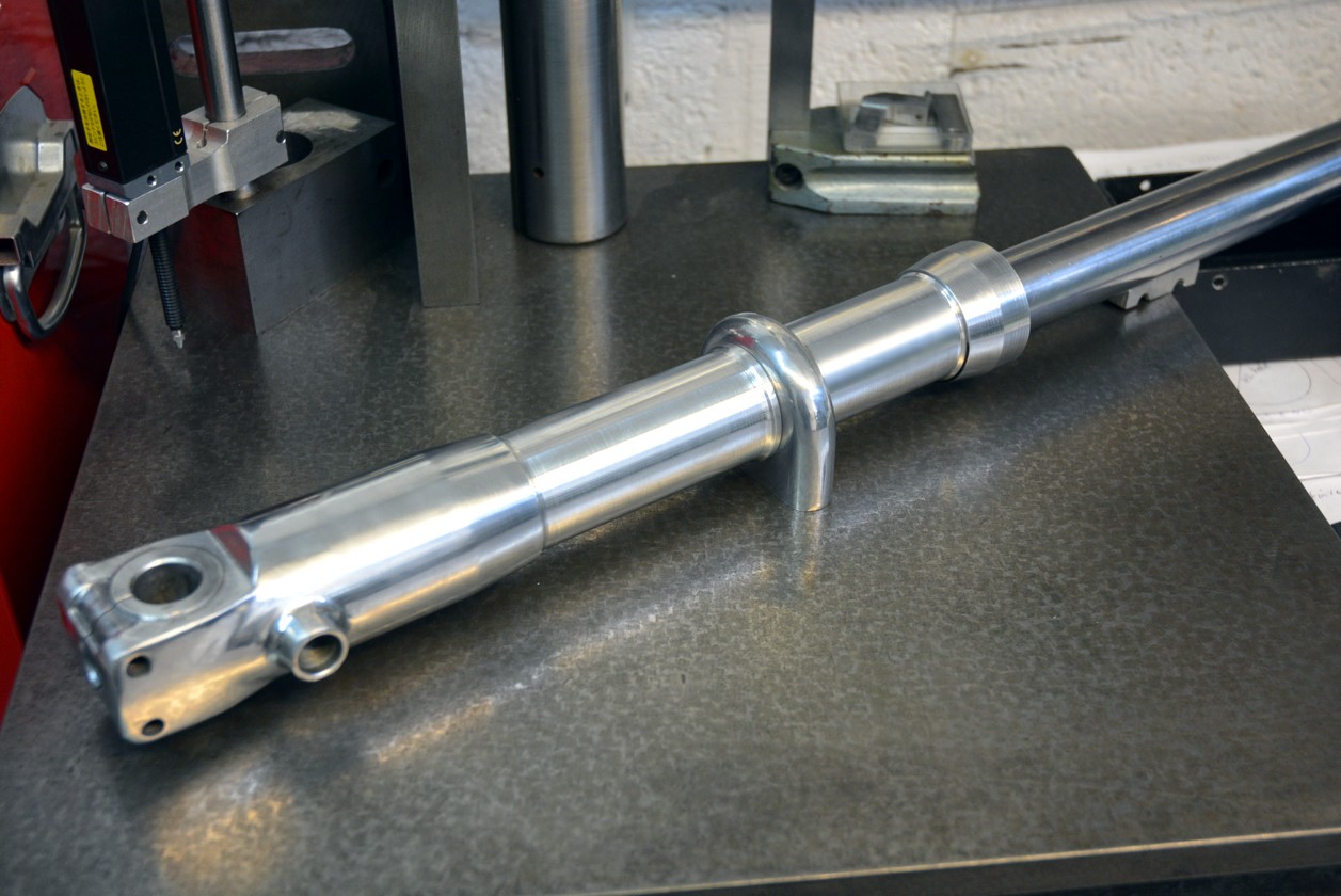

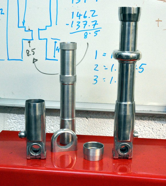

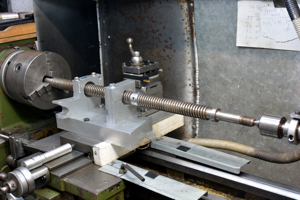

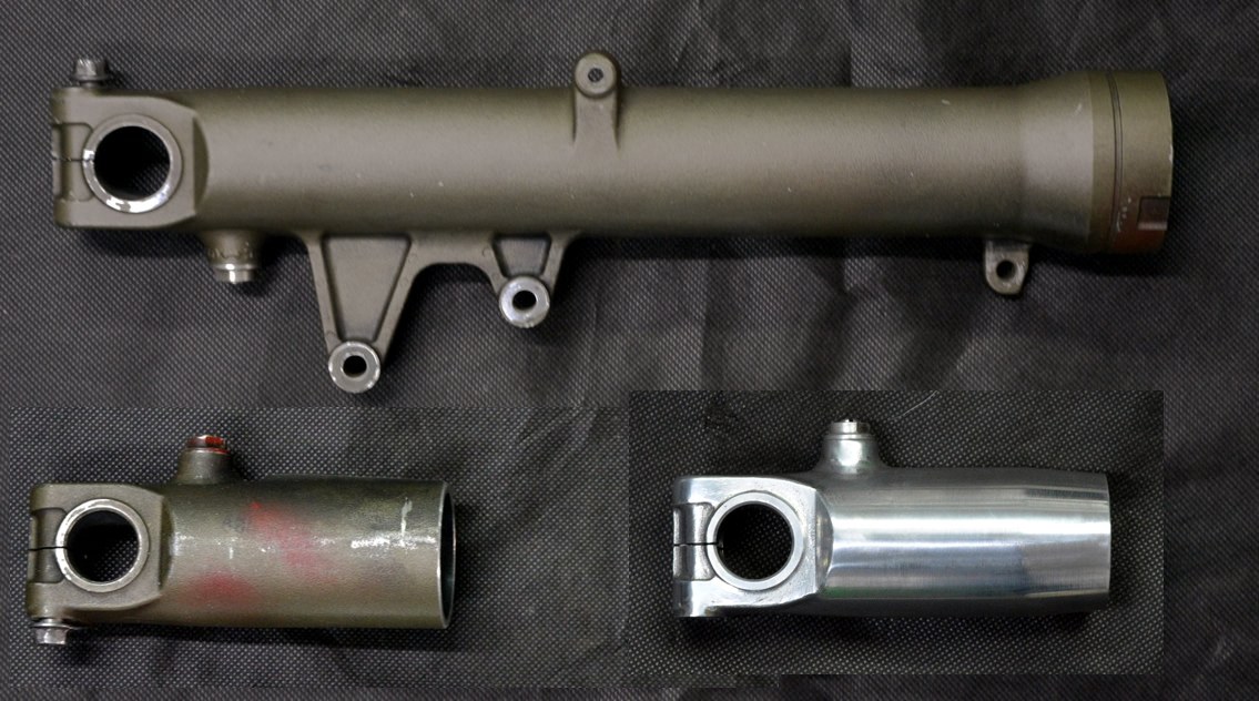

The lead screw was used to make the boring bar for a line boring setup that I used to make front forks.
