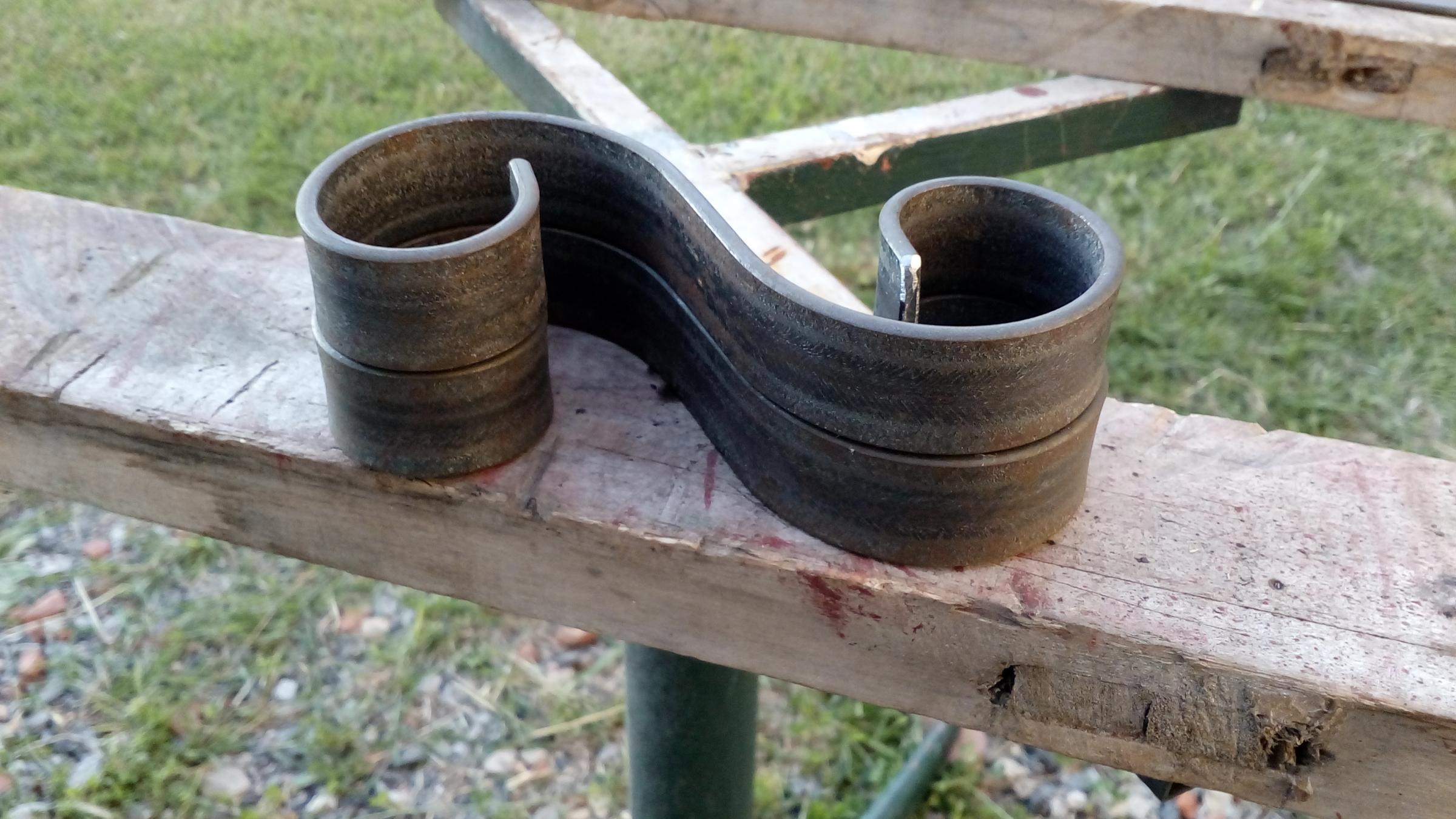

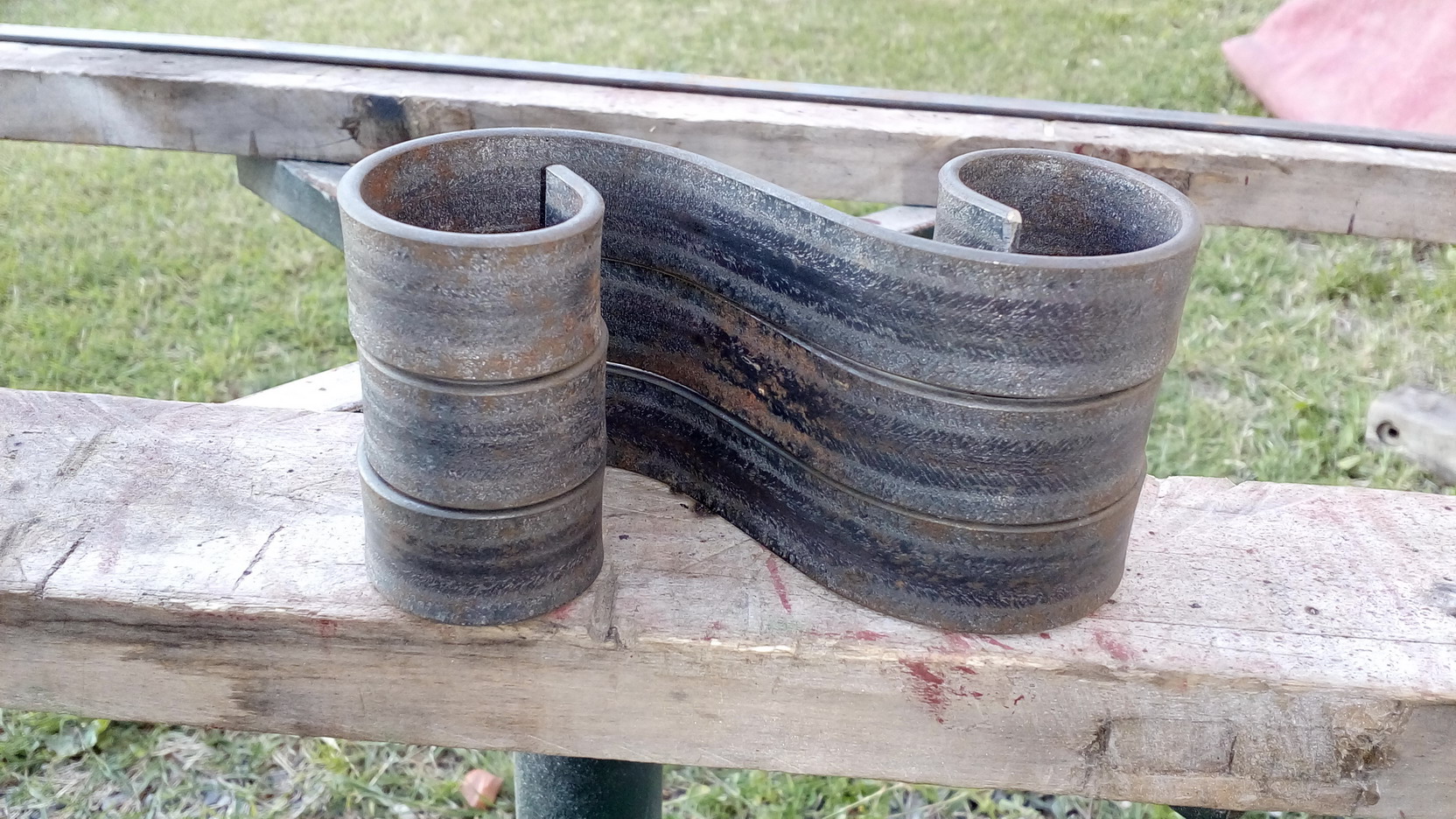

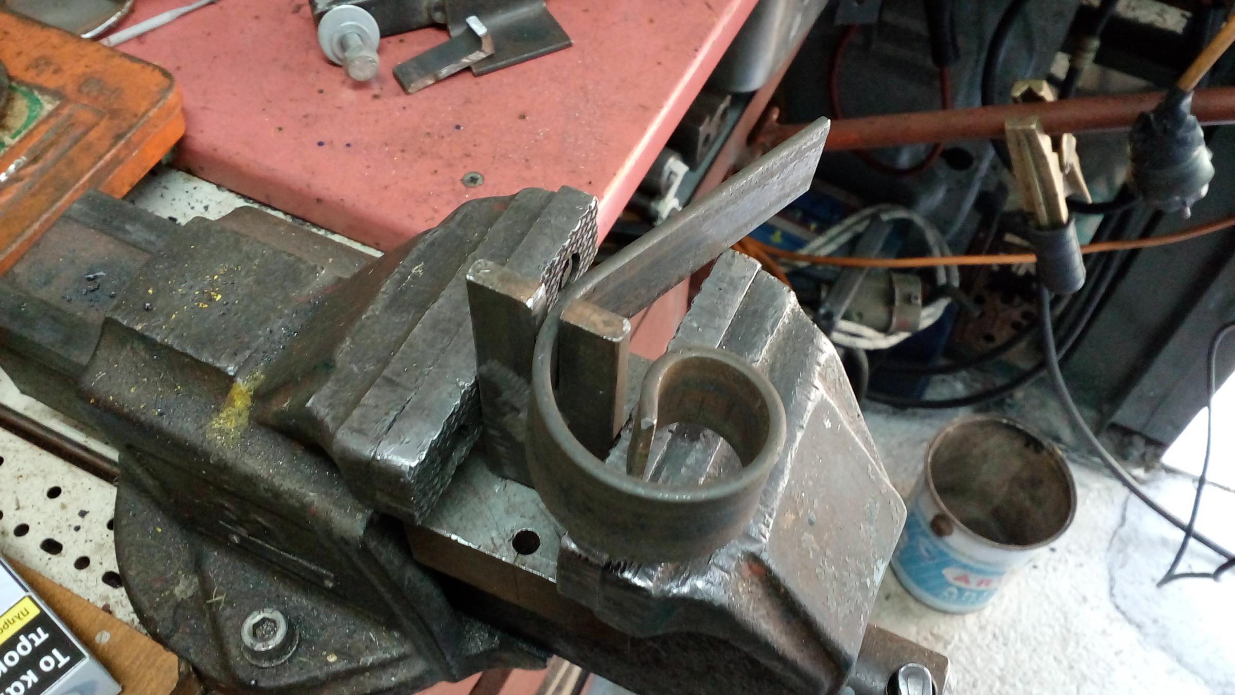

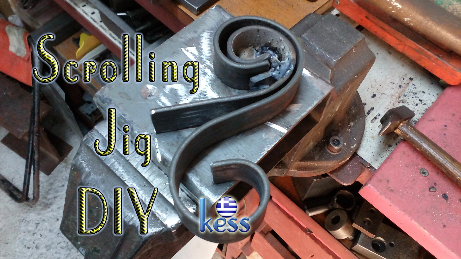

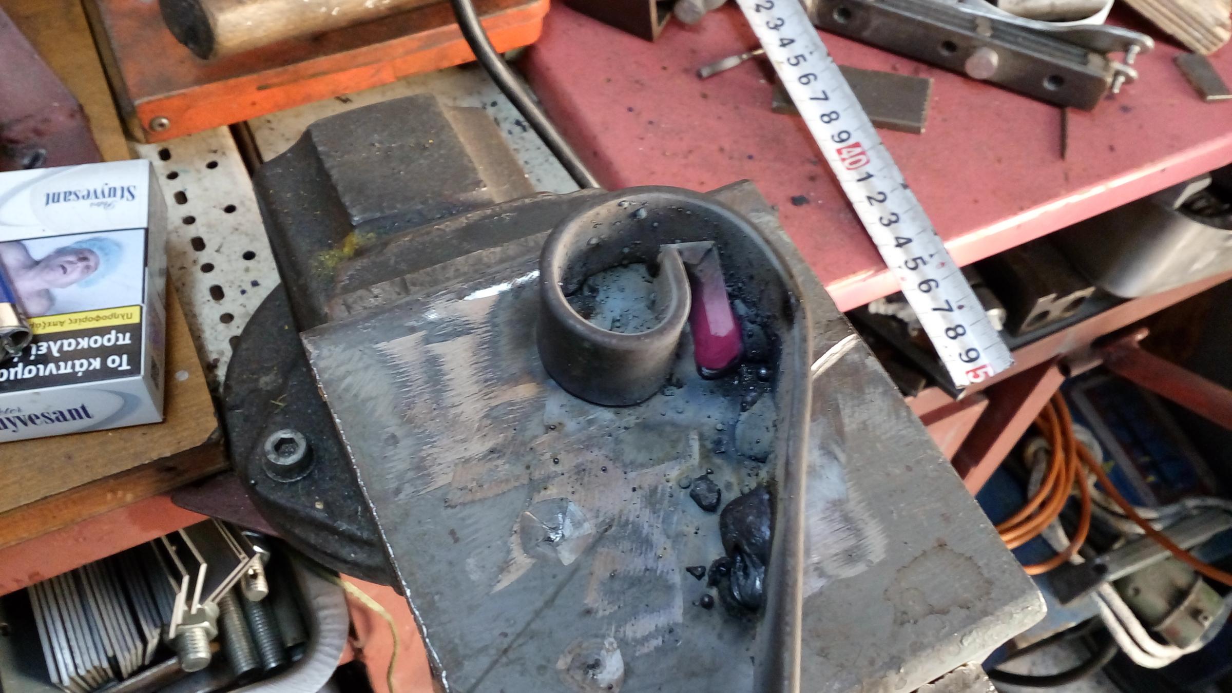

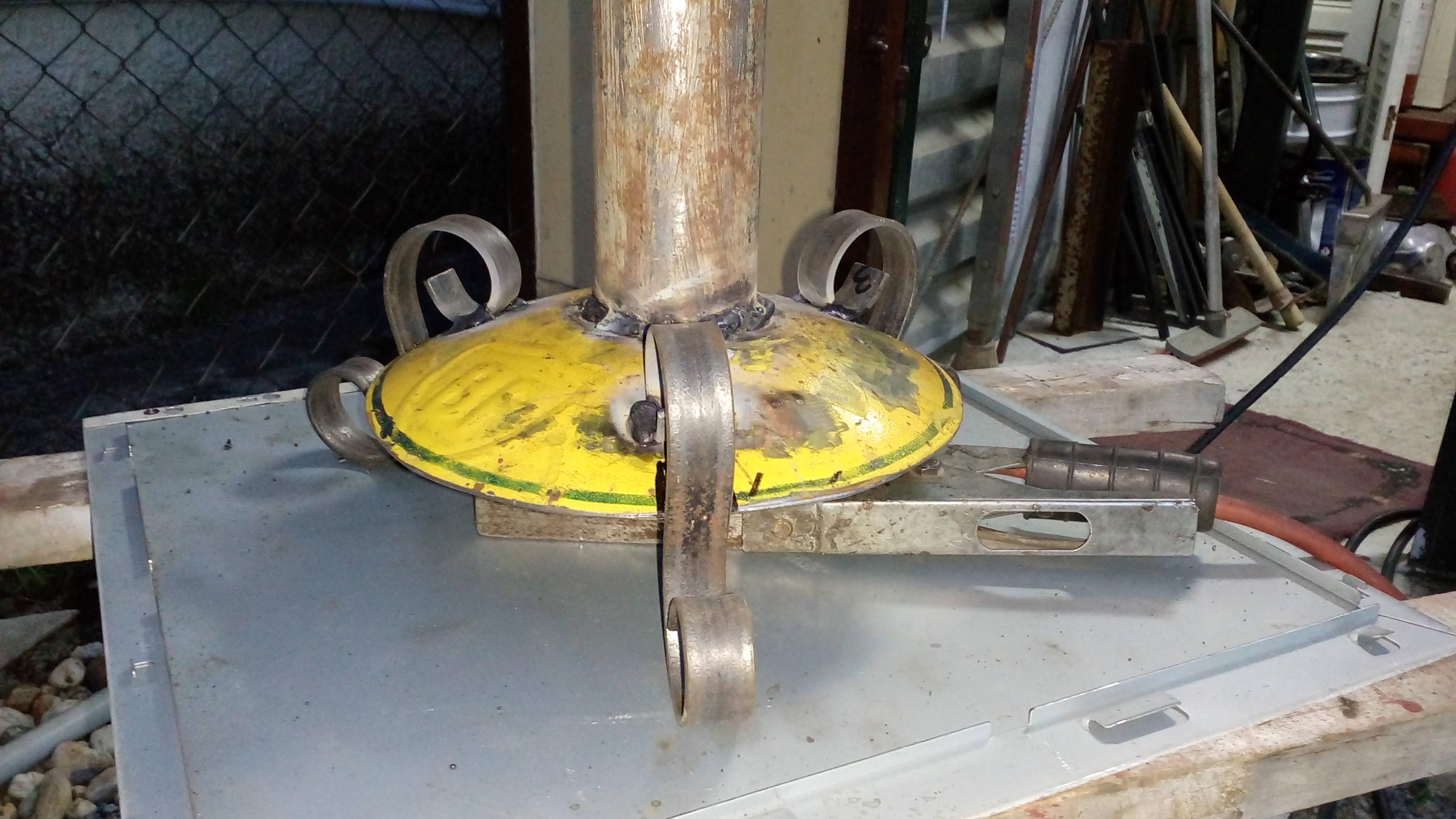

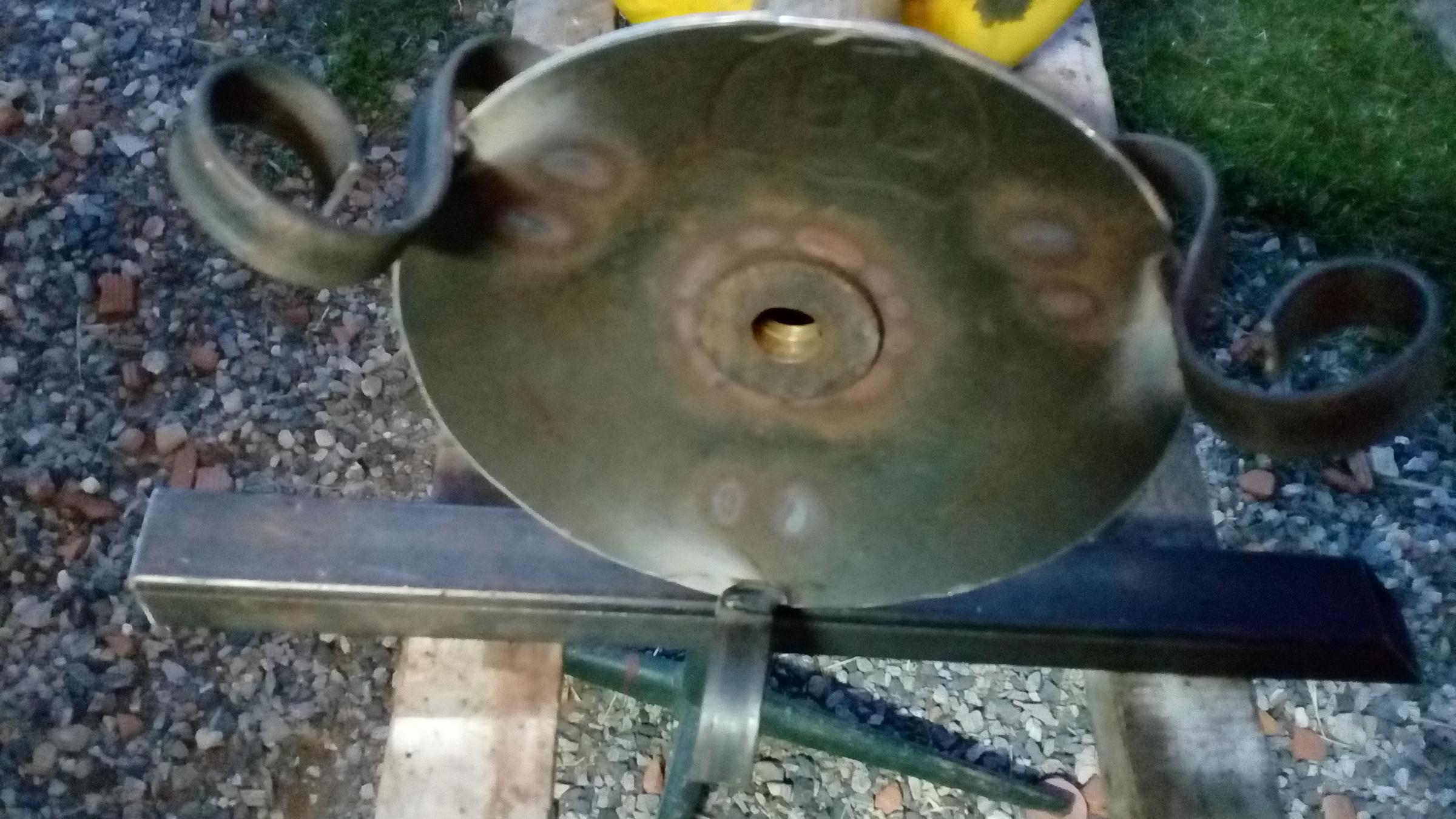

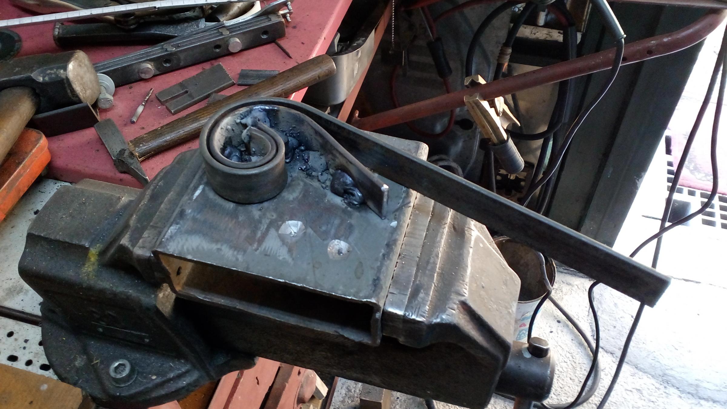

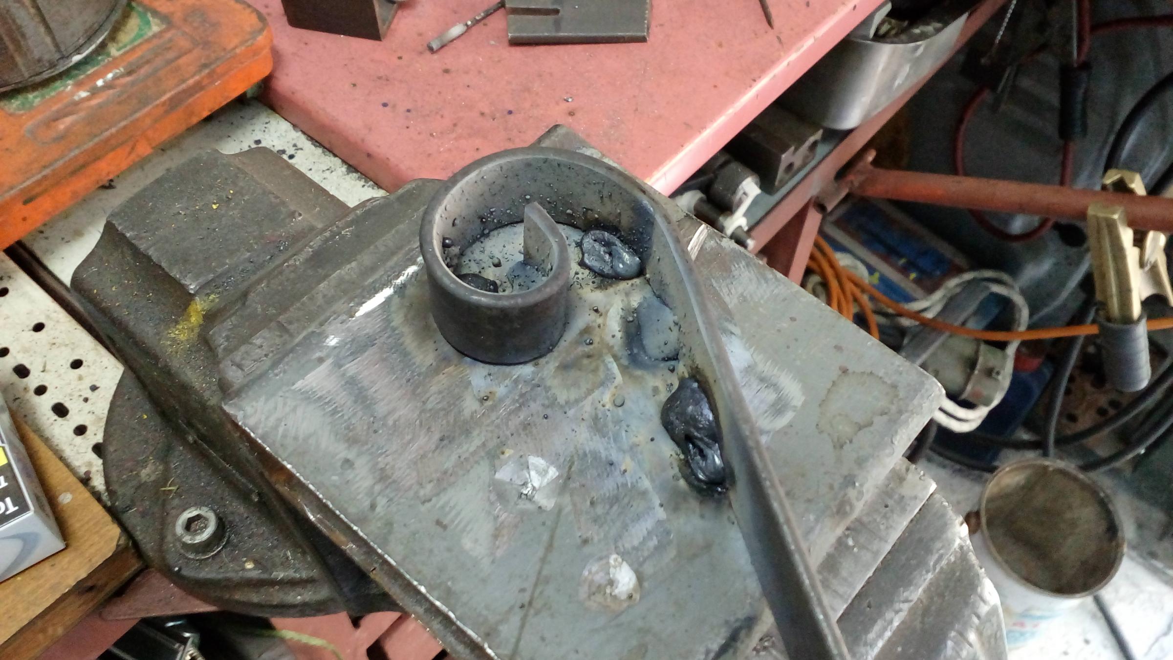

    An easy and quick build for repeatable scrolls.
    Make it from a piece of flat bar and a piece of tube.
    By the same way we can make different shapes at vary dimensions.
