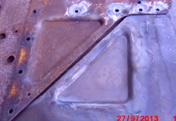

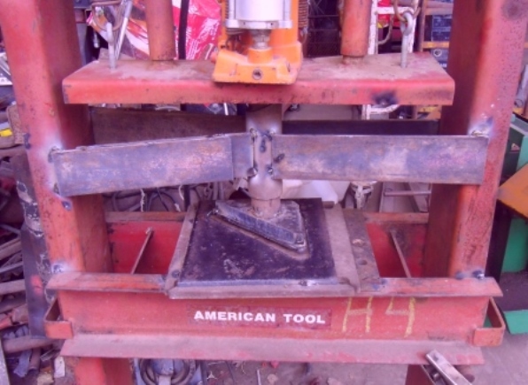

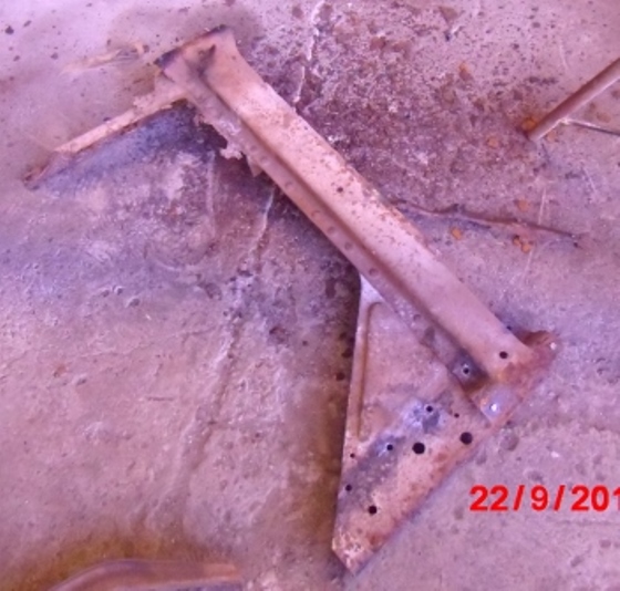

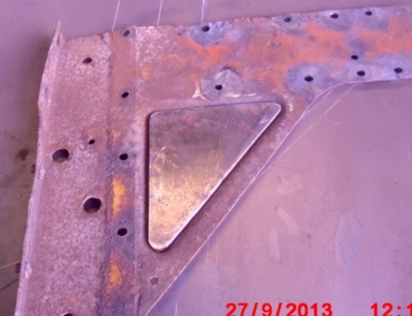

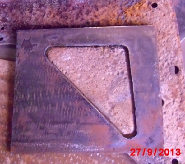

    After searching for a year for a suitable replacement cross member for my Chevy truck rebuild I decided to make my own
    My shop press has been the platform tool for many projects I actually bought it at a scrap metal salvage yard for $20.00 then added my air over hydraulic 12 ton jack
    this project deals with a punch and die to form the dimples in a sheet of 3/16 plate
    The punch was cut and shaped to fit in the dimple

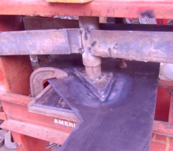

    then I did the same with the die

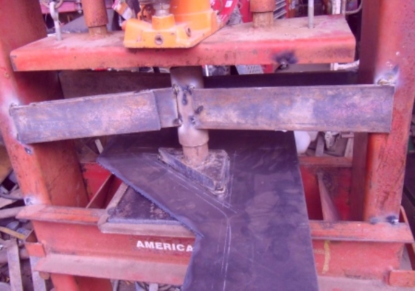

    the lay out done and positioned ready for forming
    pressure and a judicial amount of heat with some massaging with a hammer

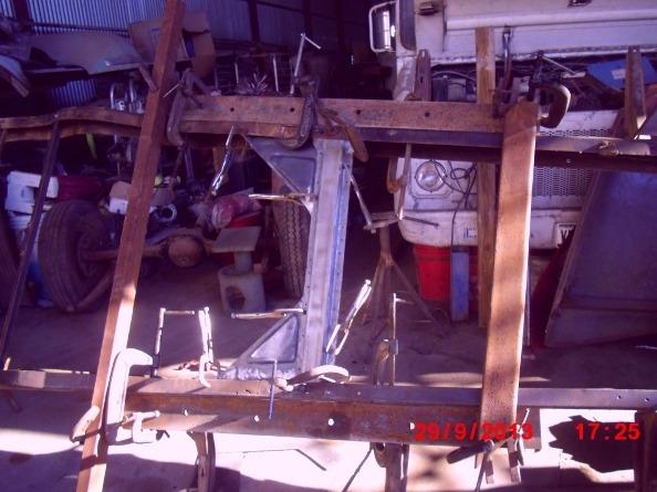

    The end results are worth the effort
    What I started our with
    What I ended up with
