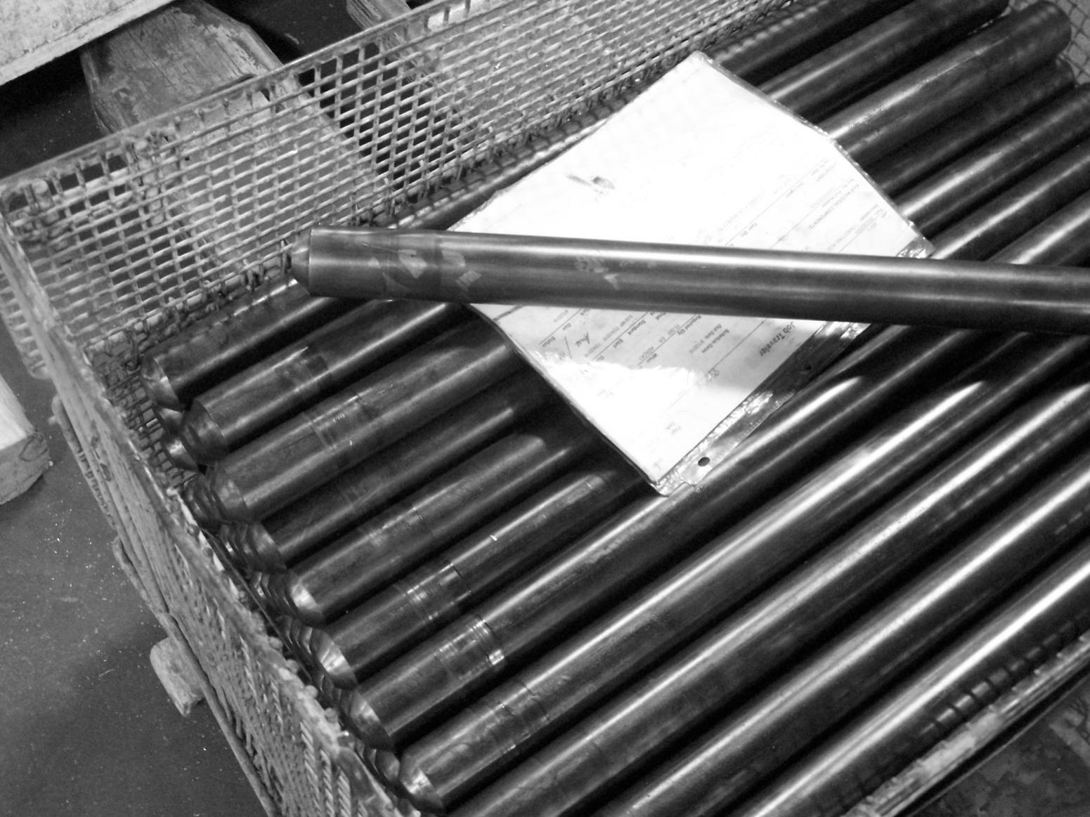

Day 2, Thursday. HOT job. Co. sells bundle of weldments, 1.75 od cold rolled 37" long w/ a forged double pin clevis each end. Rods weren't chamfered night before, to run next morn. Guess Who got that deal. Rumor has it he's Inspector and mystery machinist. Nuthin beats switching 12'' chuck to 3 jaw by hand, mount steady rest cuz bar's bigger than spindle bore. No clue, fairly kickazz 60's era Okuma D1-6 spindle isn't 2 1/16 id. Anyhoo#1, Guess Who guy loads 58 bars, cranking the compound, flipping to other end and filling a pallet. Robot operator grabs a couple, fires up and he's off to the races. They're 25#, handled 3x is 4350. Runs bulk of order, we clock out, 2nd comes in.Attachment 12782

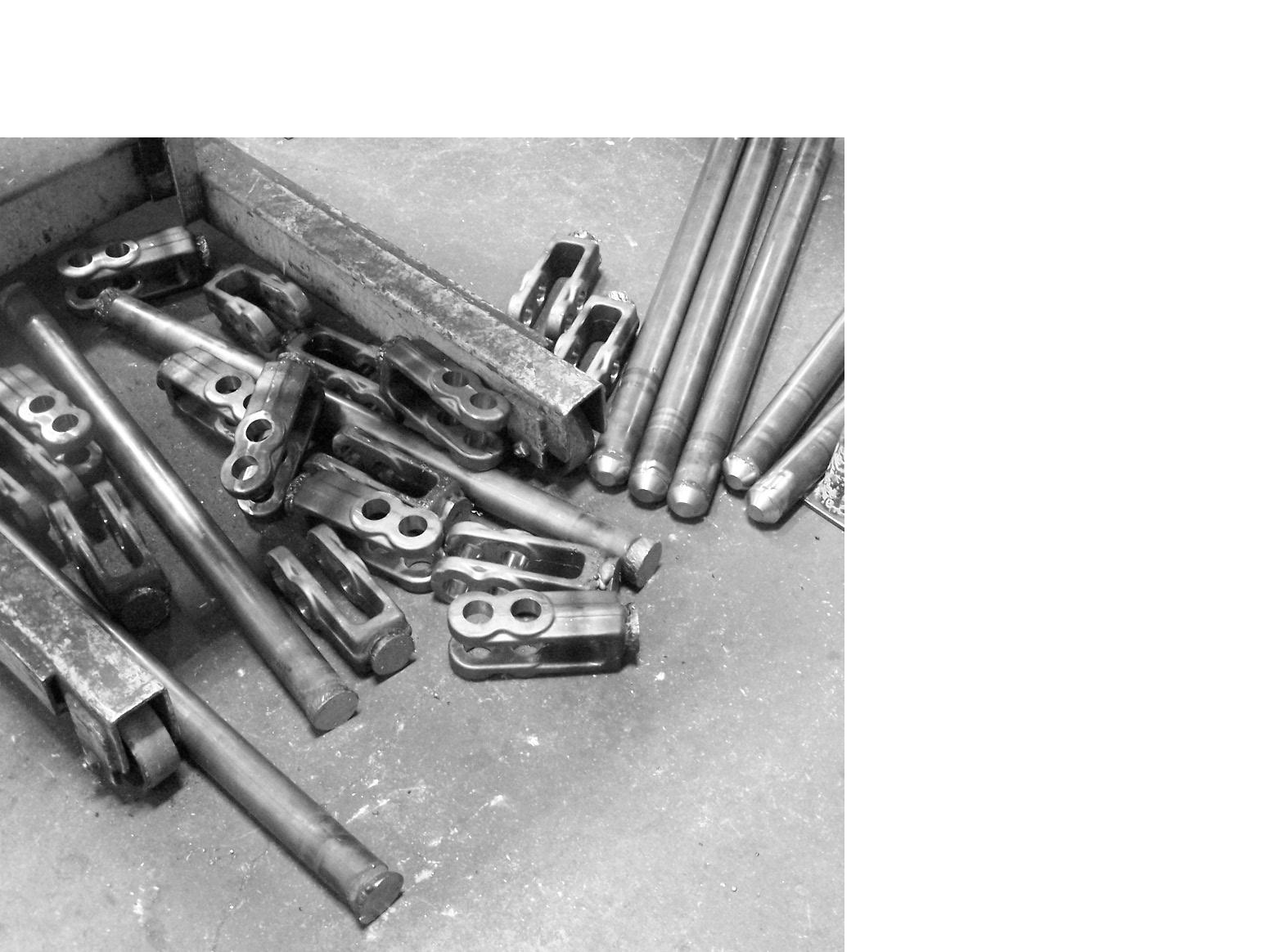

Day 3, Friday. 1st comes in 0600, job's incomplete. Shut down for porosity on 2nd's start up (oh sure - ran fine all day). 9 bad parts. We never run out of gas, silo sized vessel outside. Cracked nozzle supposedly (likely the prevalent & cracked supv.) So, intrepid G. Who gets his fav'rit flash ''...you need to cut off welds re-chamfer bars AND reshape spud of said clevises, all 18 of course. "How long's it gonna take". "Dunno, only heard of it 35 seconds ago" "Well get them done fast as possible" "No" "This isn't a race, it's to save a salesman (dufus2) and he isn't going to make a hospital visit, this ain't kid stuff". Way unappreciative glare from dufus1.Attachment 12780 Attachment 12784

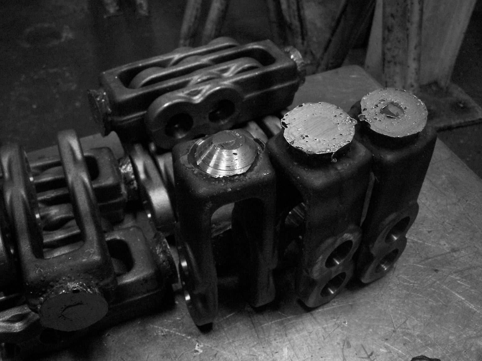

Of course G. Who knew. They (Co.) shy away from setup parts, 'specially when customer supplied materials are used. He split a few last run awhile back, recovering all destined to be scrapped out. Drawer of tool box has many accommodations, no one else can tell what they are. Snarling glance dufus1 grabs one clevis to give it a try. Oh, he'll show me, er G. Who. Despite all the 5s initiatives, 80 grit belts for the big sanders aren't replaced until last one burns up. 5s apparently means swearing, usually the colloquial term for feces, that many times. d1 goes at it, dinky right angle pneumatic in one hand, clevis in da utter. Like a weak 4th of July, way less spectators. d1 stops, clamps forging in his metal forming brake. His go-to repair site, that and fat deadblow hammer; zero talent past that. Knowledgeable set knows it as a Wilton Bullet vise. A veritable sculptor, he carves toward the spud with all the might 1/4" HF pneumatic RA can muster. The spud tapers from maybe an inch to 5/8'' or so and quite short, a well hidden nipple under mile of MIG wire. The bar, weld and cover passes near 2'' od. Audience is dufus2; hands in pockets, leaning forward oddly, intent behind 'cool' safety glasses, jeans, red poly-knit shirt, diagonal stripe on left sleeve. Grinding feverishly and trading off, they'll be awhile. Too dirty for ROFLOL, Who-man makes intermittent observations, appraising the competition, for plenty oneupmanship ammo.

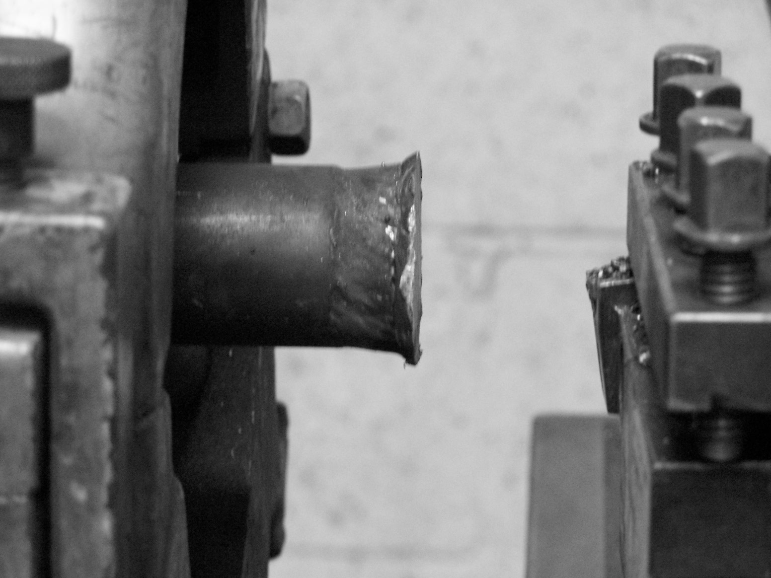

Meanwhile, Mr. Who spins last 2 bars. Swaps out 3 to 4 jaw, pulls steady rest, backs tailstock far as it goes and rolls up sleeves. Cue up something like a loping radial aircraft engine. Or 4, 113 inch HD's and a BSA 441. Anyhoo #2. He's got 2 pads that bridge gap of clevis arms and a little jackscrew inside. No indicator, just circular scored lines on chuck face; he's got the nerve and he's got the touch. Love that line, no clue on origin. Open those imaginary throttles. The setup is RIGID, goes 735 rpm, next step is 1200 something, inappropriate for this can't handfeed quick or deep enough to pass workhardening. Big negative triangular insert eats up crap weld fine, right near original form. He pulls the part and strolls toward robot station to verify Ok or better. Ahead of d1 by 5 feet, holding his out like a champagne toast - hot champagne at that. G. Who, eveready to convert defense to offense asks polite-like and impossibly straightfaced "First one?".
Attachment 12781 Evidently practice pays, now the glare is b-grade horror movie quality.

Returning to lathe Who starts in on remaining 16. Part way through, d2 hies in for another " how soon?". wtf its barely 10am. Who gets off more 2 rounds. "...faster than you'll figure out how to do this" and "too bad about the shirt dude, whats the racing stripe for?" a curt "...only decoration." Instantaneously and between the eyes "Good, lets time how fast you go away." Who is energized to say the least, heat of competition as it were.
