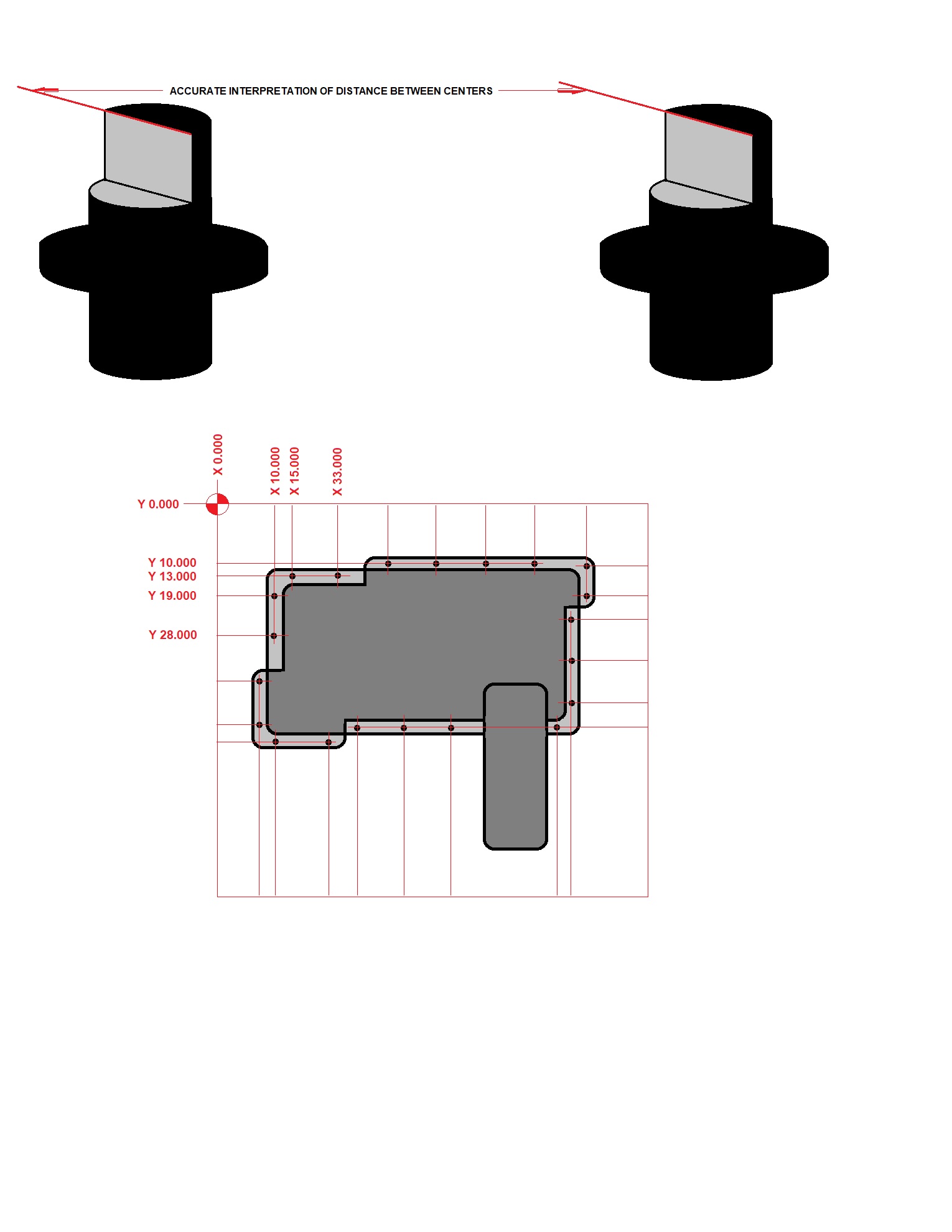

Well today, I'm looking for solutions to replicate the foot print of an [my] immense horizontal 4B JigMil. Roughly 15' across, and 10' deep, with 19 leveling screw holes in a not-rectangular foot print. It's time to layout floor cuts, to excavate 8" floor for the 4' foundation required to perform best. While pad will be rectangular, placing the bolts [or anchor holes] will be a challenge. Has to be correct, enabling riggers place machine as intended. It may be more effective to drill deep and epoxy long altered J-bolts. Nothing turns up, even close. Society of the internet isn't well geared for terminology of workmen.

Thought of making blind transfer punches to mark metal strips, holders for laser rifle/ scope aligner and project on a sheet, a pointed rod with a bubble post level, slotted bars and sliding plugs where there are overhangs...probably wind up using a little of each.
Occurs to me, to take a series of good overlapping pictures; depicting the various positions to analyze offsite.
OK here is what I have done when confronted with the need to millwright in a machine for which there was no layout prints
First I would lay out a large square grid around the machine then index the perimeter just like the grid of a map by first marking off smaller grid lines usually in 10 cm increments I try to metrics for this because everything is divisible by 10 this type of a numbering system never fails being left handed my zero point is always lower left this way standing at 1 corner my numbers always get larger going away from me and to the right. or as I term it to the north and to the east. Using 2 long straight edges a framing square a machinist square I can a pair of calipers and round pegs and sometimes a couple o f1 23 blocks or a 90° jig block that exactly fit the holes I can map out on a graph paper where every hole is on the machine that can be reached around its base. For any other holes or if there is electrical or plumbing lines hidden inside or behind other obstructions I have to create datum points which I can translate to my paper graph.
Hope this helps and that I have not completely confused you by leaving out something.
You may literally have to build a square framework out of some stable materials the same height of the top of the base to be able to get a perfect grid it is very important that if the machine is sitting unlevel or currently on a skid for best results the layout grid should be on the same plane as the top of the base or the bottom of the base if there are varying thicknesses to it

So focused on foot print and individual holes, hadn't occurred to think of them more as a pattern with an external datum, and positions within a grid...Exactly as a cartographer might locate features, or navigation from place to place.
Lets forget I spent years doing the latter!
A grid, perfectly workable solution; can envision the process. It's not on skids, just plates so riggers can place toe-jacks to finalize position. That means I can slide tape measure underneath and prove an actual 90-90-90-90 rectangle to divide a grid. Each hole is on the same plane, a few have machine hanging over them. Will make 5-6 ferrous pins, flanged that fit holes with minimal clearance. Above the flange is a boss, milled to a face indicating centerline of pin below. The milled face will hook a tape measure, or attract my magnetic tape, the flange adds weight and stability, the holes are cast not drilled. If necessary, bottom could have a small stud for a wing nut and washer. The halved pins allow accurate center-to-center measurements as well.
Sketch depicts concept, not to size scale or even accurate representation of shape.
Attachment 20550
