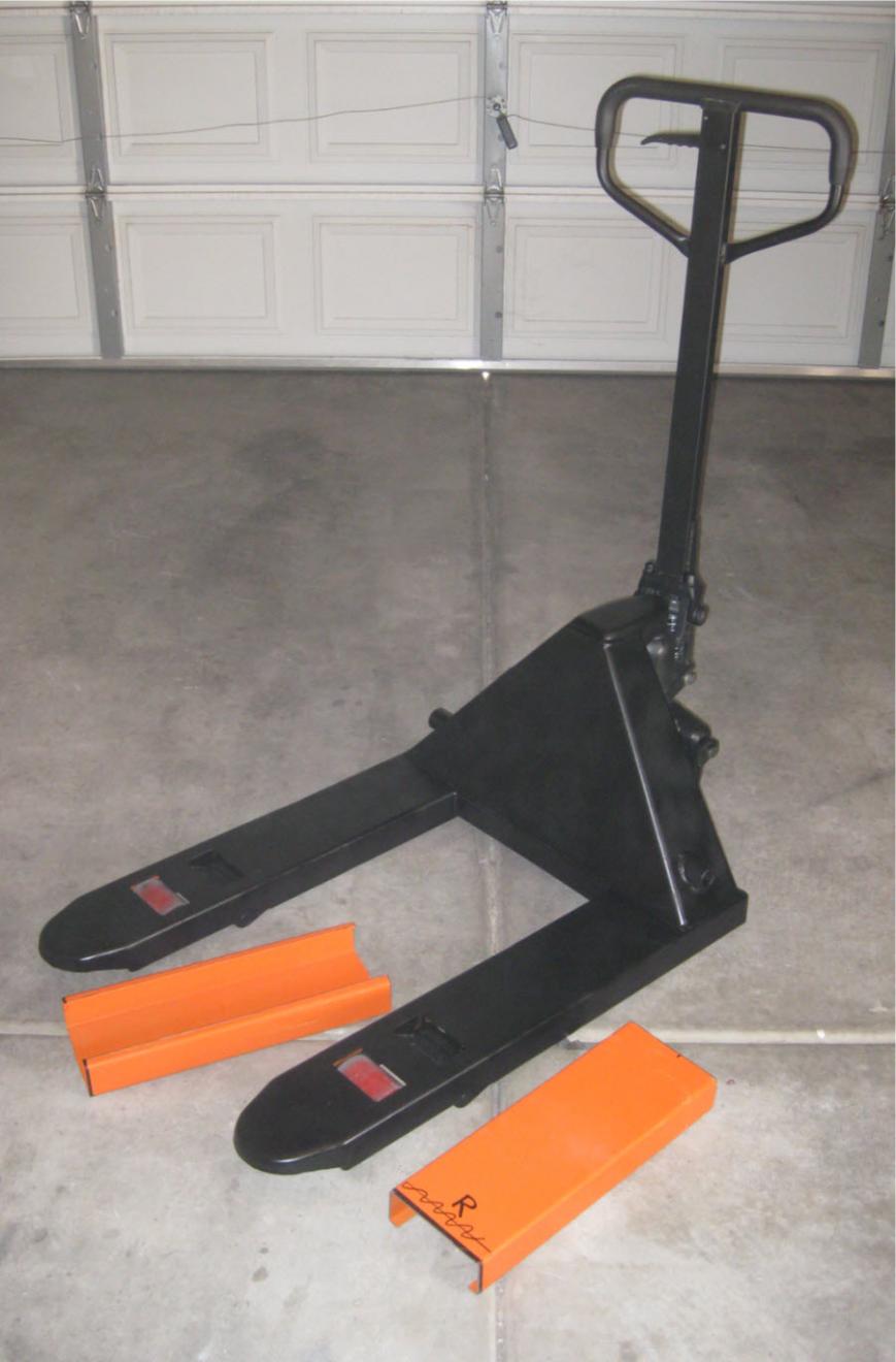

Shortened Pallet Jack by 18 inches
The pallet jack I purchased on sale came 48″ long and I need it to be 30″ to fit under my Machine Tools; therefore, the purpose of this project is to shorten my pallet jack by 18″.
Possibly I could have purchased a shorter one but where is the fun in that?
Full Post with over 100 photos at:
Shortening My Pallet Jack by 18″ | CTM Projects
Attachment 1659

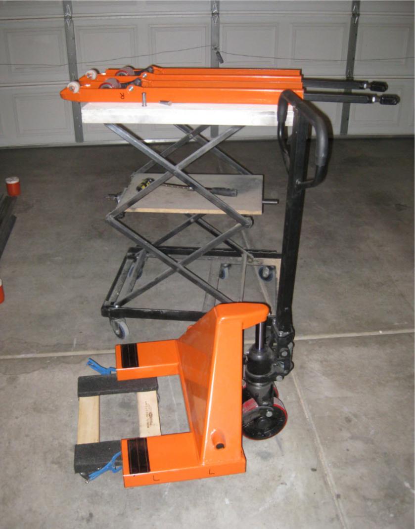

The fun challenge of this project was to cut apart and then re-weld back together a ‘shorter’ pallet jack, while disassembling as few parts as possible.
Other than taking off the handle to make it easier to flip over on the welding table, the only parts I needed to remove where 2 pins and their snap-rings.

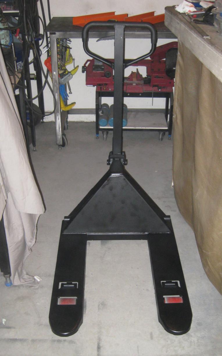

Attachment 1660
It was a fun project.
Attachment 1661
