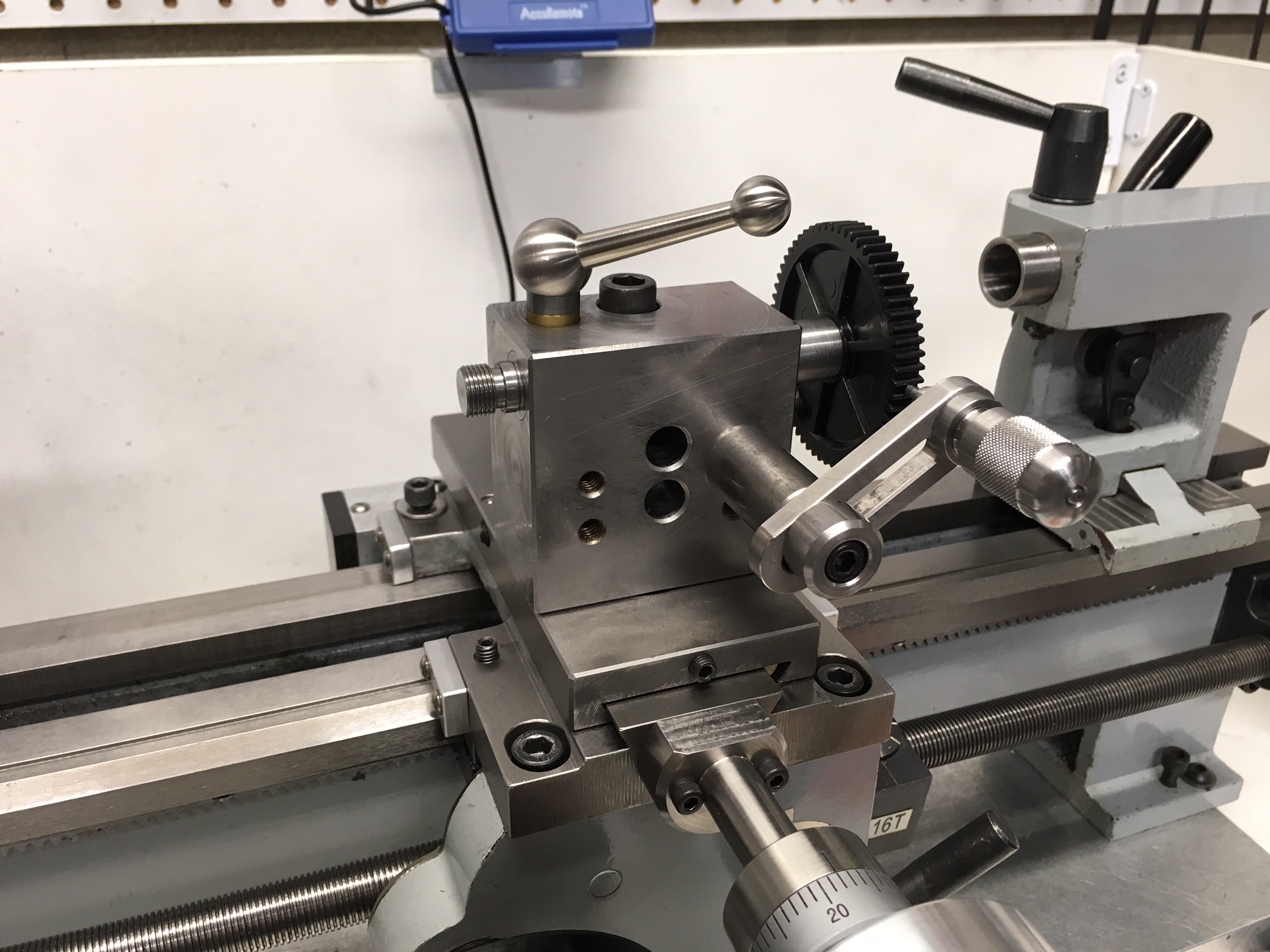

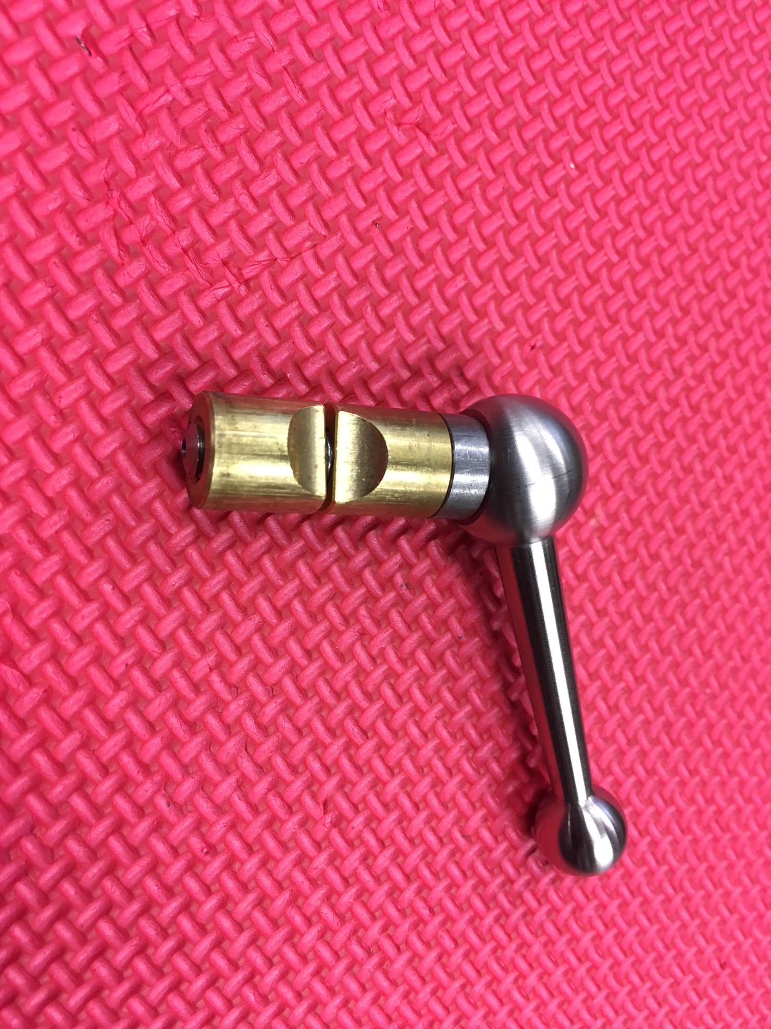

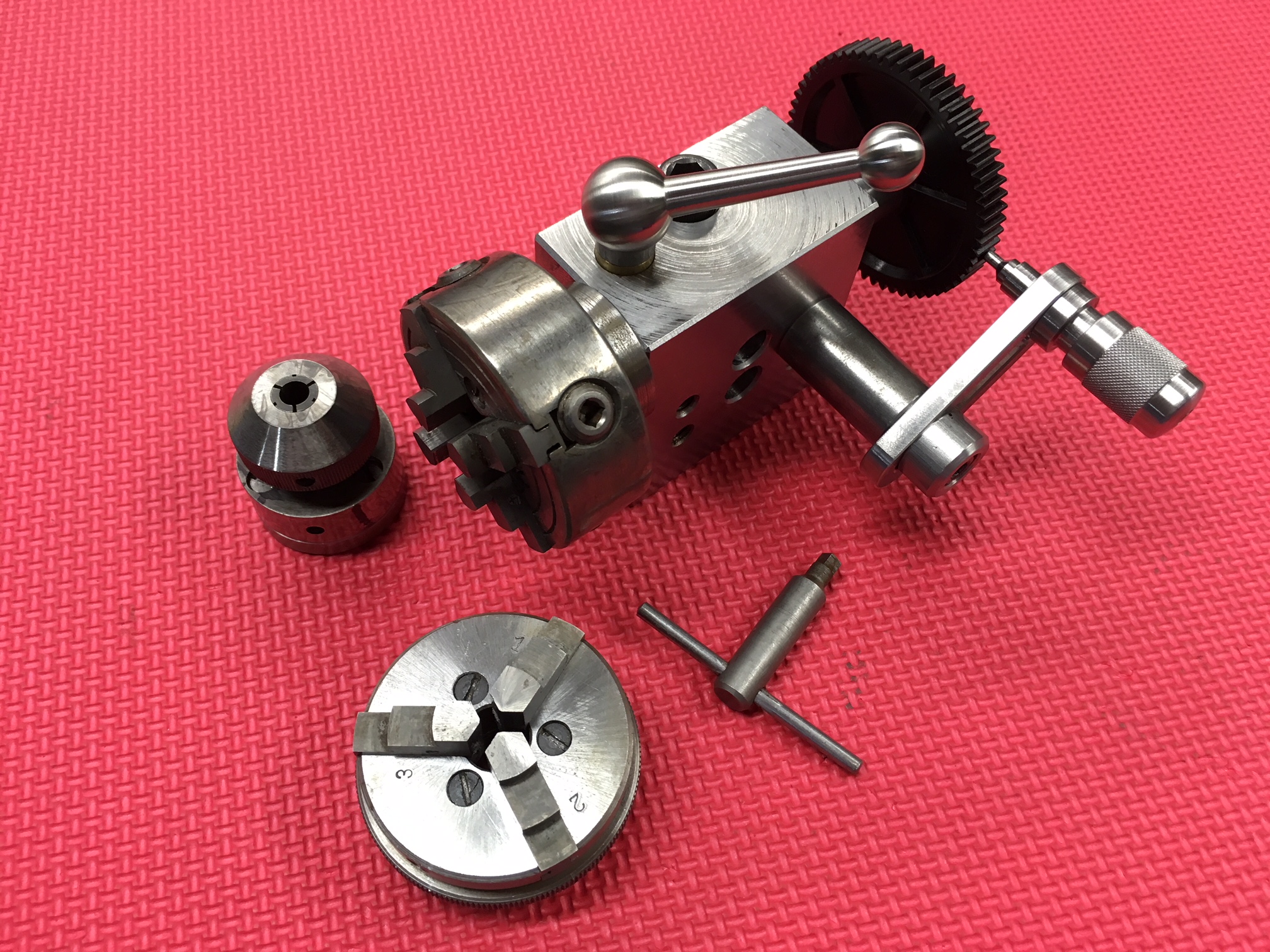

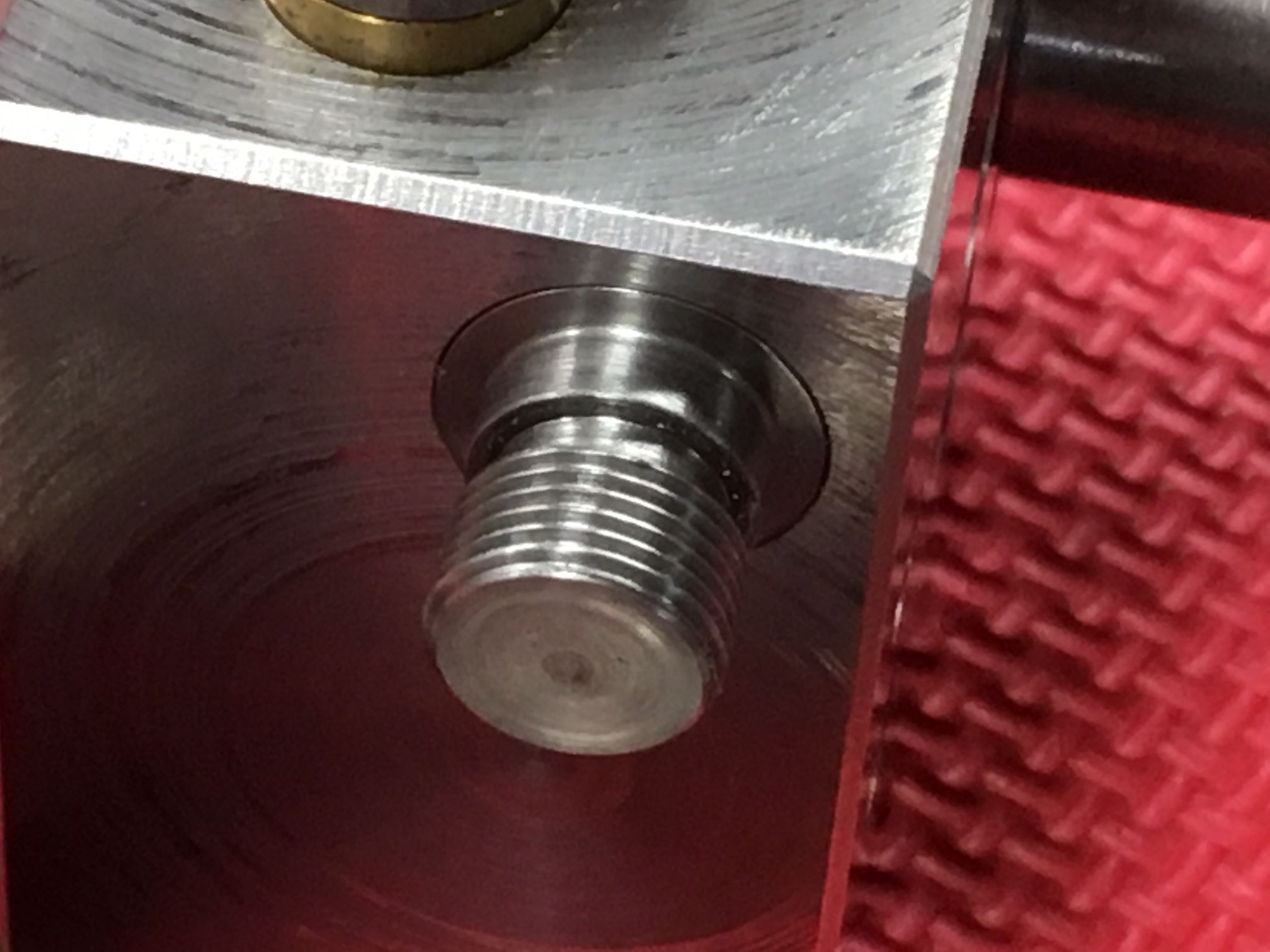

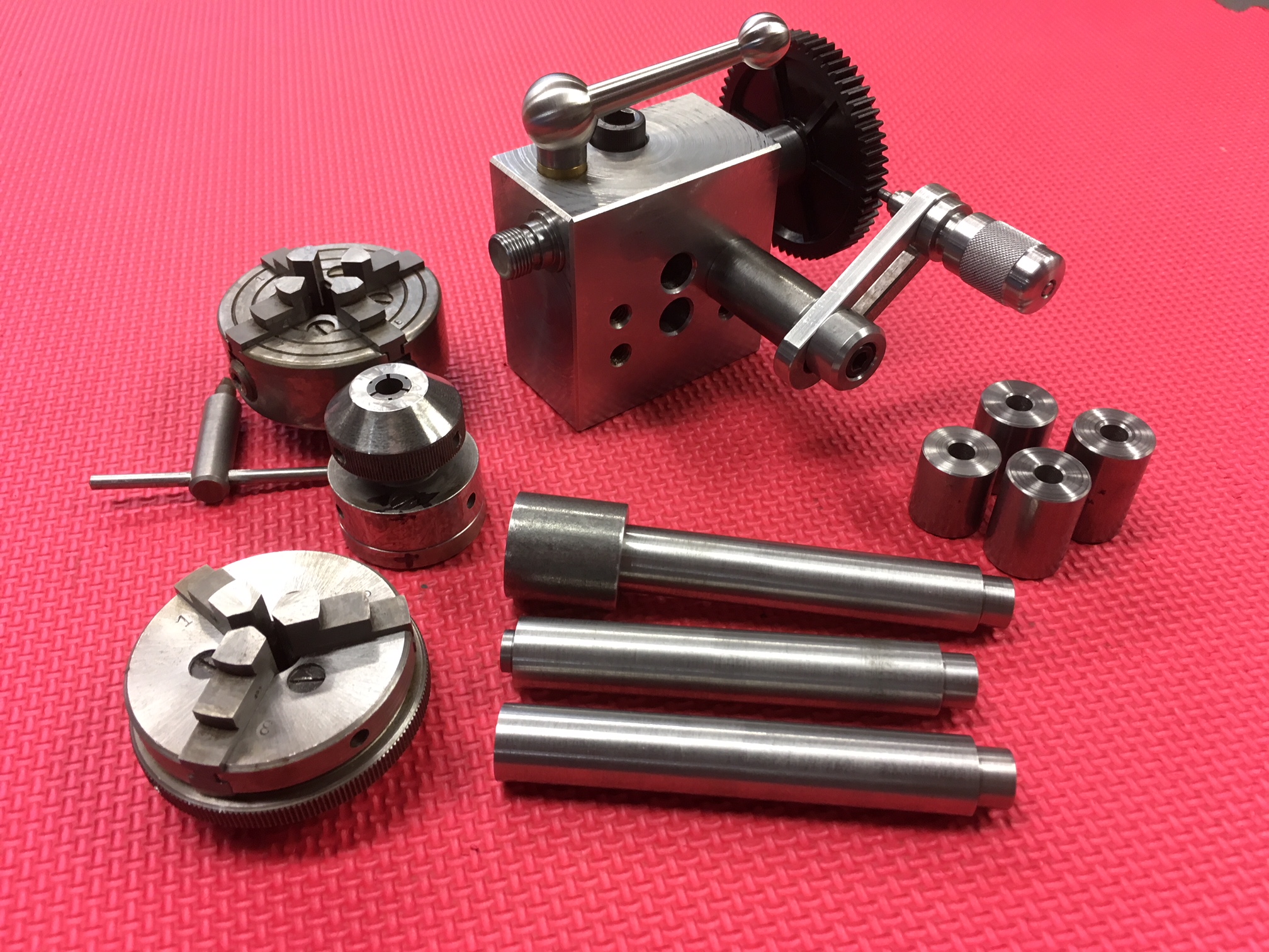

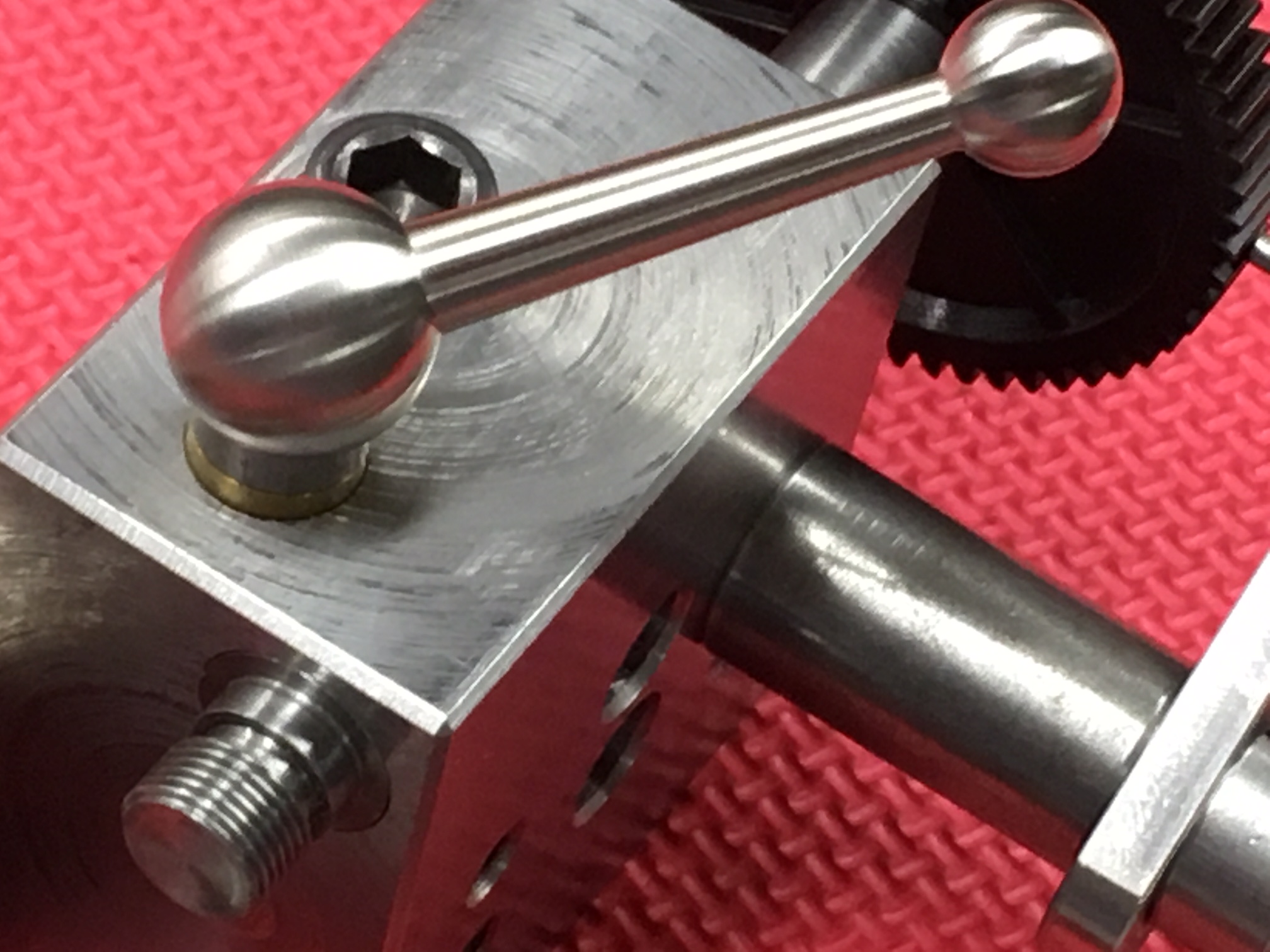

    I had a project a while ago where I needed to drill several hole circles in a dividing plate having accurately spaced holes. Having no means of accurately dividing a circle I set about building this Simple Dividing Head. I got my inspiration from an article in Home Shop Machinist magazine authored by Ted Hansen. I took the liberty to redesign it to suit my own needs. It is basically a block of 4140 P.H. steel with a few strategically placed holes. It uses mini lathe change gears as dividing plates and it has interchangeable mandrels so suit various applications. One mandrels is threaded M12x1 to accept the spindle accessories from my Unimat DB200 lathe. It is built to be able to be used on my mini lathe cross slide and has its mandrel center line on center with the lathe spindle. The mandrel is locked by means of a split cotter and double ball handle. Mandrels can be switched out and mounted in the lathe for further machining without disturbing the location of the part.

    I am not sure what you mean by "close to the actual setup on the Unimat", but the Simple Dividing Head I built is not scaled for use on the Unimat DB200 but it sure could be made that way. It would be easy to make it at the same center axis height as the Unimat indexing attachment if one so desired. I used 5/8" interchangeable mandrels but you could use easily use 1/2" mandrels. You can also build a worm drive unit to be able to index any number of teeth you desire and you won't be limited to using change gears as indexing masters. The possibilities are endless. Just a few thoughts.

    You have a very interesting hobby. Or is it an avocation? I have been thinking of drawing a set of plans as built but haven't done that yet. All I have now are crude hand sketches based loosly on Ted Hansen's article in Home Shop Machinist magazine. Those hand sketches would be hard to follow. I would be happy to give you guidance if you decide to build.

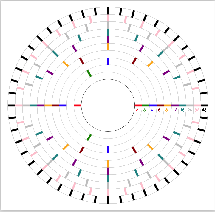

    Interesting coincidence; I just picked up some 96 tooth gears at AS&S https://www.sciplus.com/3116-plastic-gear-58018-p with the thought of building something like this.
    This is a handy number because it gets you a lot of divisions out of one gear: 2, 3, 4, 6, 8,12,16,24,32,48 and I hate 1, 2,3,4,oops did I skip a tooth? So I have written a program to make a PDF with common divisions to glue into the gear. Right now it's a prototype, but I should be able to make it fully parametized: OD, ID, #teeth, desired divisions, etc, and stick it up on a website somewhere.

    Nice find! You should be able to put this gear to good use on a simple dividing head. It is like having a full range of gears in one package. I might just buy a package myself at that price.
